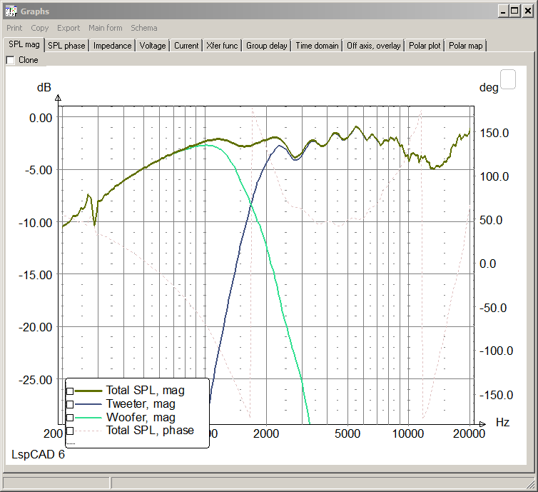

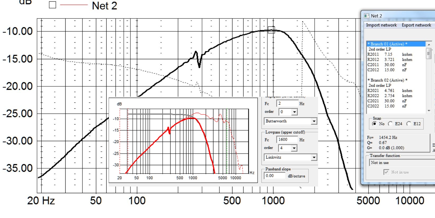

Now for the mid/bass. Luckily this is quite easy and if not for a peak in the response at 4400hz, the driver is reasonably well behaved. As we are crossing over low this can be ignored too.
One thing to note before I go any further is that due to the limited gate length the low frequency response of the mid/bass is severely limited. This has some impact on exactly how to fine tune the low pass. Having a near field splice to the far field response would help with this and is mandatory when designing a passive loudspeaker. With an active design it's easy enough to get around because you have complete freedom with setting the tweeter level and with setting how much baffle step compensation you want.
Either way due to the controlled nature of the mid/bass I've ended up with something that looks like this.

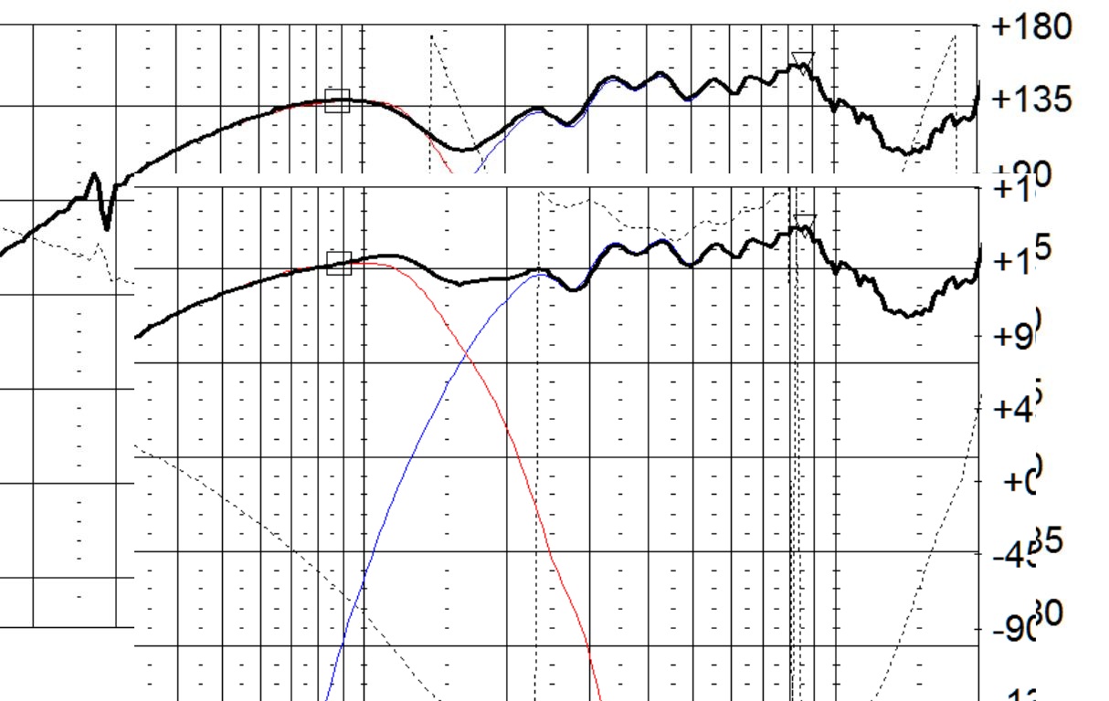

The next step is to combine them both and see how things then look.
The response is pretty dire, not so bad set one way, but the reverse null is terrible. I have also taken the liberty of setting the tweeter level.
attachment.php

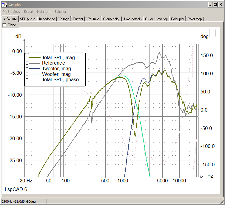

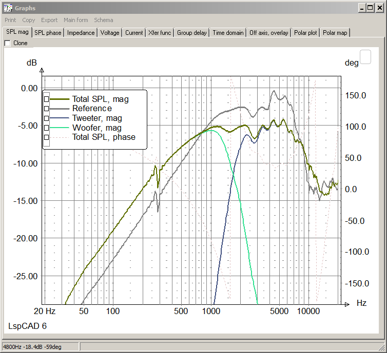

If this were a passive loudspeaker we would now start to try little tricks and asymmetric slopes in an attempt at fixing the phase issues.
This isn't a passive loudspeaker though, so we should take full advantage of that fact and add in a time delay circuit. This allows us to keep our perfect LWR4 slopes.
attachment.php
With the delay in place we now get a perfect symmetrical notch and a nice flat response on axis.

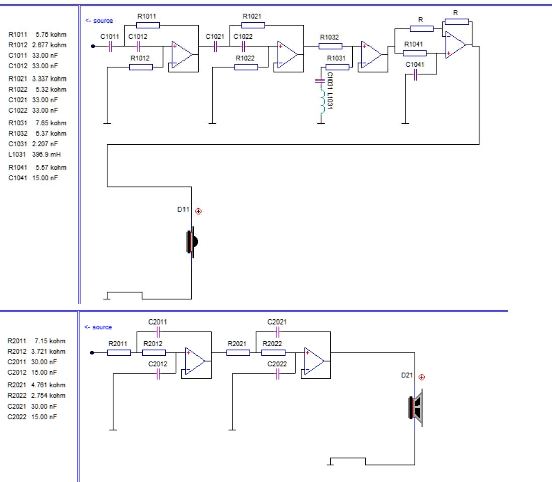

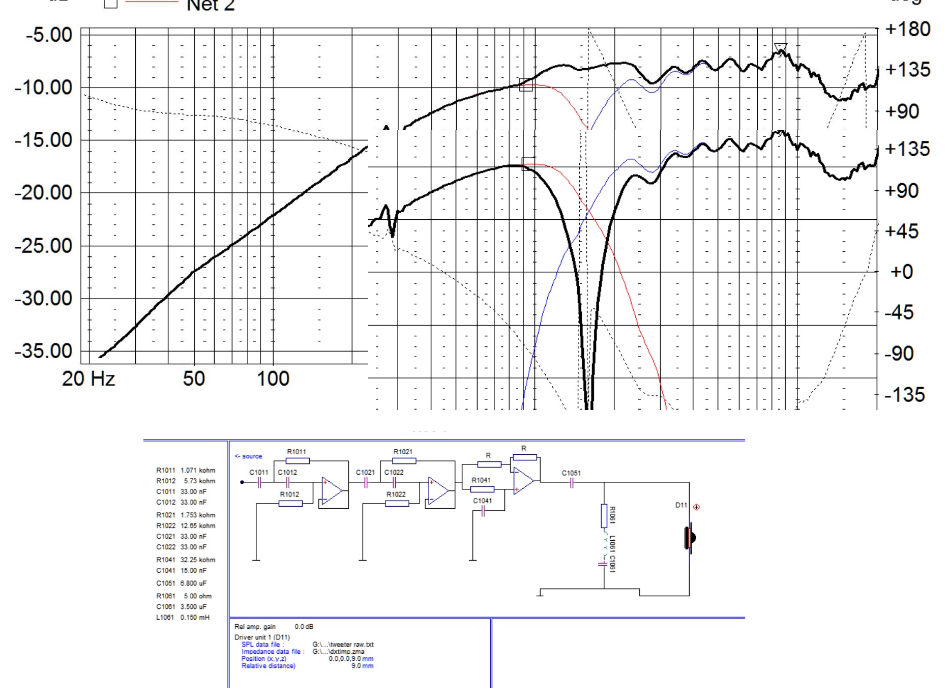

Finally here is the overall schematic.
attachment.php
Naturally you will have a baffle-step compensation circuit on the woofer and gain setting on the tweeter.
It bares mentioning however that we have just designed a speaker around a listening distance of 0.95 meters on tweeter axis. If this were a passive loudspeaker you'd want to set the mic distance to how far away you normally listen.
Also the mic is set in space on axis with the tweeter as the Dx and Dy parameters are both zero. You would want to set the mic position to your preferred listening height too. To do this you'd have to alter the Dy parameters of both the tweeter and mid/bass up or down by the same amount, to compensate for any difference in ear height. But do this after you've matched the initial measured combination to the predicted combination.
You can also measure the drivers to start with on the listening axis too.
As this is an active loudspeaker however these problems are less of an issue because of the delay circuit. You can position the microphone in your listening position and measure for the reverse null. If it's bad or off by a bit, you can tweak the delay circuit till the two drivers sum 'perfectly'.

Except for the notch filter, your schematic looks simmilar to mine and the values are not to far off either, so tha should mean I'm not that far off too.. 🙂
having said that, some of the resistor values in the HP section are a bit further out, meaning I have a bit moer of an "oddball" transferfunction, which in turn may explain that I'm actually able to get a reverse polarity null.

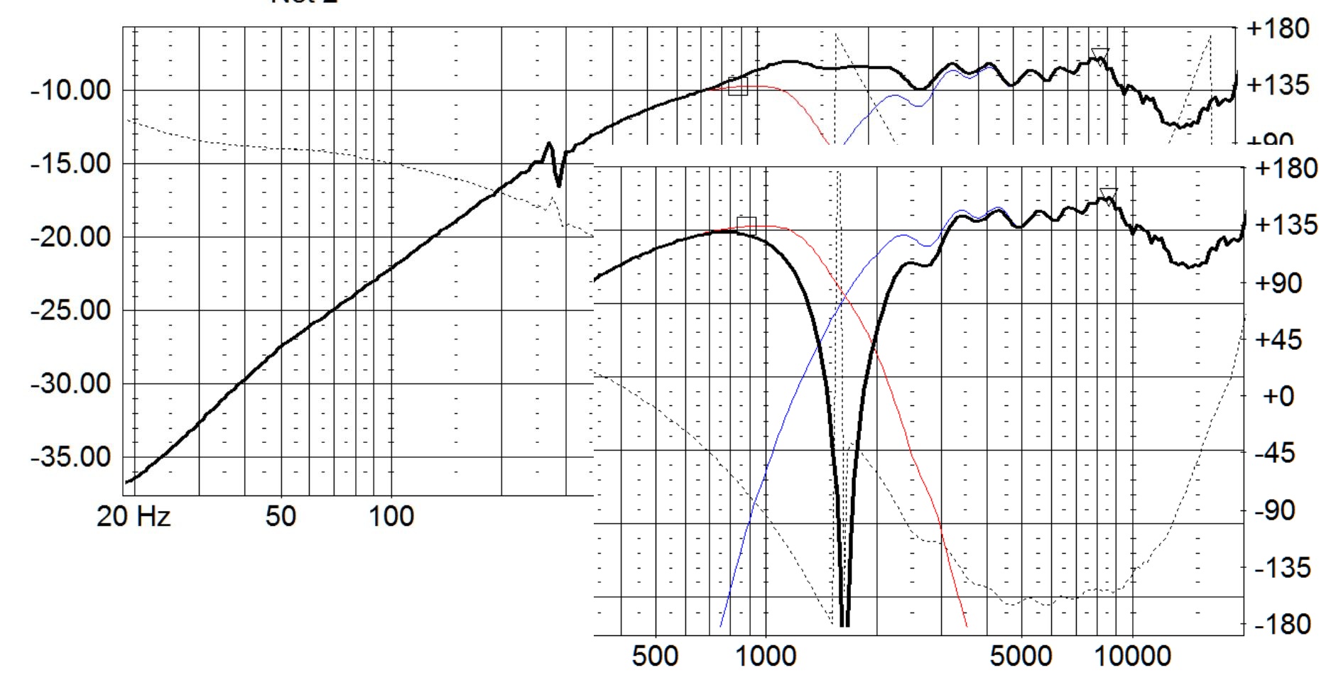

As Bob mentioned it is preferable to use a notch if possible, this is also beneficial because it allows you to shape the response a little better around the xover point I'd imagine too.
Here is another version using a passive network for the notch filter, the series cap is necessary for the shunt notch filter to work, it also provide protection for the tweeter. My amps have protection relays in too and a sensitive DC detection circuit too, but I still feel better having the cap there.

For the delay network you will have to build this yourself I think. LspCAD 5.25 comes with built in pre made filters, but comes with the limitation that you can't build anything other then what's pre built.
You can see the schematic for one in the pictures I've posted, in the last picture it's R1041, C1041 and the two R's. R doesn't have to be anything special, a value of 10k would work reasonably well, although you might prefer smaller to keep noise down. I've used 10k though and it's never been an audible problem.
One additional benefit to the delay circuit is its flexibility. It gives you the flexibility to easily try out different xover frequencies and slope types. If the delay wasn't there you'd have to constantly faff with asymmetrical stuff. All that's needed with the delay circuit is to simulated perfect acoustic targets, then set the delay till you get the required response with the polarity reversed.
It also means that you do not have to bother with configuring the simulation program for the phase. You get the acoustic targets how you want them, then you correct for the phase with your delay circuit by measuring the end product.

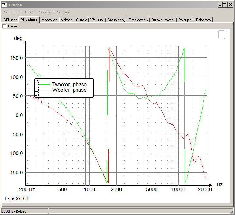

I did look in to delay, or allpass filters a bit earlier in the thread, and what I found with the slopes I had then, was that I was seriously out of op-amps for the stages required for the necessary delay..
So I'm kind of fearing that even if I did perfect symetrical slopes, I would not be able to build the required delay-circuits...😱

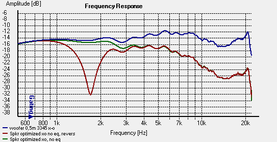

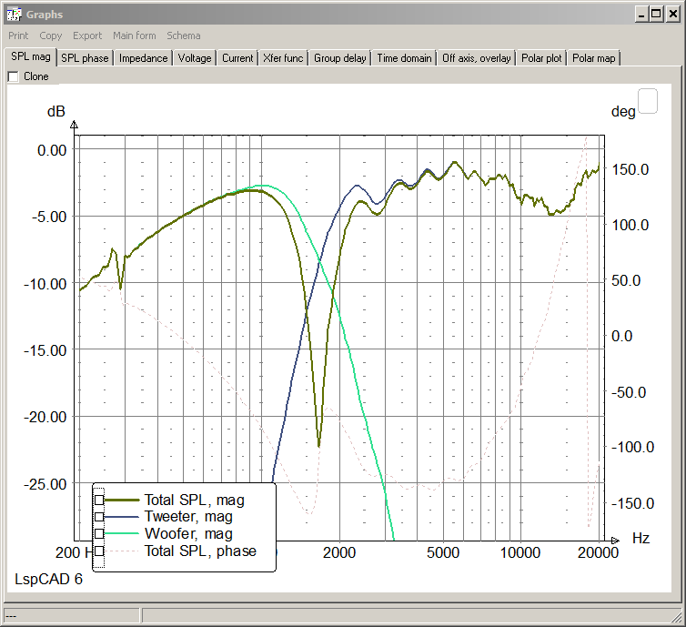

I couldn't quite see from your plots 5th, how deep is that null you get?
I found that I could improve things quite a bit by juggling woofer level, optimalisation range and set level..
After tweaking this a bit, I got a HP transfer function that will have a 15 dB null according to the simulation.
To me, this looks quite good and I think I'll leave it at that and do the HF bit next..
-35dB.

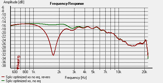

Hmmm.. one final observation I made..
In the general settings, I found that the measurement distance was set to infinite.. I changed this to 0.95 m, and Voila, a nice deep 20dB reverse polarity null! 😱 changed to 2m to check,and it was just as good there.
-20dB is of course not as good as -35dB, but I think it should be good enough, at least compared to other measurements & sims I've seen, e.g in Vance Dickasons loudspeaker cookbok.

Bob,
Looking at the phase plot for the drivers, it's obvious that it gets fairly steep above 10k. But do you think that is significant? Im just thinking that in this frequency range, to the extent we can hear stuff that high, the ear is only sensitive to magnitude changes, not time/ phase.
But anyway, do you think a 1st order filter will be "precise" enough? I'm sort of fearing that with a shallow filter, attenuation sufficient to kill the HF peak might dip down in to the slight 15k dip which is allready there??
