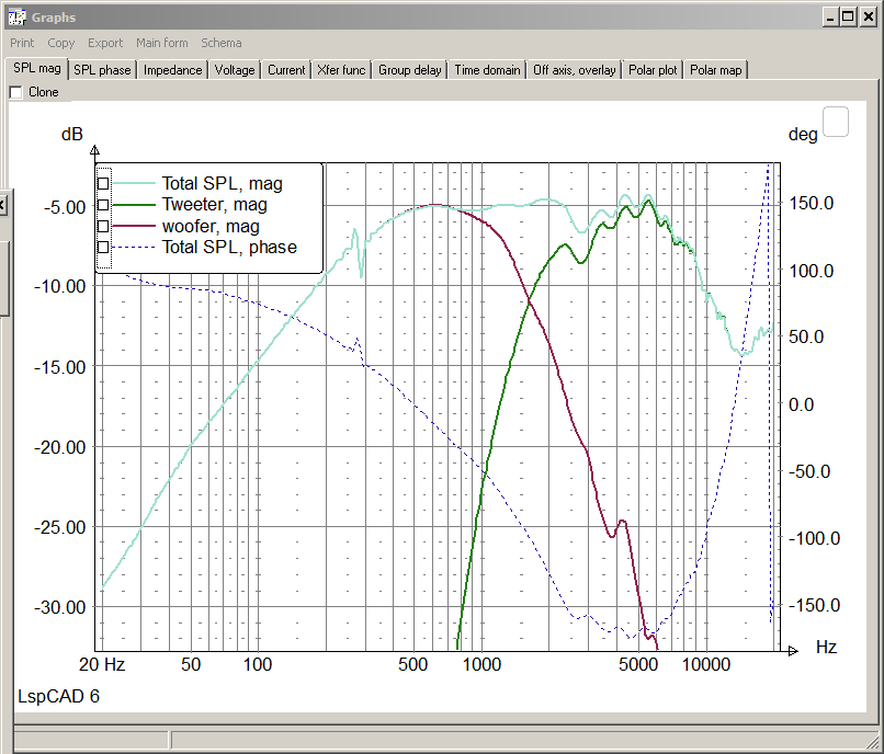

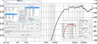

After doing the slope for the woofer, I had a go with the tweeter part of the XO.
Tried to set a 4th order LR target 1600Hz, but that didn't give any desired result, played around with the XO frequency a bit, but allways ended up with a dip arround 1500-1600 Hz..
Then I removed the slope constraint and set a level constraint in stead.
After a little cheving, the result was a fairly flat summation.
I then swithced tweeter polarity and got what I think looks like a very nice reverse dip.
I have attached graphs for both reversed and non-reversed.
Besides the HF roll-off, the nastiest feature left is a small dip at about 2800Hz, but this is fairly narrow and only 1-2 dB deep, something I believe must be of no real significance.
Allso, the resistor values remained within a reasonable range. If this is a response I can expect to get when implementing the optimized filter design, I guess this should be quite OK?

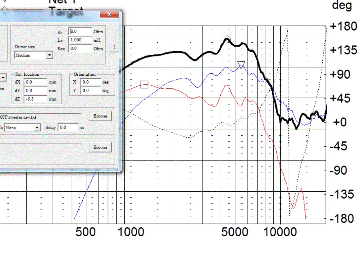

I've just started to play with these. I don't know what your exact separation of your drivers are but I'd imagine 140mm isn't bad between the tweeter and mid/bass. But already you can see with -5.8mm on the Dz axis for the tweeter the measured and simulated combined responses are right on top of each other.
Now what the Dz parameter does is effectively alter the time alignment between the two drivers and is *very* sensitive to positioning and how you go about setting things up (this includes entering the mic distance and entering the piston diameter for the mid/bass) . This is why I like to fine tune my delay circuit by hand with the mic in the listening position.
Well, that looks pretty spot-on..
Distance between tweeter and woofer is 145 mm. so you got that one quite right! 🙂
Mic distance to baffle was 95 cm, and the tweeter VC/Diaphragm is approx 15 mm behind the baffle surface, corresponding for woofer is approx. 33 mm.
So allthogu you managed to match the measured and summed curves, the figures you used are not 100% similar to the real physical measurements.. is this significant, or doesn't it matter as long as the two curves are made to match??

Had a quick play with your data for mic distance etc.
I had to alter the combined target spl by a small amount, but it ended up quite close enough.
You do not have to alter the Dz parameter for the woofer, leave that at zero. Then you alter the tweeters Dz parameter relative to the woofer.
The setting of the Dz, or phase/time parameter, is not absolute, it's simply the relationship between the two drivers, at the mic position and distance.

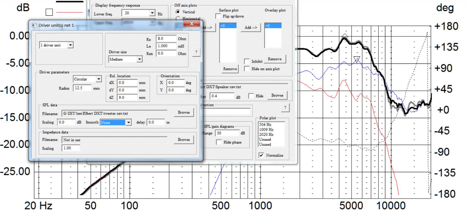

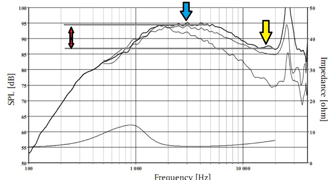

The first thing that really requires attention is the effect of the wave guide on the tweeter.
Lets look at the SEAS data-sheet again.
attachment.php
If we look at where the yellow arrow is positioned we can see here that the driver is somewhat 'flat'. This small section of the frequency response is where the wave guide you could say is having no influence, at least to the on axis SPL. If you were to draw a line backwards through the octaves this would represent the real world sensitivity of the driver if the wave guide didn't exist.
I have drawn in such a line and this shows that the tweeter would have a sensitivity of around 87dB.
The effect of the wave guide is what you see above this line, the gentle hump that is centred around 3.5khz.
What we need to do is remove this hump. The second grey line shows the difference between the two areas, this is about 7-8dB.

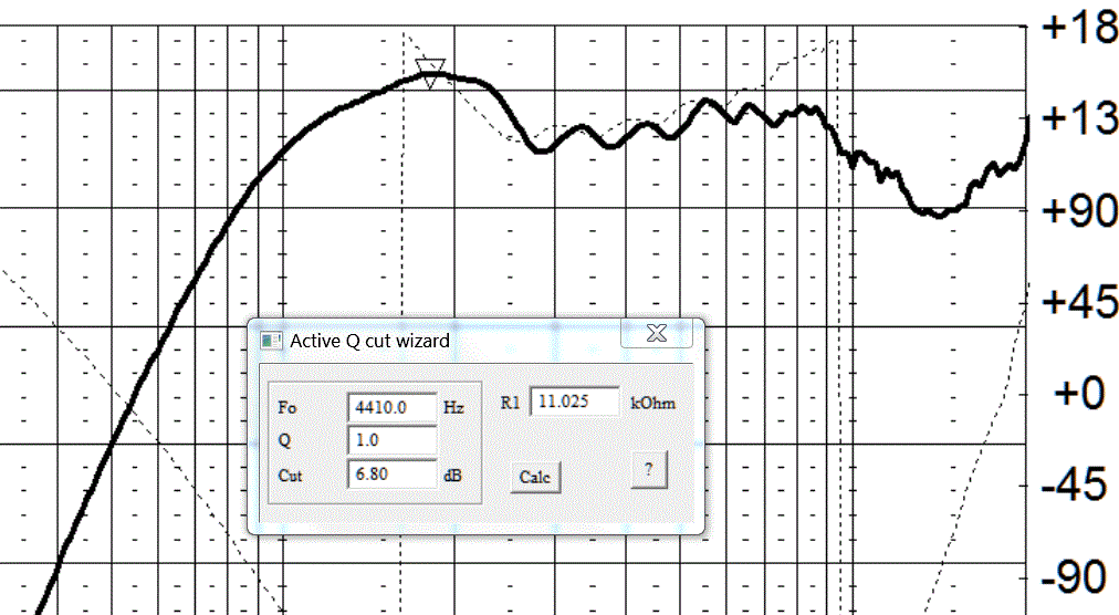

You will notice that in Mark Ks implementation he had to use a number of notches to sort out the frequency response. Luckily, if you go active it is somewhat easier to organise and you can get away with only 1.
Here is the response with the notch filter detailed in the box.
attachment.php
Already you can see that is it much improved and if your tweeter didn't dip down a little more past 10khz, it'd be reasonably flat already.

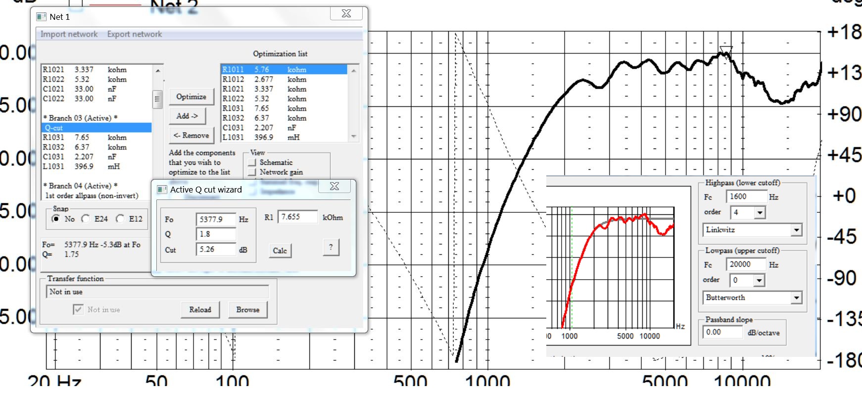

Next we need to apply a high pass. And almost immediately you notice that the effect of the notch filter is causing a dip around 3khz so it needs to be modified somewhat. Letting LspCAD play it ends up with.

Very interresting... Looking at the FR with the notch implemented, it looks very much like what I can get by using a 12 dB oct shelf after I've set the HF XO and acheived a reasonalby flat response up to 6k (then starting to roll off)
As such, it looks like there is little difference between pulling down the waveguide hump with a notch and using a shelf to lift the HF roll-off..
using either shelf or notch filter, perhaps the only way to get a flat FR all the way up is to add a sharp notch (or peaking EQ) to add some boost around 15k? that is if it really matters...
