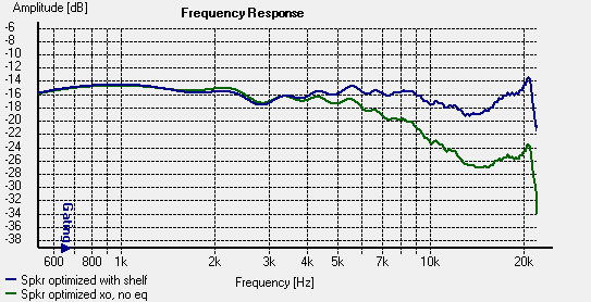

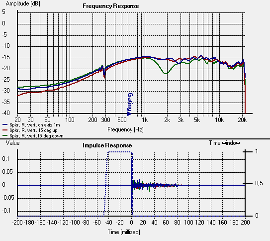

I played around with the tweeter level setting a bit, and increased the shelf frequency stepwise from 5k to 7k and bumped up the shelf gain a couple of dB.
Still a dip at 15k, but FR op to 10k is now fairly flat and the 20k peak is not severe.

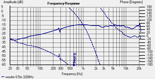

I have included a zoomed FR plot of the latest itteration and a second plot showing phase response.. nothing wild going on here is it?
Assuming that these home-made measurements are reasonably representative of what is actually going on, I feel that the result is one that will stand up to, and perhaps even surpass, relatively expensive "storebought" equipment.
Rather than trying to hammer out the HF response further with more shelving and filtering of the 20k peak, I think I'll leave it at this as a good compromize.
I feel I'm starting to push the limits on what is really relevant, especially considering the venue (my smallish living room) and the equipment I'm actually working with. I have to remember that my mic is a homegrown Panasonic capsule job, not a Bruel & Kjaer! 🙂
The sound is however very pleasant, there are no signs of any audible "snags".
On the record I have playing right now, the overall timbre might seem a bit bright, but I need to do some more listening to various music before passing a final judgement, some recordings ARE actullay bright . Based on that, I may or may not adjust the tweeter level a bit to get a result that actually works in a listening environment, at the end of the day that is actually more important than a ruler flat measured FR.
Once that is done, and I'm happy with the final result, I'll do a series of off-axis measurements and post for final judgement and evaluation! 🙂

...my mic is a homegrown Panasonic capsule job, not a Bruel & Kjaer...
I think I asked about this earlier in the thread but don't recall if you answered it - has your microphone ever been calibrated or compared to a reference or another mic? Do you have any certainty that the response of the capsule is flat or do you use any kind of correction?
Since you are now correcting the response by only a few dB here and there, it's important that you have a good reference to "flat". Just curious about this, otherwise it looks like you have made huge strides in getting the tweeter response under control. Kudos to you.

Good evening Charlie,
Regarding the mic, I buildt it, or rather did the capsule modification and amplifier according to the plans on the Linkwitz-lab page.
http://www.linkwitzlab.com/sys_test.htm#Mic
I then managed to obtain a calibration file for this mic, can't remember if it was on the HolmImpulse web-page or where it was, and this has been installed in my HolmImpulse software.
This is of course a generic calibration file, so my mic is in no way an absolute reference. Having said that, for the price and considering I'm only a modest DIY'er, it is probably plenty good enough relative to other limitations, both equipment and skill-wise!
I believe the mic and HolmImpulse on a laptop, not to mention that gee-wizz LspCad software, has made lightyears of difference to my DIY capabilities compared to the devices I was left with in the good old bad days. (ears and simple passive filter calculator programs).
Some of my past, and admittedly less ambitions projects, often ended up sounding nice, but I'm not to sure what the measurements would have looked like! 😀
I did find some comparisons of the mic I buildt where it was lined up with some other mic's, some of them expensive pro stuff, and it stood up to comparison surprisingly well. I think I'd have to do quite a lot of serious projects to justify the cost of going to the next performance step.
I would assume, with a reasonable degree of certainty, that with the generic calibration file, the mic should be good for +/- 0,5-1 dB from 20Hz to about 20kHz.
Yes, the tweeter response is not perfect, but I think it is acceptable. Looking at the factory measurements of a lot of other tweeters (SEAS, Scanspeak, that sort of stuff), it is apparently not uncommon to have some response anomalities up in the top, so my end result is perhaps not too bad for the rreal world after all..
And thanks again to you Charlie, you played an important role in sorting this out. That unintentional difraction groove would have eluded me completely had it not been for your observation!

What I'm most pleased with, is the actual x-over. Getting a good 20dB reverse tweeter dip without using delay circuits impressed me, lightyears from what I got just by slapping in a standard filter slope!
I'm not quite there with the tonal balance yet...
Having listened, slept listened some more, It becomes obvious to me that the speaker could do with a bit more energy in the 1-3k area. After adding the shelving filter, I pulled the overall tweeter level down a bit, and that resulted in the "sag" between 1-3k, which is visible on the plot.
I notice this in some lack of prescence of lead vocals and solo Instruments.
We are not talking about much here, perhaps 1 dB but even 1 dB over a wide frequency range can make an audible difference in tonal balance.
On top of this, the shelving filter has given some lift in the 4-7k region of about 1-1,5 dB, and I believe that this, combioned with the sag between 1-3k makes the sound a bit thin and bright.
So I think I will bring the overall tweeter level up a bit to increase the level at 1-3k, move the shelf up a bit more, and throw in that 23k LP as the 20k peak will inevitably rise as a consequence of pushing the shelving frequency higher.

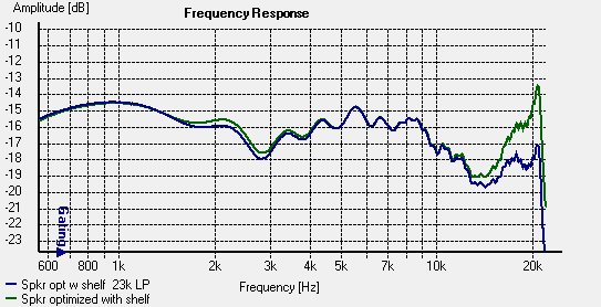

That took a bit longer than anticipated..
Well, I have now added a 23kHz 24dB/Oct LP filter in the tweeter channel, and it did a very nice job of lobbing of that 20k Peak!
I looked at the phase response too, and there was virtually no change.
This should give me some more latidude for playing with the shelving filter as I don't have to worry about that 20k peak getting out of hand any more.
Irrespective of that, I'll leave the 23k LP in as there seems to be no trade-offs to it! 🙂

The low pass would also act as a barrier against ultrasonic hash and less then adequate low pass filters in D/A converters. Also should something misbehave and oscillate it'd protect the rest of the system from possible damage.

To your credit, I can confirm that getting rid of that 15-20k peak was an improvement! Very hard to describe the effect as it was more perceivable than directly audible, but it was like removing some sort of a thin veil from the upper frequencies.. very subjective but definitively influencing the listening expereince, so despite my reasoning around sensitivity to HF information etc, I obviously underestimated the well-founded concerns you had on that subject!
I have now tweeked the shelving filter to the point where I have a +/-1,5 dB FR from below 1k (limited by measurements in room, but should be good to where room modes starts kicking in) and up to 12k. Still a dip of 2-3 dB at 15k, but I'll live with that.
Now I'll order up components for the second card and resistors to replace the trim-pots I've been using for tweeking.
Once the fixed resistors are in place and the tweeter level checked and adjusted, I'll do some final measurements including off-axis.
And most important, it sounds great! Filling in that 1dB between 1 and 3k, had the desired effect of getting the presence right, and lobbing off a dB 4-7k, got the balance just right!
The sound is very clear and detailed without being over-emphasised in any particular area..
Seing that it's possible to reach this level of performance as an amateur is really amazing, and these new-found possibilities sure will make the next project even more fun! 🙂

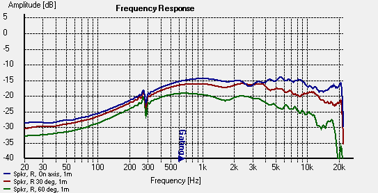

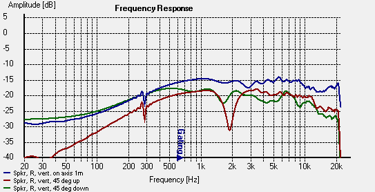

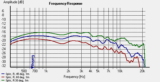

Got both cards for L and R finished today and did new off-axis measurements.
Again, measured in 15 degree increments, one file with 0-30 degrees and one with 30-60 degrees.
I think this looks quite OK? 🙂
Now it's time to install the cards in to the amplifier chassii and get everything wired up properly, hopefully without running in to any hum-problems! 🙂

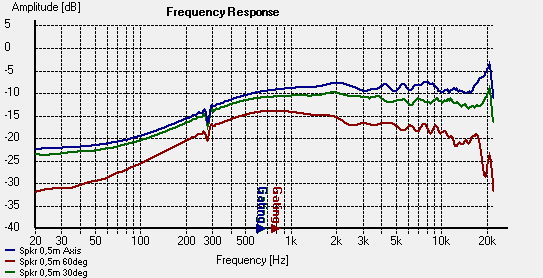

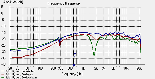

Well, this isn't quite over yet...
Some time has now passed since I finished the x-over cards and got the amps finished as well.
Since then, I've been listening quite a bit to the system, and I can not get away from the fact that I'm not entirely happy..
I feel that the upper midrange is a bit to pronounced and at the same time not as transparent as I would like it to be..
The frequency response measured fine enough, so I'm starting to think that despite a nice on axis response, something might not be OK with driver interaction and in room response....
I decided to re-visit some of the many measurements I've done and see if I could find some clues there as to what might be going on..
I dug out the on/off axis responses done with the last x-over configuration with 1700 Hz x-over and filter slopes optimized for phase tracking (using LspCad), and the corresponding measurements done with the first x-over version that had an x-over at 3200 Hz but no optimized phase tracking.
The curves show 0, 30 and 60 degrees.
On axis, the frequency response is fairly smooth for both configurations.
Looking at the of-axis response, I see that with the 1700 HZ x-over the off axis response is not as smooth. Most noticeable, there is a hump between approx. 1700 and 3500 Hz.
So why is this not the case with the higher x-over?
I'm thinking that the reason for this must be that with the lower x-over, there is simply an ubnfavourable match of off-axis response between the SEAS woofer and the DXT tweeter.
As this thread, and my experiementation, developed, a lot of good arguments for running a low x-over was put forth, but I'm starting to think that the priorities might need to be re-visited.

What surprises me the most is how flat the off axis curves are for the 3200hz xover, typically you'd expect to see a dip appear as you go off axis corresponding to the off axis droop of the mid/bass due to beaming.
I would be surprised if that small bump played such a large part in the way the loudspeaker comes across. In the 60 degree curve you don't really have a bump, what you have is a small dip at 1700hz. Fill in that dip and the bump pretty much disappears.
We are talking an error of less then +-1dB from flat though, realistically it doesn't get much better then that.
I think you could be perhaps looking at the wrong thing, your lateral off-axis plots for both x-overs are more then acceptable. Try looking at how the driver integration varies through the vertical axis, you might see something that jumps out at you. It might not be a question of crossover point or phase integration, it could be that a peak appears due to diffraction and it's this that's causing the trouble. Bare in mind however that vertical off axis plots will always look a mess, as the drivers will go in and out of phase with one another, this will create dips in the frequency response as the drivers null with one another. What you're looking for are any peaks that stand out above what would be the nominal 'flat' on axis response.

Ah, 5th, your viewpoints and observations are allways rewarding and interresting to read! 🙂
Yes, considering "commonly accepted practice", I agree that the good result of the high x-over configuration is somewhat surprising.
I think the SEAS DXT tweeter may play a part in this. Not to long after it was released, it was discussed in various threads, and on one account, somebody compared it with other more conventional wave-guide applications, e.g. those of John Krutke Zaph|Audio .
One of the comments was that the DXT lens/waveguide was too small to have any effect at frequencies below 3-4k Hz.
From this, I'm thinking that with the 1700 Hz filter, the tweeter is starting to widen its dispersion at the lower frequencies, and that this explains the "hump" between approx 1700-3500 Hz.
I further suspect that with the higher x-over, the above mentioned frequency range is covered by the midwoofer, which is starting to display a narrower dispersion at these frequencies, a dispersion that might actually match the dispersion of the DXT tweeter where tie waveguide of the DXT lens is effective.
This might explain why this seems to work where conventional wisdom and conventional tweeters would normally dictate otherwise?
Granted, the "hump" is not severe in magnitude, but it is rather wide, and whereas a small ripple of 1-2 dB might not be very audible, such a difference in level may be audible across an octave or two.
Following my reasoning, a higher x-over point should allso reduce the general disperison of the loudspeaker and thus reduce room-reflection problems.

Ah, and for vertical response, here's the plots for 15, 30, and 45 deg up and down.
As you predicted, some deep nulls from the drivers going in and out of phase, but apart from that, I can't really see anything hair-rising stuff going on?
Now, I have to point out that the chriticism I have at the moment is not severe, the system does sound good, but I know there is more to be had.
My reference is the first track on the ELO out of the blue album, "turn to stone".

Vertical off axis plots look fine. The entire speaker seems well put together, although as you've mentioned some fine tuning will most likely be necessary.

I think there's some confusion going on here, the mid/bass appears to have decent off axis curves till a bit below 2khz, any higher then this and the dispersion from the midrange decreases as it really starts to beam. Geddes show's this a number of times in this PDF, but look at figure 12. The typical wide/narrow/wide dispersion characteristic is due to crossing the tweeter to the mid/bass too high up. The dispersion narrows due to the mid/bass starting to beam, but then you cross over to an omni source, the tweeter, so the dispersion widens again (before narrowing due to the tweeter starting to beam). This seems like something you would want to avoid and is avoided in Geddes designs.
As the DXT has wide dispersion at 3khz itself, if crossed here you could end up with wide/narrow/wide>CD (how narrow depends on how much the mid/bass beams). I'd have thought wide>CD would be preferable.
At the end of the day though, you can't beat hearing the system though, so it'd probably be worth give both a go.

Looking at the off-axis plots for the high-and low x-over point, it seems to me that the higher x-over point has a potential for better "constant directivity" with somewhat less dispersion in the upper midrange area.
Both have exactly the same potential for constant directivity as any CD you're getting is completely due to wave-guide tweeter above 3-4khz. The transition to CD and what happens before this is up to the crossover and mid/bass.
It is a good point that for the highest octave, the most important thing is that something "is there", this is not the most sensitive area I agree! 🙂
I allso agree that adding a second horn/ wave-guided tweeter to cover the top octave is going a bit over the top.
Regarding the midrange area, this is a complicated one, and I do agree that part of the focus this hhas received has come from poor-x overs. As you say making a hash of it in this area is doomed to give bad results! But even assuming a good x-over implementation, I'm a bit sceptical..
What worries me, is the fact that the ear is very time sensitive in this area, so if you have part of the midrange emeanating from the tweeter and the midrange, the ear can detect the difference in position. and due to the ears sensitivity in this area, this can muddle up spatial perseption and immaging. This is just drawing assumptions from common psycho-acoustic research. If one moves up and above 2-3 kHz, the ear transits from time, or phase, sensitivity to level sensitivity. Having two simmilar signals emeanating from two sources placed close to each others will be less distinguishable as their position will be difficult to discriminate from level alone.
I agree that the midbass off-axis looks good as such except for the dip.
But the dip aside, with the higher x-over, the 30 degree response is consistently lower than on axis, and that is something I find interresting.
As I read the plots, the response for the lower x-over seems closer to figure nr 12 than the hight x-over response, whilst the high-x over more approximates that of figure 18., i.e. It seems I got more of a wide-narrow- wide issue now than with the high x-over. But had I been using a conventional tweeter, I think it is likely that the result would have been a pronounced wide-narrow-wide response as a "non-waveguided" tweeter would probably have wider dispersion at 3 khz than the DXT tweeter.

Figure 12 shows a standard 2 way xovered at 2000hz, with a mid/bass showing off axis droop due to beaming. The tweeter is also non wave guide otherwise the black lines representing 6dB differences in output level would be more or less parallel.
Figure 18 represents Geddes flagship wave-guide design that exhibits CD down to around 1khz, where the directivity then slowly decreases as the woofer takes over, I am guessing here that the xover is at around 1khz too if I am reading things correctly.
With the DXT, you should have controlled directivity from ~3.5khz onwards.
If you are drawing comparisons to those two figures then I'd say figure 18 would represent the 1700hz xover. Here you should have CD from 3.5khz+ and below that a smooth transition to omni. This is almost identical to figure 18, except that the CD to omni transition occurs at 1khz instead of 3.5khz.
The 3200hz xover should show signs of beaming from the mid/bass and thus a narrowing of dispersion up until the tweeter takes over. This would show a similarity to figure 12, where the mid/bass to tweeter xover does exactly the same thing. Except here the similarities end as the DXT should show CD from 3.5khz+.
