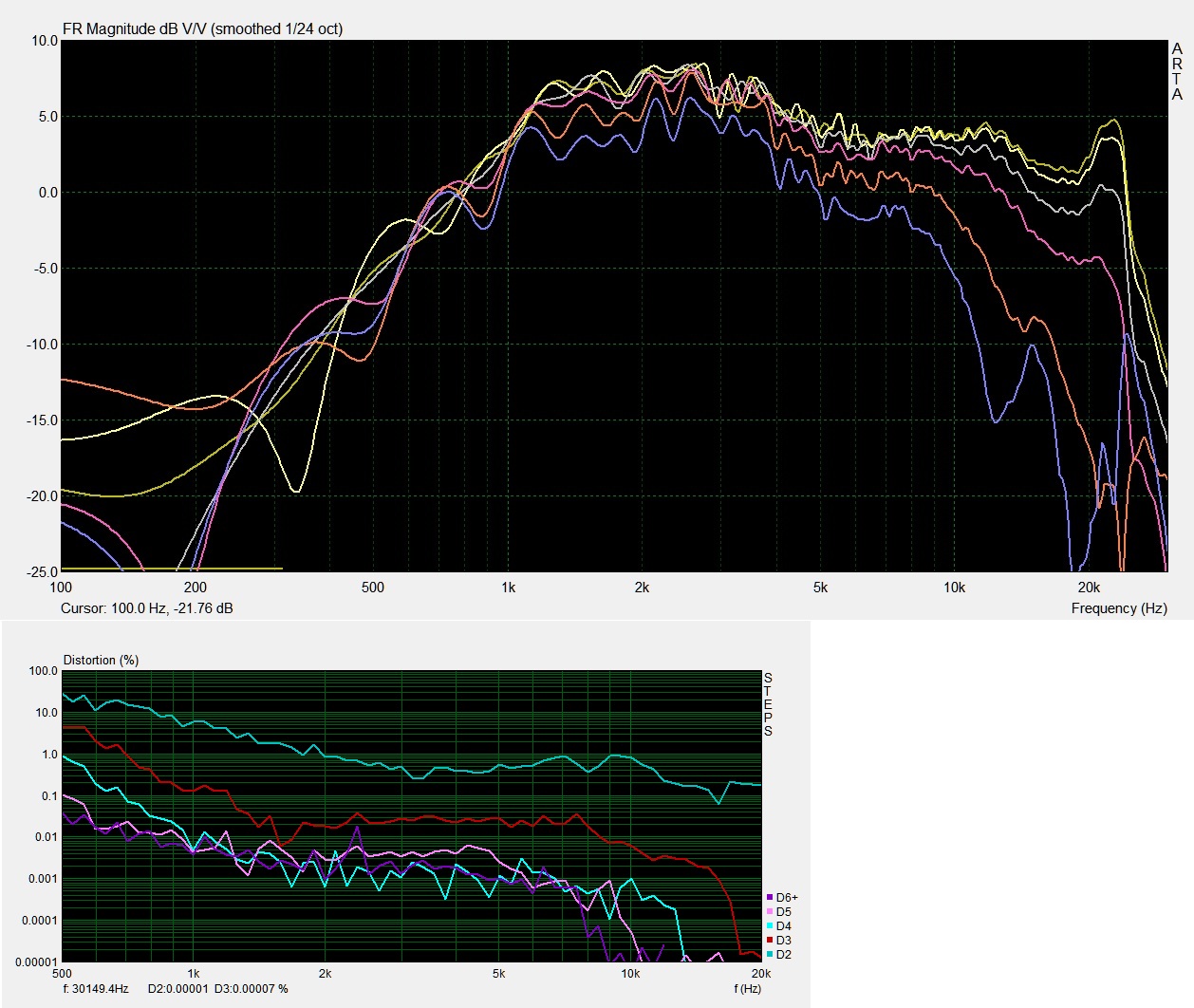

Now for the fun stuff the measurements.
First up is the XT25
The first thing to notice is the very smooth response. All these measurements were taken in unfavourable conditions, so some small room reflections show up making the response a little ragged, but overall they are pretty decent.
Like this the XT25 also has very good distortion performance too, excellent 3rd, 4th, 5th and 6+. Only the rising second harmonic @ 3khz lets it down. I originally tried running the test @ 2.8 volts rms, the tweeter wasn't happy like this at all, something buzzed around 600-900 hz, not that the tweeter would be used down this low anyway, but I had to turn it down a little for it to be happy. Due to the extra output provided by the wave-guide you could probably get away with 1500hz 4th order slopes. The buzzing sound at 900hz was caused by the phase plug arrangement and might not be present in the scan speak versions with their better quality control.

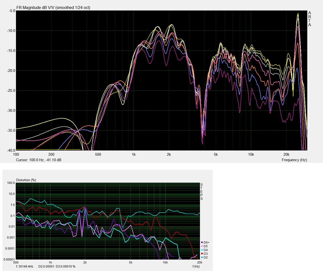

Now for the DXT.
Shock!
I thought this might happen😉 The spacing described above is obviously not anywhere close to being adequate, this creating a huge suck out centred on 4khz. Not much to say other then that, distortion performance looks nice though.
Out with the plasticine! DXT version 2.
Ahhh much better. My 5 minute low tech filling in of the gap with plasticine has helped things considerably, the 4khz suck-out having vanished completely. Now however there's a dip in the top octave and as you go off axis another narrow suck-out appears. I am sure I could improve things considerably if I spent more time creating a better transition between the mesh grid and the wave-guide, currently it looks a bit like a 2 year old made it 😀 Distortion performance is excellent, it's clear that this is a better tweeter compared to the XT25. You might just be able to get away with a 1khz xover with 4th order slopes, this would have to be measured though to find out and I do intend on trying this out.

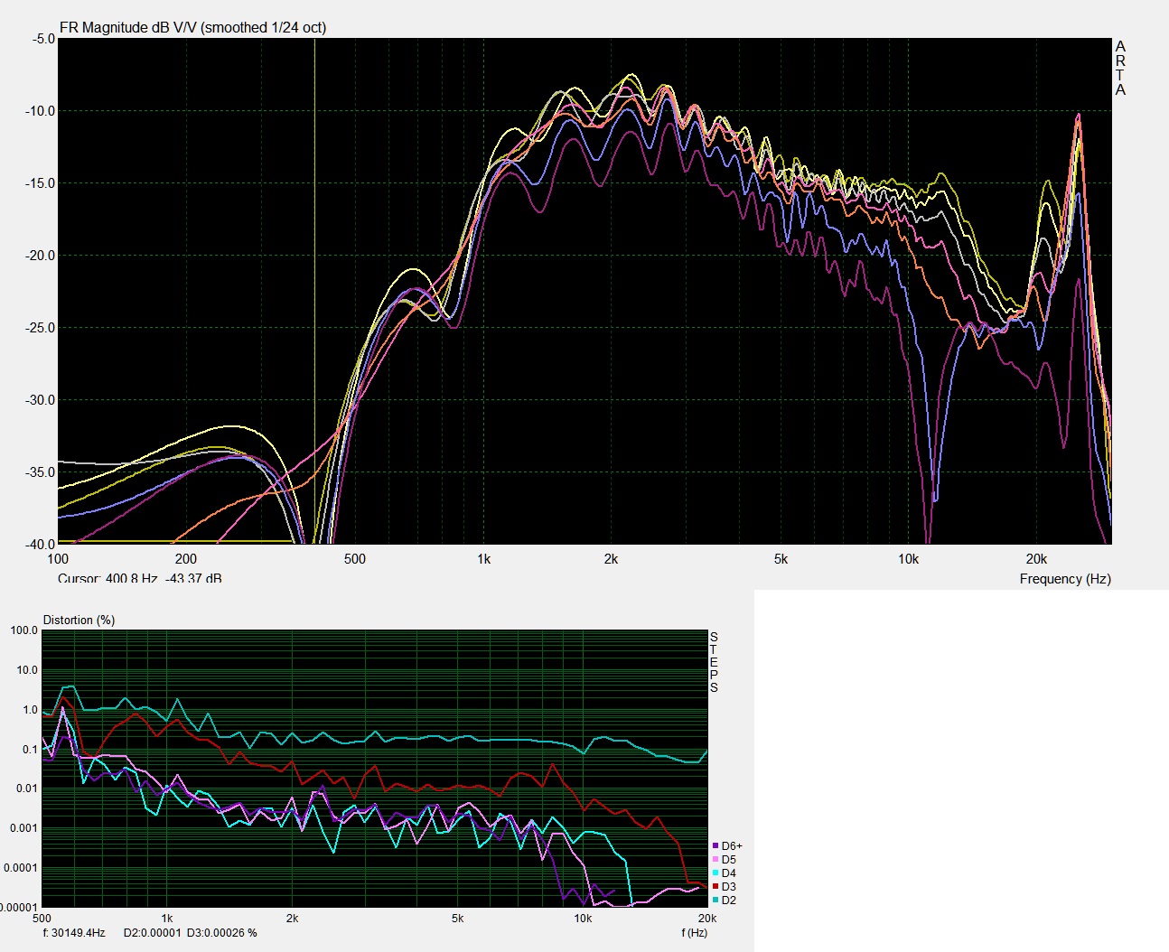

One thing that's interesting is the DXT distortion performance, here is a graph of the DXT in its own small wave-guide.
As can be seen there's a broad hump in the third harmonic around 1-2khz. This same hump can be seen in Zaphs measurements of the DXT too. However when using the WG300 instead of the DXTs own wave-guide this hump completely vanishes. I had assumed this was an issue with the motor/dome/chamber etc, but it appears like it's created by the wave-guide instead. Either that or the WG300 suppresses the peak.
The wave-guide appears to work rather well though, probably giving constant directivity down to around 2.5khz. The off axis curves can't really be directly compared as I didn't have a protractor around to give accurate angles, however the overall trend is easy to see. I probably went out to around 60 degrees.
This has me wanting to buy a pair of the scan tweeters I linked to before and trying those out. Tomorrow I'll probably pull some scan D2905/95s out of a finished design and test out those too.

Here is the d2905/95
It works rather well. Here it is hammered flat with the DSP + a 4th order acoustic LWR filter.
This still looks very nice. The tweeter wasn't happy using a 1khz xover, moving it up to 1.5k was possibly useable depending on how loud you want things to be. Mind you I wear ear defenders when doing distortion tests as it hurts otherwise, so I guess it can prolly go loud enough at 1.5k.
The only issue I can see is the bunching up of the off axis response @ 16/17khz. I don't think this is enough to make anything sound bad, it might add a touch of brightness.
The XT25 certainly looks promising, hope it is easy to smooth out to flat with a "standard" filter slope too!
The d2905/95 required three notches in combination with a 4th order electrical filter to get it flat, the XT on the other hand does this with only 2 notches, one these also only works at 10k+ and by a small amount, so it might not actually be needed.
But why would you add the waveguide to the DXT tweeter?? That would sort of be a waste of the DXT waveguide/ lens allready in place.
The idea was to use the DXT's motor + dome in conjunction with the WG300, effectively bypassing its own wave-guide completely. This did not work very well, even faffing about with the plasticine wouldn't get the top octave to come together, and although it did improve things a bit, it made the 5k region a bit lumpy.

The RS225 has a peak in the distortion plot at 1.5khz, and while not really that high, it could be contributing to it. There's a spike in the third harmonic there and any 1.5-1.8khz stuff will excite this giving output in the 4-5khz range. The relative level of the distortion is still low mind you so I am not convinced that's the issue. Using the W15 will be an easy way to see if this is the cause. Also the XT would prefer being used a bit higher, at least 1.8khz or so.
