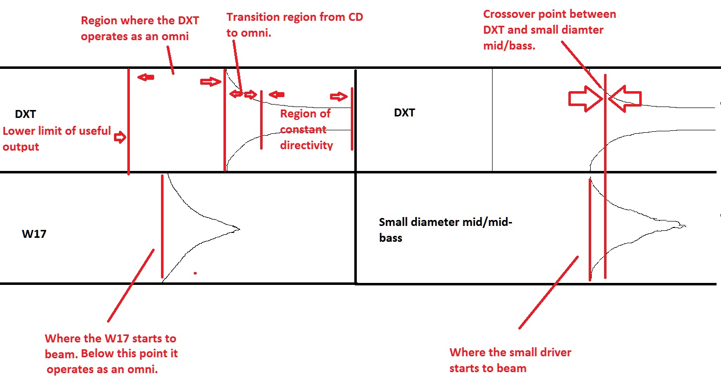

Yes, the other way around is to match the directivity of the midrange/mid-bass to the directivity of the wave-guide.
A picture will better illustrate this, my paint skills aren't exactly epic, but I hope you get the idea of what I am trying to say!
With the left hand side part of the image you want the entire omni to CD transition region to occur solely within the DXT and you also want the region below this transition to remain as an omni - that is you don't want any part to have a narrowing of dispersion due to the mid/bass starting to beam.
This is easy to achieve as there is an overlap region between where the mid/bass starts to beam and the lowest xover point the DXT can cope with. This is what I've been saying you should be doing.
The right hand side part of the image, shows the DXT again, but this time below it you've got a small diameter mid/bass. This time round you have to pick the mid/bass and the xover point carefully. I'm sure my representation isn't exactly how it would appear in real life mind you, but the goal is still the same - to cross the two together so you end up with a smooth transition from omni to CD. As you can see, here you cross over after the mid/bass has started to beam and before the tweeter has transitioned to an omni radiator. This is fortunate indeed because it lets you cross the tweeter over higher, relaxing the load it has to handle, and it lets you use the mid/bass into the region where it starts to beam, relaxing the need for a mid/bass that is omni up until a bit before the xover point too.
I will also add in here that when using the small diameter mid/bass with the DXT there is nothing stopping you from choosing a lower crossover point. This will push the xover into the range where the DXT and the mid/bass are both acting as an omni and you'll end up with a speaker similar to the DXT/W17 implementation. While this sounds nice, if you've got a 15" driver mated to a tweeter with a 15" wave-guide, the tweeter wont go down low enough to let you do this, you are literally forced into matching the directivity of the two together.

A very good and illustrative description of the "problem" you made there!
This allso illustrates some assumptions we are now working from, or at least, I'm working from. I'm assuming that I can actually get away with what you illustrated to the left, (the example for x-ing over to a smaller dia. woofer), but with the W17cy. This is of cource assuming that the dispersion pattern is beaming in such a way that it will "intercept and converge" with the controlled directivity of the DXT at some point. I think that the off-axis plots I did with the 3200 Hz x-over points to this being feasible.
Your example of the 15" scenario is interresting, it clearly demonstrates a situation that doesn't afford extending a waveguide down to get an "omni-overlap". But provided it is possible to overlap in the non-omni range, so to speak, one will end up with less omni and more constant direction.. which I've obviously come to believe is a good thing by now! 🙂
Besides this, I'm sarting to itch for designing and building some new speakers with those SEAS 8" woofers and some 6 or 8" wave-guides.. Think I've been bitten by the CD/ waveguide bug here! 🙂

The image on the left was specifically for the W17, showing that you can easily cross over in the region where both drivers are acting as an omni radiator.
The 'Region where the DXT operates as an omni' is supposed to be from about 1500-3000hz.
The W17 acts as an omni up to around 1800hz, so you want to cross over between 1500 and 1800hz..
This is of course assuming that the dispersion pattern is beaming in such a way that it will "intercept and converge" with the controlled directivity of the DXT at some point.
No, it isn't, there is no converging point between the two drivers, that is there is no controlled matching of directivity. Both drivers should be acting as an omnidirectional sound source at the frequency you choose to cross them to one another, hence the 1500-1800hz xover frequency. This is point Zaph was making when he said this.
Make no mistake, a wave-guide of only 3 or 4 inches in size is still a wave-guide. Wave-guides CAN be used below their corner frequency of directivity as long as they are paired with a woofer operating below it's off axis rolloff.
The corner frequency is when the wave-guide tweeter is starting towards constant directivity. A bit below the corner frequency and the wave-guide is acting as an omnidirectional sound source - this is the DXT how we want to use it, it's corner frequency is around 3.5khz and we want to cross below this.
As long as they are paired with a woofer operating below it's off axis roll off.
Off axis roll off is the mid/bass roll off due to beaming. As we've seen with the W17, this extends to around 1800hz before off axis beaming becomes an issue, hence, as Zaph said, we cross over below this point.
So our overlap with the DXT and the W17 is between the lowest point you'd want to take the DXT to, 1500hz, and the highest point you could take the W17 to, that would be 1800hz.
If we were using a 5.5" driver instead of a 6.5" W17, the 1500hz low point of the DXT remains the same, but now, because a smaller driver starts beaming at a higher frequency we would extend the upper xover point to around 2200hz.
Crossing the DXT to the W17 in the 1500hz-1800hz region, where both are operating as an omnidirectional sound source, means that the entire loudspeaker will remain omnidirectional up until the corner frequency of the DXT wave-guide, where it then starts to control directivity.
Your example of the 15" scenario is interesting, it clearly demonstrates a situation that doesn't afford extending a wave-guide down to get an "omni-overlap". But provided it is possible to overlap in the non-omni range, so to speak, one will end up with less omni and more constant direction.. which I've obviously come to believe is a good thing by now! 🙂
This isn't quite what I was trying to get at. The 15" wave-guide loaded tweeter will probably not operate satisfactorily in it's omni region and even if it did this would be at say 800hz. A 15" mid/bass driver starts to beam around 400-500hz, it cannot go high enough to mate with the wave-guide in it's omni region, neither can the wave-guide tweeter make it down low enough to mate with the 15" mid/bass (400hz). In this instance you mix the two together, this is where you are actively 'matching' the directivity of the two drivers. At 1000hz the wave-guide is tending towards constant directivity, but it isn't all the way there yet and although the 15" driver is beaming quite a bit by 1000hz it's still got quite a lot of juice left in the off axis plots. Here you want the reducing off axis response of the 15" mid/bass to match up to the reducing off axis response of the wave-guide as it transitions into constant directivity. This is what matching the directivity of the mid/bass to the wave-guide means. It is important to handle it this way with a large loudspeaker because there are direct gains to be had. 1) it lowers the demands of the tweeter and 2) it allows you to use a mid/bass of the same diameter as the wave-guide, instead of a 15" wave-guide and 10-12" mid/bass.
With the DXT this directivity matching would occur at around 3500hz and thus you'd want to use a 3-4" mid/bass driver for the directivity to match. With the DXT though, because the wave-guide is so small, you can easily use it below its region of constant directivity, allowing it to mate satisfactorily with any mid/bass no bigger then a 6.5" providing you cross over before pattern control starts in the DXT and that the mid/bass is crossed over before it starts to show signs of beaming.
Besides this, I'm starting to itch for designing and building some new speakers with those SEAS 8" woofers and some 6 or 8" wave-guides.. Think I've been bitten by the CD/ wave-guide bug here! 🙂

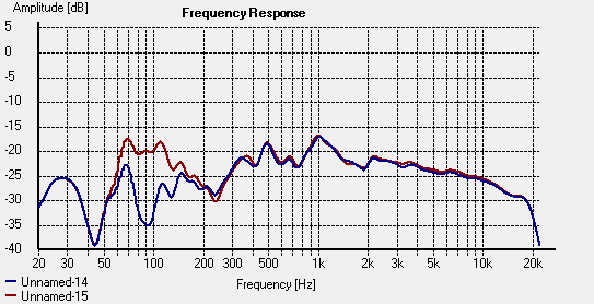

Since last, I've made two very interresting discoveries.. first of all, the L-R balance from the pre-amp was not entirely balanced with the result that the right channel was a bit louder, and the sub is on the left channel (haven't completed the sub for the right channel yet). When this became obvious, it was further obvious why the tonal balance seemed overly bright!
Removed the pre-amp from the set up to check it... and it measured fine!
Put it back and the bvalance was OK, even measured level at the speakers! The only explanation i have for this is a poor contact somewhere...😕
Further to this, I allso tried to swap the polarity on the sub.. suddenly the sound was much fuller and richer.

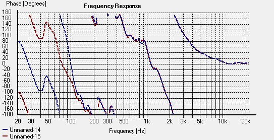

I decided to measure this to see if the results correlated with my listening experience.. right so..
Attached is the in room rwa response 1/5th oct smoothed, roughly at the listening position. Red is with phase reversed.
Seems I had an out-of phase situation in the x-over area resulting in a pronounced high-bass dip!
I allso included a phase plot of the same measurement.
The 50 Hz dip is a room mode artefact and the dip around 200 Hz should hopefully be possible to sort out by experimenting with speaker room-placement. The droop in highs can in part be explained by the off axis situation at the listening position, absorbtion from carpet etc..
So 5th, you were in deed on to something when you suggested looking at baffle step allthough it turned out the issue was caused by something else!
Based on these findings, I think I will suspend any further tinkering with midwoofer/ tweeter x-over point, at least untill I've completed the second subwoofer and optimized speaker placement!
It's nice to see good phase integration between the subs, even with the smoothing applied it still stands out well. And stand out it does all the way up to around 150hz! It's not a surprise that some warmth was lacking from the sound. Building the second sub should also give you the benefit of loading the room from two separate locations, so it should help even more in smoothing out the lower region.

So you think the phase integration after polarity switch on the sub looks OK? Well, good news for me then! Again, I'm lacking the experience to make the best judgement of the plots here.

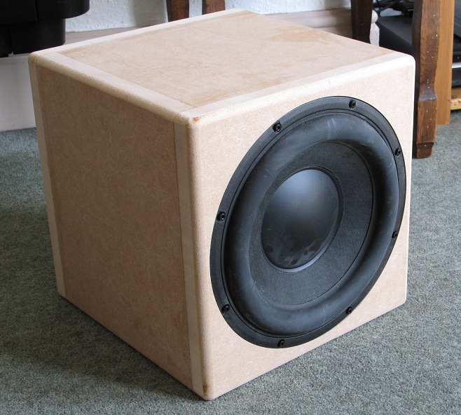

I guess I'll have to make do with two for the time being, after all, being 140 L closed boxes with 15" dayton woffers, it's completely overkill for my smallish apartment as it is, but oh boy what a deep and wonderfull bass, even from just one! 🙂

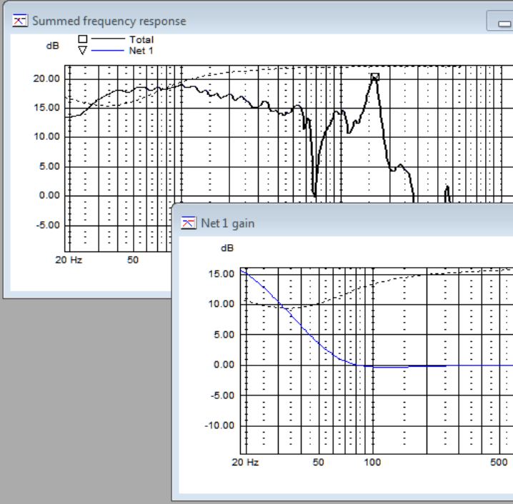

140L It makes the little XLS enclosures that I'm building seems positively tiny! Here's the first one I made yesterday.
Of course these need a large amount of EQ applied to get a decent bass response out of them.
This is why 4 of them make sense. According to simulations, 4 of them with room gain and boundary reinforcement should net around 105dB @ 20hz just meeting the THX specification, not that I watch many movies mind you😀

I do not know whether it is strictly important in keeping the vertical off axis response identical to the lateral. You can see in 18Sounds datasheet that the horns control of directivity is different for the vertical and lateral off axis. Lateral having a decent stab at CD beyond about 1500hz, with the vertical only doing so from about 2.3k. Personally I'd rather have a circular WG and CD down to 1500hz from all angles. After all it is only 8" wide in its largest dimension. I guess for outdoor venues the vertical axis upwards = the sky, so it's less important and below you've usually got people and grass/chairs etc, which'd be pretty good at scattering any reflections.

Nice little subwoofer there! 🙂 handy size if you have four of them to distribute arround the room! Actually, your calculated/ expected in-room response is not to far off from what I get with two of my "monster" subs..
The reason I'm "questioning" Monacor a bit, is that their driver line-up seem a bit to varied to come from the same factory, and I remember seing some drivers which I have allso seen elsewhere under a different brand name or no particular brand name at all.. you don't see that with Seas or ScanSpeak..
The "eliptical" disperison of the 18Sound horn is perhaps an advantage for exactly the same reason you stated.. just replace sky with reflective ceiling and crowd with floor.. 🙂 From this, I think this one actually looks more interresting than a spherical wave-guide. Perhaps the narrower vertical pattern will allso reduce rhe magnitude of comb-filtering/ phase issues between midwoofer and tweeter?
