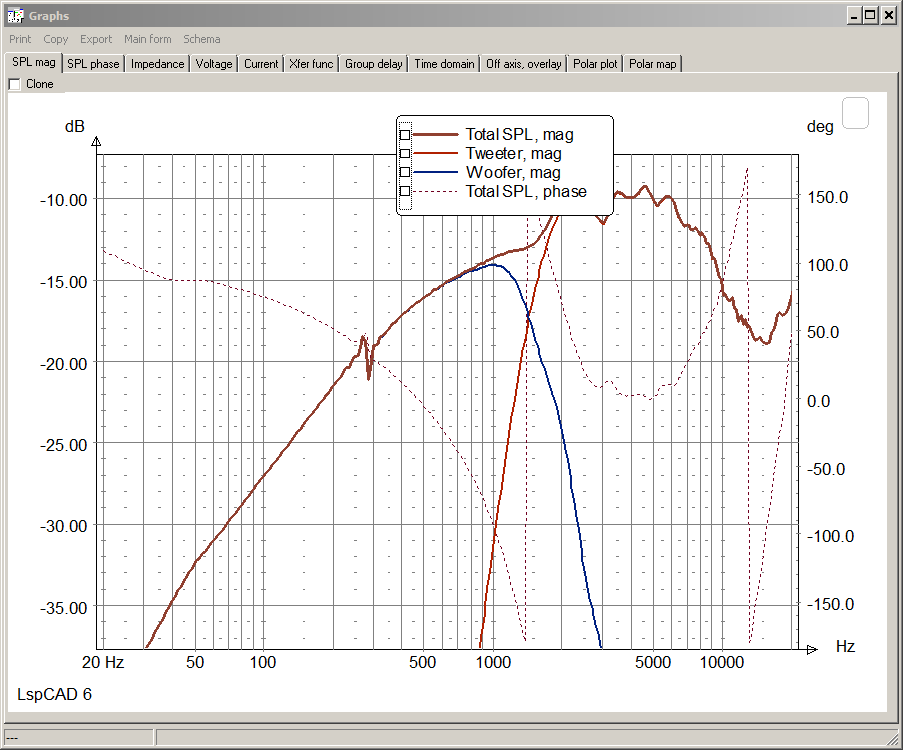

It's giving me a very flat response up to just over 10k, but then there is that dip and HF peak again..
However, looking at what this software can do, I'm tempted to throw in some additional filter stage to see if it can use that to manage this problem for me.
Having said that, it is obvious that the software worked out a fairly asymetrical set of slopes to get a smooth transfer function. When I invert the tweeter in the schematic, the reverse-null is very non-symetrical.
Should I care about this?
If so, I could perhaps add some delay to alleviate this, but then I won't have any op-amp left for an additional filter stage to tame the HF peak..
No... hang on.. I re-started the optimizer again with the tweter reversed, and after getting a flat FR again, i reversed back to Normal, this time there was a very deep and fairly symetrical dip! 🙂
So that should leave room for a filter to kill the HF peak..

What you should be doing is optimising the transfer function of each driver individually, not both at once.
Get the acoustic roll off of the mid/bass to hit a perfect 1600hz 4th order LWR acoustic target.
Then get the tweeter roll off to hit a perfect 1600hz 4th order LWR acoustic target.
After having done this, if the phase is aligned there will be a massive null with the polarity reversed.
I have to stress what I am about to say next because it is very important, you CANNOT design the phase into the simulation at its current level, for that you need to do something else to 'calibrate' the system.
This can be a chore to do and is one reason why using the delay network is so nice, because you simply fiddle with it, measuring in real time time, till you get your reverse null.

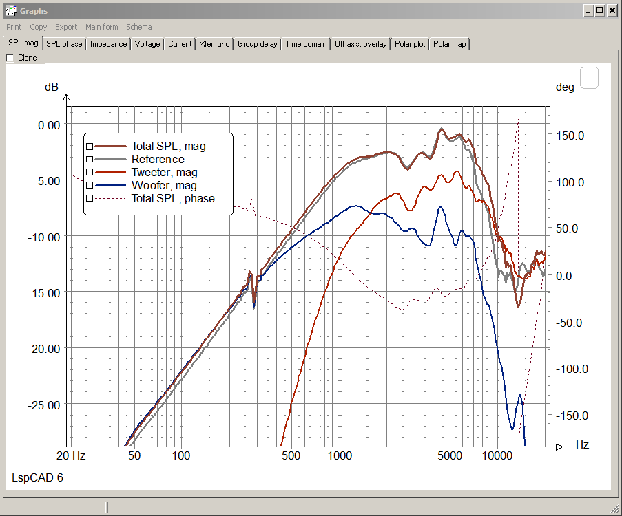

The DXT lens on the tweeter adds in a hump of gain that starts at around 12khz and then extends down to where you want to xover. What you want to do is remove this hump in some way, either through a passive filter or an active notch.
I have attached a passive filter that I use on mine. The component values aren't optimised as I cobbled something together out of the components I had lying around. It works however. My active crossover then changes that response into something useful.

I've been letting LSPCAD do its thing with my drivers for a couple hours now. Still optimizing, finally got the crossover near the target. I guess I gave it too many things to play with.
Things went much more quickly with Frequency Allocator, tweak and measure. LSPCAD would make it easier to design the analog equivalent of my digital filter, though.

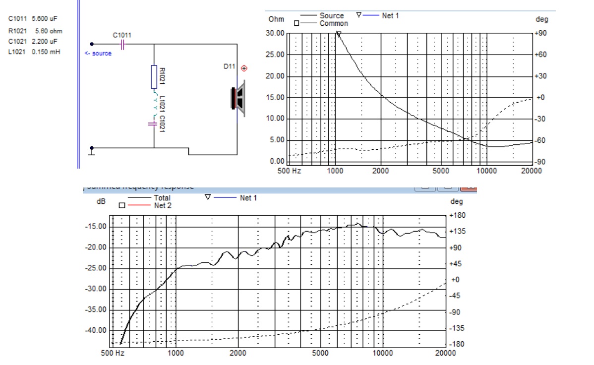

I guess I'm setting my goals too tightly. I limited the variables to one R and one C in a unity gain Sallen-Key filter (fourth order filter, target LR4 from 700-4000 Hz 6.4% step) Started with the values I used that matches the target and sounds pretty good and let it run overnight. Still going 10 hours later. Does this ever stop?
Elbert, neither of your posted responses look very attractive. When I was working for flat response I saw some very flat curves initially then it gave me curves like yours as it drove component values to zero and infinity. Are the curves using 5th's notch filter?
I agree, the curves are ugly..
They are with the raw responses and the x-over (as buildt), no level adjustment between drivers.
I just used this to throw in a series cap with the tweeter to see what happened.
Based on this, I decided to throw in a 12,9 uF cap I had, thus giving me some tweeter protection and at the same time smoothing out the tweeter response a bit.
I've now taken some raw measurements with the cap in place and I'm working on getting this in to Lsp Cad as per 5th's instructions! 🙂
Once that is done, I'll hopefully be able to tweak the x-over to get some workable results! 🙂
I must say that this software seems very usefull, will certainly save me from trying and failing a lot, not to mention wearing out the solder-pints on my board! 🙂
It doesn't look like this thing ever stops.. seems like it gets to a point where it gets fairly close to a target response and then just keeps mkaing minor itterations. perhaps this happens because it runs out of range on certain components?
here's a plot with the drivers raw responses, the total raw response of the speaker (grey) and the summed driver raw responses in red.
Looks like the summed and reference plots agree pretty well.. tried to adjust woofer/ tweeter positions in the Z plane but that seemed to do little and did not improve the match between the plots.
allso tried to adjust the woofer position in the Y plane corresponding to its baffle placement relative to the tweeter, but this gave for a lesser match between the target and summed curve.
Annyway, I assume that the repsonses now upploaded in LspCad are suitable for further work optimizing the filter slopes.
Yeah it never stops because nothing ever tells it to. The step size governs how much it will change any given component value per iteration. To that end you can set the step size higher at the start of an optimisation process and then, once the curve fits decently, you can reduce it to get a better fit.
If you want to try a different measurement program you can give ARTA a go. I've used Holm before myself and although it can do what ARTA does, ARTA is easier to use, especially when setting your gate and making repeat measurements.
Hol impulse seems to work quite nicely for me, and since I've allready got it up and running with a mic calibration file and everything, I guess I'll stick to it for now! 🙂
Just did the LP section ,entering a target of 1600Hz 4th order LR, locked the level to -5db and set the range to 500-5000 Hz.
Seemed to do the job quite nicely?
I allso added some gain to the woofer to bring it up to level with the tweeter.
Now I'ts time to see if I can get a HP slope for the tweeter that will sum with the woofer..
