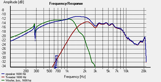

Well, now the board is soldered up with new resistors for 1600Hz x-over, so I should get back with a fresh measurement in a minute or two!
That sounds rather exotic! 🙂
Looking good. It would be beneficial to expand the vertical scale. Baffle width ~9"? That's the diffraction bump just before the roll off. Another reason to cross low - you don't need to mess with it. 😉
My filter is 4th order with a DEEP notch ~an octave away from the pass band. The initial roll off approximates LR8 to 60+ db down then bounces back up to ~-50 dB. Beyond the notch it is pretty close to LR4. Group delay is closer to 4th order than 8th. I got the idea from Jon Marsh over at HTGuide's DIY forum. He did it passively by adding a couple of parts to a 4th order filter.
Sure,

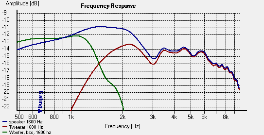

Here's a new plot attached zooming in on the x-over area. I had less resolution on the last plot so that the extension of the break-up region would be visible.
Well, the baffle is 22 cm wide, so closer to 8 inches then. But yeah, good point about the difraction bump, looks like we got that under controll as a bonus! 🙂
Looks like the actuall -6dB point, as a function of woofer roll-off and filter slope, landed well on just over 1600Hz.
Now, the big question is what crossover to choose for the tweeter filter to get a combined response that matches best??

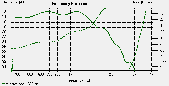

From the woofer measurement, I have what to me seems like a fairly decent 4th order slope.
Looking at the SEAS and Zaph measurements of the DXT, it looks like there is a 2nd order roll of from about 1500Hz and adding a 2nd order electrical on top of thatshould yield close to a 4th order slope. But, are these measurements performed with some sort of filter to protect the tweeter? if so, the plots do not represent the true roll-off of the tweeter...😕 I can't find any details on this ont the respective web-pages..
I donæt know if it is possible to sucessfully match a 4th and 6th order slope, but matching two 4th order slopes seems a safe way to go! 🙂

So, more testing..and some more graphs with woofer, tweeter and combined response.
The first thing I notice is that summation gives a 1 dB hump at the x-over area. in it self not that much, but when bringing the tweeter level up, this will increase..
I see two options here, moving the x-over frequency of the tweeter up a bit, or changing from 2nd order to 3rd order filter slope..
I allso included a plot of the phase responses, not that I can make much out of it, but perhaps it gives an indication on how to best approach the summation hump??
Just listening to the speaker, the HF droop is of course obvious and the sound is a bit forward due to the 1-2 Khz lump. Apart from that, there are no immediately obvious issues..

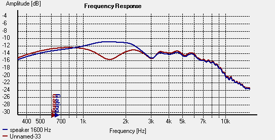

Here's the measurement with switched tweeter polarity.
No deep null or anything.. but rather having a 1-2kHz bump, there is now shallow droop around 1,5k..
What to make of this?

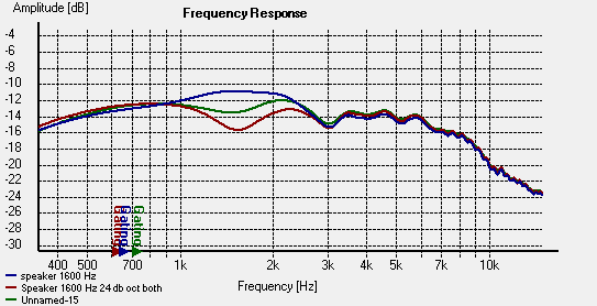

I decided to try 24 dB/oct on the tweeter, and that was not a bad idea..
Due to the steeper roll of, I got a slight dip around 1500Hz as opposed to the previous 1-2kHz bump.
Something like this was sort of expected due to the steeper slope.
Playing some music, this actually sounds noticeably better, a hint of "shrillness" seems to have disappeared.
As such, I could probably be happy to leave the x-over as it is.
If I am to try and remove this dip, I see two options; lowering the tweeter x-over slightly, or adjusting the Q of the filter a bit.
As I have trim-pots in place of the four resistors in the HP filter, I have good opportunity for tweaking a bit. Lets see what can be done..
Changed the x-over frequency of the tweeter to 1450 Hz in order to try to fill out that dip.
The result can be seen on the green graph.
The dipp filled in nicely enough, but I allso got some gain at arround 2k.
this stil sounds better than the first attempt (blue), but some of that shrillness is creeping back.
So far, the red curve sounds best.
I think I will therefore leave the tweeter x-over at 1600Hz, and perhaps increase the woofer x-over a notch to see if that can fill out the dip without giving that gain at 2 Khz.
