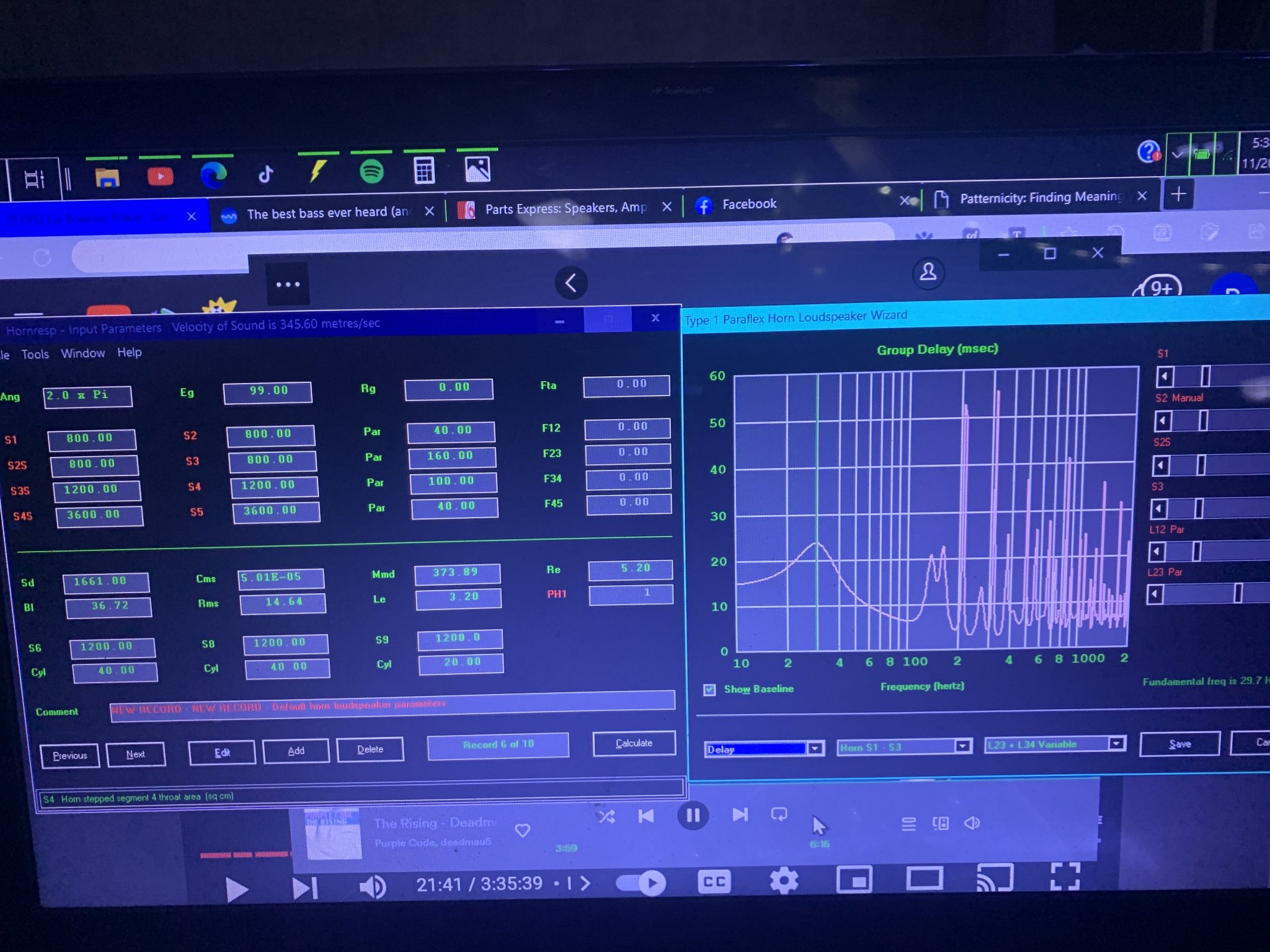

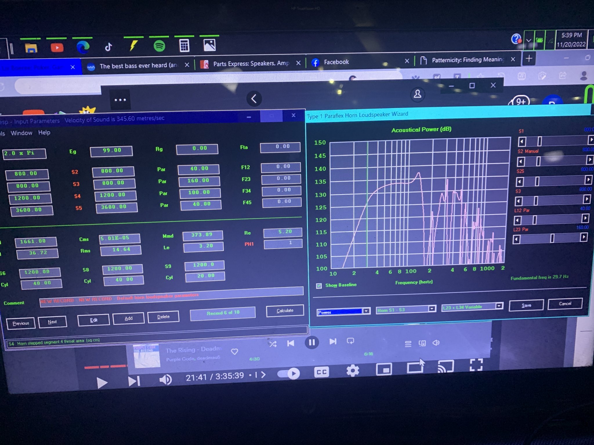

Re delay, even with critical damping, the low tunings required to meet my goals make for high GD around/at/below tuning, but the lower the tuning the faster the decay, so by the time it gets up to these various frequency 'limits' its decayed to well below our hearing acuity and if sims are to be believed, right down there with sealed, so in the scheme of things, 'much ado about nothing'.
Time to move on.

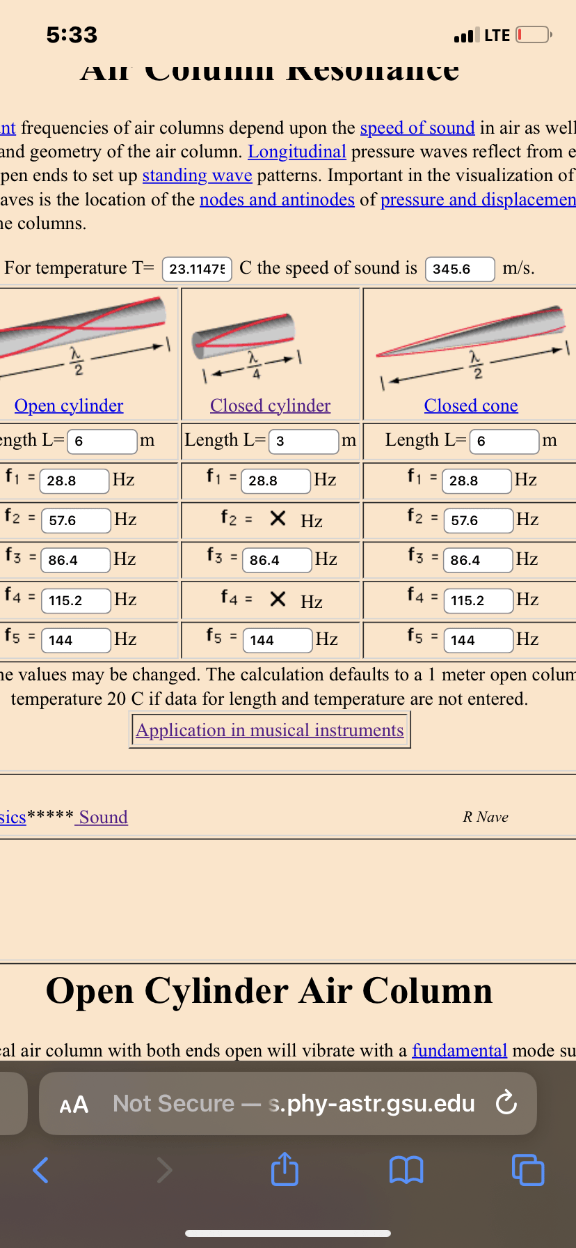

Notice the 300cm :100cm ratio (odd harmonic?) 28.8/86.4hz…. Fix. Then it sh!ts the bed at 5/4(144hz (60cm?))Im so confused…. Some of the ‘worst’ designs have no group delay

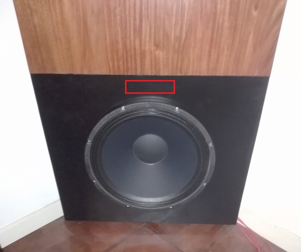

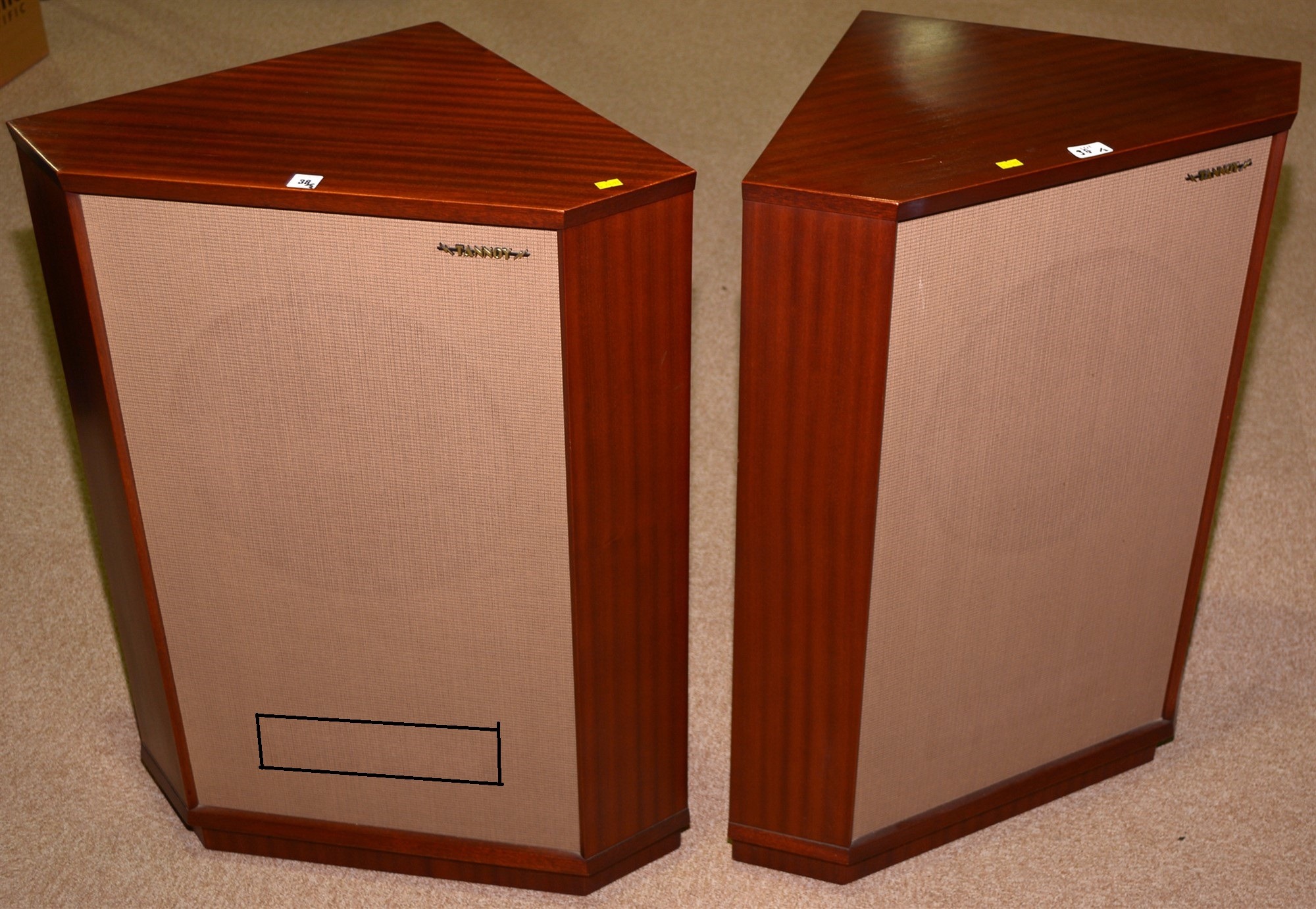

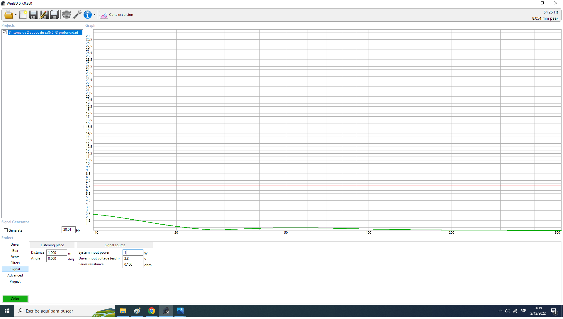

Regarding / the tuning tubes, I have found that the "vintage" option of "groove" (similar to the one attached) would be the easiest option to locate, (but not to build, the tubes are bought ready-made, here you have to work , but it won't be a problem for me )
one slot above and one below the speaker, 2 x 8 x 6.73 cm deep.
It would be the best practical and aesthetic option, I have played with the dimensions and Win ISD shows these results as the most convenient for this prism.

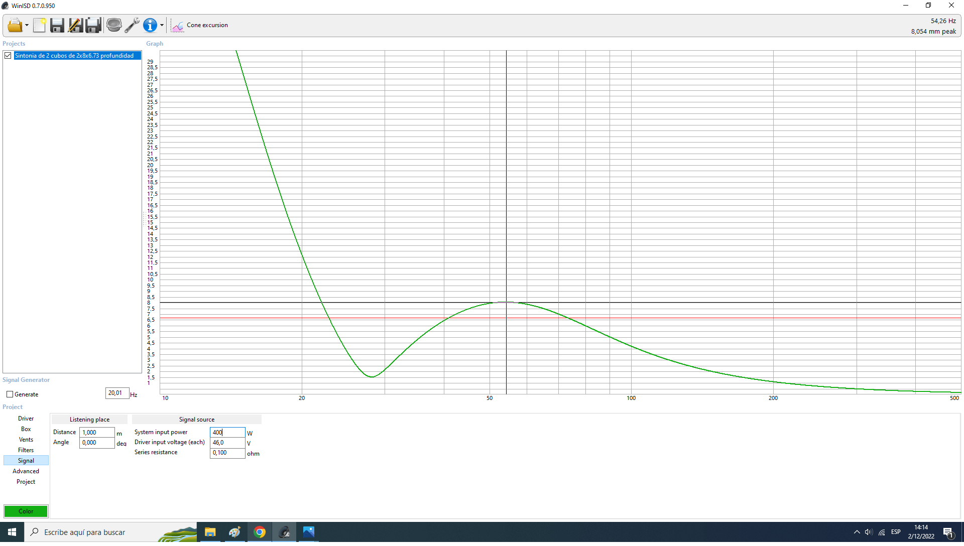

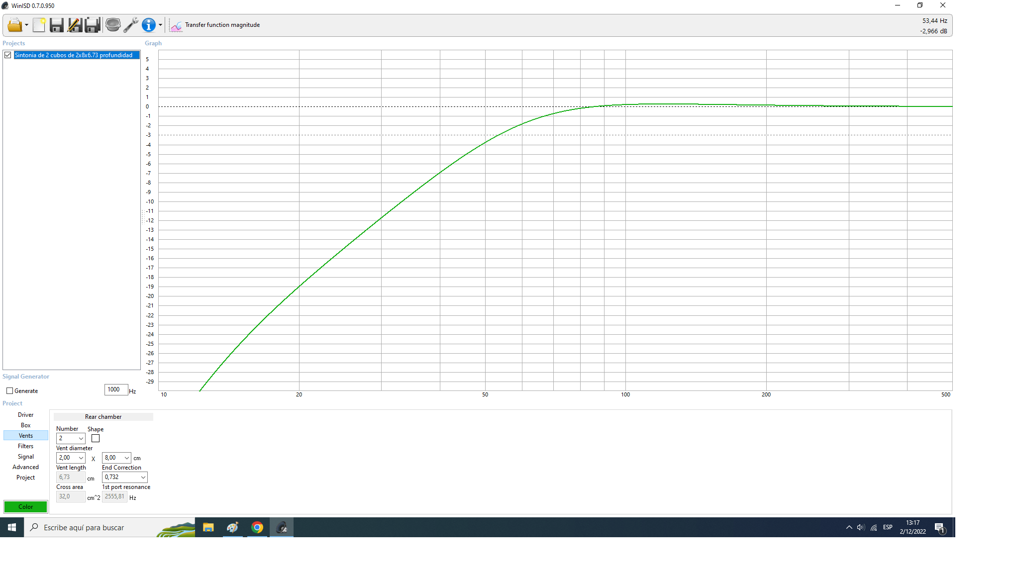

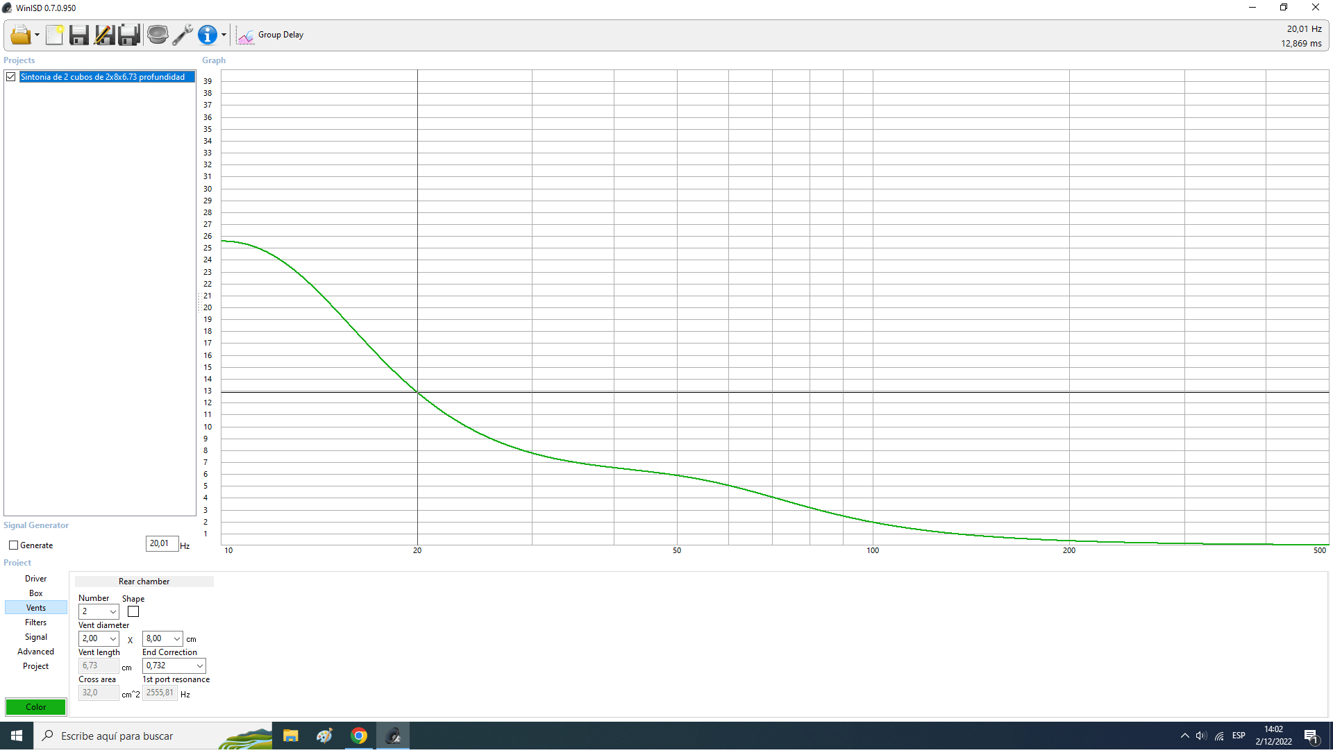

Tuned to FS of the speaker (28 Hz), 122 liters shows an F3 of 53, 44 Hz (better than sealed), the group delay playing 20 Hertz is 12.8 ms.
That can't be changed with DSP or EQ, but who cares if it's not audible? On the other hand, the 6.7 mm Xmax is only exceeded by applying 400 watts, being 8 mm and still does not exceed the 15 mm of XLim.

'Groove'? Are the vertical slats box vents?Regarding / the tuning tubes, I have found that the "vintage" option of "groove" (similar to the one attached)

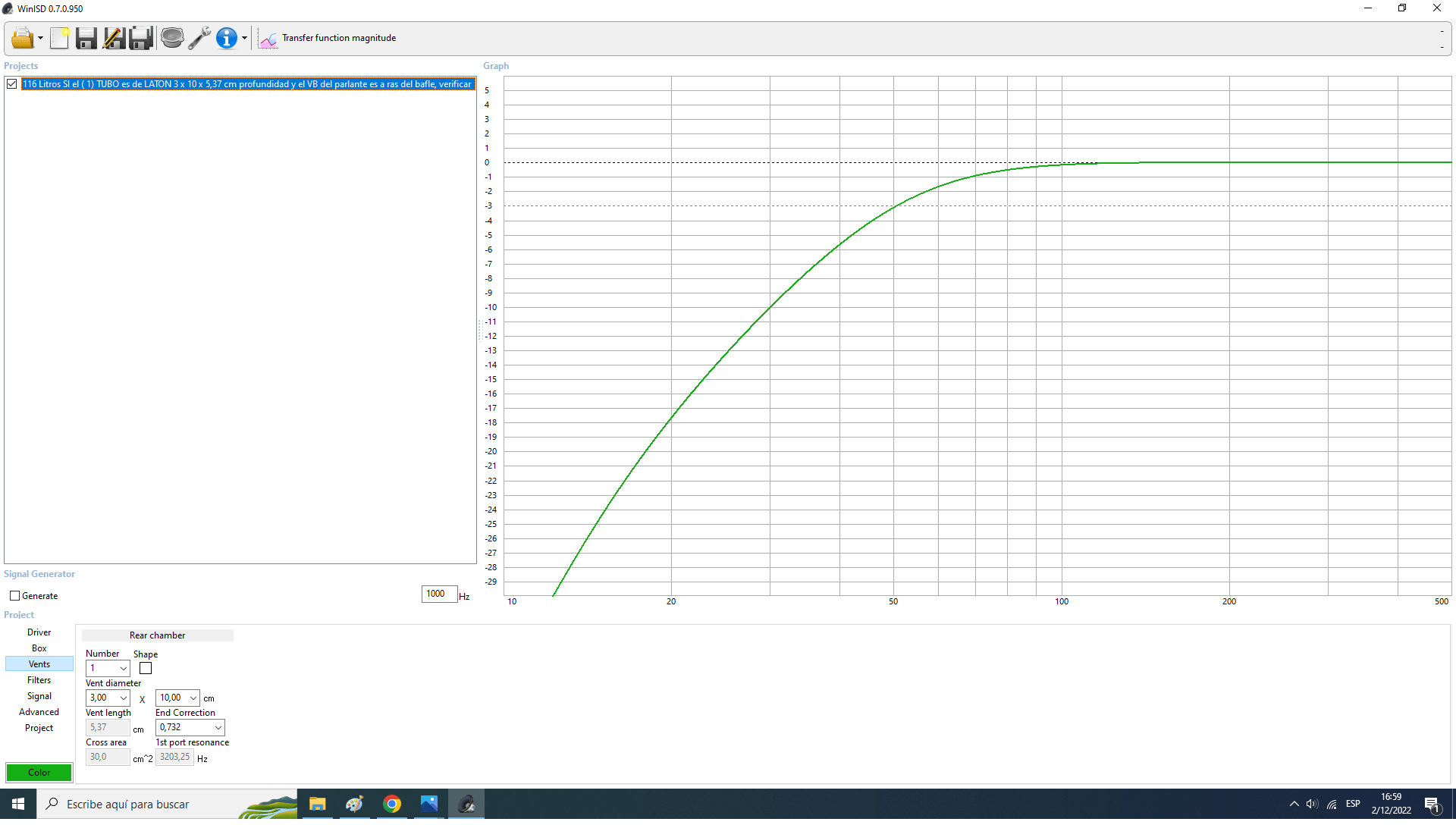

Here is the answer, I think it will be even better, a single box tube above the speaker does not interfere with the bracing and has excellent air coupling between the inside and the outside. I have a question here, if I build it with wooden plates I should discount the thickness of the same to the total volume, correct? If so, it will be better to build it in brass or PVC of minimum thickness...... 🤔
If I'm following, you subtract all the volume of the vent inside the box as if it was solid. Any particular reason you don't want any vent/floor loading to shorten the vent for a given tuning?Here is the answer, I think it will be even better, a single box tube above the speaker does not interfere with the bracing and has excellent air coupling between the inside and the outside. I have a question here, if I build it with wooden plates I should discount the thickness of the same to the total volume, correct? If so, it will be better to build it in brass or PVC of minimum thickness...... 🤔
1) I am not subtracting the volume of the vent, I am only introducing the net liters, discounting the volumes of the prehistoric stone - which I will remove -, the speaker and the bracing (the latter is not too precise because they are quite irregular shapes (ha, exotic? ) and I assume that WinIsd calculates the final dimensions of the vent taking into account that the cubic volume of the vent tube should be calculated in such a way that it gives a result corresponding to the litrage entered previously, but maybe I'm wrong...... 🤔

2) There is no particular reason, only that in the bibliography that I have read they recommend that the space between the tube outlet (it does not matter what section it is, round, square or whatever) and the adjacent walls and/or floor it must be generous and in my case it is barely an inch.
It is for the same reason that moving a back-vented cabinet too close to the wall is not recommended.

Well, it must be 'generous' if the program doesn't calculate a near/at floor, wall end correction that shortens it. 😉
Humm, I guess I won't go further than the results that Win Isd shows for my project. Your attachment clearly shows that the duct located in the position I chose has the same Q whether it is circular or square in section, this is 0.732. But if you have a definitive and superior result to help me, since you are so good with math formulas and I am not, could you calculate exactly the duct for me? Think of it as your own project. You have all the data you need, if it is not clear, just ask me ! 🙂
Yes, you're fine if WinISD is accurate enough, I was referring to when near a solid boundary where depending on its size/shape can significantly shorten it.
