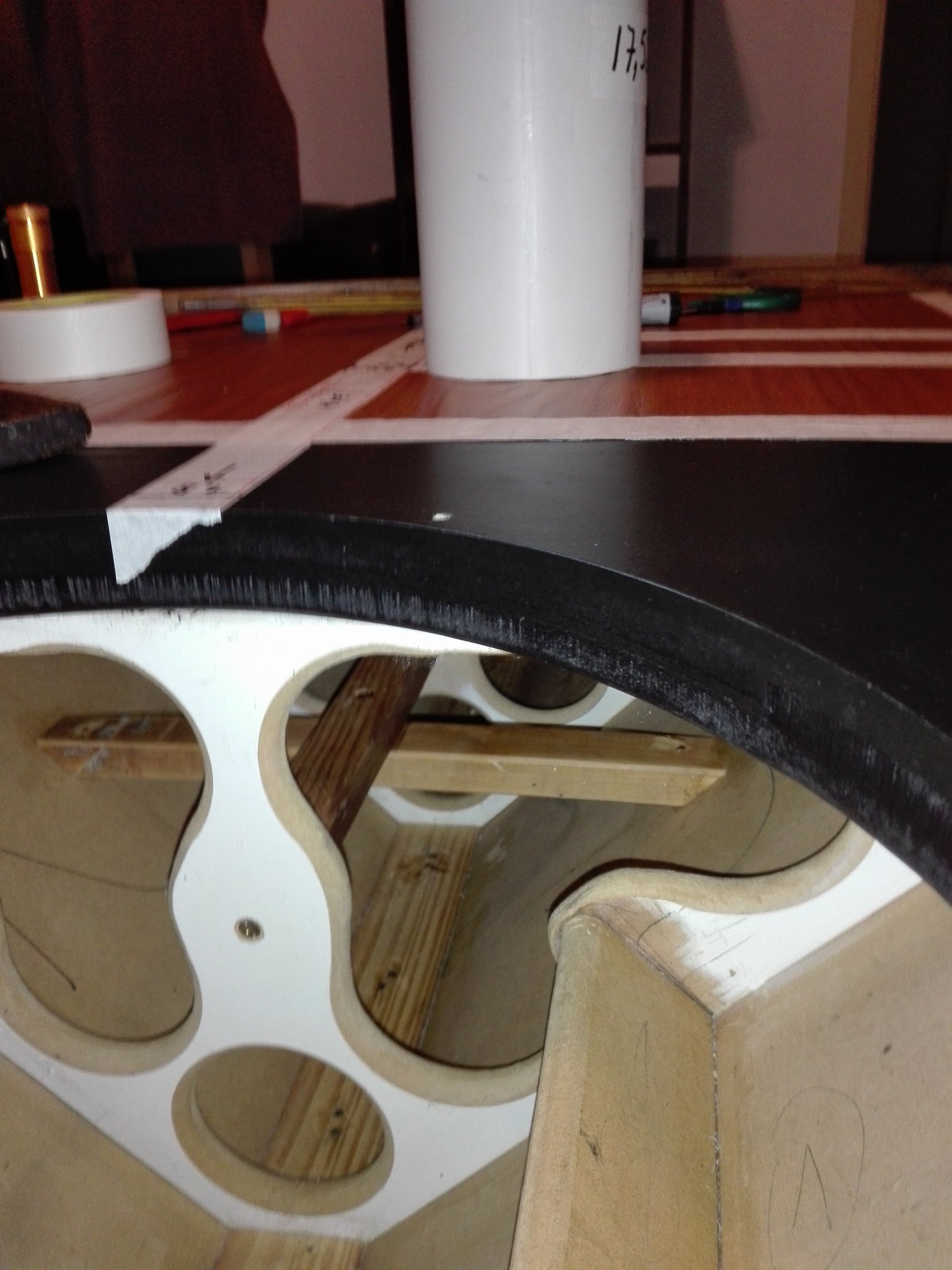

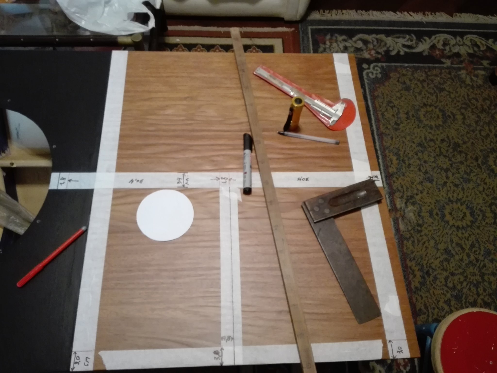

Would using multiple ports of smaller diameter be an option?
Answer
It is not valid, this is the best, I have already explored it, thank you.
The problem is that it is a prism-shaped box with internal bracing that is best avoided, and the more ducts you use, the diameter gets smaller but the length increases a lot.
