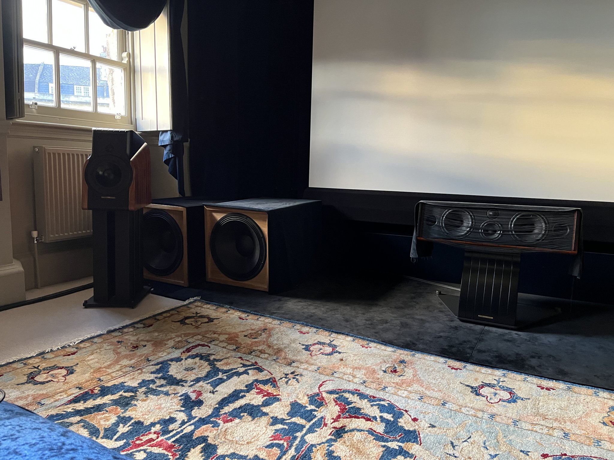

My 18's tucked away (I'd move one to the opposing corner but cant in the current room as its a door way)
I am glad my wife is understanding of my hobby.And cover up that hideous round black 18" monster ! 😒
A single 18" woofer never hurt anyone.
If it's that difficult you can always try to "bling it up", apply some gold paint or real gold leaves if that helps.
I might go for copper or bronze, that could be fun.

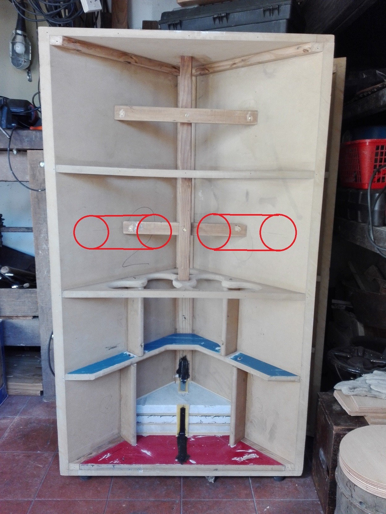

My answer is a no, no, no, to everything you say. I use boost DSP ( Post 37 ) for the sub-bass, progressively
from 80hz all the way to +12db at 20hz.
The result is very good, I have already said it. I want to play a bit with a BR, I have already explained the reason. In the Eminence specs this subwoofer is listed as N/A for sealed. Why with an EBP of 84 do they rule it out for sealed? Well, J.M.N from Eminence explained it to me, they created this short Xmax subwoofer and a 4-wire VC to achieve a lot of "punch", the range that guys like in clubs, and hold a lot of power. That does not mean that I cannot use the part of sub frequencies that interest me.
DSP corrects the drop, whether sealed or vented, and obviously, the reinforcement in the BR will be less. If something goes VERY wrong (boomy bass? well I don't think so, I bet), plugging a hole in the base will be very easy. By the way, your opinion about the location that I proposed about the tuning tube, what is it?
In post #59, you wrote "My expectation is to use the converted BR subwoofers without any DSP or EQ".I use boost DSP ( Post 37 ) for the sub-bass, progressively from 80hz all the way to +12db at 20hz.
Your 28Hz Fb BR simulation only predicts 3-4dB gain over the sealed cabinet, the BR with -8 dB LF level would sound quite thin by comparison to what you have become used to without the LF EQ boost.
If you are set on no DSP or EQ, I'd suggest a higher Fb of around 36Hz so the low end does not drop off so much.
"Boomy bass" won't be a problem with your proposed BR alignment.If something goes VERY wrong (boomy bass? well I don't think so, I bet), plugging a hole in the base will be very easy. By the way, your opinion about the location that I proposed about the tuning tube, what is it?
Over excursion and the resultant vent noise and added harmonic distortion when driven below Fb may be a problem if you don't use a HP (low cut) just below Fb.
A port exiting on the bottom of the cabinet is OK, though the floor and back walls effectively become part of the port length unless the cabinet is raised to roughly the port diameter, probably higher than you may want for appearance sake, especially if using an adequate port diameter to keep vent velocity in the <20 meters per second range.
I'd suggest using the rear corner location for the port.
You could use higher Fb (shorter port) and then lower the cabinet height to tune lower.
Have fun, and like chess, try to plan your moves ahead!

Something like that?, the calculation will be quite complicated since the ends are at an angle.....In post #59, you wrote "My expectation is to use the converted BR subwoofers without any DSP or EQ".

I didn't say that I won't use DSP, I just imagined that maybe it wouldn't be necessary, because there will be a lot more gain in BR, (6 db between the two cabinets + the room gain in the corners) but having DSP is an advantage that I can't ignore if with this I achieve a good result.
Here it says that for an 18 "speaker the port must have a minimum of 8 inches of diameter !!!
This is getting too complicated...
https://www.subwoofer-builder.com/port-flares.htm
