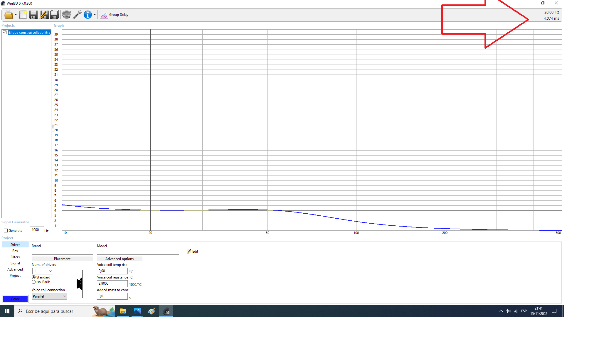

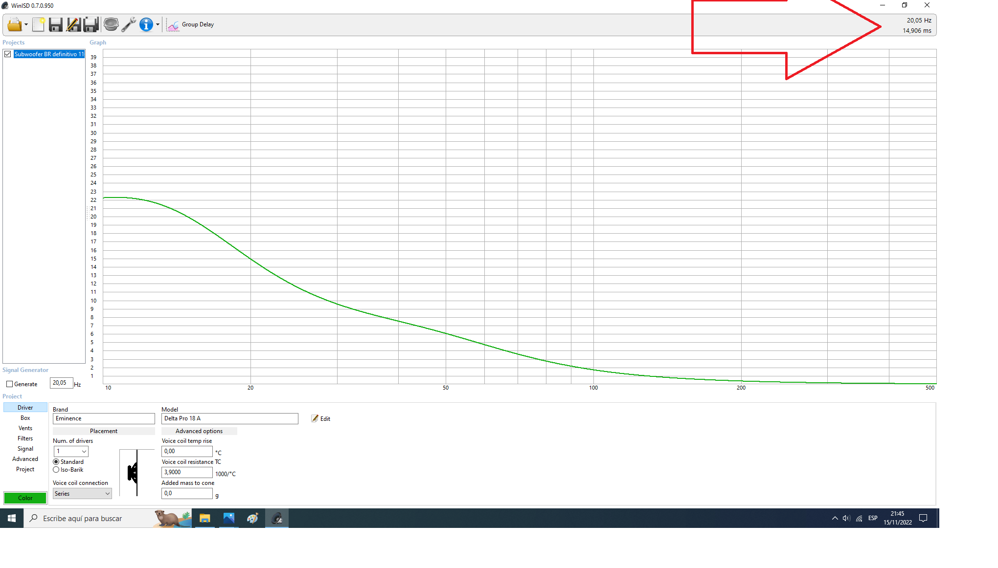

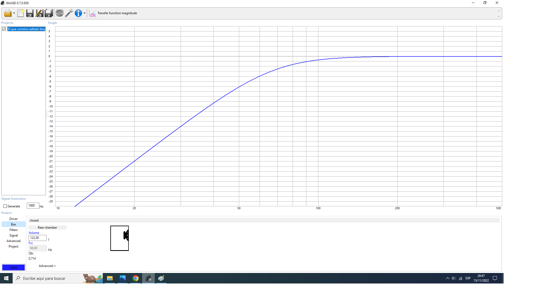

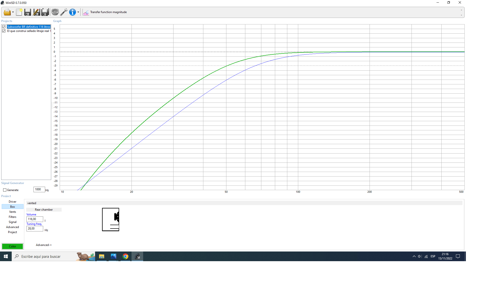

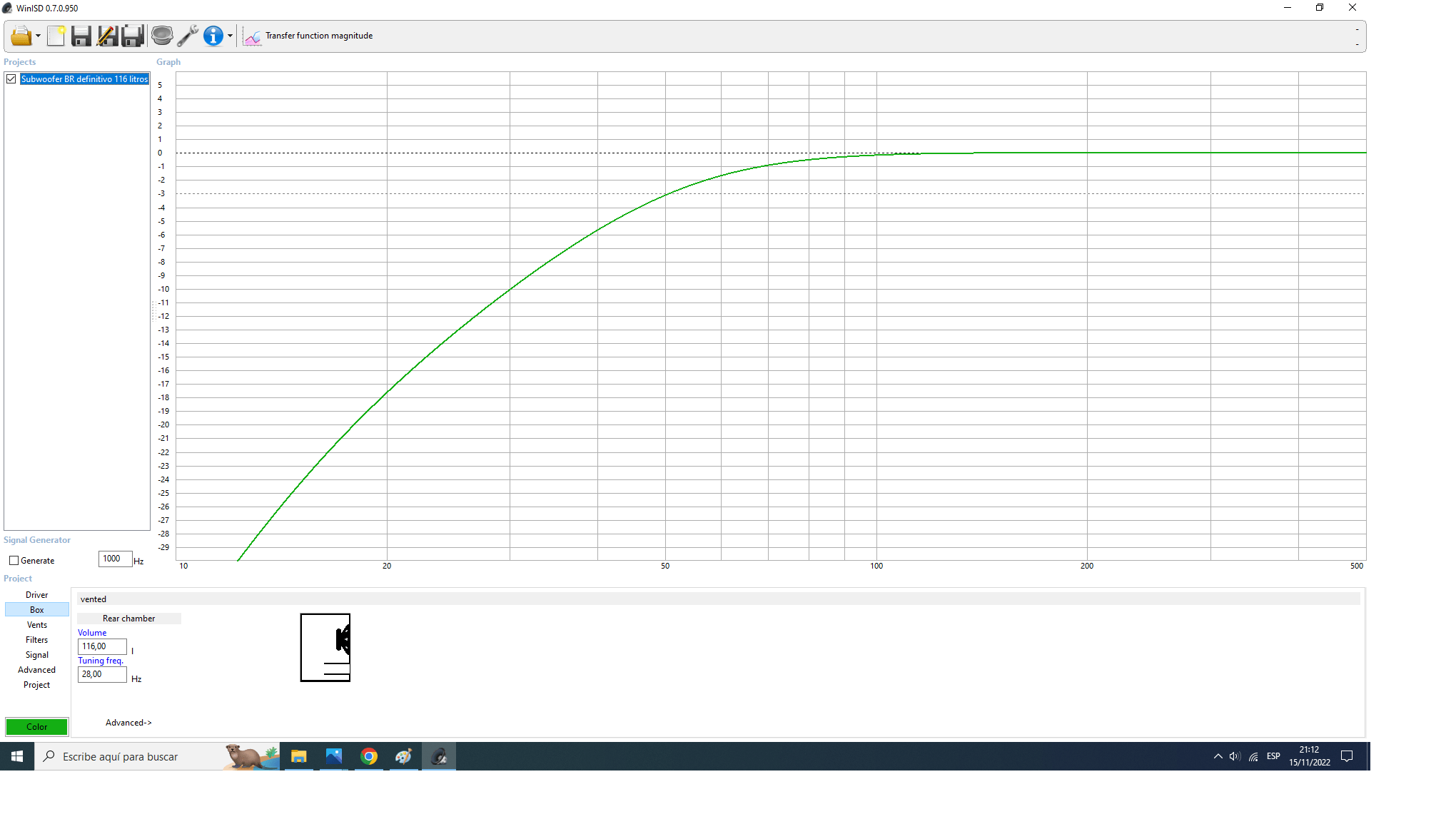

Sealed subwoofer to bass reflex, what do I gain and what do I lose ?
The second cabinet is finished and working. As you can see in the photos, the subwoofers are left and right. The tuning tube and connectors were placed with that in mind. The Behringer amp needs to deliver much less power than before, as I had already anticipated. The two BR subwoofers working together playing Bach's Tocatta and Fugue .....wonderful ! , better than before, more harmonics and zero distortion, ....well, I wish you guys could hear it, but since that's impossible, you'll have to believe me - or not - 🤔 ......
