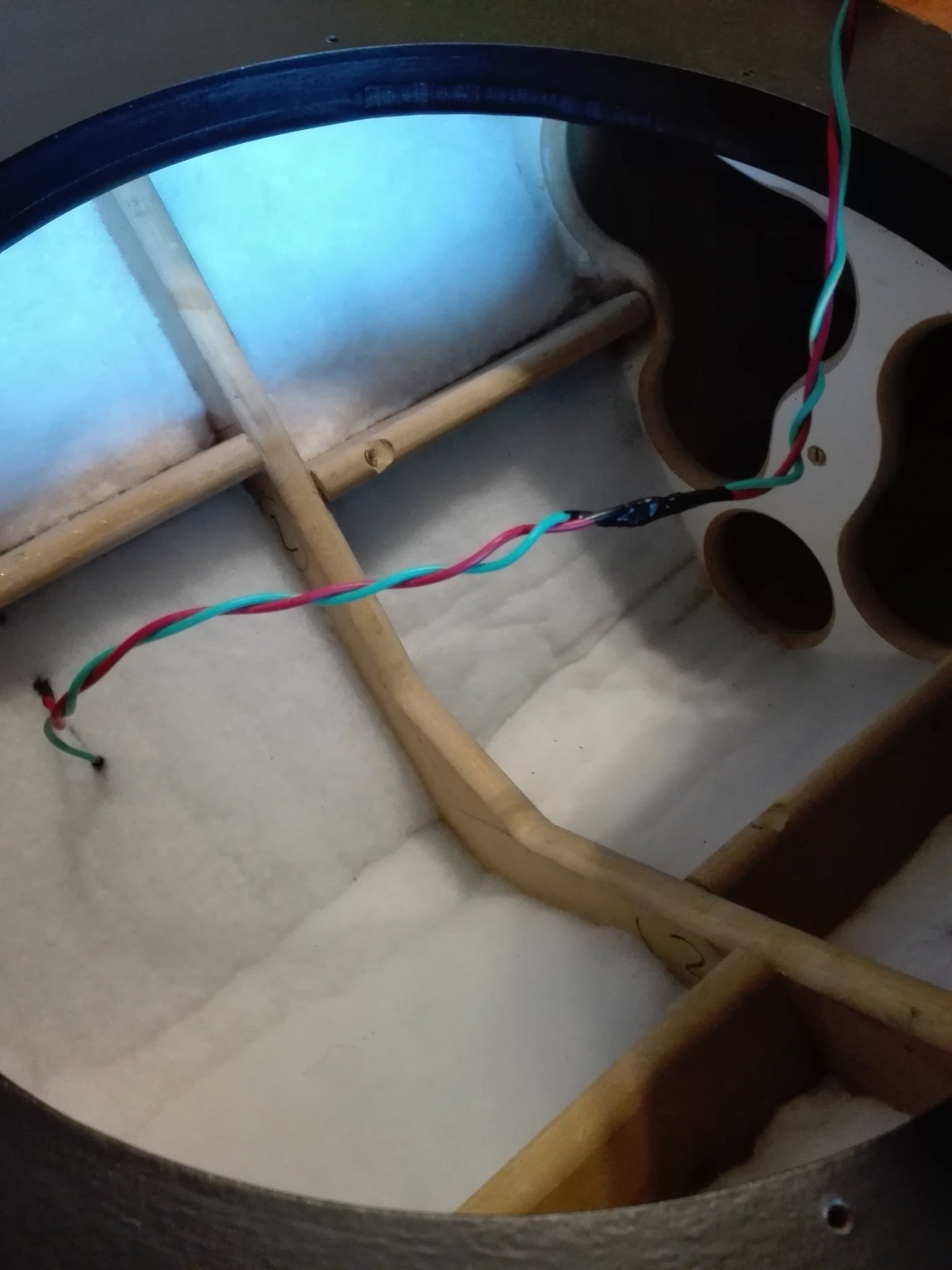

Do not use fiberglass!I plan to cover ONLY the bottom side walls with fiberglass
Use rockwool or some kind of felt, melamine foam or whatever else like old fleece sweaters or something, why not re-use the polyfill?

I figured I could improve the response by changing the fill to something else. Whatever I did resulted in less extension and did nothing to reduce peaking in the mid-bass, much to my amazement.
So the scant layer of whatever it is went back in to stay.

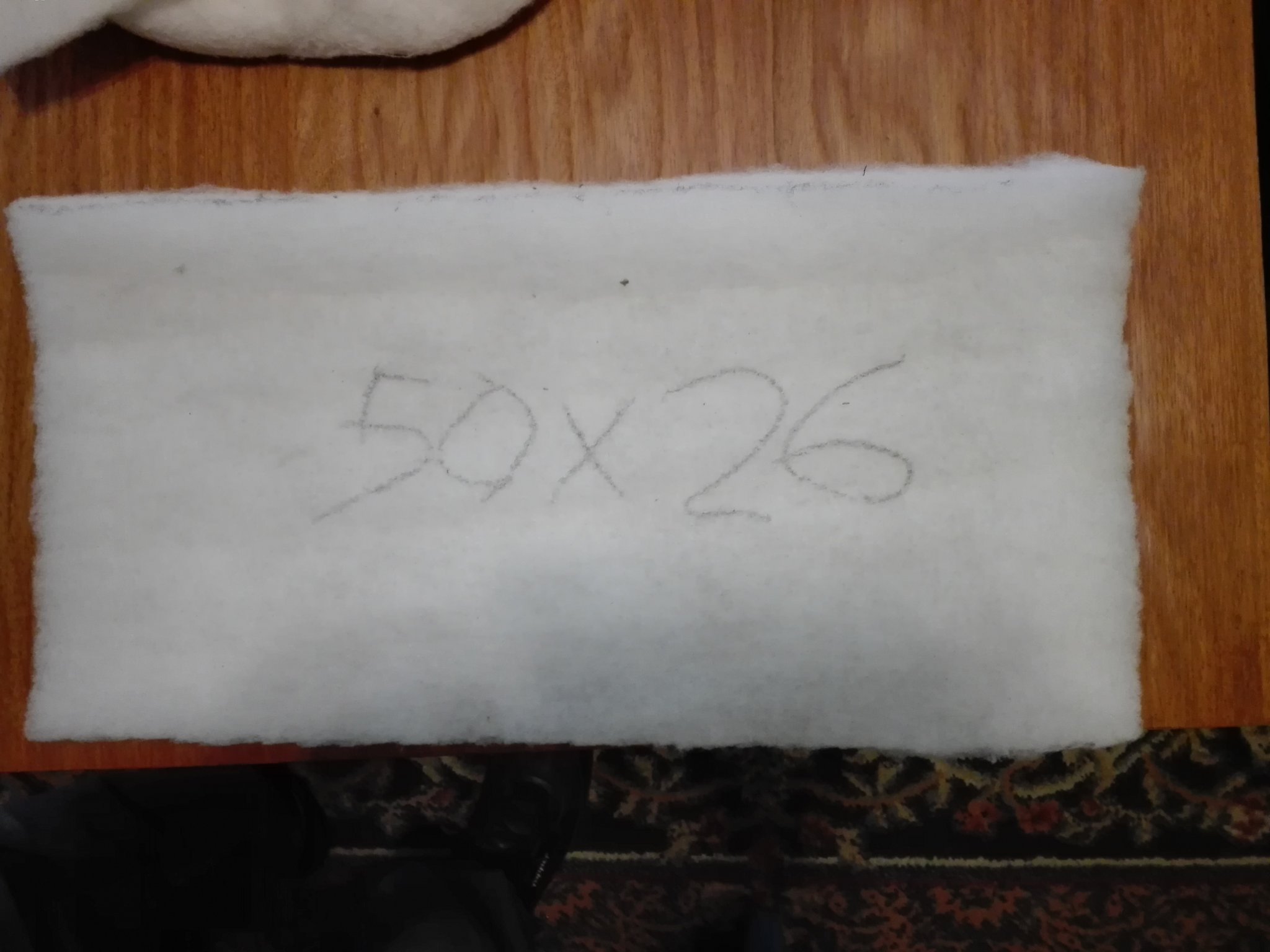

Thanks for the advice, I wrote that because I was actually thinking of glass wool, not fiber, (I always get confused) which is not so brittle and volatile, with the known risk of being inhaled into the lungs. The issue that it is carcinogenic, I leave it to discuss in another thread, JBL recommended it and used it regularly in its commercial products, I even used it in my vintage DIY coaxials of that brand, I have been listening to them for 40 years and here I am. Although I try not to listen to them without the protective cloth frame since they are BR, ha..... 😀Do not use fiberglass!
Actually, I had the idea of using a roll of discarded glass wool that I kept from a reform of the roof of my house, - it is used as acoustic and thermal insulation -, but I examined it and it also falls apart quite easily when handling it, and the strands can fly into the cabinet and enter the breath of the VC of the speaker. So it was discarded and it went to the municipal dump.
Answering my own question from my previous post, in the subwoofer frequency range, I don't see much using these dampers. Another hotly debated topic, I know, attached two interesting thread. But finally I placed it only in the lower compartment, on the sides of the speaker and the base. ( I have no " back " on this prism , which helps to lower the resonances of the box )

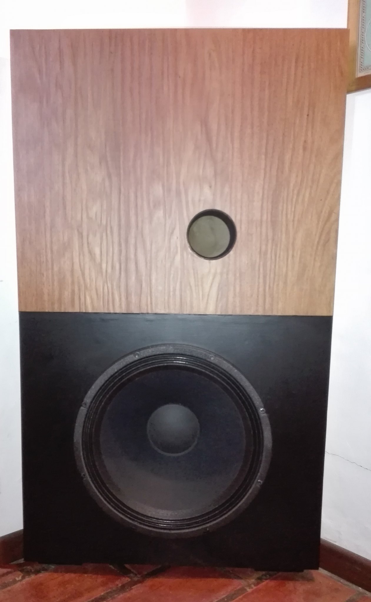

Ok, one of the subwoofers is done.
I have been comparing performance with a 30hz tone and music with low note content, sealed against bass reflex.
It is what I was looking for! Now there are more harmonics and before the reverberation time was too short for my taste. So I am very happy ! 👍 😊 , and the modification of the second cabinet awaits me. It would be easier.

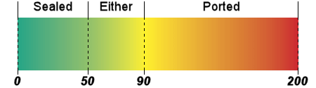

When I chose to use this driver for sealed, I should not have gotten so excited about the group delay, and paid more attention to the following:
1) Eminence never recommended this speaker for sealing with their EBP=84 , that should have alerted me.
2) In this chart that made me make a bad decision, 84 is much closer to the BR zone than "either" .......😒
https://www.diyaudioandvideo.com/Calculator/SealedVsPortedSpeakerBox/

I can't help but notice that there's a large blank open area that could hold an entire second woofer...
You are keeping the same drivers as before, right? Then you can easily switch back to what you previously had by plugging the port. If the mood hits you.

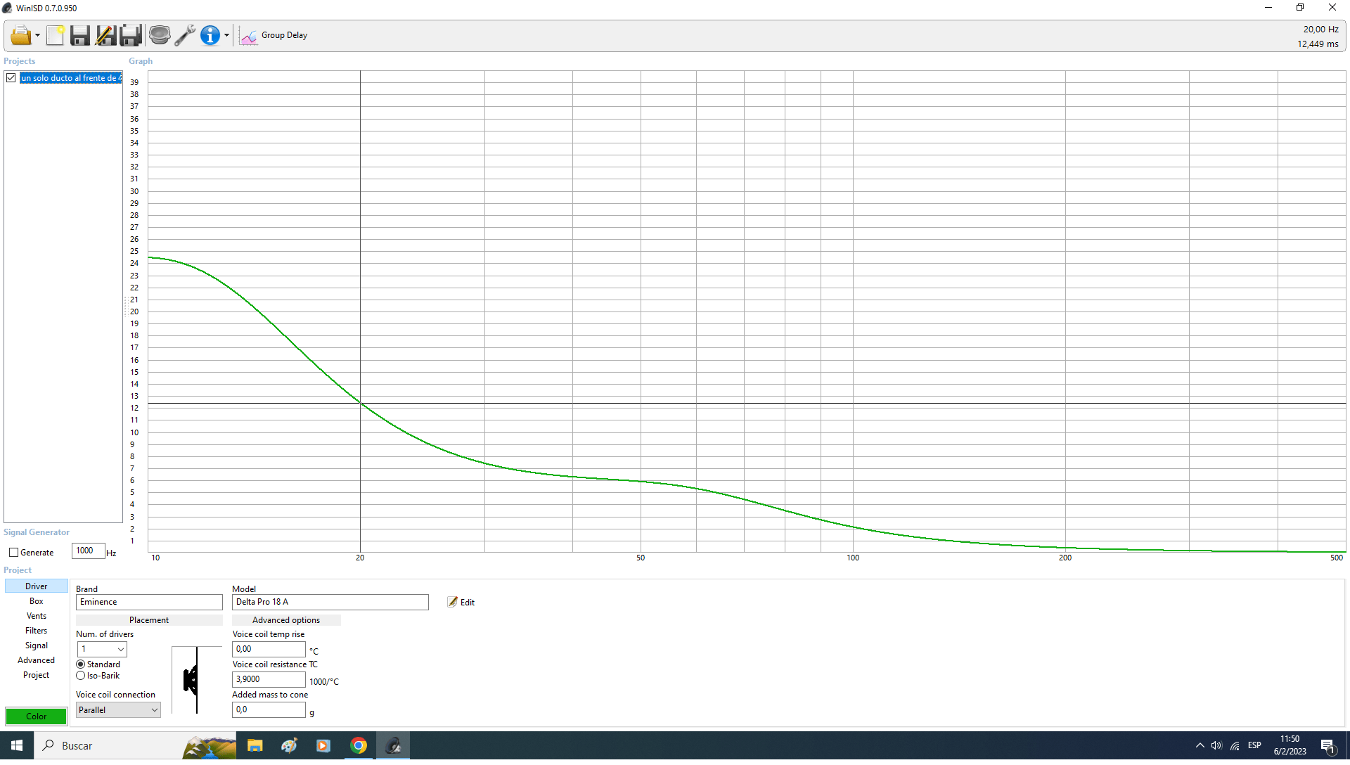

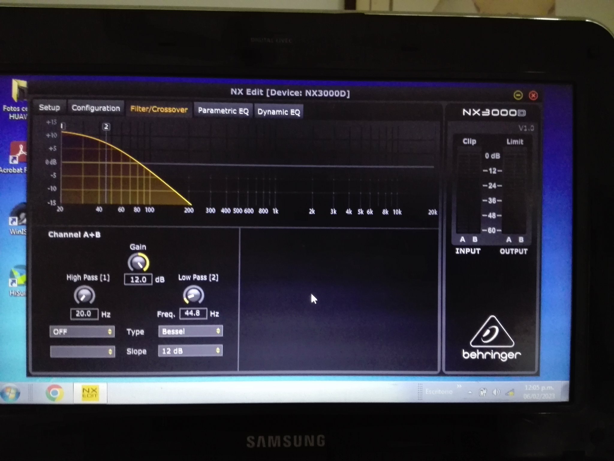

I do not perceive any distortion that can be attributed to a GD, I already mentioned 20 Hz before, in my construction it is 12.449 Ms.
These subwoofers were built to listen to the lower octaves of the musical spectrum.

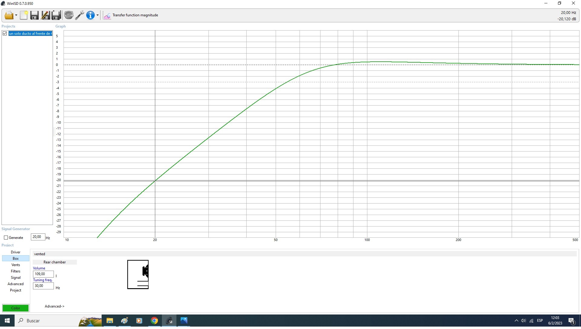

The loss of -20 Db at 20 Hz with DSP is compensated, + 12 Db is the maximum that the NX Edit software allows me, attached graphics. In addition, we owe other extra Db from the second sub. With only one (the BR) the room is flooded with clean and well-defined bass.
I never intended for there to be "punch", but it does, and lots of it, that's what this speaker was made for, I've tested it.
But, that doesn't interest me, and if one day I want to make a danceable disco in my house, I'll just modify the FR with DSP, ha, I don't see it as possible, I'm playing the extra time of the game.
