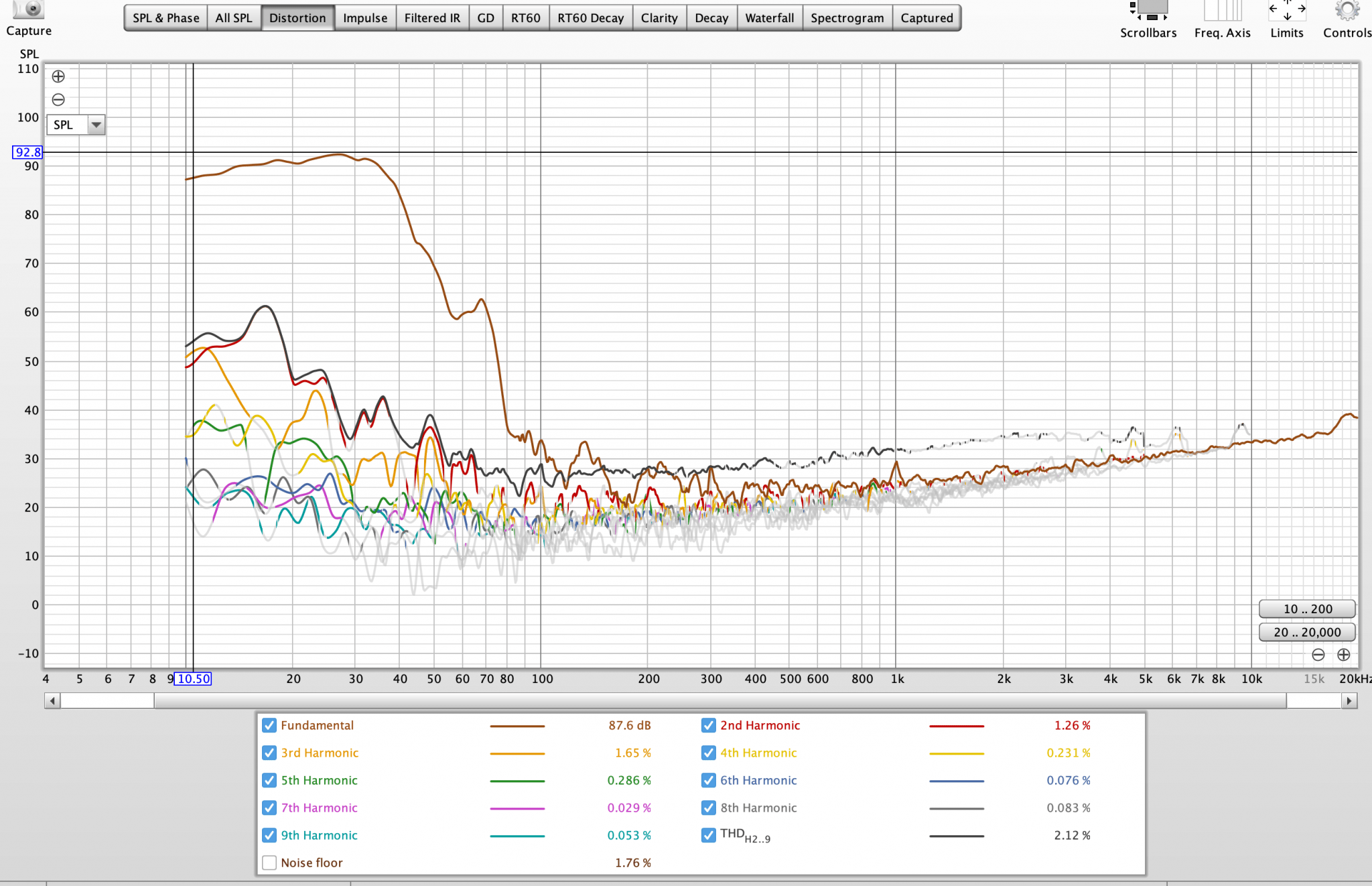

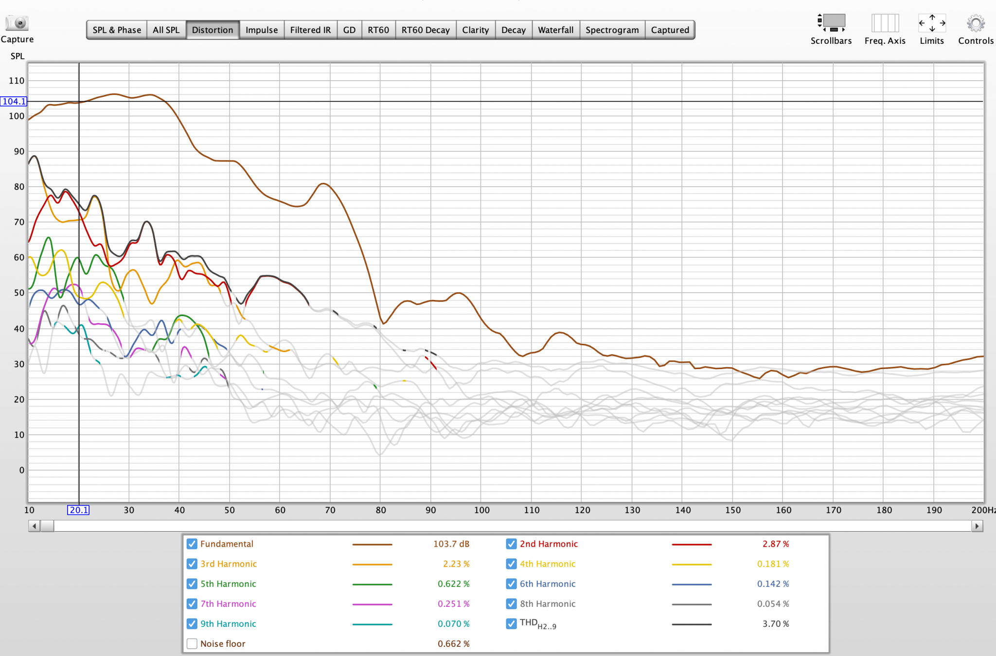

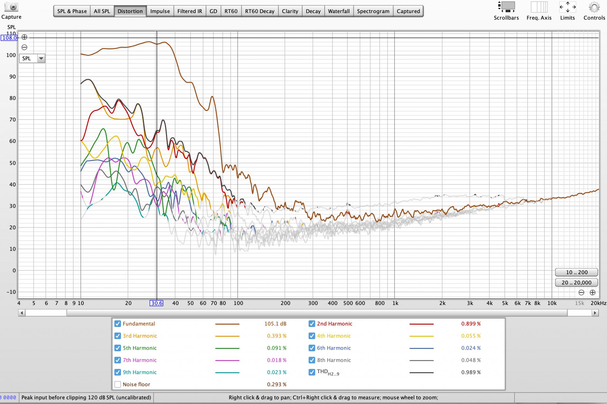

I use two sealed 18” subs in wadded 140 L cabs . I run these from 8-39 Hz and can get a response within 3-4db using one PEQ at the room resonance, only the room is modest size 5m x 5m x 2.65m I can get 106 db at 10HZ at the seating position with less than 20% distortion and 110db only 2% at 20 HZ. I use 12” subs from 40-80, they do overlap. I have no issue with volume on music or film. A tonne of headroom as I can hit 115 db at the main seating position with less than 5% disortion at 20 Hz I am over 3m away from the two 18’s

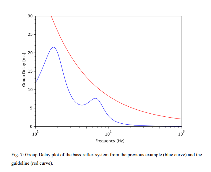

Sorry about the bump, image from the article and a copy as PDF, from Claus Futtrup who changed companies from Seas to Dali in 2021.

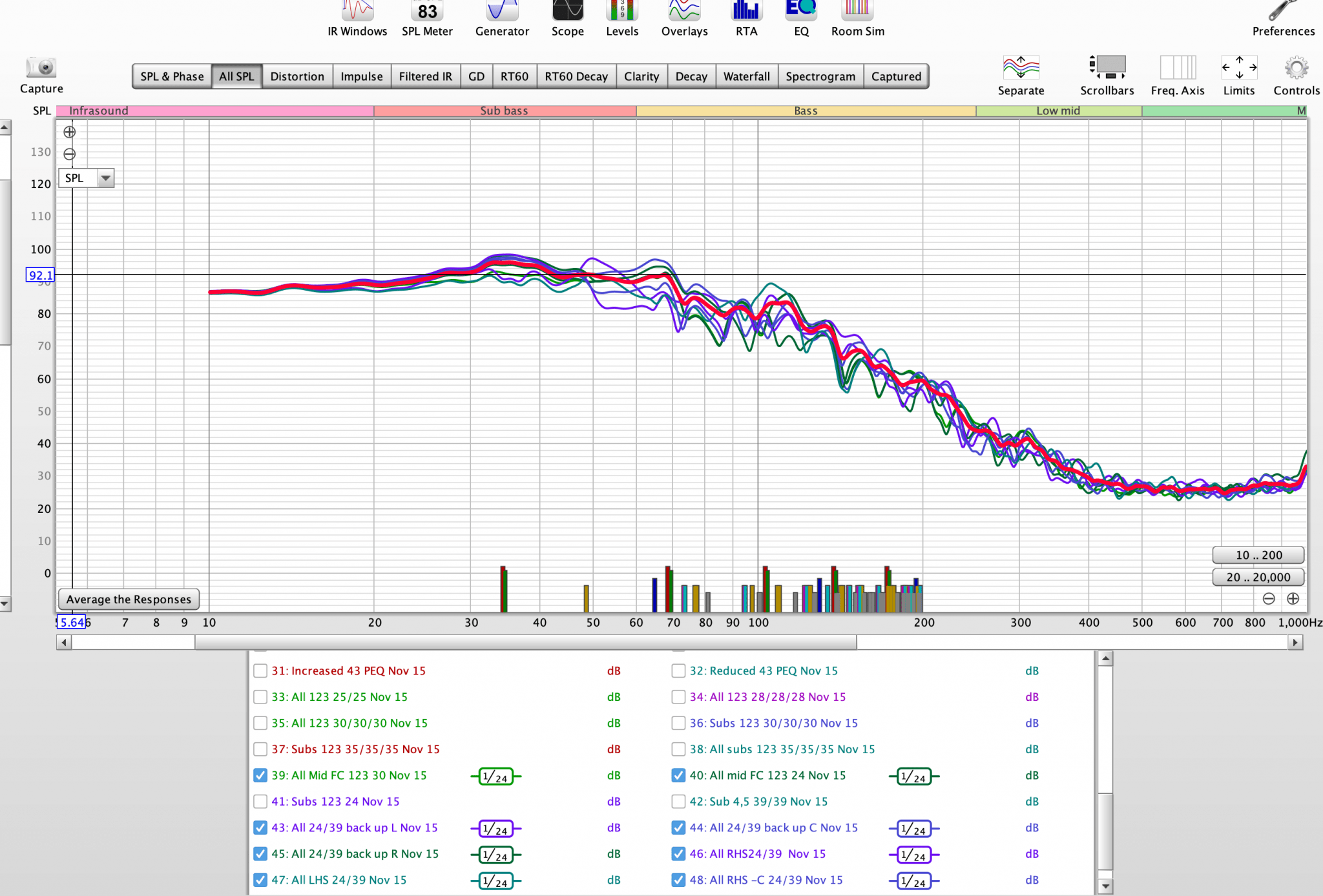

The MLP is the main listening position so this is a measurement at the centre seating position at the low end it’s quite consistent across the sofa, less so for the 12” subs
The room has a node at 34 Hz
Here is a look at the three seats and a number of positions where I think it sounds really good in the room. I run the subs to 70 Hz or so this is 2x18 and 3x12. The 18 have a 48db/Octave DSP filter at 39 Hz and the 3 x12" have a 24db/Octave DSP at 24 Hz roll on these are rolled off by the plate amp and not digitally
I ended up with a lift at 34 and a little down turn from 30>20. This was a preference by ear, I can clean up the 34 bump but it seems to lose a bit too much energy and drive if I lift the 18's and add more to the sub 20 Hz it sounds a bit too heavy. I am still experimenting with settings. Obviously I blend in the subs with each channel and filter out the unecessary added db. all bar the LFE channel are over 80 db. I have a harmon like curve where most channels have a 6db lift or more from 20-70 Hz

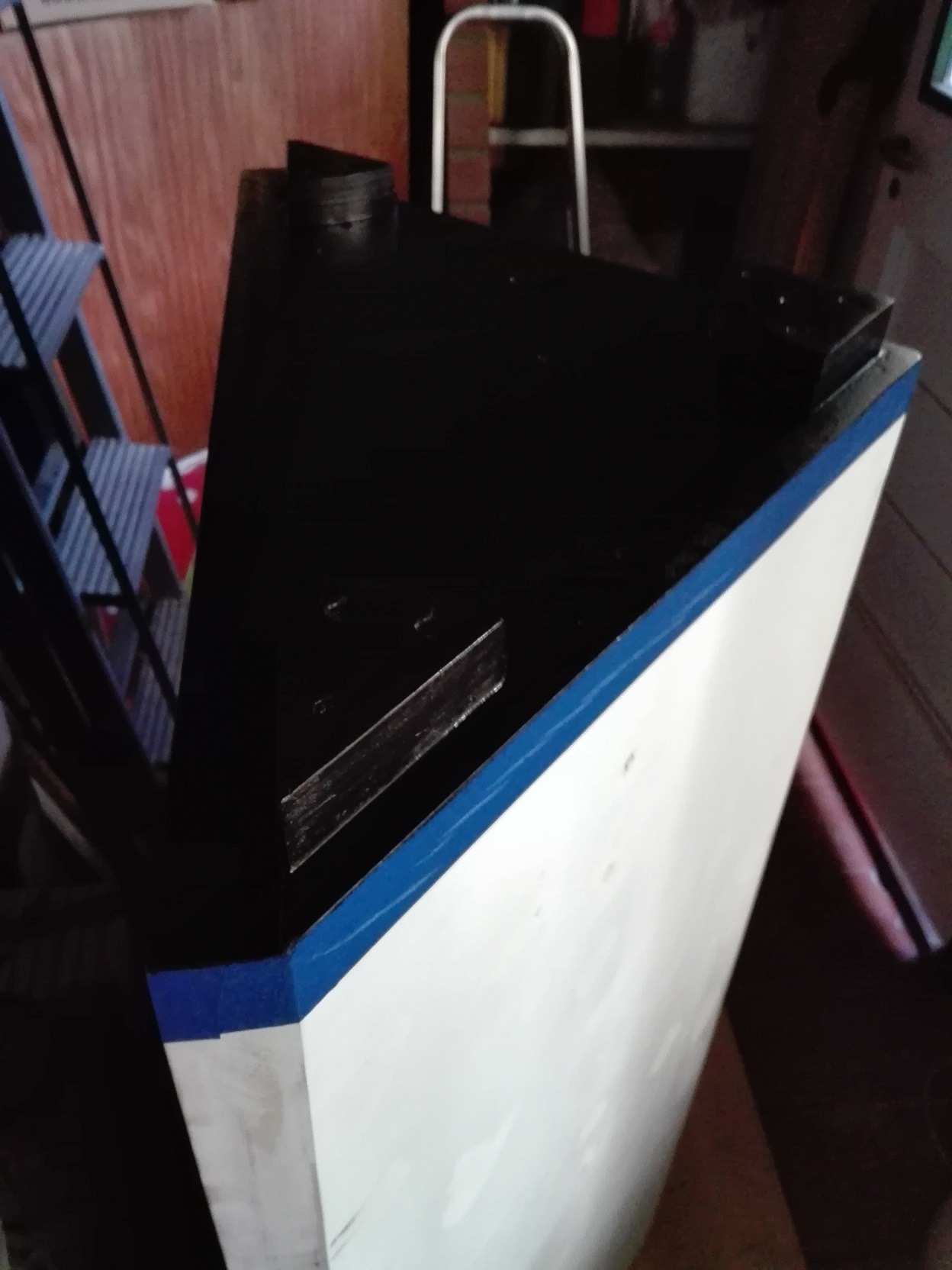

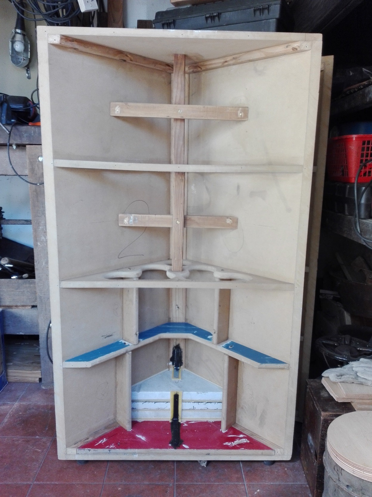

I'm thinking of putting the tuning tube pointing towards the floor, in the spot available from removing the marble block. They are 25mm. free .
There has been a lot of talk about the correct position of the tuning tube, but since this box is a prism, I don't see another way to locate it, should I not risk that it does not "vent" enough and raise the feet a little more?

So you'll go with ported then, I guess
It remains to clarify some details before making the decision, mainly the location of the tuning tube. I promised WAF that I would make the protection grids for all the cabinets in the living room, and I still haven't delivered, so every time children come to visit my house, it gets difficult.....
For this reason, the sub should not see a "hole" in the front!
And cover up that hideous round black 18" monster ! 😒
I took quite a bit of measurements of distortion in sealed and ported subwoofers. In a perfect case you gain 15db of output by going ported right at the tuning frequency while keeping distortion levels the same. However this bass output comes at the tuning frequency comes 10-20ms later than lets say an octave up (group delay) and the output of port usually takes longer to decay than the driver by itself. Is it worth it? For music I say no, a better option is to add a second driver and get 6db of added output across the board. For home theater or PA where you want to squeeze out the most SPL it's an option and with a very low tune the added group delay is less noticeable.

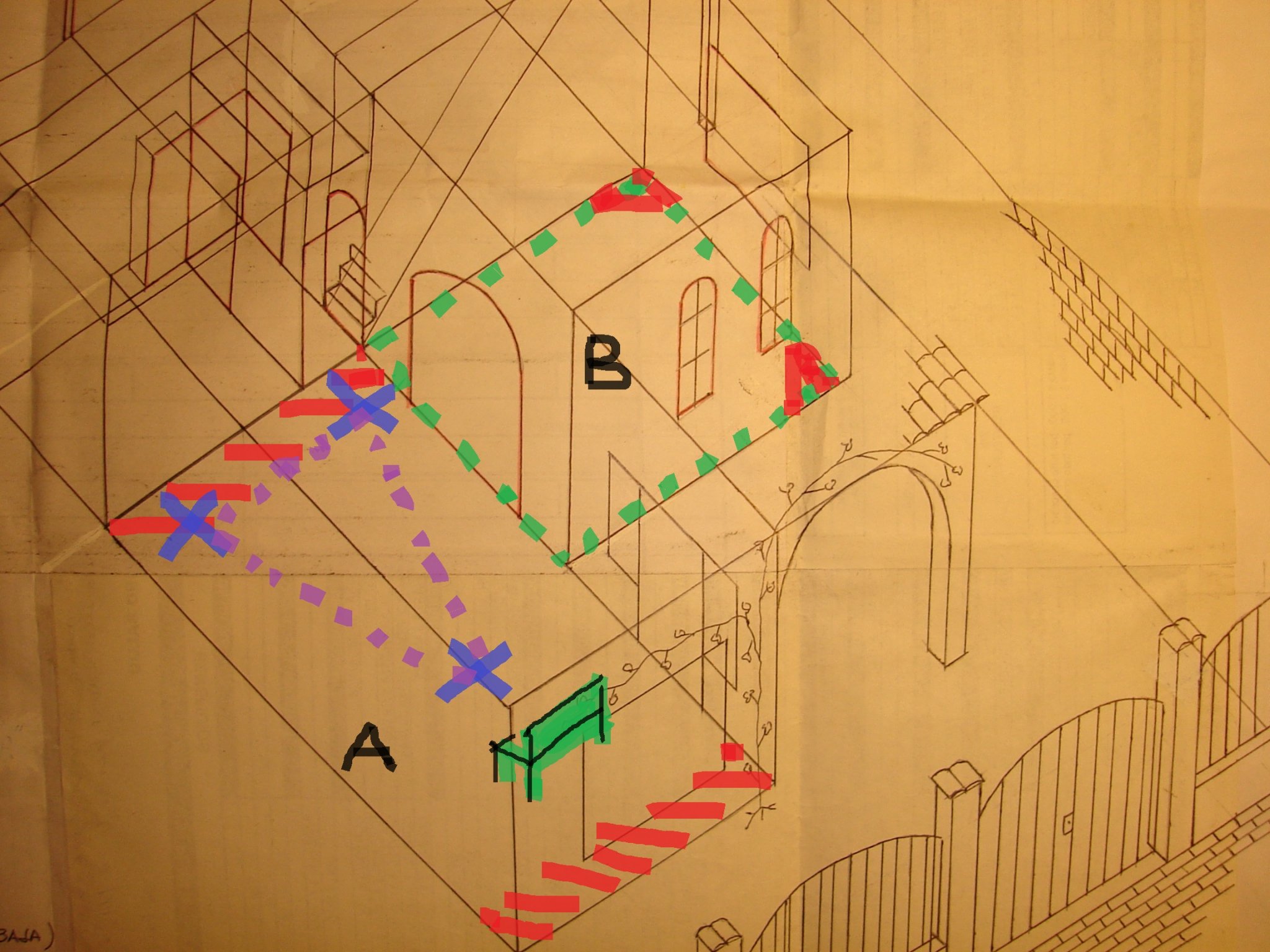

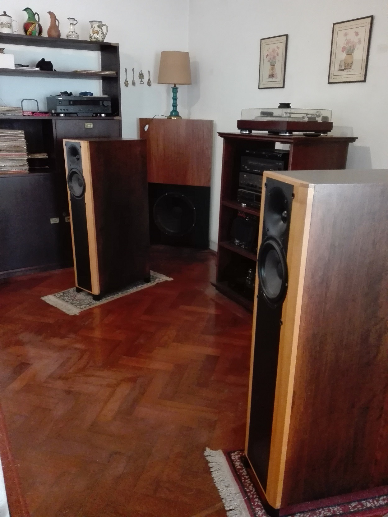

Regarding that, I must tell you that there are 2 subwoofers and being corner subwoofers they increase the gain even more (+++). In the attached graph you can see the location, the clumsy sketch is due to my lack of management of technical drawing programs, but you just have to imagine that being corners, the gain is even greater............ For music I say no, a better option is to add a second driver and get 6db of added output across the board. For home theater or PA where you want to squeeze out the most SPL it's an option and with a very low tune the added group delay is less noticeable.
My expectation is to use the converted BR subwoofers without any DSP or EQ, I'll just drive the gain I feed them with the amp, which by the way has power to spare as I mentioned. I have had the previous experience with a monophonic 250 Watt plate amplifier (power to be shared between 2 subwoofers) and 2 vintage BR cabinets, and, although the most noticeable difference is that I had to place them behind my listening position (in the field near) and now I do it in the far field with power to spare.........they sound different! For me harmonics are missing, I can't find another explanation.
