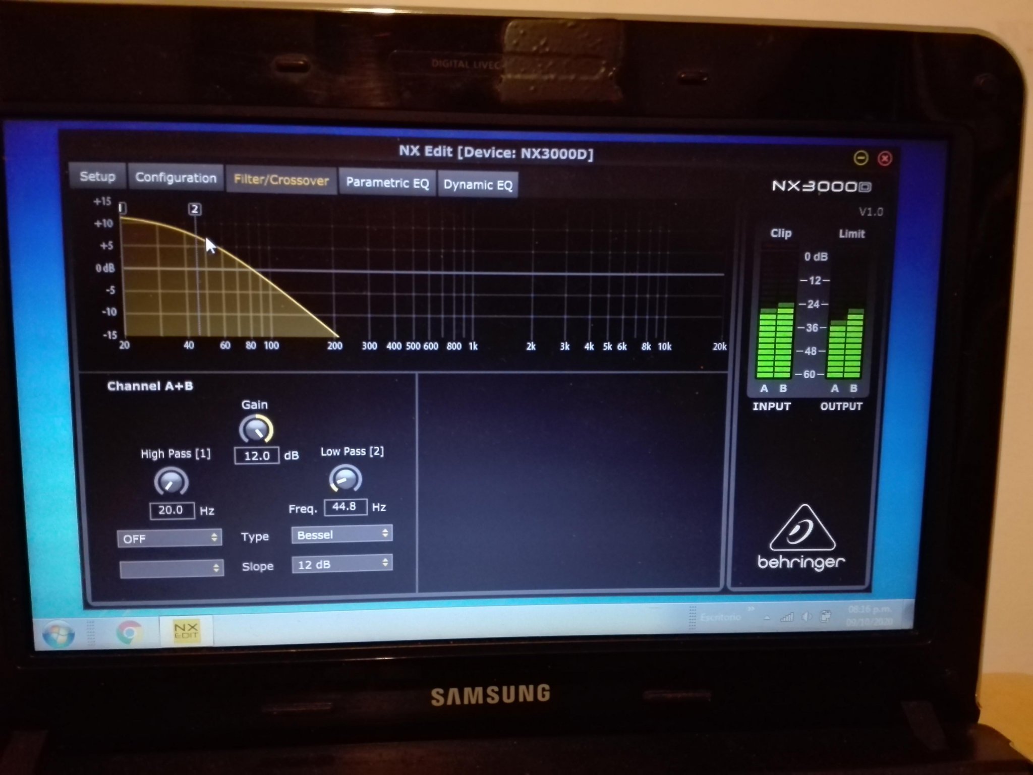

Then I would not be analyzing cabinets, but a resultant...Are you adding any EQ to the sealed subs? If so add that to the simulation and recompare group delay.
I use DSP, not EQ when listening, I don't need it.

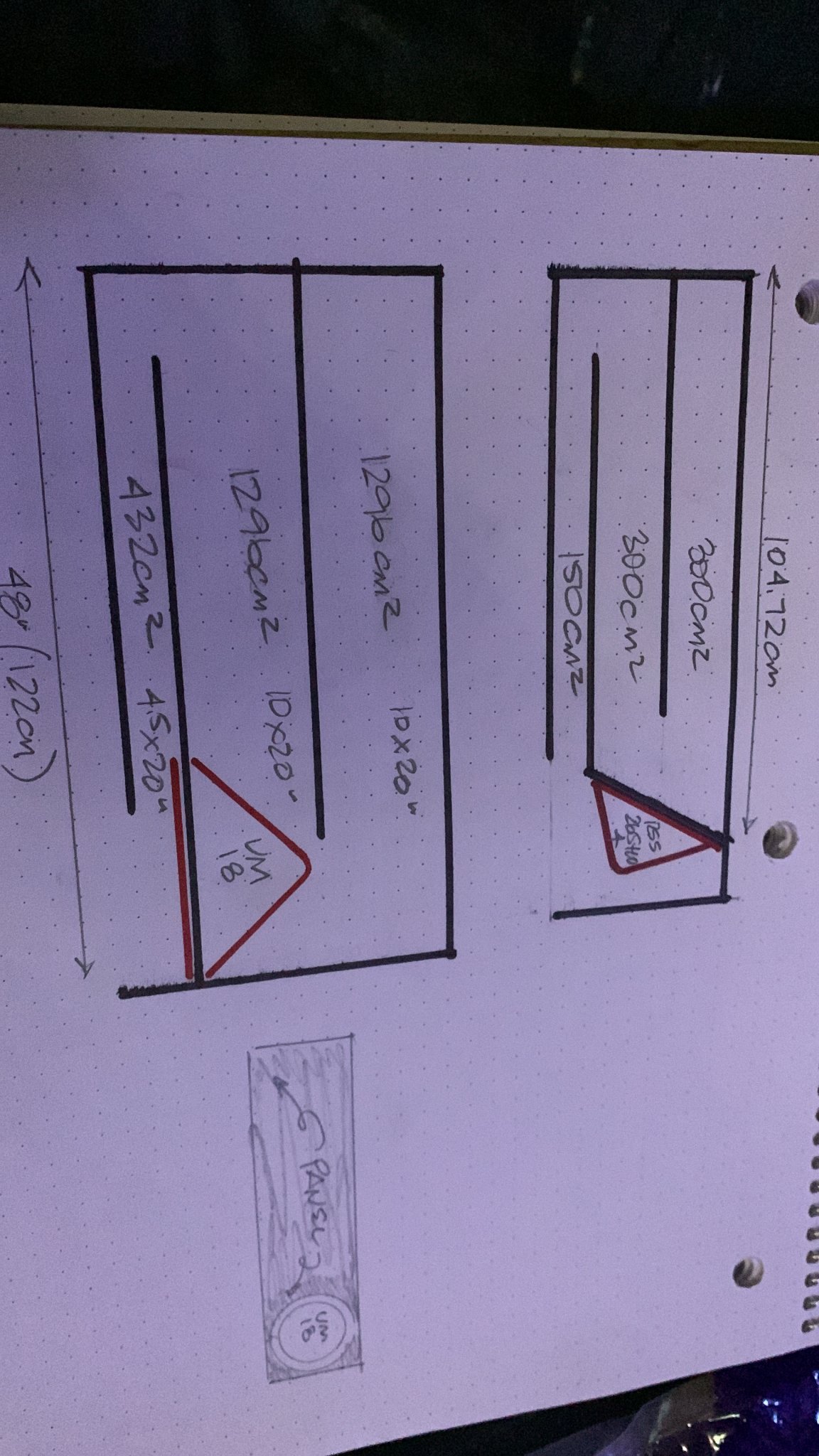

Sealed 360 liters x 120cm , with eq and filter to protect, or MLTL of the same (dayton umax18 for a random example ) at ~120/120/120 (offset entry 2fold)…. I’ll just seal it up , if sealed is so good? since it’s so easy to do in this case. ??? Hard to argue when everyone’s right. I just stole the blueprints from Nikola Tesla, and the device to use to cure Mark Twain’s constipation.I said is " booming bass " correct ? Sorry, I was in the middle of uploading attachments and I missed it. I don't agree with that either, well calculated BR cabinets are not, not at all...

Make no mistake, a ported enclosure is a poorly damped resonator which stores energy, and the bigger they are the longer they ring after the signal has ceased, which can be 1/4 second or more...... see what would happen if I converted my two sealed subwoofers (which I built and documented here at Diy Audio ) to bass reflex ...
If you can live with this 'smearing' of transient events and need to achieve higher output then porting your enclosures will achieve this gain.

ANY type of processing adds delay and phase shift and if the speaker design can't be used without it has to be considered part of the design.Then I would not be analyzing cabinets, but a resultant...

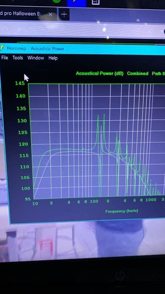

I don't think anyone has seen that if you enlarge the attachments of post 16, in them you can see - top right, red arrow! - the respective group delays of MY box and my speaker :
For a 20 Hz sine wave,
Vented is 14,906 Ms. and Sealed is 4,074 Ms.
Those almost 15 ms. in the BR are inaudible to me and the bibliography confirms it.
