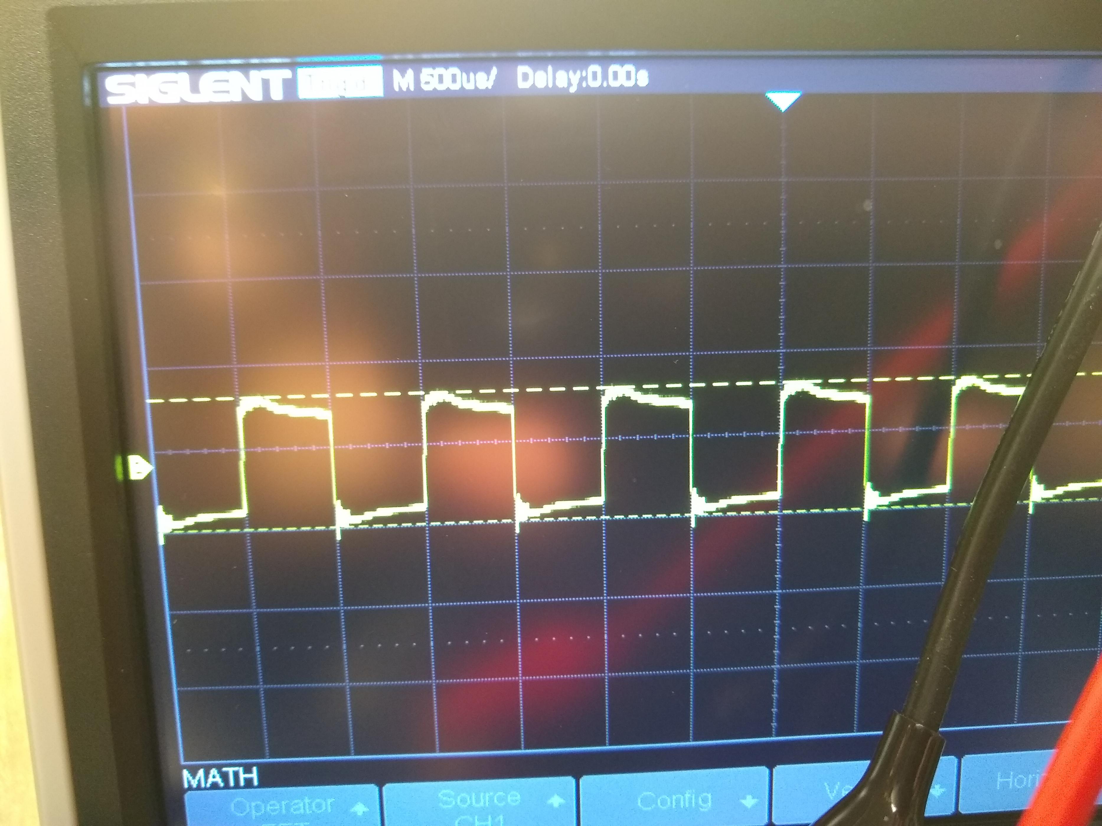

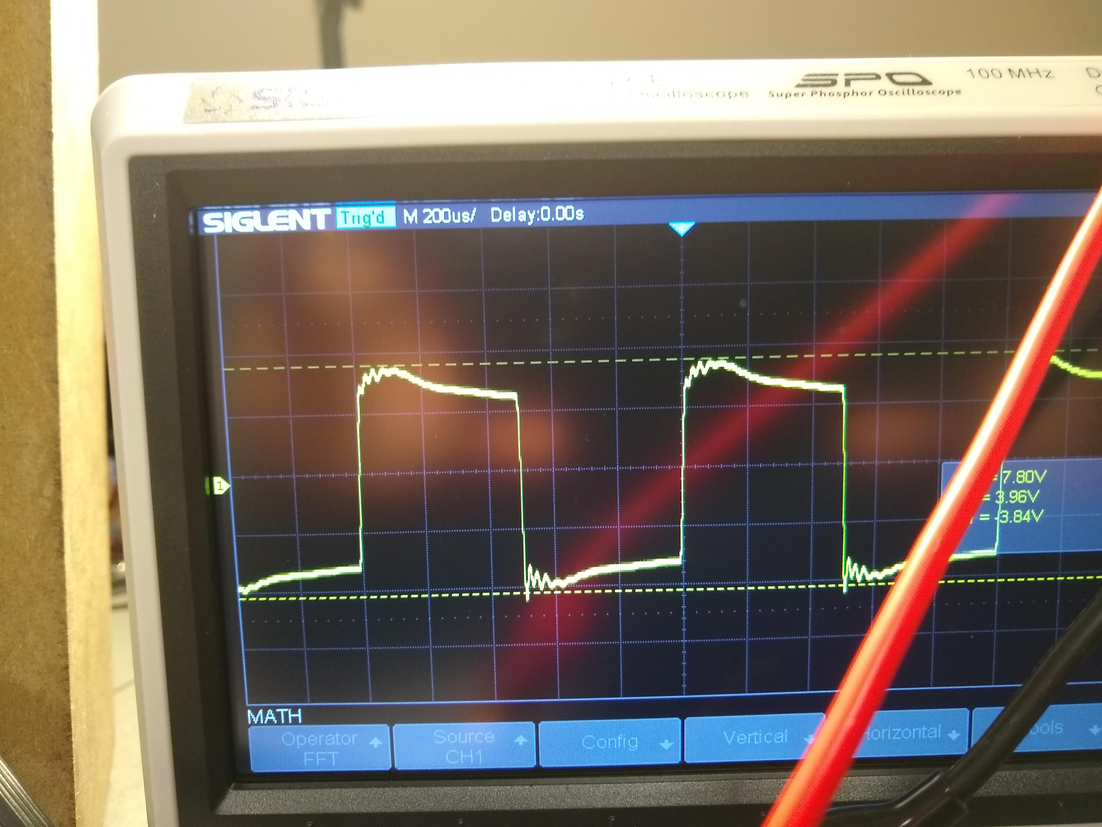

Square waves into speaker: First is unbypassed, 2nd pic is bypassed.

Sounds like the driver was "foreshortening" in one direction, and the output stage was "foreshortening" in the other direction.

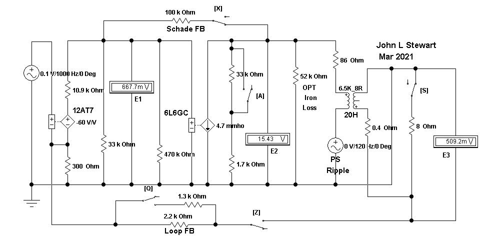

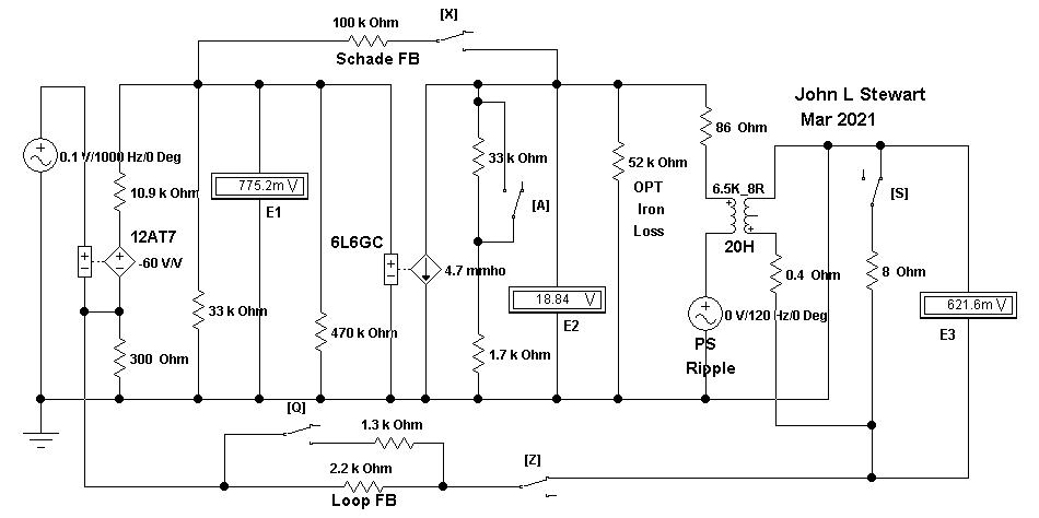

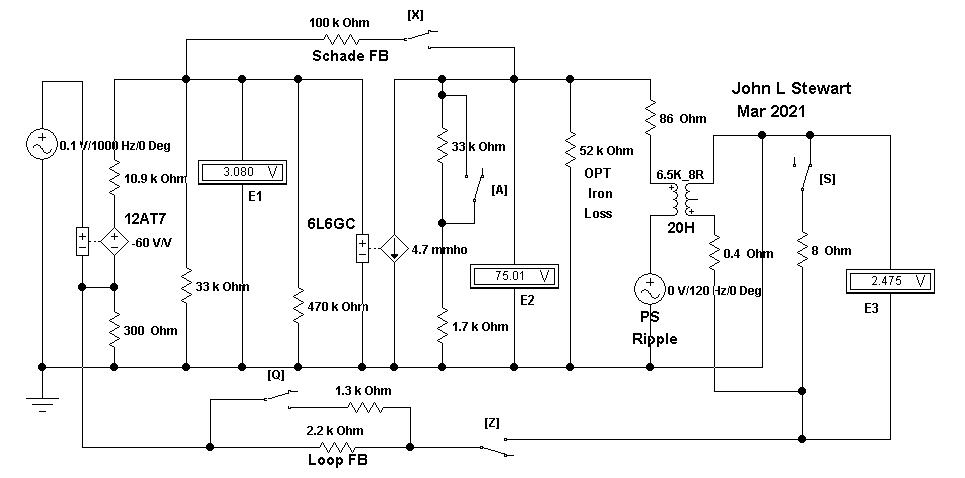

But before you leave the screen issue get a scope shot of the voltage on the screen without bypassing at One Watt & 5W. That information is not only nice to have but can be used to explain the issue in more detail. The information will also be useful when you go PP.
You could also determine your loudspeaker resonance issues with an easy setup. With the speaker driven at low level from the amplifier thru a suitable resister, say 100R, the resonance can be seen on the scope as the SG is slowly swept from 20 Hz & up. The scope probe goes on the loudspeaker leads, not the amp.
The attachments are the bare bones numbers for no FB, Schade FB, Full Loop FB & Both FB. A guide for you as you try different FB.🙂
Be sure to keep a record that you can refer back to.
I may not get those screen measurements right away, I am having too much enjoyment listening to the amplifier. Its sounds better with some 'edge' taken off by the bypassed screen resistors.
I still can't believe that "we" made an SE amp with no measurable 2nd order harmonic distortion. (at 1W, 1khz)....
