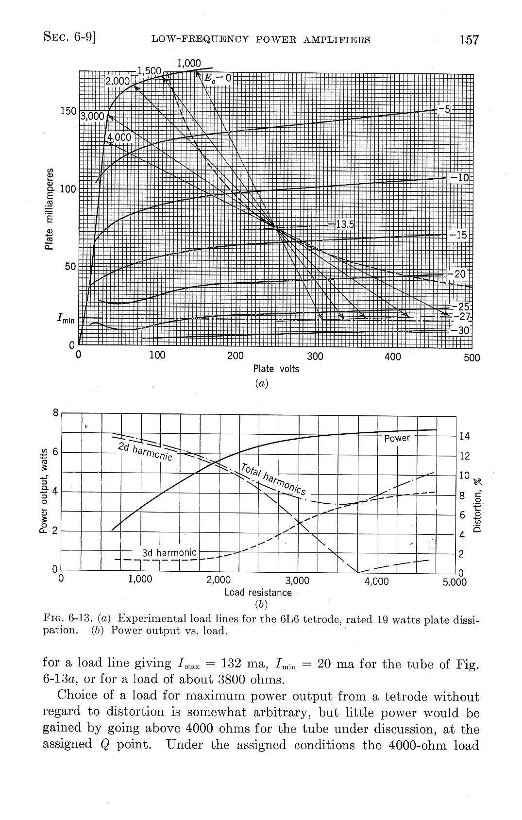

The attachment covering distortion is typical of all common pentodes & beam tubes. Your SE 6L6 OPT load should be down around 3K. Do you have a copy of the original paper I could read?

More Distortion Information

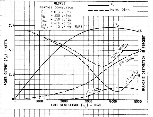

On the 6L6WGB Plot the D% curve is moving up & to the right on the RHS as load impedance is increased. Not a good sign for using a 6K OPT.

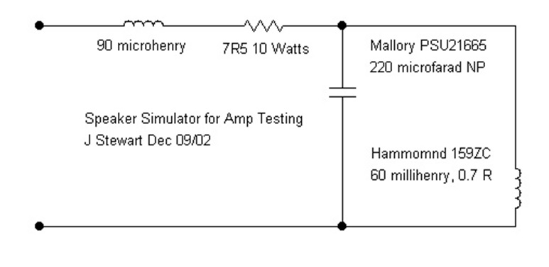

Many amplifiers are stable on the spec'd resistive load. But could have problems driving a speaker, a complex load. So many experimenters put together simple complex loads for testing. That way no one has to listen to a speaker during the test. Mine is shewn here attached.

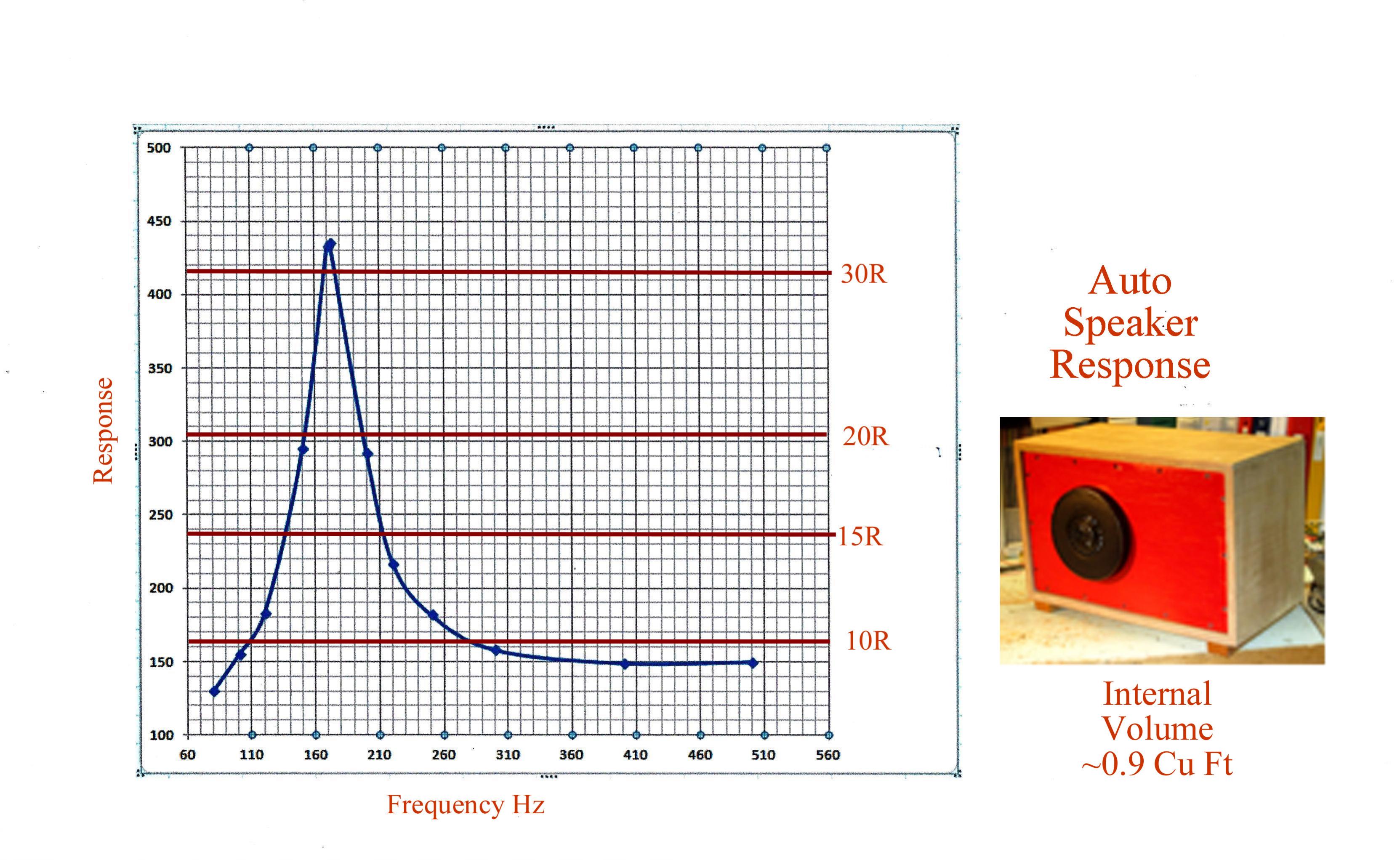

A real speaker with impedance plotted to below the resonance. This is in a simple sealed enclosure, 3/4 inch plywood. The speaker is an auto replacement. Real cheap, I built two for the garage. Driven by a low cost SS AM/FM thing, 3W per channel. It competes with Skil Saws, Drills & so on.🙂

I dug into some of the old threads but was not able to discover why Alex Kitec put an unbypassed 10K in series with the screen. Or how the 6K OPT was selected. All still a mystery!

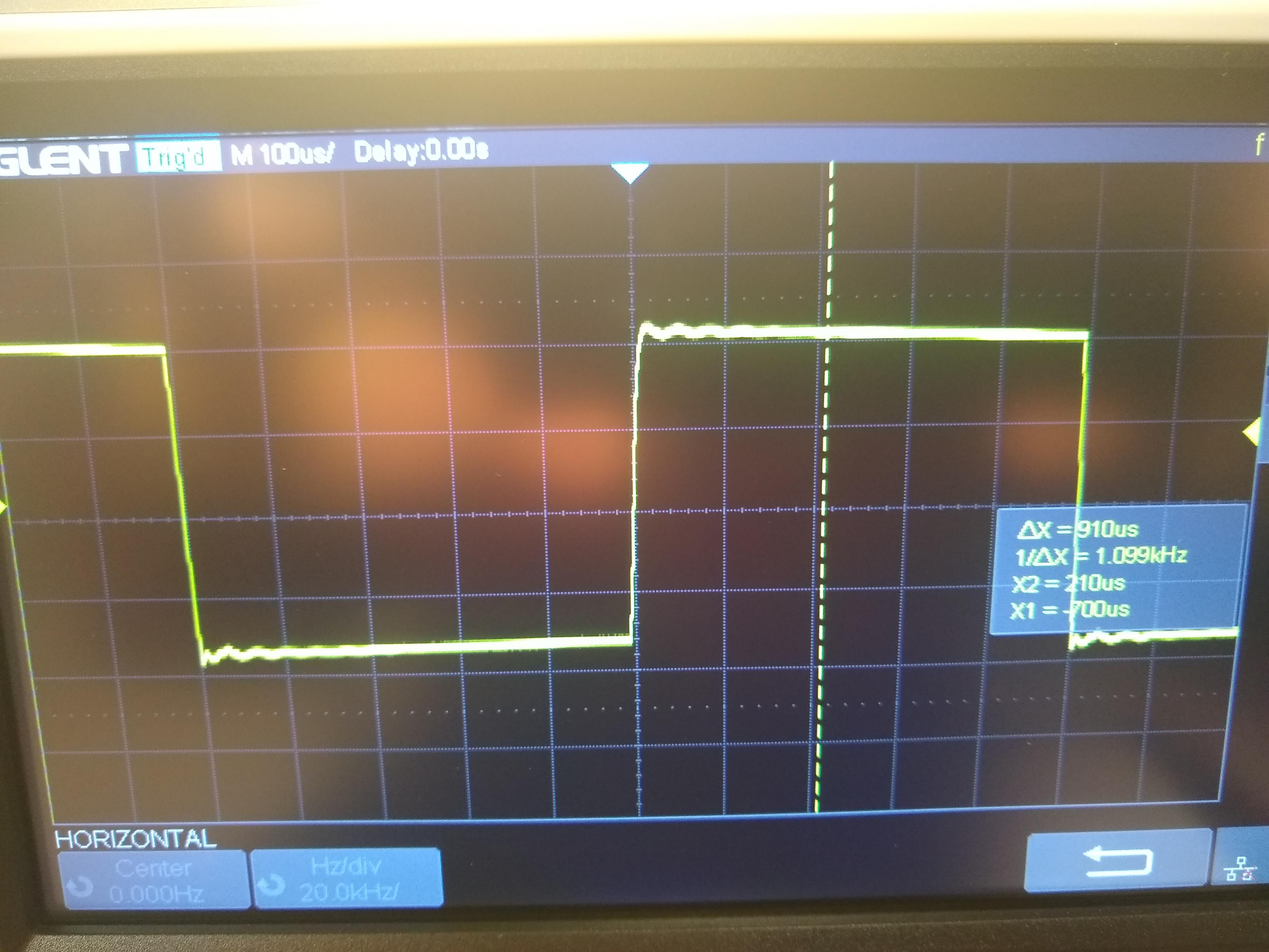

Measure the AC signal across the 8R on the OPT secondary. Using a Sine wave, not Square. 6W will make a lot of noise thru your Bookshelf speaker. At a lower level drive the speaker with a square wave, you might see some ringing on the trace.
