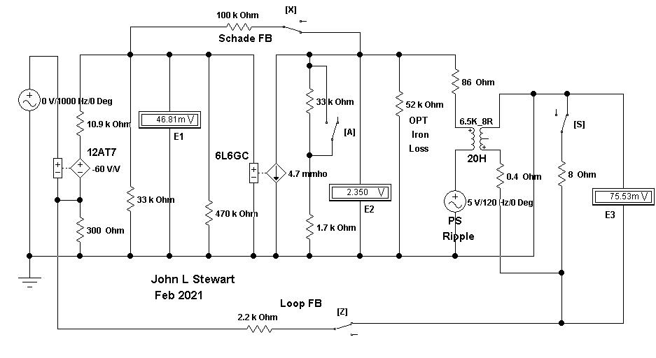

Schade P2P and gNFB in RH807

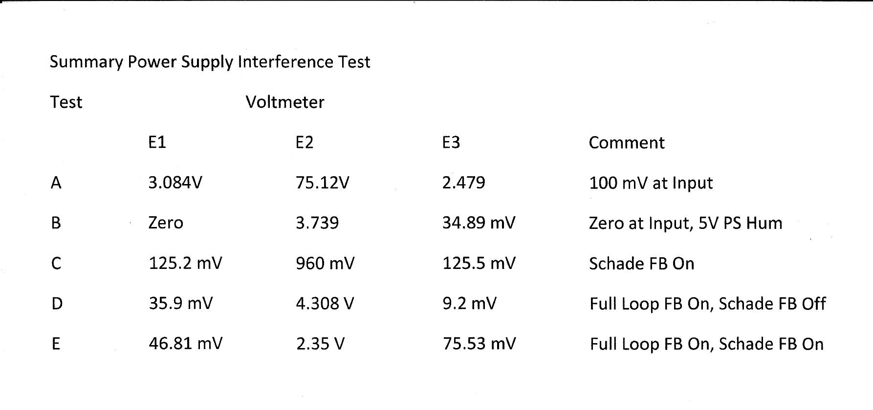

FB Effect on Power Supply Ripple

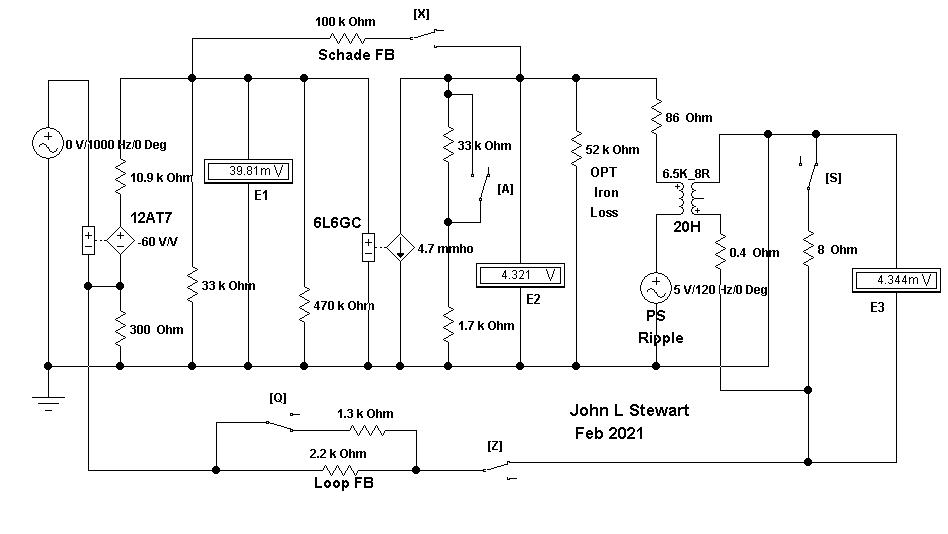

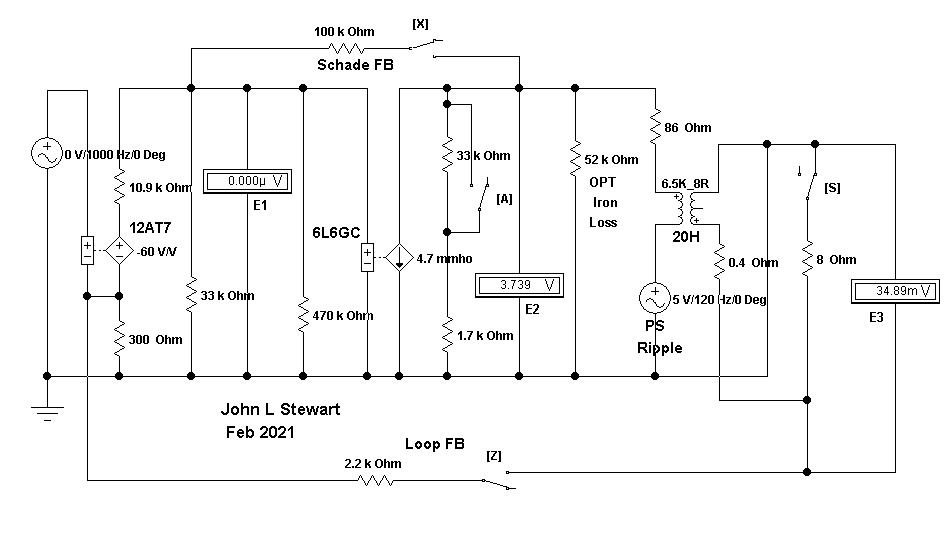

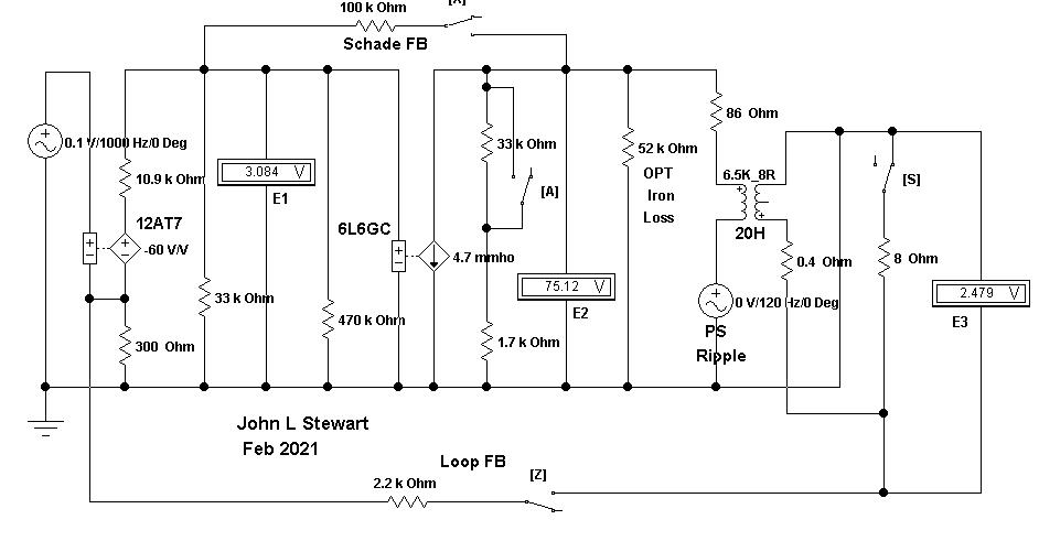

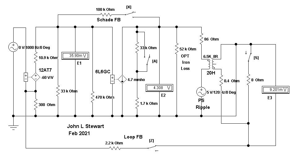

The new numbers for the OPT winding resistances are included in these simulations. The first simulation is simply a 100 mV input so stage gains can be calculated.
The 2nd sim sets the input at zero but adds a PS ripple of 5V. A PS hum voltage appears on the load resister. The 3rd sim applies Schade NFB, the hum on the load resister increases.
The 4th sim shews Schade FB unhooked & normal FB applied. Notice a bucking voltage almost as large as the PS ripple appears at E2 in opposition to the PS ripple.
In the last sim both Schade FB & normal FB are applied, the hum on the load resister persists. The bucking voltage at E2 is smaller.
All this is normal, more sims later.🙂
And somebody pls check my numbers in the summary table.😱

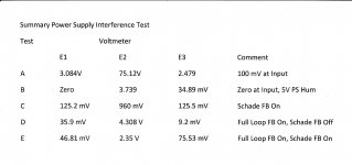

Summary of Simulation Results
Here are the bare bones results of the sims without the schematics. Except for the PS example. All should be self explanatory.
Schade FB Only 13.75 db DF 3.34
Full Loop FB Only 12.02 DB DF 4.41
Both FB On 17.6 db DF 6.17
Full Loop Alone Adjusted for 17.6 DB NFB DF 10.1
PS Ripple Suppression, Full Loop FB Only 17.6 DB
Fans of Schade FB may not like these results. They are free to challenge them. But they better come with more than opinions.
Measurement results do matter & give a good prediction of how the circuit will perform.

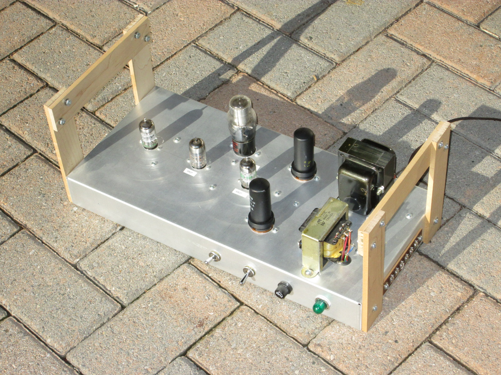

Some might wonder if I've built SE, here are some I can recall off the top. The last three were published by AudioXpress. With lots of actual measurement data, a lot more than just 'It Sounds OK'.
And photos, parts lists & construction advice.🙂

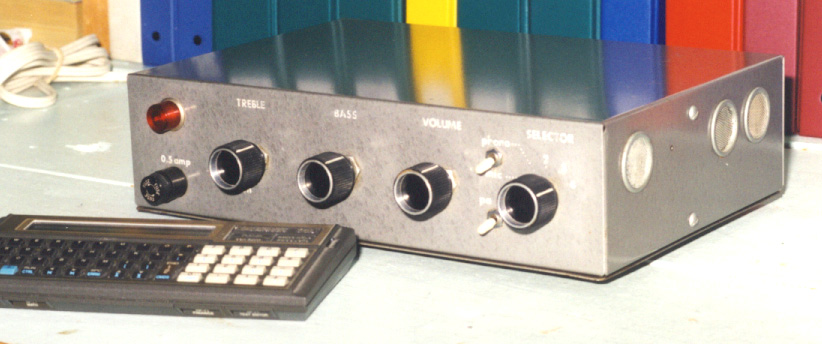

SE Amps Built 6C4/41, 6SJ7/6V6, 6J5/50L6, 6J5/50L6 on 220V, 6AU6/6AQ5, 6EA7, 6LU8
The 6AU6/6AQ5 amp is a fully integrated amp, complete with Baxandall Tone Controls & a PreAmp for Magnetic Phono. It runs every day in the workshop here, since 1968.🙂

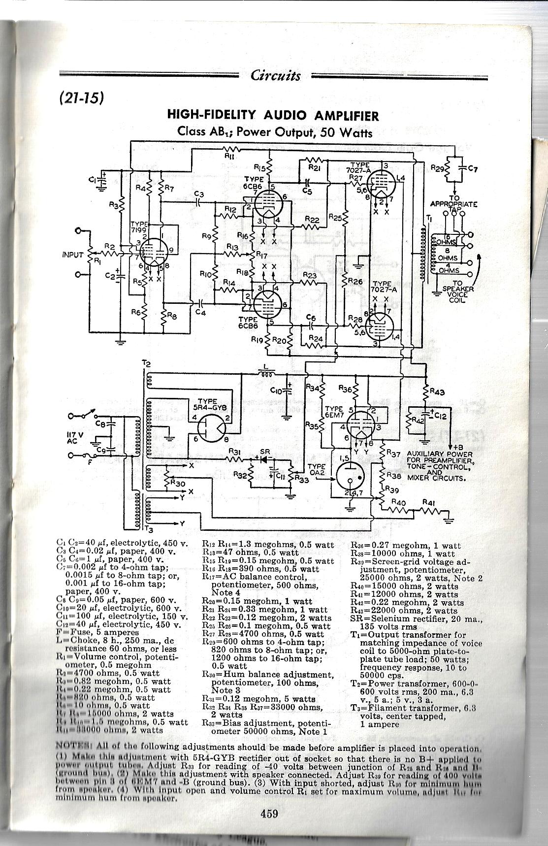

Attached a rather exotic cct with three kinds on NFB, one of them Schade. This needs a very good OPT, maybe a Plitron. Not exactly a circuit for amateurs to attempt.🙂

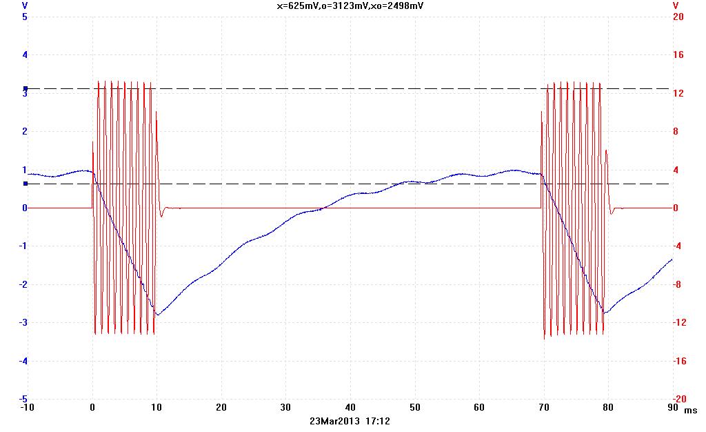

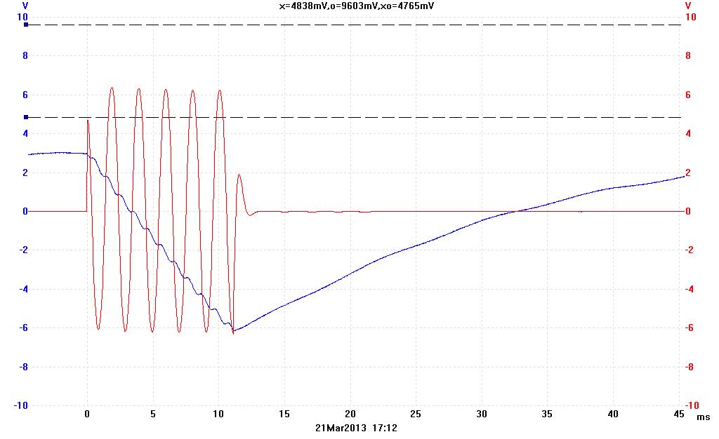

Whenever I'd built something in the last 25 or so years there are certain objectives in mind. This one tried PP 6V6s in Class AB2 pushed to the limit, a minimasl PS so could see overhead ability & try FB from output anodes to the upper grids of a PP differential stage. Off the top it manages 19 watts on the limited PS, 26 watts on a regulated PS. The internal NFB is about 8 DB. The OPT loadline is corrected for Class AB2 operation.
As usual, 'It Sounds OK'. What else should we expect when a typical speaker system brings with it 2% or more distortion? DF above 10 doesn't help any less than a DF of 100 since an 8 Ohm speaker adds about 6.5R in series with the amplifier. Do the math.😀
The pulsed waveforms are produced by an analogue gating circuit I built as a separate project. The audio generator was probably an HP 200CD.🙂
This cct has been on DIY before, probably already seen by many. My apologies.

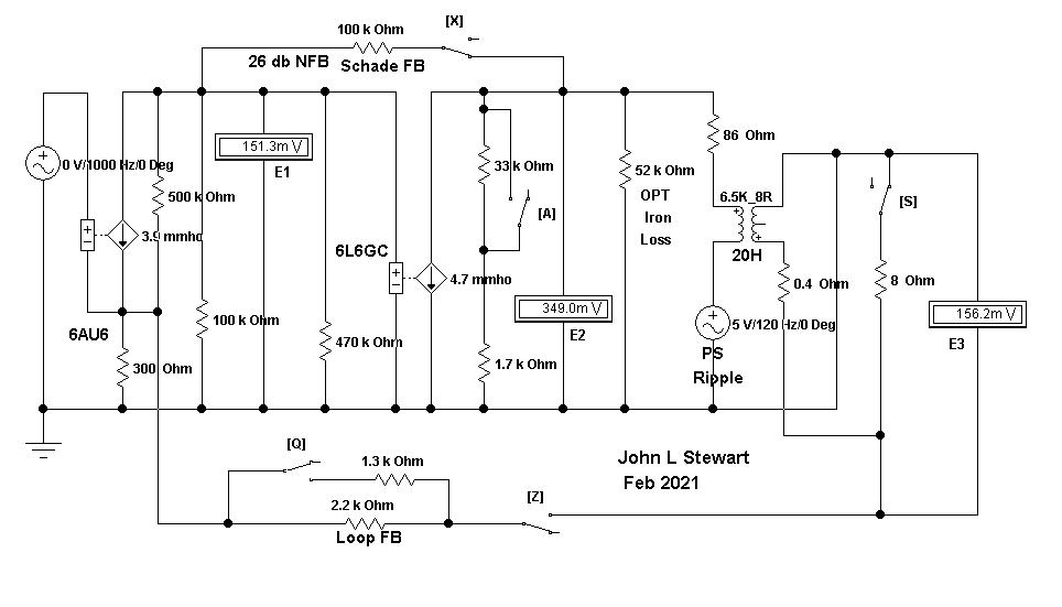

I see you subbed the 6au6 for the 12AT7 in the last sim. You kept the 300 ohm cathode resistor but used a 500K plate resistor? Am I reading your model correctly?
Edit: Nevermind, the 500K is your tube model? 100K for the plate resistor?
Your Edit is correct. Sometimes these schematics get so piled up they become difficult to read. This cct does better because the NFB factor is much larger, the FB current is driving back into a higher resistance.🙂
To the driving cct the FB resistance looks like the FB resistance divided by the gain of the power tube.
