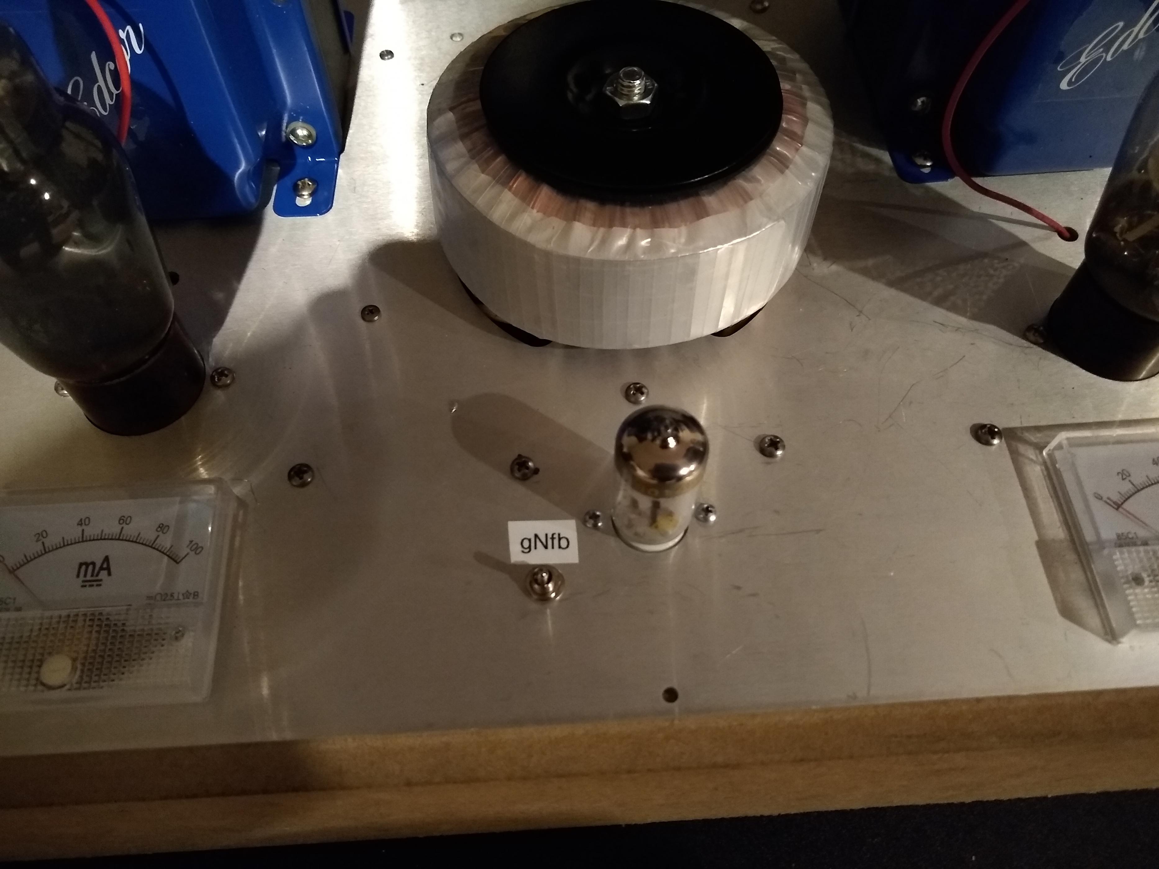

Schade P2P and gNFB in RH807
Dual SE Cancels D%
Have a read of this.:)

It will pop a bit, because you remove that 2k2 to ground in parallel with 300 Ohm cathode resistor, so the working point will change a bit.
Another option is to have a 1 kOhm resistor in series with a 10 kOhm Log potentiometer: around noon you'll have the same feedback, then you can increase it or decrease it to taste. It will scratch, because there's DC across it, but you could like the added feature.
