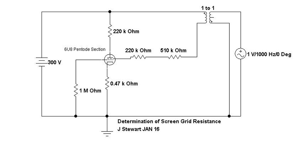

Same kind of fix applies to screen bypass. The resistance part of the calc needs to include rg2, usually not even considered. For small signal pentodes like the 6AU6 rg2 is ~30K, I measured a few years ago. Not sure about 6L6 but probably 1/10th of that.:)
Not sure at all...the 6AU6 has a rather large percentage of cathode current going to the g2. 3-4:1 with the plate above the g2 voltage. EL84 is much less, and IIRC 6L6 also lower. This becomes important for resistively loaded signal amplifier stages. How is this g2 current related to its resistance?

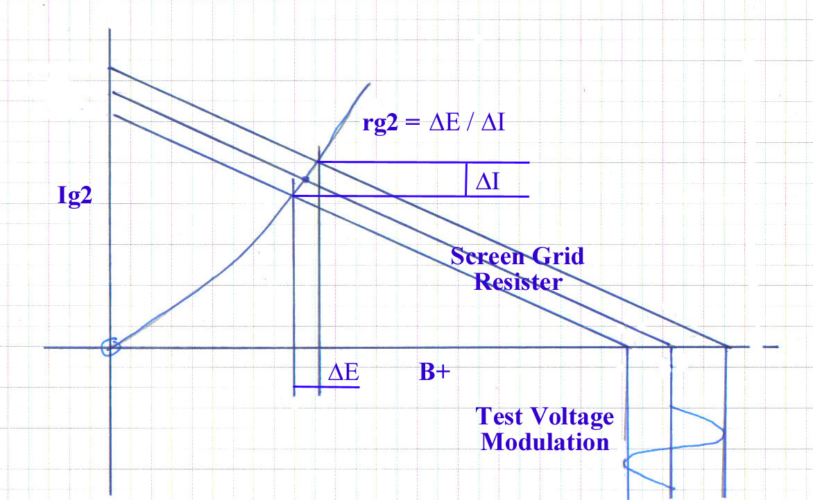

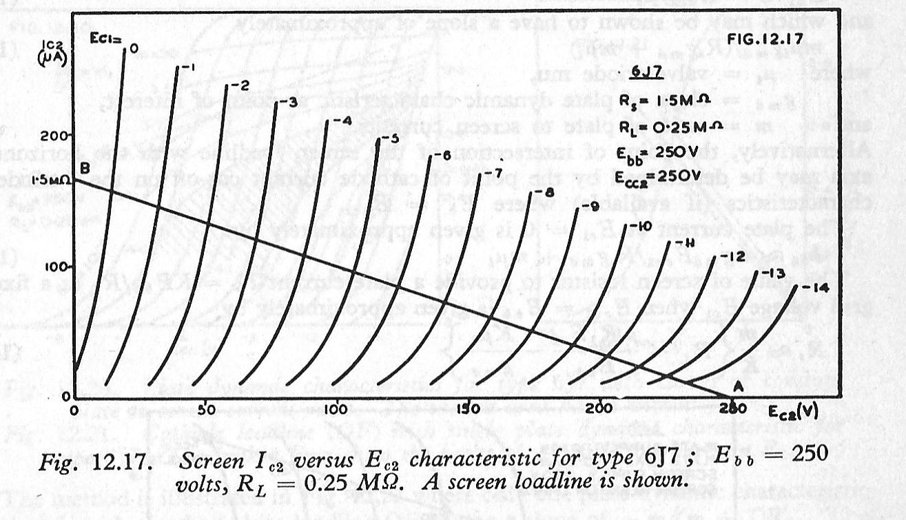

Determination of Screen Resistance
How I tested a small signal pentode a few years ago. A driving signal is introduced to the screen lead & the resulting deltas of E & I measured thru a high impedance differential probe. Without repeating the math the result was 29K.
So to estimate the bypass cap the R used would need to be 29K in parallel with the screen supply resistor.:)
The screen family of a small pentode, the 6J7 are lifted from the pages of RDH4.

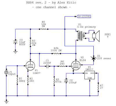

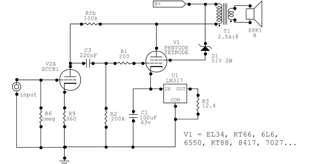

Your RH84 amp is not built to Spec
See the attachment. The original used an EL84, not a 6L6 as the output. That is why the OPT in your version at 6K is mismatch. The 10K resistor was a 24V Zener, both significant differences from the original.:)

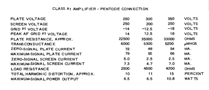

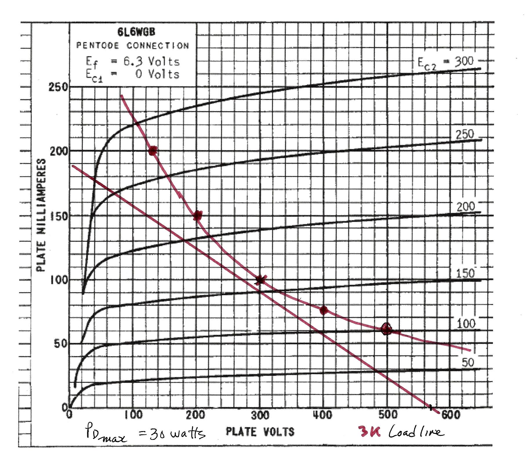

That data refers to the ordinary 6L6 series, 19W plate dissipation. It shews the D% rather high, not a good starting point for fidelity. The RH Universal schematic lists several tubes with higher dissipation specs, the 6L6GC is good for 30W. Based on that I plotted a 3K loadline on the G2 curves for the 6L6GC. The idle current would be ~80 mA while total plate voltage from cathode to plate about 300. That allows something like 30V lost in the cathode bias resister & resistance of the OPT primary.
There is no ideal Rl for a pentode, the published numbers give the max power Rl for a resistive load. A real load isn't much like that at all & spends most of the time looking like an ellipse. Clipping happens much sooner than on a resistive load. Since most speaker systems have an impedance rise both above & below mid frequency that dictates that a loadline of lower impedance will give better performance. So 2.5K is a very good starting point for the power supply used.
Others may differ, but if they do we need more than opinion as an answer.:)

Thanks for that. I drew one too at a 5.5K load line. Why pound that poor little 807 at 80% of its dissipation rating at idle? That sounds cruel. With a 5.5k line I can dial back the bias to about 55ma running at 60% Pd max. The tube will be happier and the power output penalty is very very small. (and less impact on climate change!) And I am measuring less than 1% THD now.

Less than One % distortion is nice but that is after all the NFB that is in the cct. A good design starts out with low D%,
In order to minimize the distortion of the system shouldn't both the load lines of the driver and the output tube be considered? Especially if you wanted to take advantage of possible complimentary distortion cancellation offered by a selected driver-output tube pairing. As such the optimum OT load line would not be achieved by considering the OT plate characteristics alone, no?
