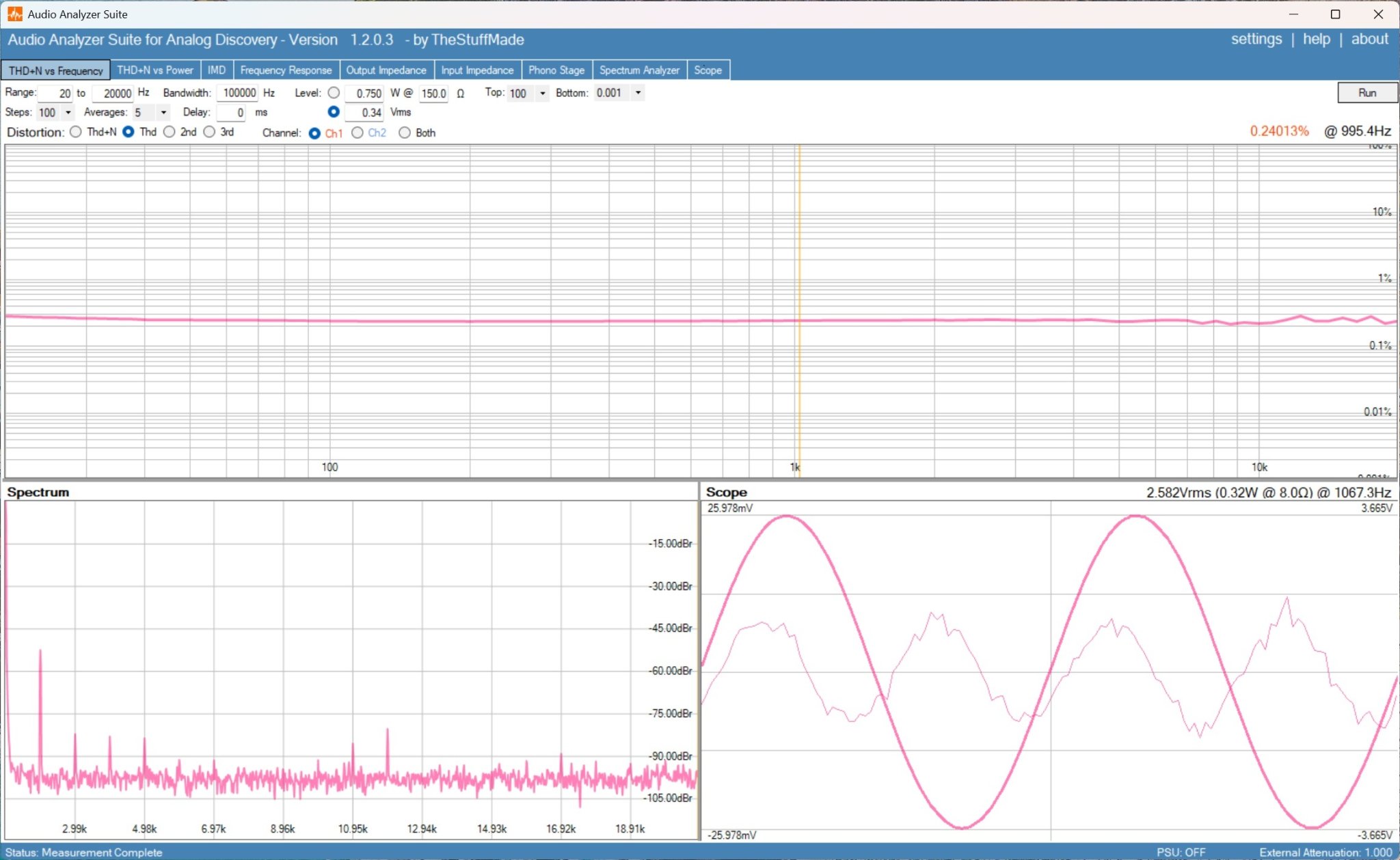

Initial results:
This is for my most difficult headphones at 100 db SPL...pretty loud, I very rarely listen at that level:
Vin 0= .34V
Vpp out = 7.35V
THD+N = 0.31%
THD = 0.24%
H2 = 0.24%
H3 = 0.01%
This is for my most difficult headphones at 105 db SPL..1 hour of this will damage my hearing:
Vin = 0.6V
Vpp out = 12.92V
THD+N = 0.54%
THD = 0.44%
H2 = 0.43%
H3 = 0.06%
So, basically, everything halved across the board.
What did it?
The new power supply?
The fact there is a single power supply eliminating potential current loops?
The fact the supply voltage is higher?
The fact that Vds is higher?
We won't know. Sorry.

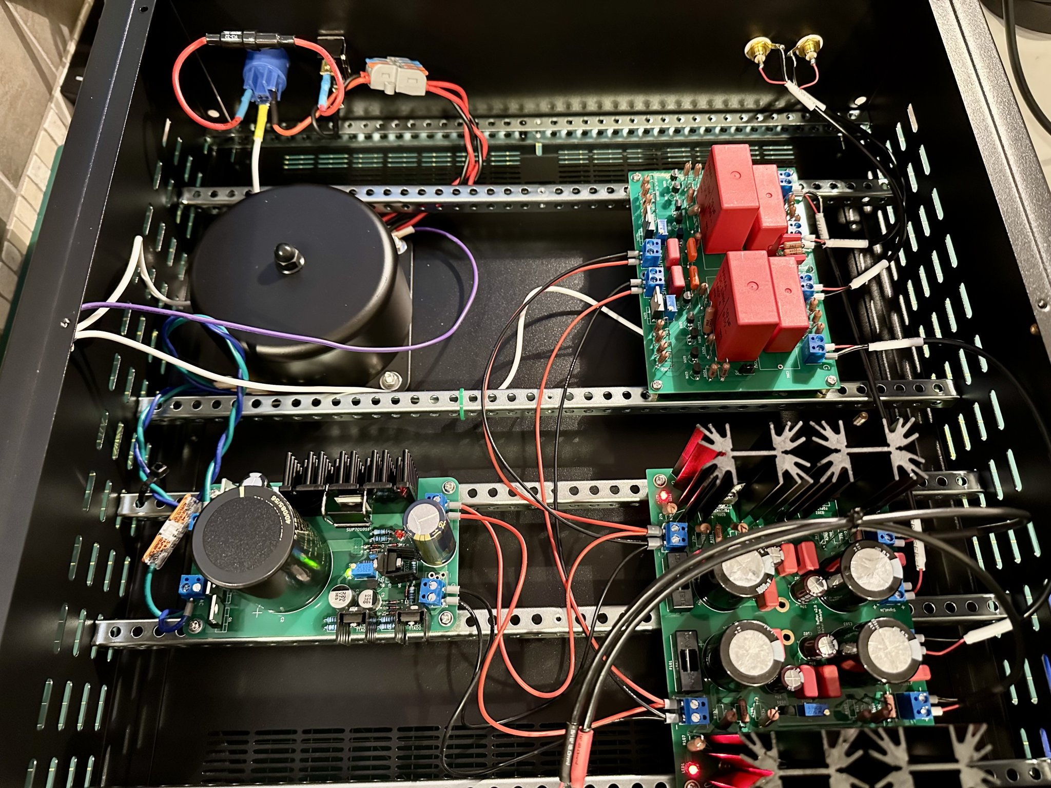

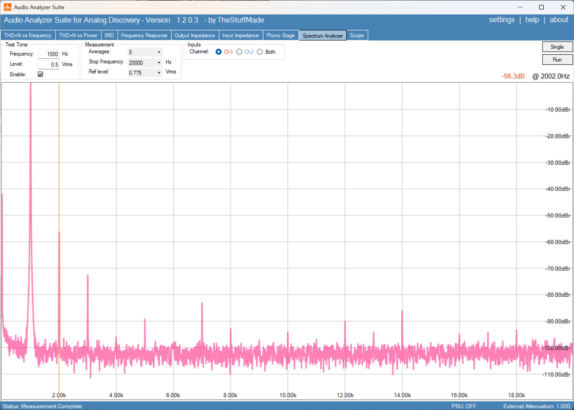

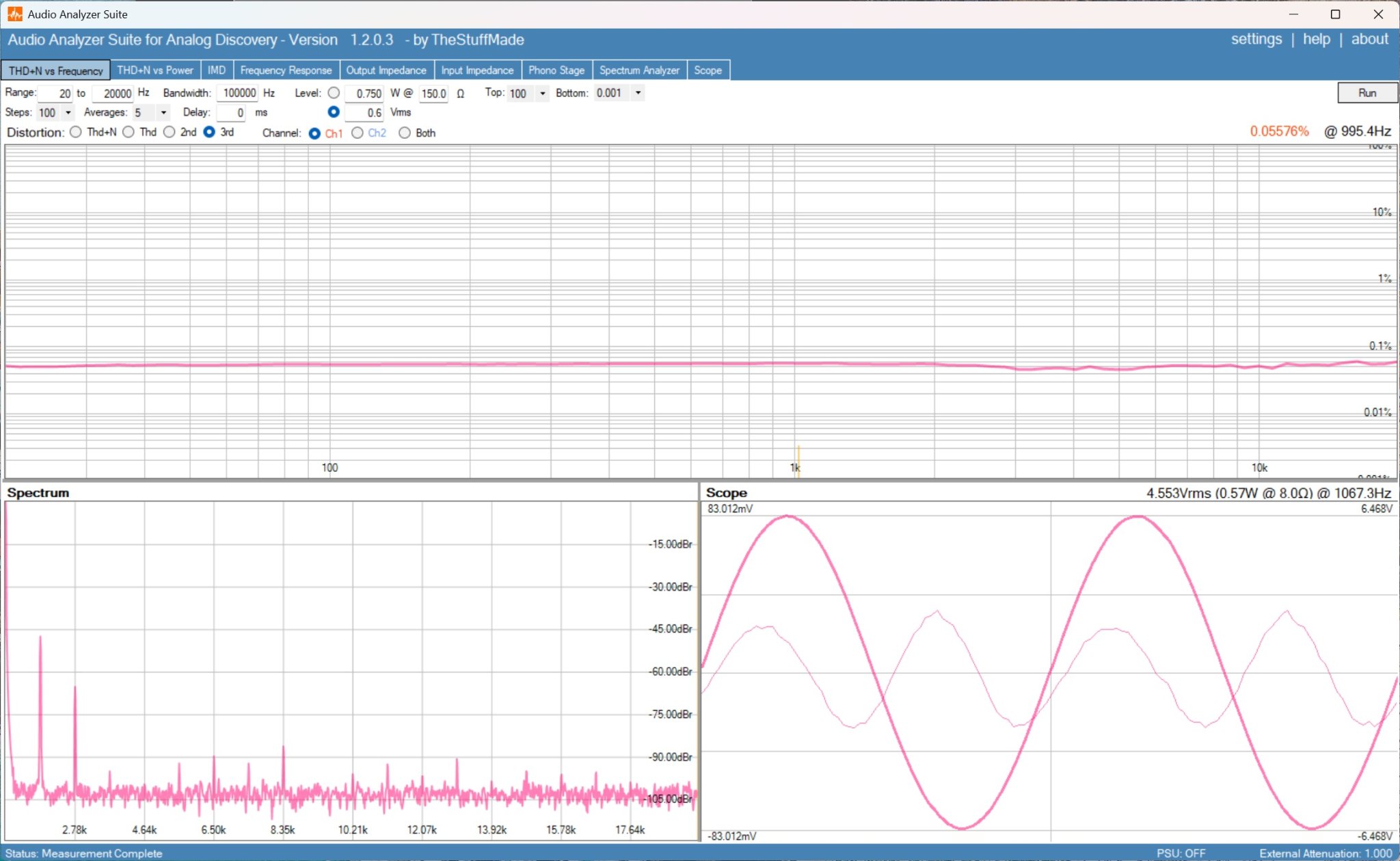

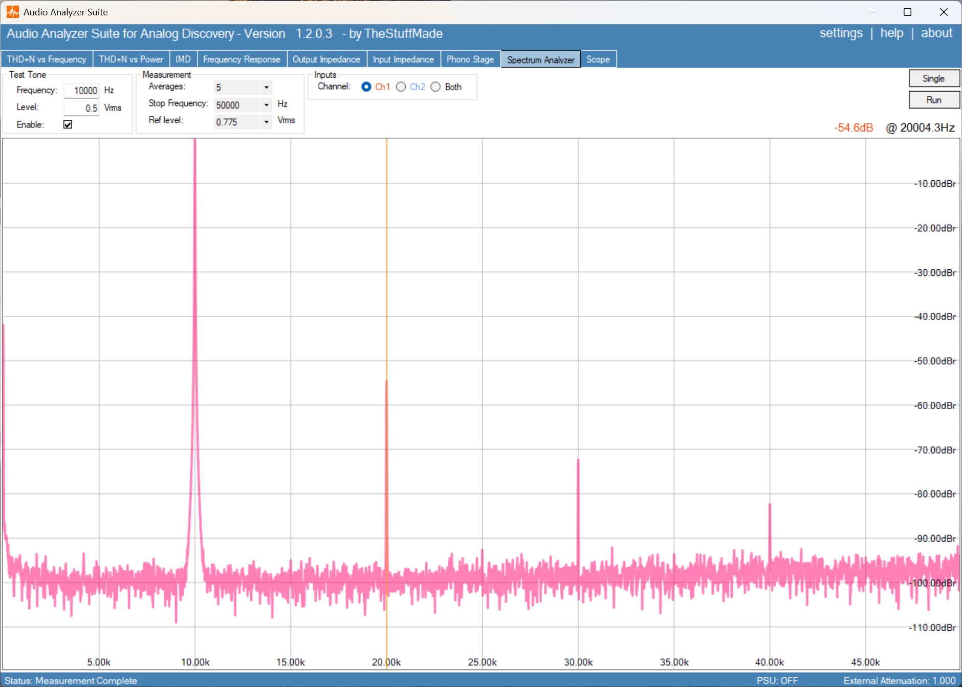

OK, more tests...
The new headphones amp build:
The DC wiring will be better before I close the lid, bit I don't think it matters much, really.
Notice the electron tank on the R25 supply. That thing is nearly half the size of the transformer, which is the new transformer with 2 X 24V in series and static shield (purple wire).
As a first test and verify the validity on last night's initial tests:
Vin: 0.5V
Vout: 3.79 Vrms, 10.78 Vpp
THD+N: 0.47%
THD: 0.38%
H2: 0.37%
H3: 0.04%
Hard clip at 1.3 V of input.
Vds was at about 32.5V for yesterday's and this test.
Now, I jumpered off the output buffer.
Keeping Vds at yesterday's 32.5V.
Vin: 0.5V
Vout: 3.38Vrms, 9.6Vpp
THD+N: 0.23%
THD: 0.18%
H2: 0.18
H3: 0.03%
Hard clip at 1.5 V of input.

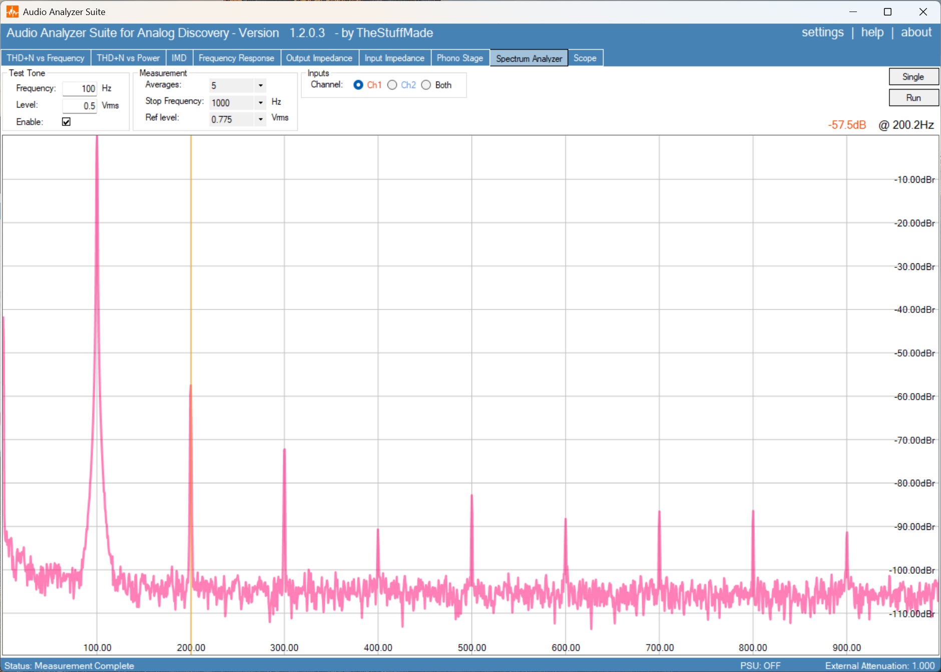

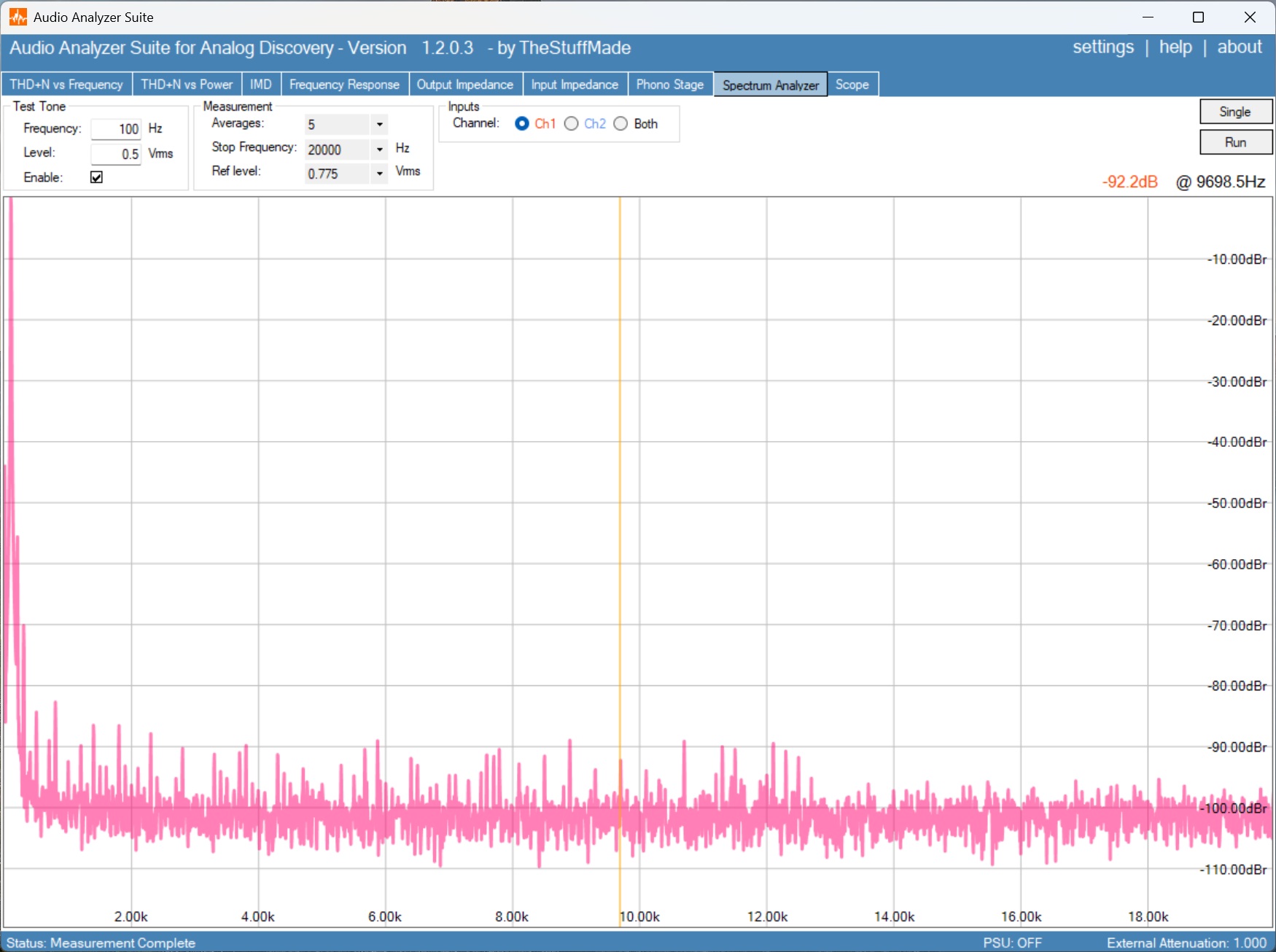

1 kHz spectrum:
100 Hz spectrum:
10 kHz spectrum:
So, obviously, bypassing the buffer seems to halve the THD in that build, which has 59V of R25-regulated supply.

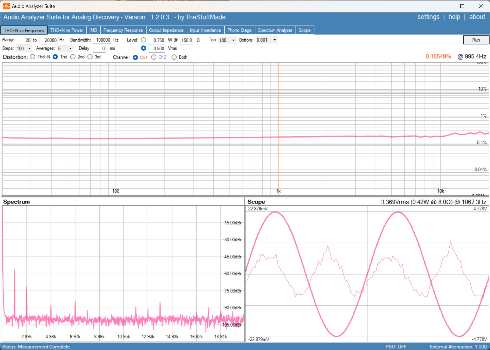

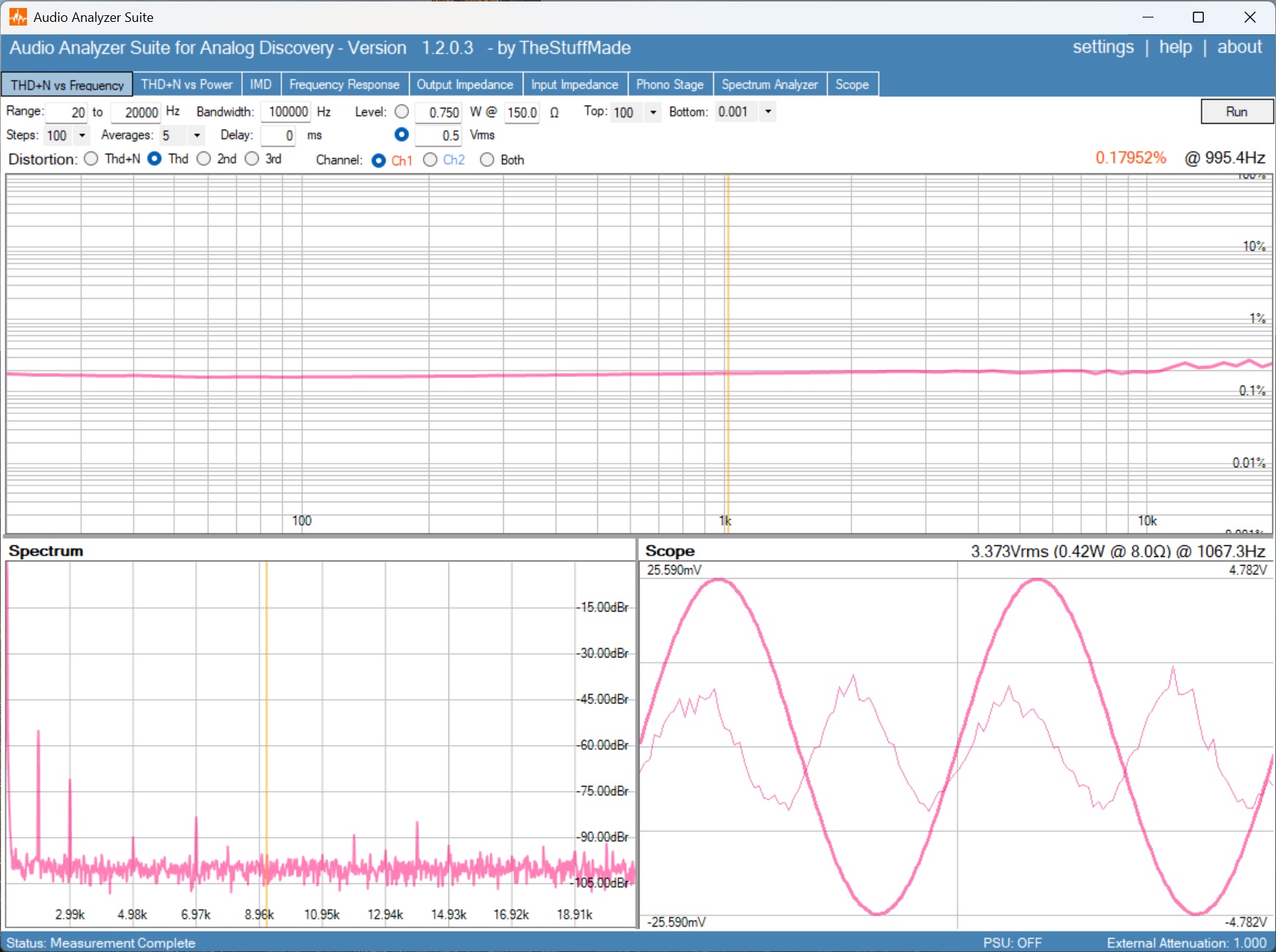

Then, I decided to play with Vds...
At Vds = 35V
Vin: 0.5V
Vout: 3.37Vrms, 9.58Vpp
THD+N: 0.17%
THD: 0.13%
H2: 0.12%
H3: 0.03%
So, increasing Vds reduces THD further.
However, the THD is no longer ruler-flat across the FR.
At Vds = 33V
Vin: 0.5V
Vout: 3.36Vrms, 9.56Vpp
THD+N: 0.22%
THD: 0.17%
H2: 0.16%
H3: 0.03%
The THD is back to being ruler-flat across the FR.
1 kHz spectrum:
100 Hz spectrum:
10 kHz spectrum:
So, H2 at about -55 dB.
If I could supply 66V, this would probably be the sweet spot for this build, but I cannot.
I also tried 31V for Vds and 29.5V for Vds...THD increases as you decrease Vds. At my 59V of supply, Vds should be 29.5V to have symmetrical clipping.
For this build, it's all a matter of how much H2 I desire, Vds could be anything between 29.5 and 33V. The fact THD is not ruler flat at 35V tells me it's not quite right for this build.

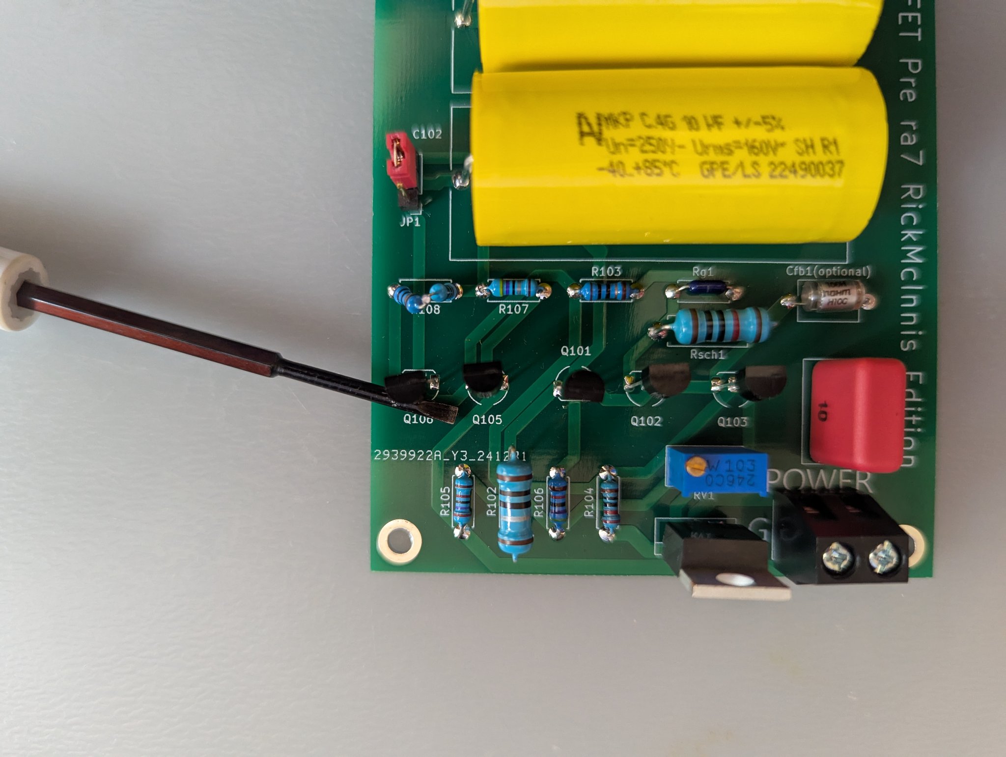

Could we run a wire between both FETs pin 1? Seems like the simplest way to do this. Would this cause I problem I do not know about?
I presume you mean the two rightmost pins? Those are the drains, one connected to power, other to ground. Don’t want to short that. Just leave as is for now. Both Metaphile and Elarte’s measurements are very good. In the meantime, I’ll work on figuring out a solution.

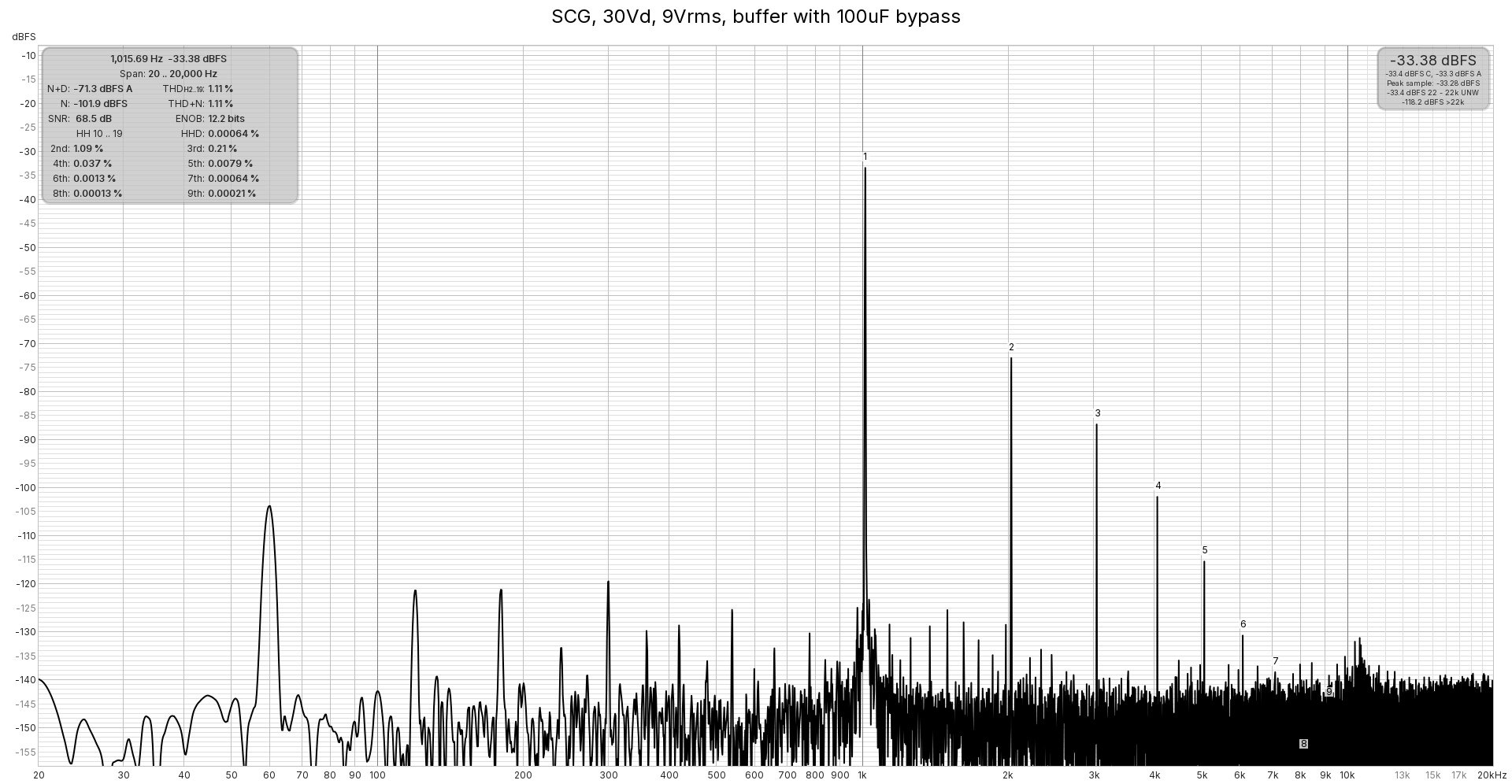

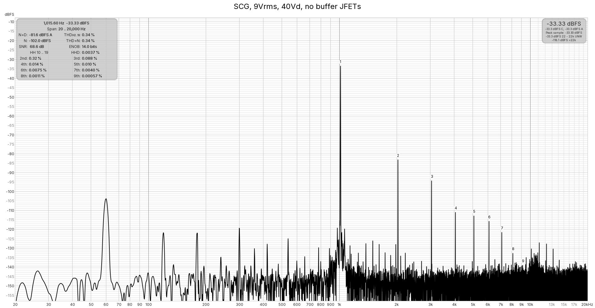

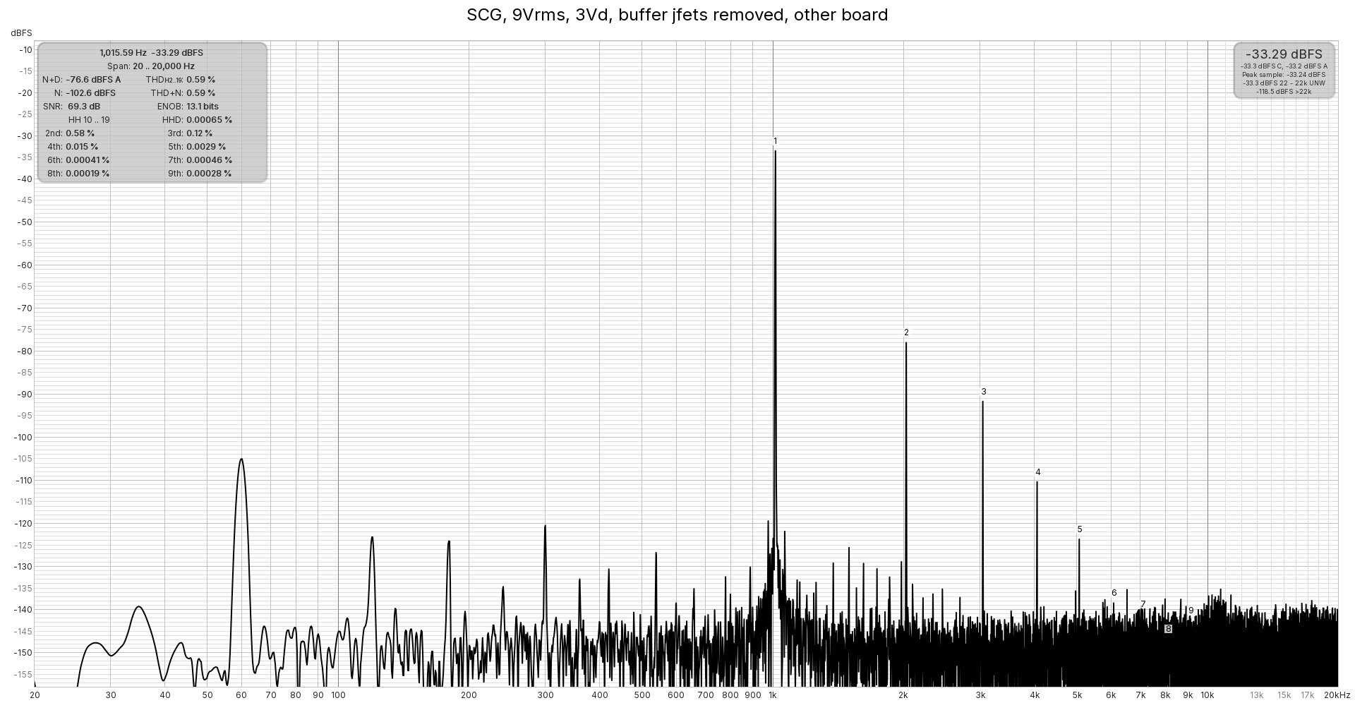

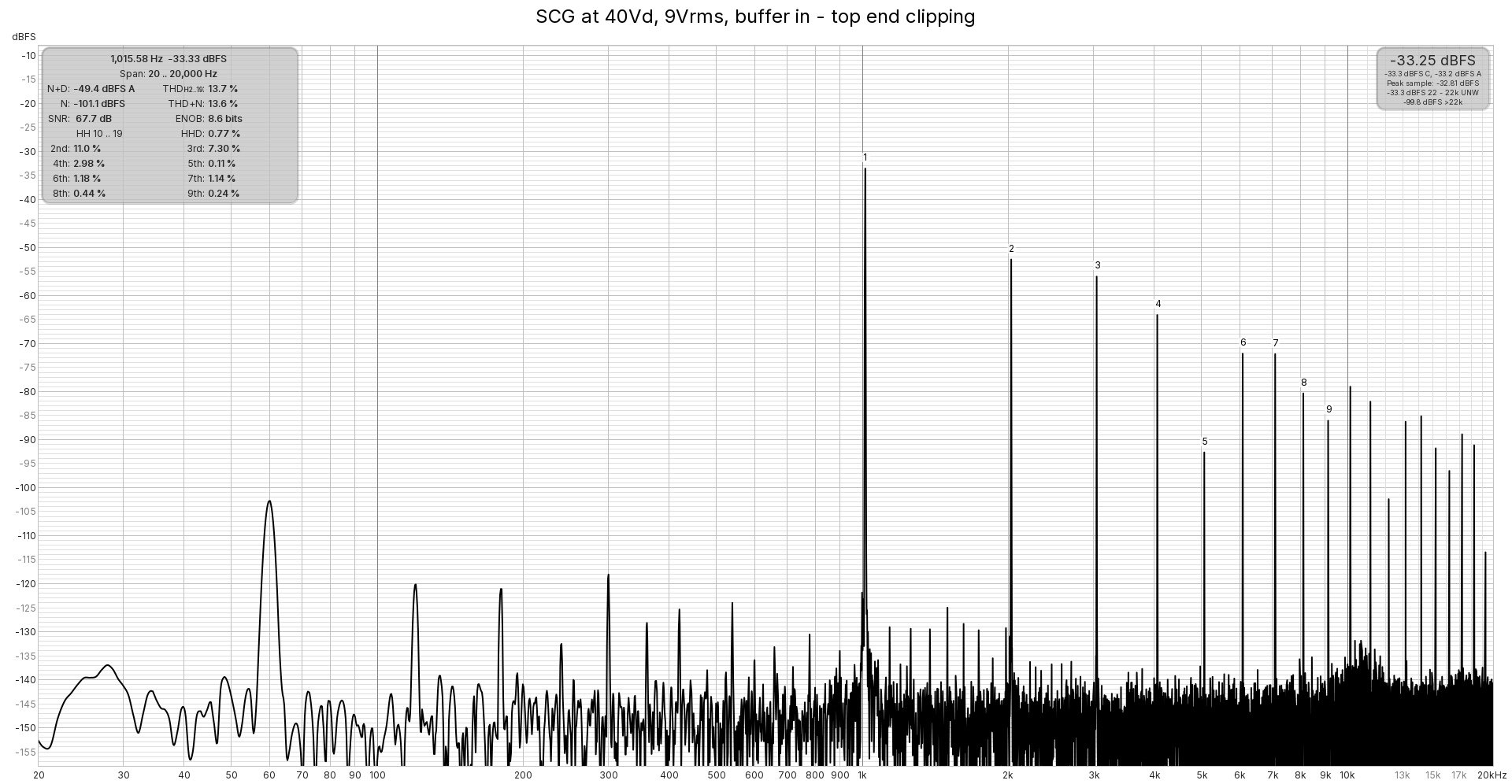

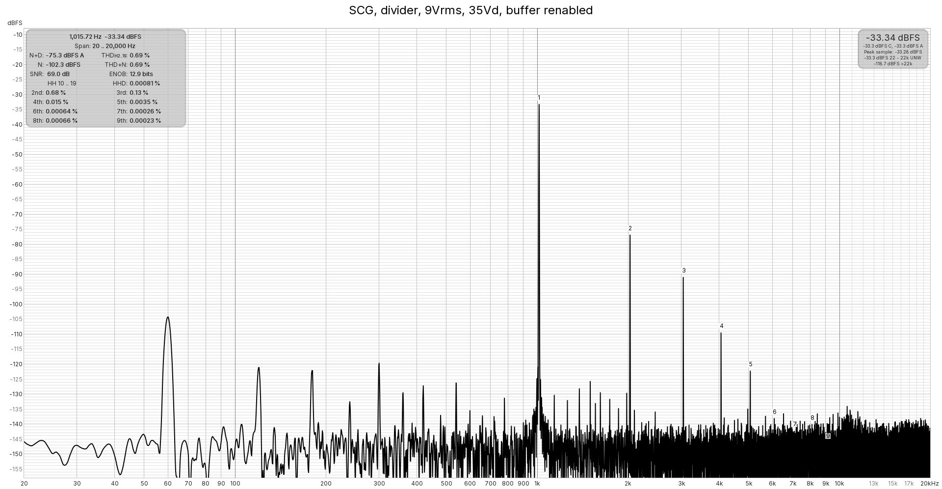

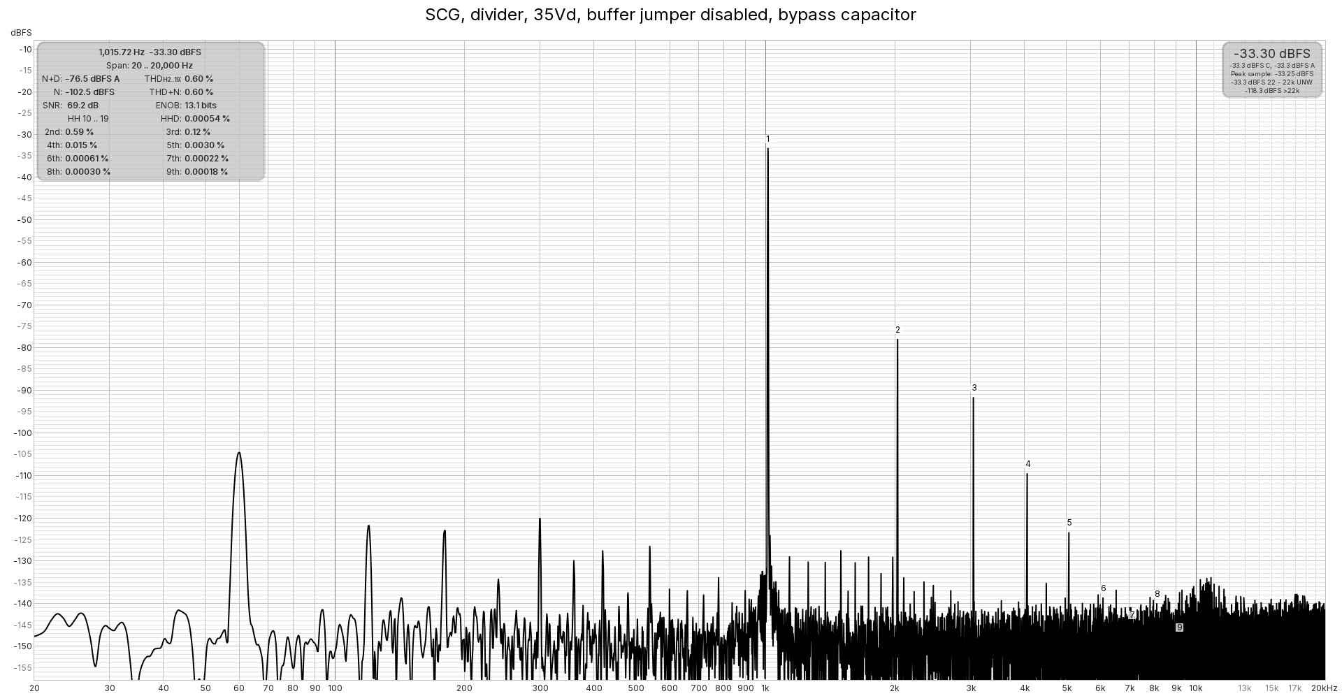

Alright, some interesting new measurements.
Since I have two boards, one with Q105 and Q106 installed and one with them removed, I switched to the one that still had the buffer installed (at first).
Conclusions:
Measuring setup:
Also, the biggest impact on the distortion numbers came from increasing the Vd - a bigger impact at these higher swings than merely jumpering out or even removing the buffer JFETs.
Hope that's all interesting. For my part, I intend to remove the buffer JFETs from both of the board when I install these into my TDV amp and set the Vd to 40V. I'm quite pleased that I can get 0.52% distortion from the preamp stage of the amp at nearly 20W into 8 ohms, which would exceed the capability of the TDV amp anyway.

- At the same Vd operating point, jumpering out the buffer versus removing it makes little-to-no measurable difference.
- The buffer seems to add about .1% distortion at the 9Vrms output level.
- Adding a 100uF bypass capacitor to the V+ rail at the drain of Q105 makes no measurable difference.
- The biggest reduction in distortion resulted from raising the Vd operating point, I tested up to 40Vd. Removing the buffer JFETs allowed me, with the same power supply, to get higher maximum output voltage from the preamp at operating point Vd's above 30V and 35V.
- Recommendation: remove the output buffer JFETs from the board unless you need to drive a challenging load, and increase your Vd operating point to 40V to get lower distortion from this preamp. Operating point versus maximum output voltage can be a compromise, depending on your input voltage. Mine is 60.4V.

- I tried adding a bypass capacitor - 100uF with a 100ohm resistor - between ground and the drain of Q105 (the JFET at the top of the buffer circuit). This made no difference at all the the THD, which was 1.11% at 9Vrms with the buffer enabled.
- I then disabled the buffer - THD at 9Vrms dropped to 0.99%.
- Then I raised the Vd from 30V to 35V - this reduced the THD at 9Vrms to 0.60%. I tried both with and without the bypass capacitor to the drain of Q105. This made no difference in distortion.
- Re-enabling the buffer via the jumper, with the Vd still at 35V - the distortion again increased to 0.69%.
- Starting at 35Vd to compare to the measurement above (ignore the "3Vd" on the screenshot, that's a typo), I got identical performance - 0.59% THD.
- Now, with the buffer JFETs removed, I was able to increase the Vd to 40V without clipping the top half of the waveform. Distortion dropped to 0.34%.
