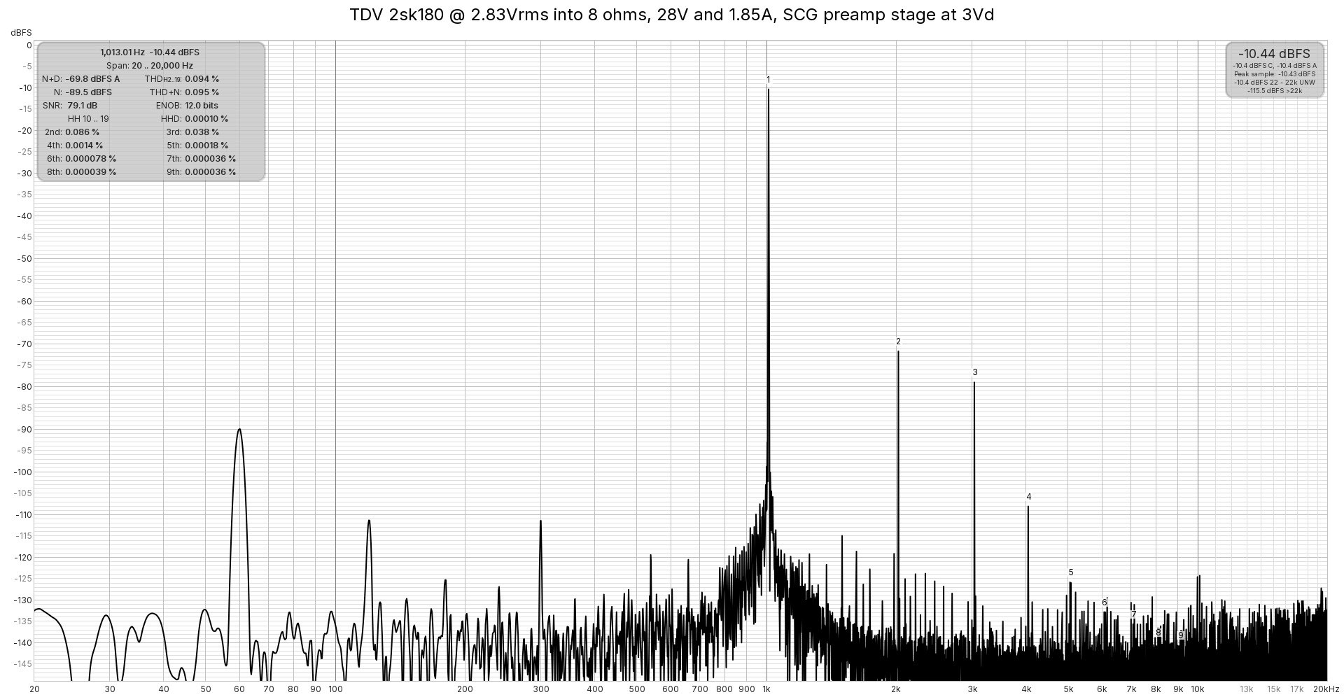

For what it's worth, I finally did some listening this past weekend with the SCG driving the TDV output stage. Just one channel, but I'm very happy with the sound. I'm no Stereophile writer but I would describe it as both detailed and non-fatiguing. It definitely sounded, to my ears, "tubey".
From a measurements perspective, once I had tweaked the SCG by removing the buffer and also adjusting the Vd to ~37V (this is what I settled on with my 60.4V supply) I measured the distortion of the whole amplifier at 1W into 8 ohms and it had dropped to 0.094%. My prior measurement at the same output was 0.25% - but this isn't a controlled experiment, I took that previous measurement with the amplifer output stage on my bench supply and prior to adjusting the SCG. Either way, I'm happy.
Now I'm anxious to get going on the enclosure for this project so I can give it a proper listen.

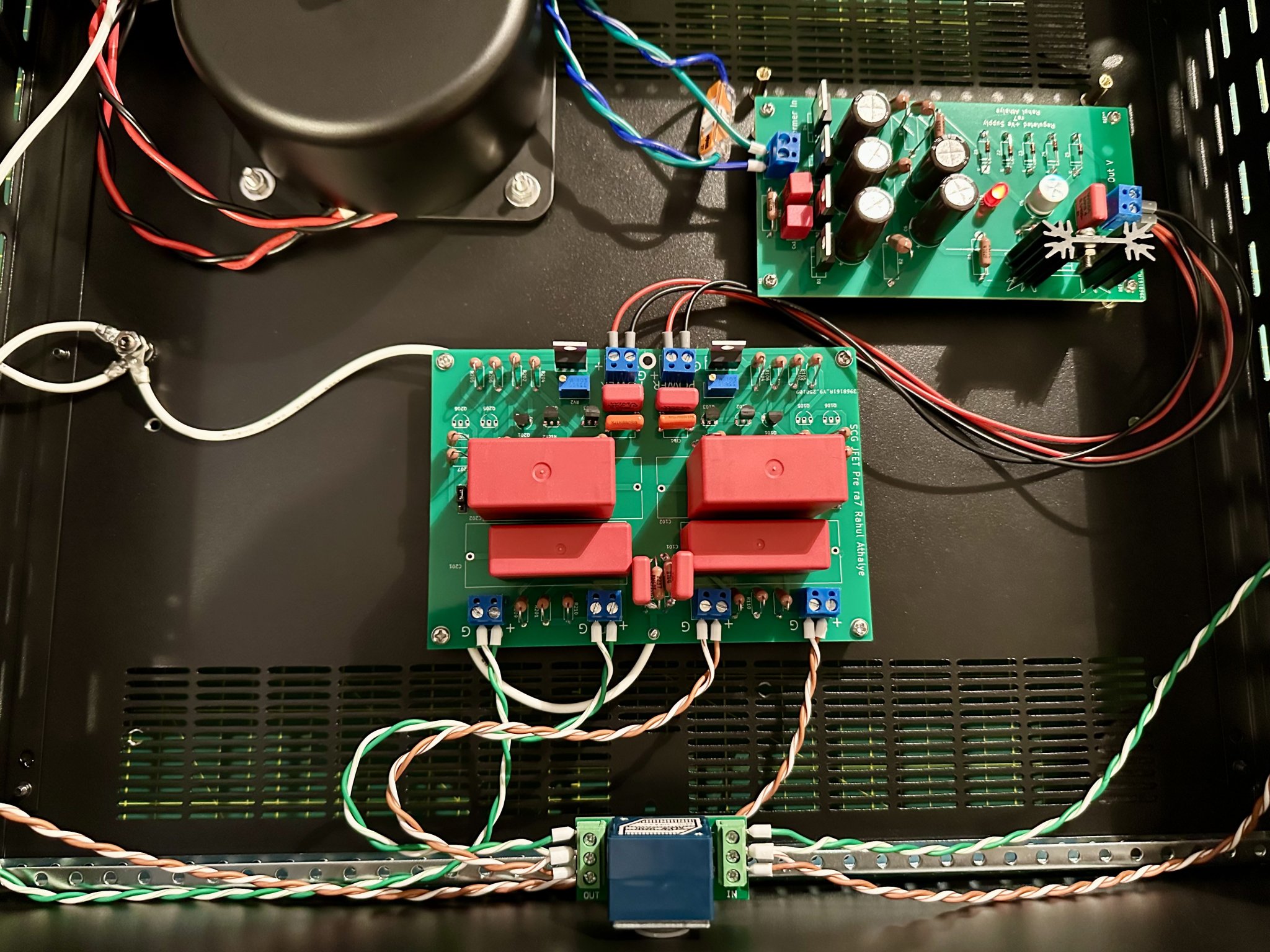

The rebuilt preamp build.
@metaphile
With power supply at 68V and Vds at 34V and output JFETs desoldered, it really does what it’s supposed to do.
THD will rise as input level increases, but in practice, when you have a power amp after it, input level will be much much lower than 2V and THD will indeed be much much lower.
I still need to clean the bench area, put a knob on it and set it up for listening with proper speakers. I am sure it’ll be greatly great. Dialed Vds down to 34V for extra tubiness, which puts it at half the supply, as originally intended.
Papa says it sounds pretty good when distortion rises linearly with level as long as it stays below 1% or so. This preamp does exactly that. It’s H2 dominant and starts low and increases linearly with a ton of headroom (clean swing). Hang a follower on it and you’re golden.
I approve this message.

The report I promised is delayed a bit. I am chasing a noise issue that is pot-sensitive (highest in the middle position) and only when output RCAs are connected to an amp.
As a test, I put a cheat plug on the amp, but it had no effect, which eliminates the possibility of a ground loop introduced by the amp.
When the amp is not connected, there is no noise at all no matter the pot position.
I don’t think it has anything to do with the removal of the output buffer, but, alas, I didn’t test that when it was still in place.

I put the preamp build back on the bench to sort out the noise issue.
I don’t think the gain is reduced.
I’ll reread your post tonight to make sure I understood everything.
So, it seems the input impedance (unknown) of the amplifier doesn’t agree with the output impedance of the preamp. In this very specific case.
There is no ground loop. The pot is not at fault either. All was quiet on the bench, with headphones connected to the RCA output jacks, even though FR was clearly off, because no headphones buffer in between.
I’ll try with another amplifier, of known input impedance.
