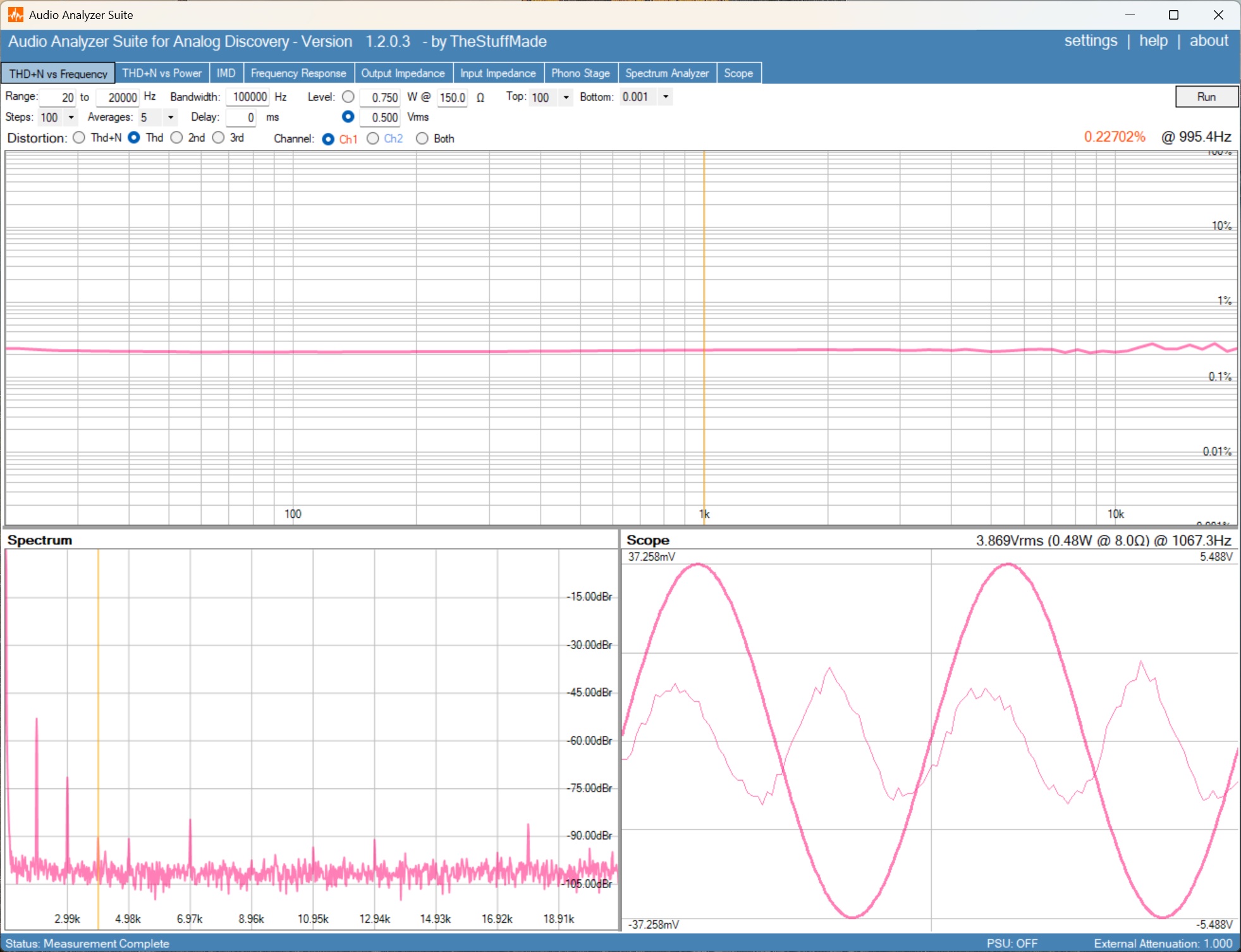

So, this is the pure preamp build...with output buffer JFETs desoldered! It went well.
After putting the secondaries in series, I get about 68.5V out of 1 PSU board. I share that between left and right channel.
34V Vds
Vin 0.5V
Vout 3.86 Vrms, 10.97 Vpp
THD+N: 0.29%
THD: 0.23%
H2: 0.23%
H3: 0.03%
Rounding errors apply.

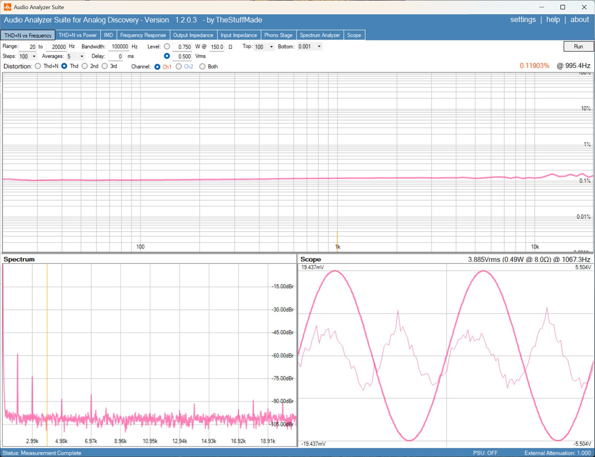

40 Vds
Vin: 0.5V
Vout: 3.88Vrms, 11.02 Vpp
THD+N: 0.16%
THD: 0.12%
H2: 0.12%
H3: 0.02%

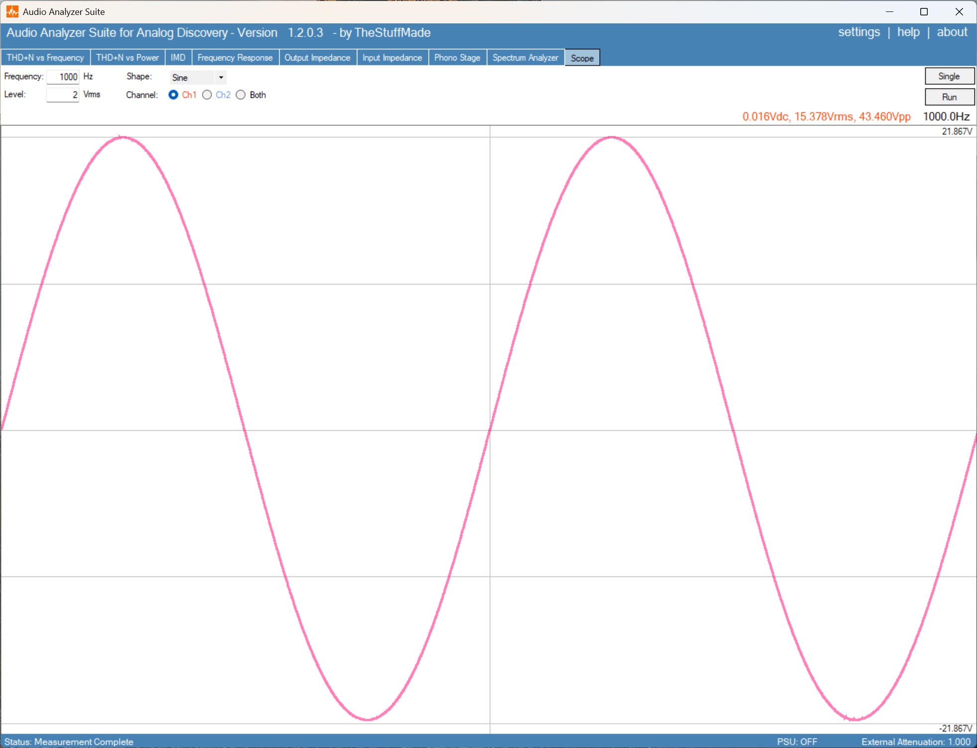

Now, as far as swings go...
Vds 40V
Vin: 2V (a full 2V)
Vout: 15.34Vrms, 43.46Vpp
This is quite a clean sine.
Clipping doesn't happen until around 2.2V of input.

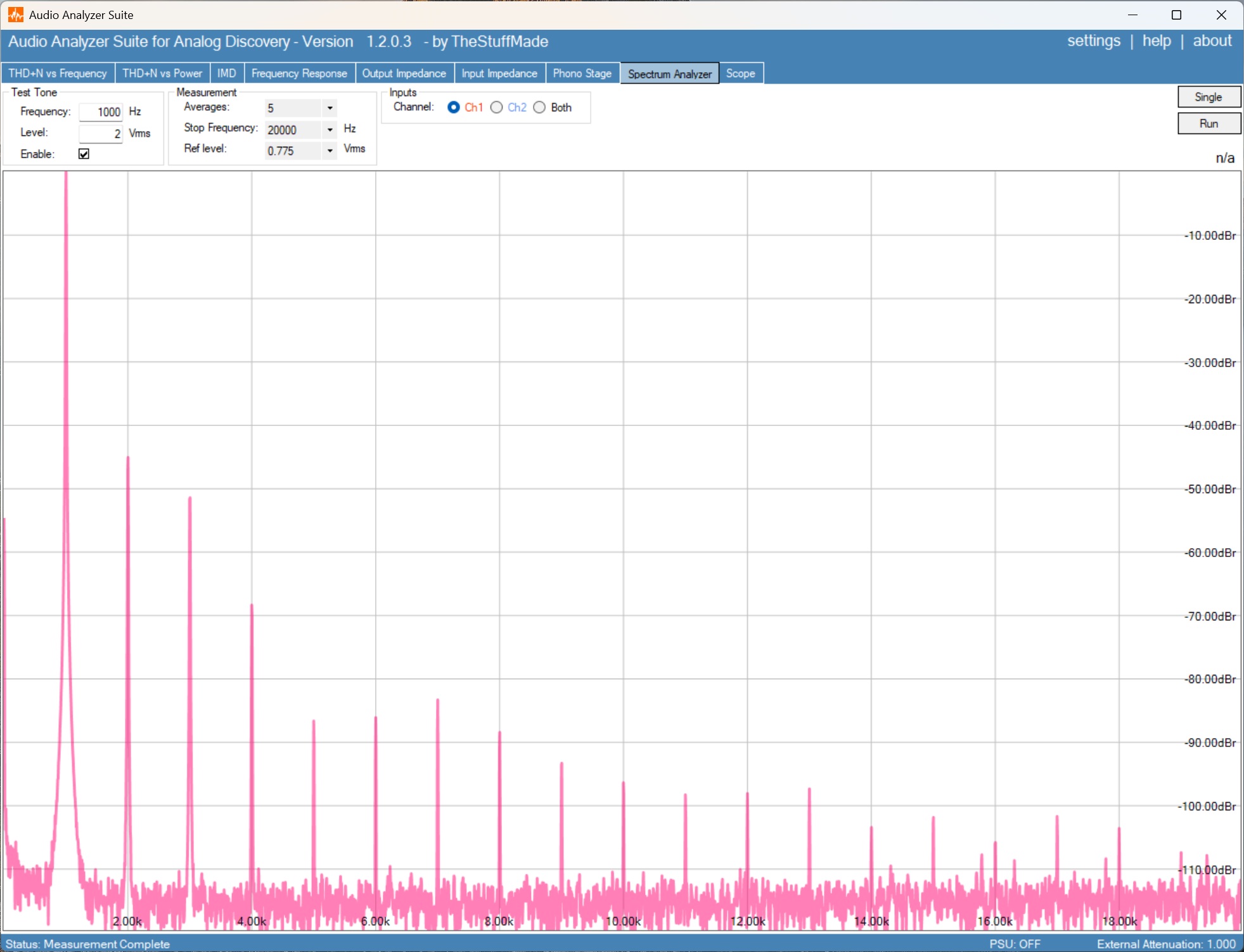

That's the corresponding spectrum. There are more harmonics in this party, but still quite decent.
