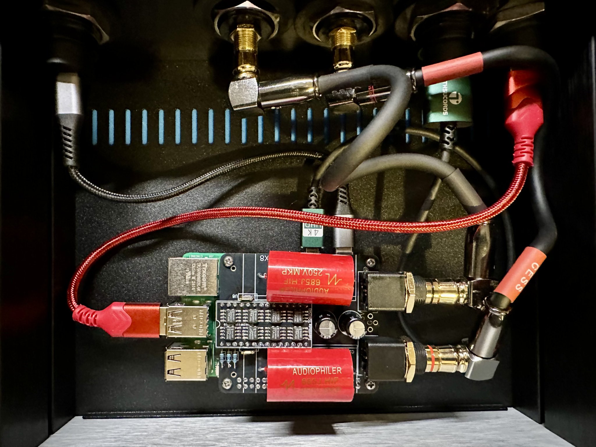

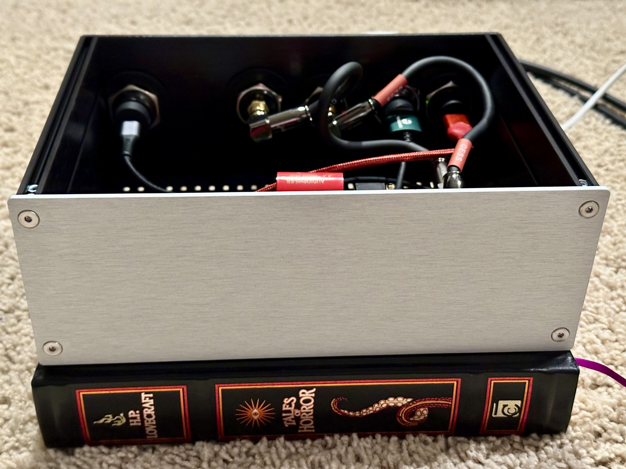

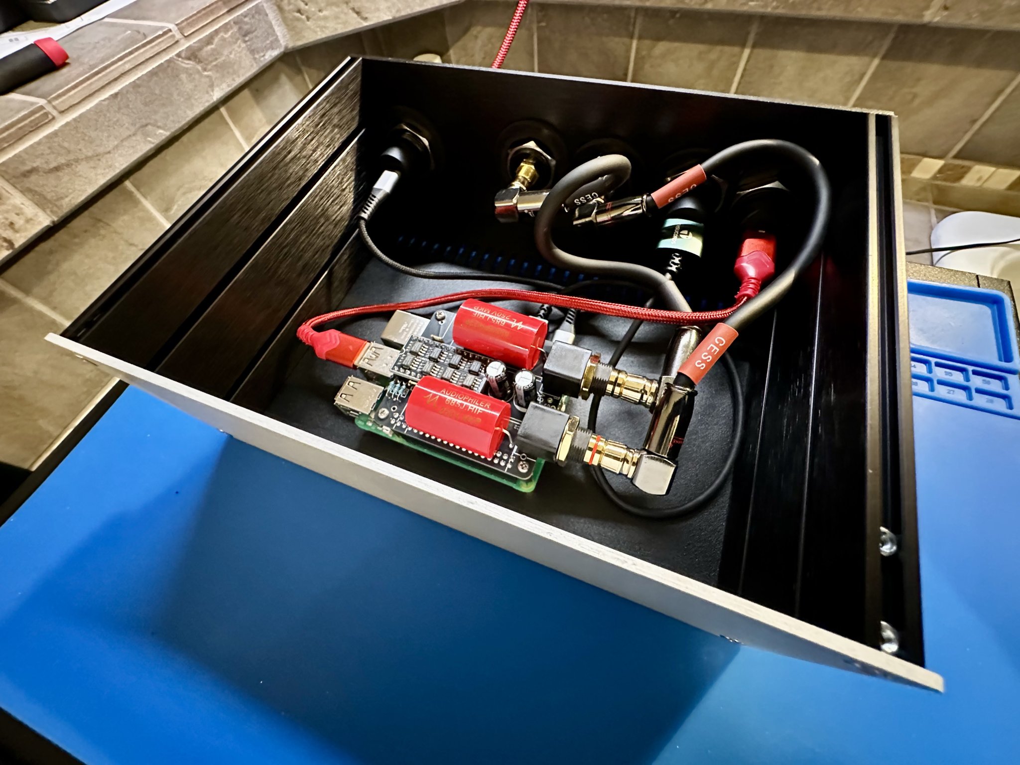

I want to say it’s an entry level DAC/streamer, but I cannot tell when I listen to it. My Lord, what a rabbit hole!
Looks fantastic! Don’t tease us with those pics… tell us more. Which DAC is it? I recently ordered an R2R dac as well, though it hasn’t arrived yet.
@william2001 I totally get what you are saying with too much H2. I don’t need a lot of power, so the single ended follower is just right for me. But a push-pull lateral follower would cancel most of the H2. Now that would be interesting. Of course, there are tons of amps with that config already. Would be fun to try that with SCG driving.
It's a ProtoDAC. TD1837 X 8. A NOS DAC HAT on top of a Raspberry Pi 5.
In its current incarnation, the PSU is shared between the Pi and the DAC, which is not the best scenario. But it sounds pretty great already, probably because the Pi only has 1 job: Running the RAAT bridge.
At some point in the future, I'll add a low noise linear supply for the HAT, but for now, I just need to clean up the build and put a lid on it.

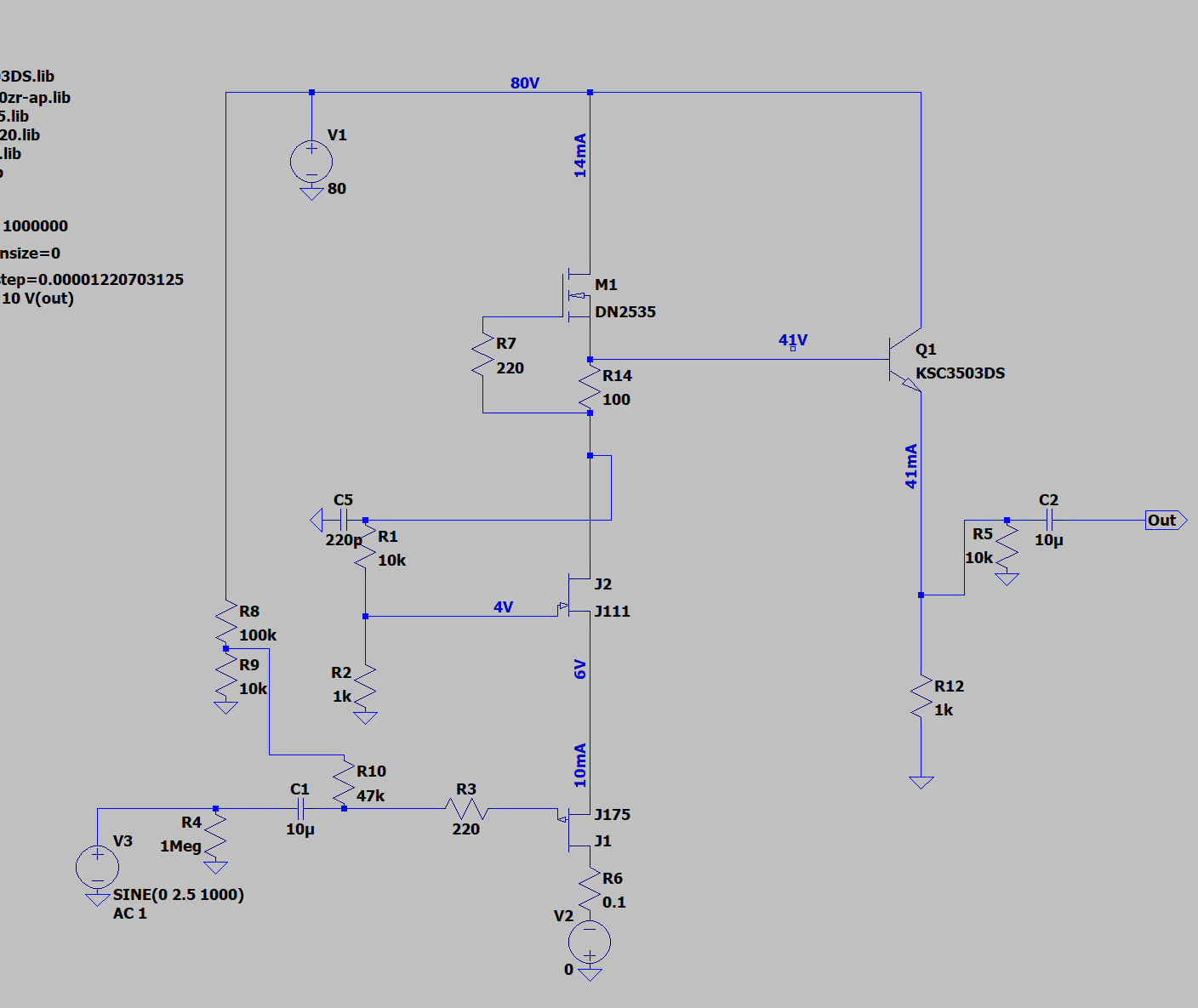

Thanks for posting your beefy driver, three questions if I may:
1). In post 1863 you had a J113 below a DN2535 but in post 1913 you got rid of the J113 and replaced it with a resistor, is this for better sound?
2). In post 1913, I think R5 should be on the other side of the 10uF output cap, as drawn it is in parallel to the 1k resistor, lowering the resistance hence increasing the output current beyond your 40mA.
3). If I was to build your Elmo, how do I eliminate one capacitor by mating the SCG which has an output cap to Elmo which has an input cap and biasing arrangement without stuffing up the lateral's bias and input resistance etc?
1) That's just how my trials in Spice went. Result of multiple edits to the schematic in Spice. The J113 should be in the SCG CCS.
2) Yes, that's right. It's a remnant from a previous trial in Spice.
3) You can eliminate the cap in the SCG or the Elmo. If putting SCG and Elmo into the same chassis, this makes a lot of sense.

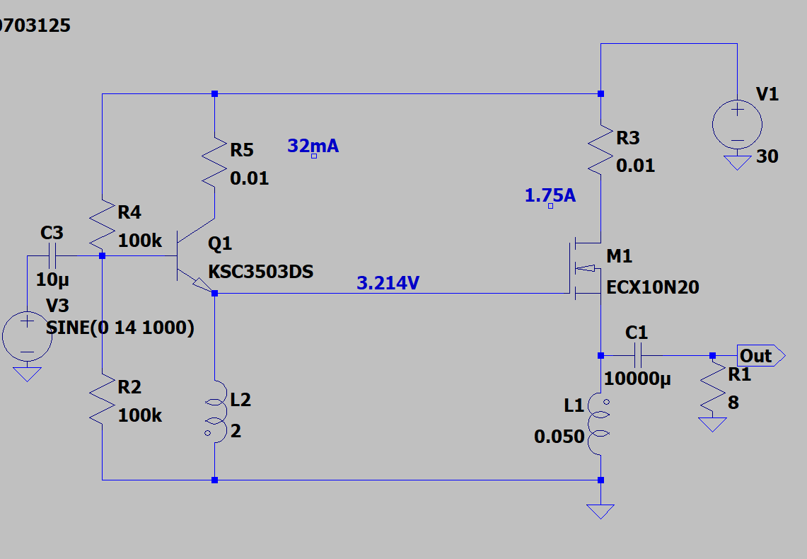

Here's where my standalone Elmo (when not driving with beefy SCG) development stands. This is for illustration purpose only. It WILL definitely change before calling it final. The point here is that you could direct couple the lateral FET driver (KSC3503) with the output stage, but the input will need a cap. This is easier to do when building the power amp section separate from the gain stage (standalone Elmo). Alternatively, you can direct couple the driver to SCG (as in post 1913) and put a cap between the driver and the lateral FET, thereby saving one choke (L2 below). The choke in the schematic below (L2) is simply so we don't need two power supplies for Elmo, otherwise to get symmetrical swing, we'd need a bigger supply on Q1 or a bipolar supply.
