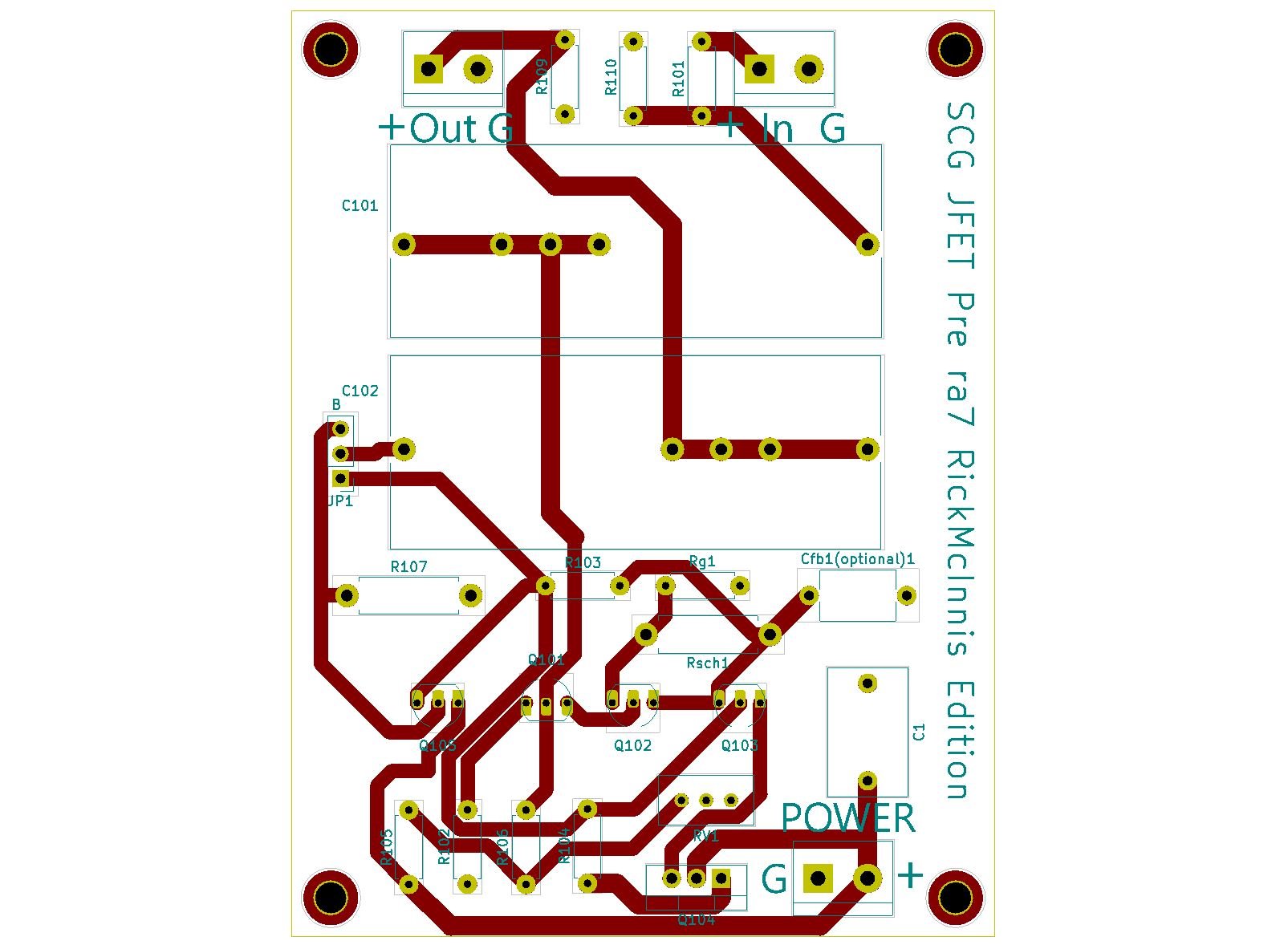

Attached are revised gerbers with the single-ended buffer. The footprint for the 4k7 resistor has been increased to allow for a bigger resistors to be used. Enjoy!

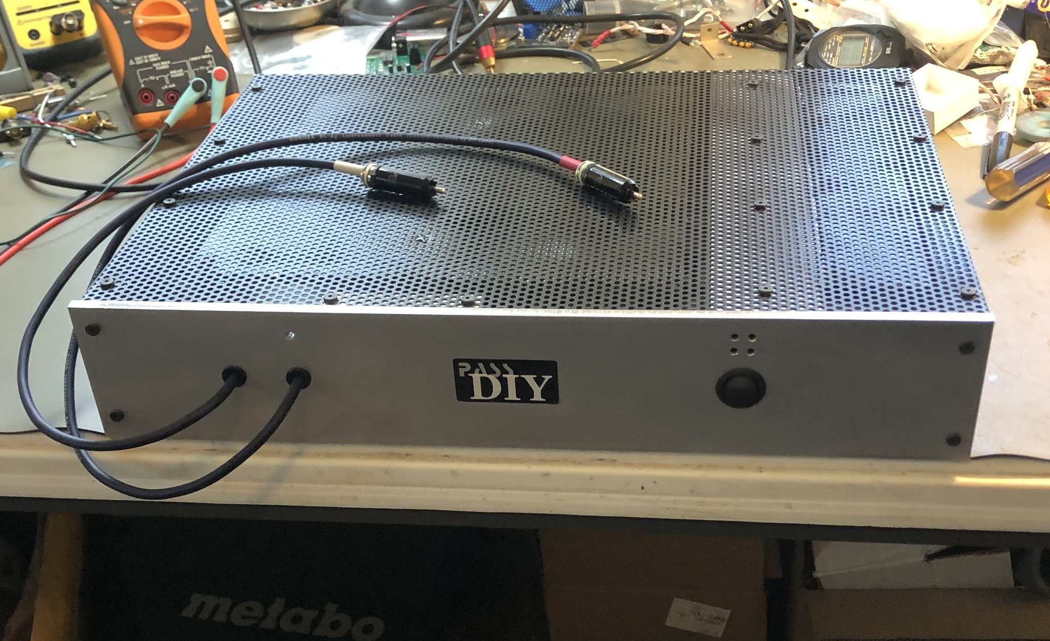

Almost ready to try in the system. I need to do a little work on the mono blocks first.

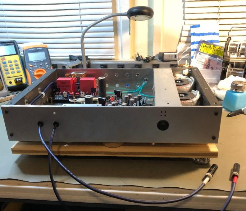

This chassis has housed multiple different projects which explains the unused holes there. It used to be a full featured preamp but at this time it's just a stripped down hot-rodded external amplifier front end only. Only one source and volume is controlled upstream. My output signal cabling exits through the front because the mono blocks live on the floor in front of the equipment shelf.

Lovely! I operate it similarly, just with a volume pot. Curious about the monoblocks this will be driving.

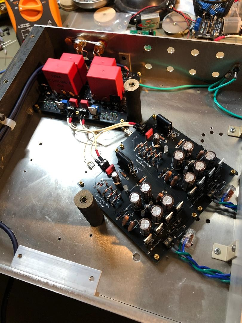

Big CRC supply, rails ~27V. The onboard opamp is "just fine" of course, but we'll bypass that and feed it the DHT, I mean SCG instead..

Oh, it is the HGF. That should be a deadly combination. I predict sonic blissfrom the HGF thread...

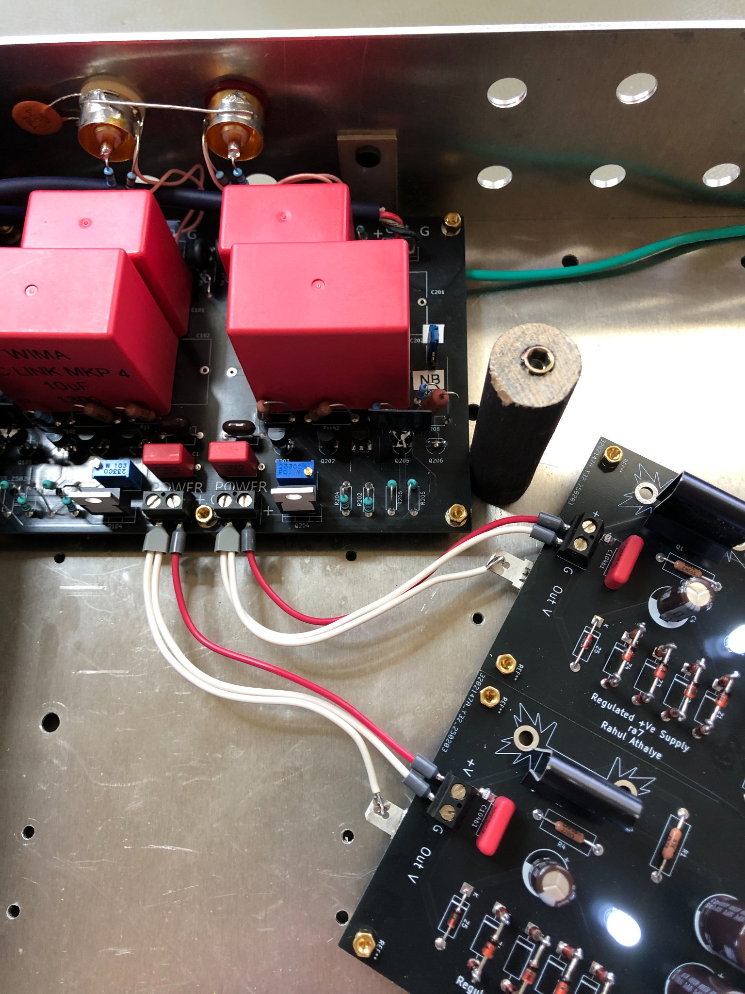

OK, under microscope, I couldn’t identify any cold joint or bad contact. Wiring at terminal blocks was also reliable.
I still reflowed some joints with flux. Cleaned up the board and put it back in.
And that puttering noise was…WORSE!!!
Today, line level was higher than last time.
That got me thinking…I dialed the Vds on preamp boards to 30V from 35V for both channels…and that was like a magic volume knob for that puttering noise. At 30V, there’s no noise at all!
My test set up for this is drastic: The output of the preamp is connected to a THX (extremely low noise) amp, and I have high-sensitivity headphones connected to that THX amp. I don’t have any source connected to the preamp. So, I am listening for the preamp self-noise.
My suspicion was on the supply board, but the noise was from the preamp board.
So, it seems, at 69.5V of supply voltage, it seems my part can only handle ~30V of Vds.
Which is entirely fine for me. I am glad I got that figured out.

Last couple of pics after a few revisions / corrections. Both channels quiet now on my Sennheiser headphones. This was just for testing purposes, my SCG will only feed the HGF output stage in use. Had noise initially, and accidentally damaged the amp during the fault finding / testing process. Waiting on parts... With no volume pot, I moved R101 and R110 up to the RCA jacks (some nice MANLEY's), and those values are 1K and 10K respectively. Both input grounds bonded together (kinda obvious) to avoid any cross channel ground loops. The ceramic disc cap (.01uF) shunts unwanted RF to chassis ground.

HiAttached are revised gerbers with the single-ended buffer.
What is the Voltage value of power supply?
And how much current device is consuming?
