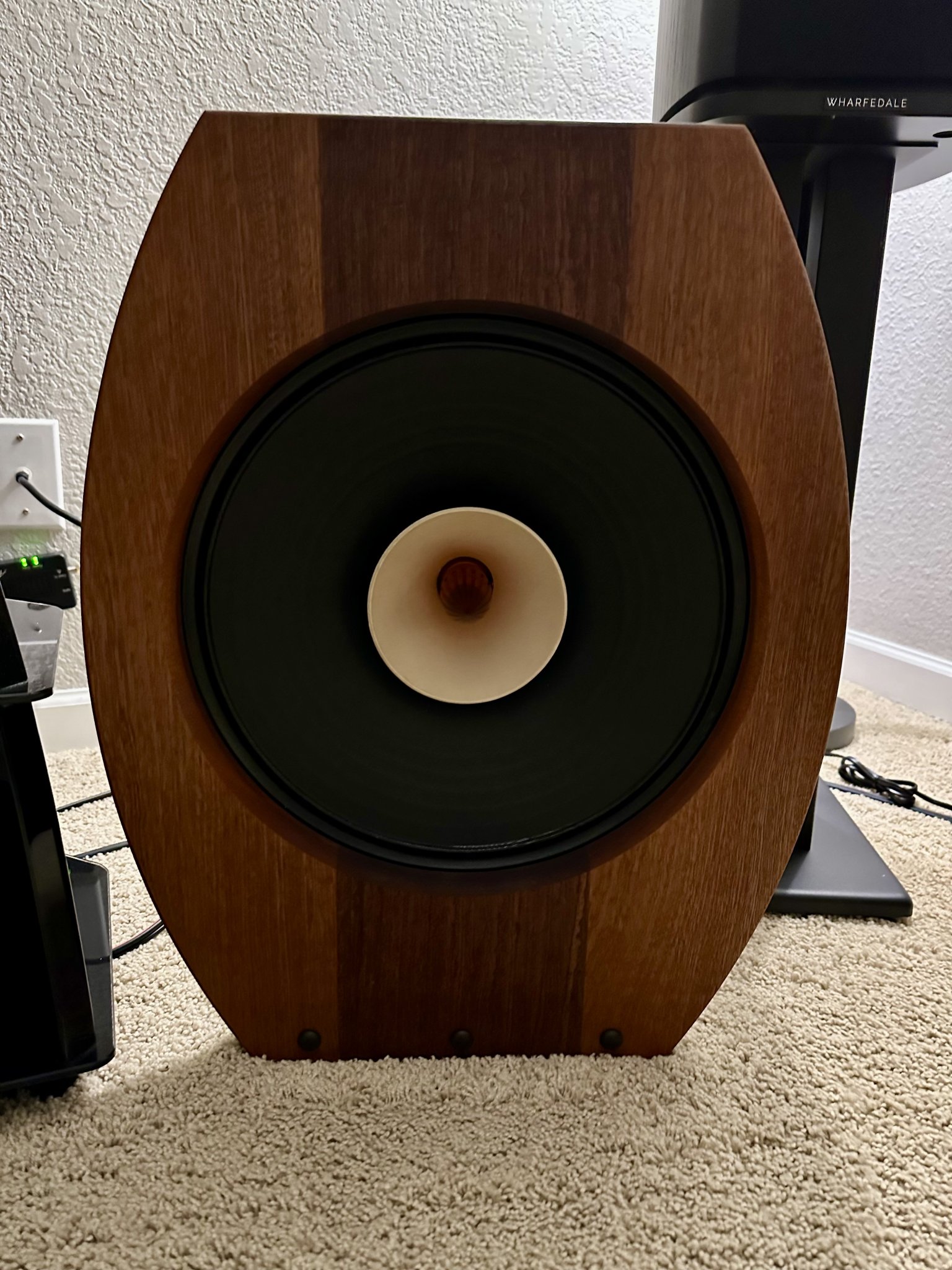

I had somehow manged to destroy my right hand CD so when installing the replacement I added the "phase plug" (an illegal copy - please do not tell anyone) if there could be anything more generic looking than this phase plug which is not a phase plug. Mr. Delgado came up with it for the K402 domestic edition he calls JUBILEE UBER ALLES or something like that.
I do think it makes the high frequencies less directional.

Those speakers look cool! Are those 15” dual concentric?

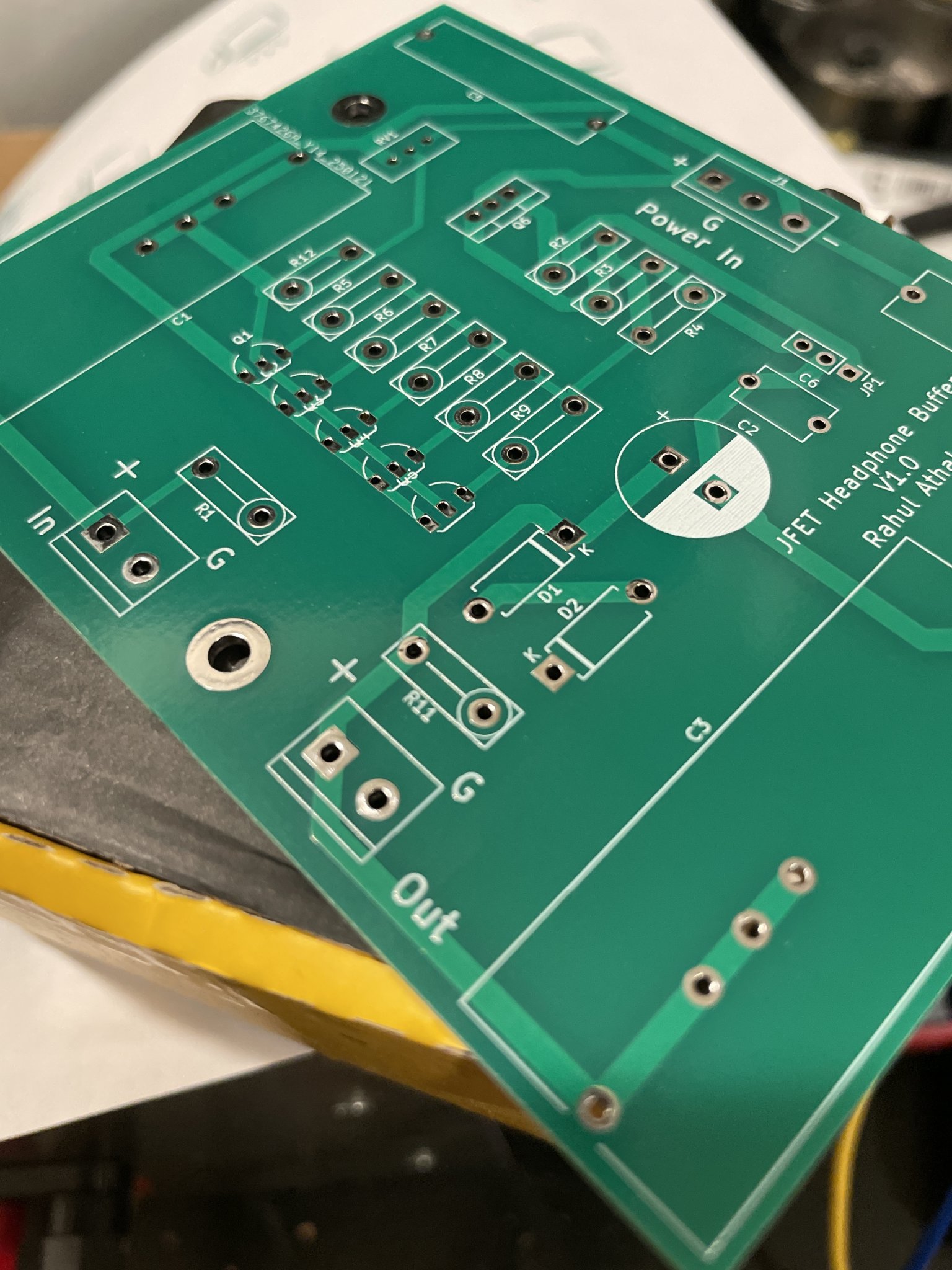

An all-JFET headphones buffer… 😵💫😵💫😵💫
15” full range OB. I have to run them with a sub, but they magically disappear in the room and then music seems to appear out of nowhere. It’s quite a trick.

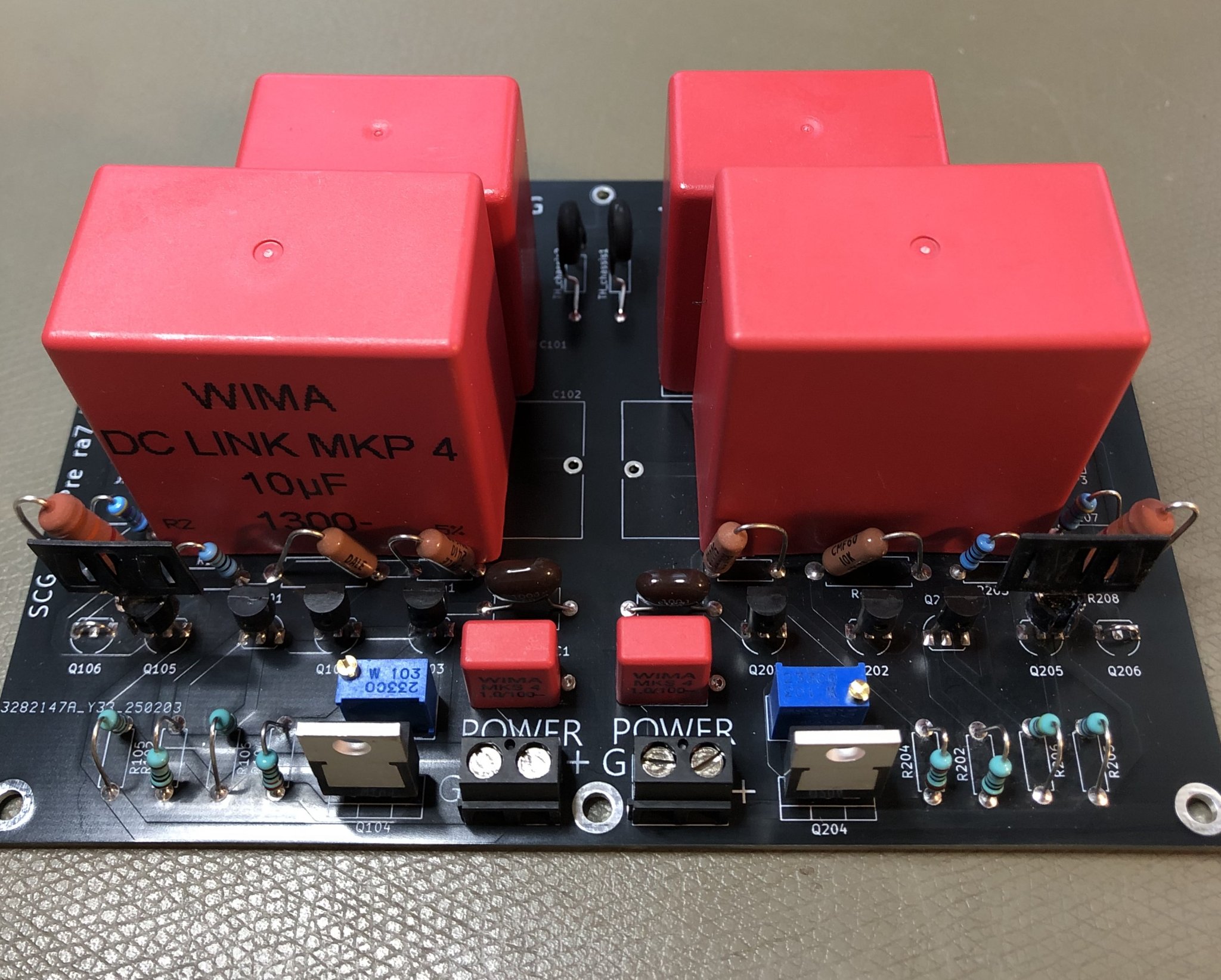

I've got a gain of 8.2x, which is going to be a little low in my system if I'm throwing away my tube pre and current front ends in the amp and trusting the SCG to provide all the voltage gain for that DHT goodness. Can Rg1 be safely lowered here without making a mess of things?
Yes, it can be lowered, or Rsch can be increased. Might have to readjust the voltage at the output after the change.

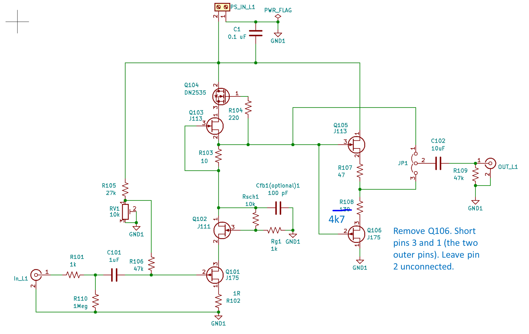

Here's the updated buffer. It replaces J175 with a resistor. This makes it a single-ended buffer and the whole preamp is now single-ended. I have measured three channels with this change with repeatable results, so it should work in your builds as well. If you intend to use the buffer, this is what you should go with.
The 4k7 resistor together with a voltage at the bottom of R107 of about 40V should give a little less than 10 mA of current through Q105. There is some flexibility with the 4k7 (R108) resistor. You can go lower to get more current but be sure that you are not exceeding 400 mW of dissipation on Q105. For example, if your supply is 65V and you have 40V at R107, then the current through Q105 is 40/4k7 = 8.5 mA, and voltage across Q105 is 65-40 = 35V, making the dissipation about 300 mW.

Thanks for your patience with these changes. This should wrap it up for the SCG JFET Pre. I will post updated gerbers and BOMs this weekend.

I don't have a 'scope at home but the equipment I do have says this thing should be ready to make some noise, hopefully the good kind. Gain is 12.5x with Rg1 @500 ohms. Good timing on the final buffer so I have that installed as instructed.. hot off the press... Final assembly will take some time, I'm kinda slow usually.
