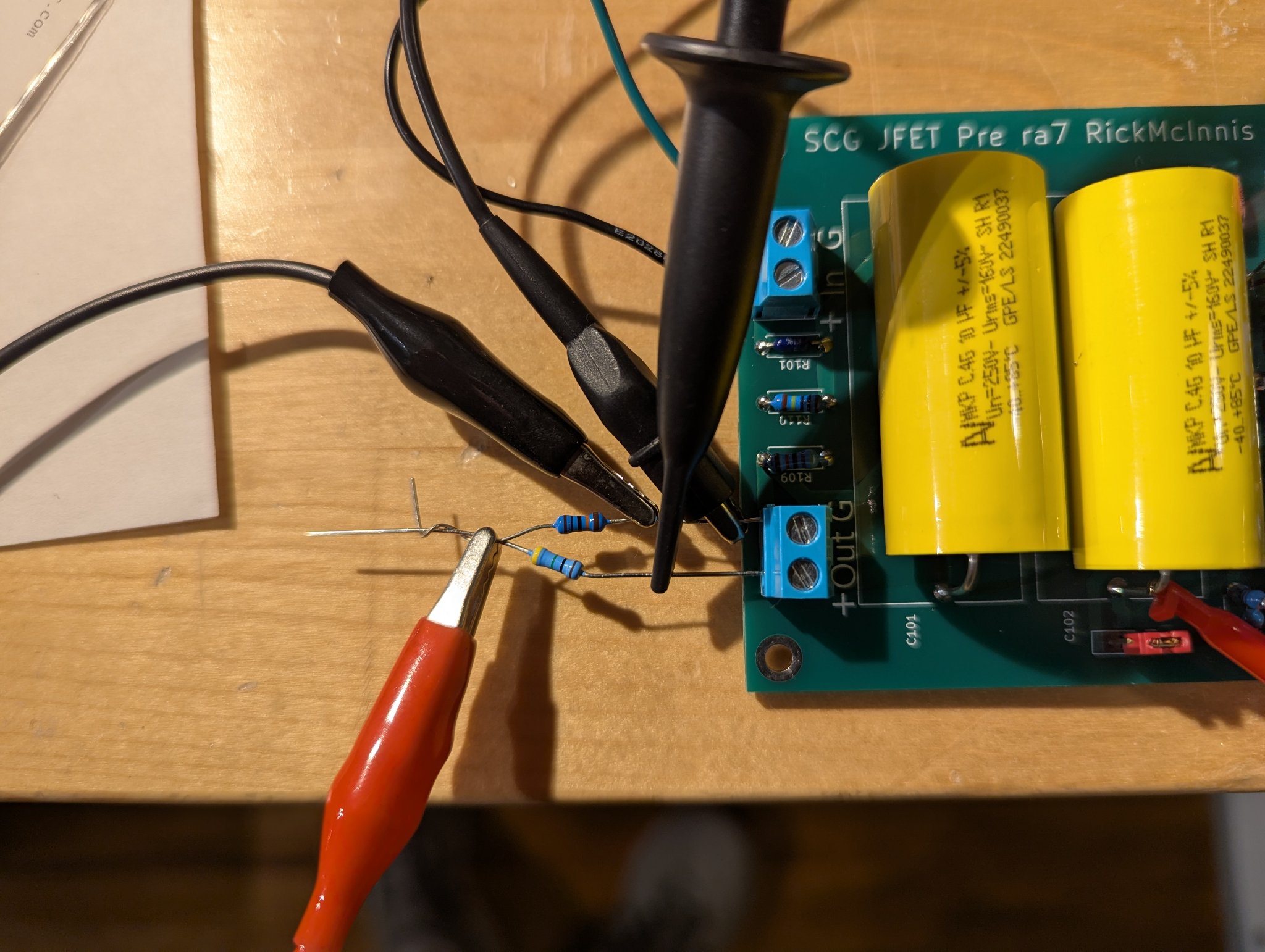

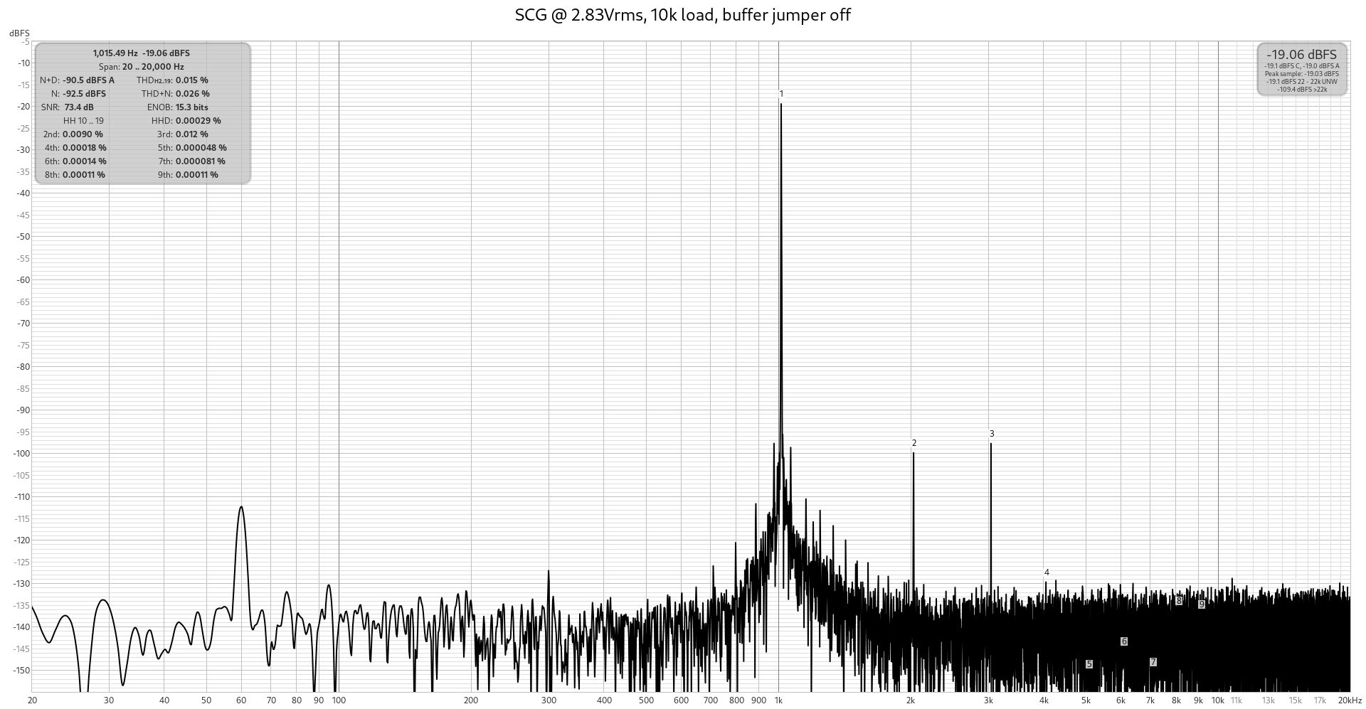

I set up the preamp and took some distortion measurements tonight; you may find my findings interesting.
First of all, baseline setup:
- I am using @ra7 's regulated power supply board with a Hammond 166G50 power transformer. That's a 50VAC single CT secondary @ 500mA. My Zener string is made up of 3x 20V Zeners and 1x 6.2V Zener and I get 60.4VDC into the SCG preamp. I tried raising the supply voltage by swapping the 6.2V Zener for a 15V Zener; this gave 69.4V but there was a significant amount noise on the output of the preamp (~30mV if I recall correctly), so I reverted back to the 20-20-20-6.2V zener string. Noise went away. Probably need more headroom from a beefier transformer to get a less noisy result around 70V+; opinions welcome.
- Per @ra7 's suggestion I set the operating point at 35VDC. I noticed it comes up slowly as the preamp warms up so I gave it some time to settle in.
- I'm using an Akitika 1Khz oscillator to generate the test sine wave.
- I'm using a Focusrite Scarlet 2i2 and REW to measure distortion.
- Measuring across a 10K resistor at the output of the preamp. Scope to measure signal amplitude, Focusrite to measure distortion.
Buffer in place, baseline measurements:

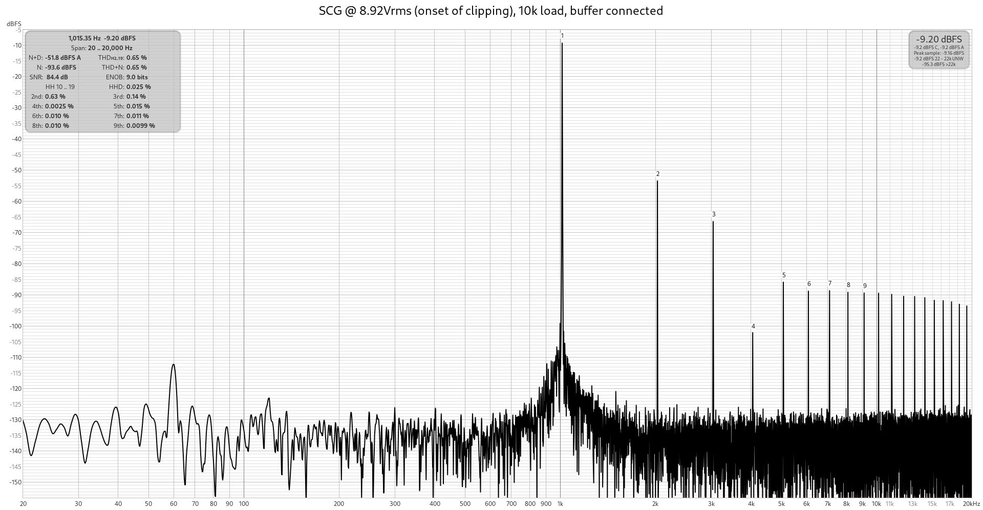

- First measurement was 2.83Vrms with the buffer in place and the jumper set to enable the buffer. 0.19% THD, predominantly second harmonic.
- Second measurement I set out to find the max output before clipping. At 8.92Vrms, 0.65% THD, still predominantly second harmonic. (From here, increasing the input signal even a tiny bit immediately shot the distortion way up to around 5%.)

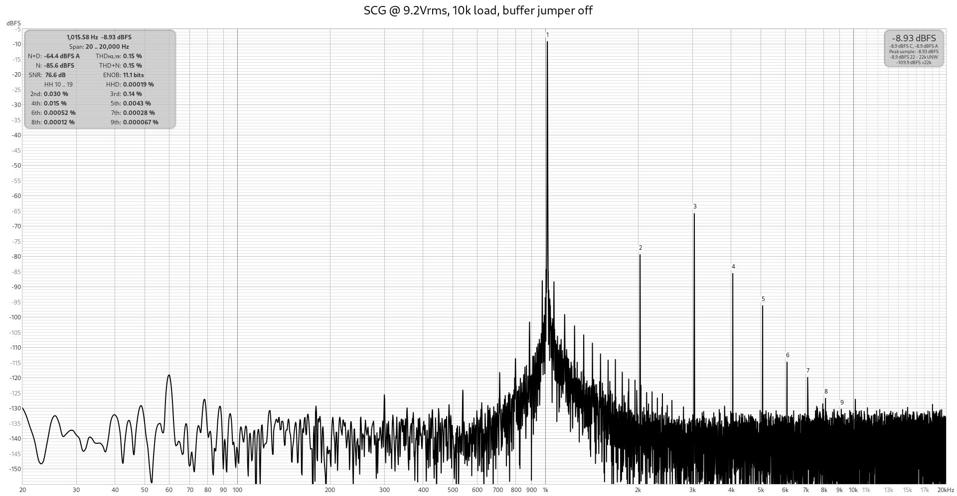

- Third measurement I moved the jumper to the buffer bypass position and took another measurement at 2.83Vrms. Now THD has dropped by over 10x, 0.015%, slightly greater 3rd harmonic.
- Fourth measurement I set out again to find the max output before clipping. Now, at 9.2Vrms, I reached 0.15% THD - less distortion than I measured at only 2.83Vrms with the buffer enabled! Still predominantly 3rd harmonic now with some higher harmonics present. (Once again, I couldn't increase the input signal by even a tiny bit before the distortion shot up from here).
- Fifth measurement was again 2.83Vrms and now, slightly better performance with no buffer at all: 0.013% THD, predominantly 3rd harmonic.
- Sixth measurement, looking for max output before clipping with no buffer JFETS, I was able to get 9.77Vrms before crossing the 1% THD line. Lots of higher harmonics, we are beginning to clip here. Not a very meaningful difference from what I found with the buffer bypassed, maybe a few tenths of a volt extra output.
That said, I'm very curious why I'm not getting nearly as much usable voltage swing (taking the 1% clipping figure, I'm getting 27.6Vpp) as @ra7 -- any ideas? Input voltage of 60.4V too low for those big numbers, I presume? 35VDC operating point needs some tweaking?
While I'm here - should I consider running these dual mono with two power supply boards and two transformers? Seems mega-overkill for a preamp that only draws 15-20mA but I'm curious.

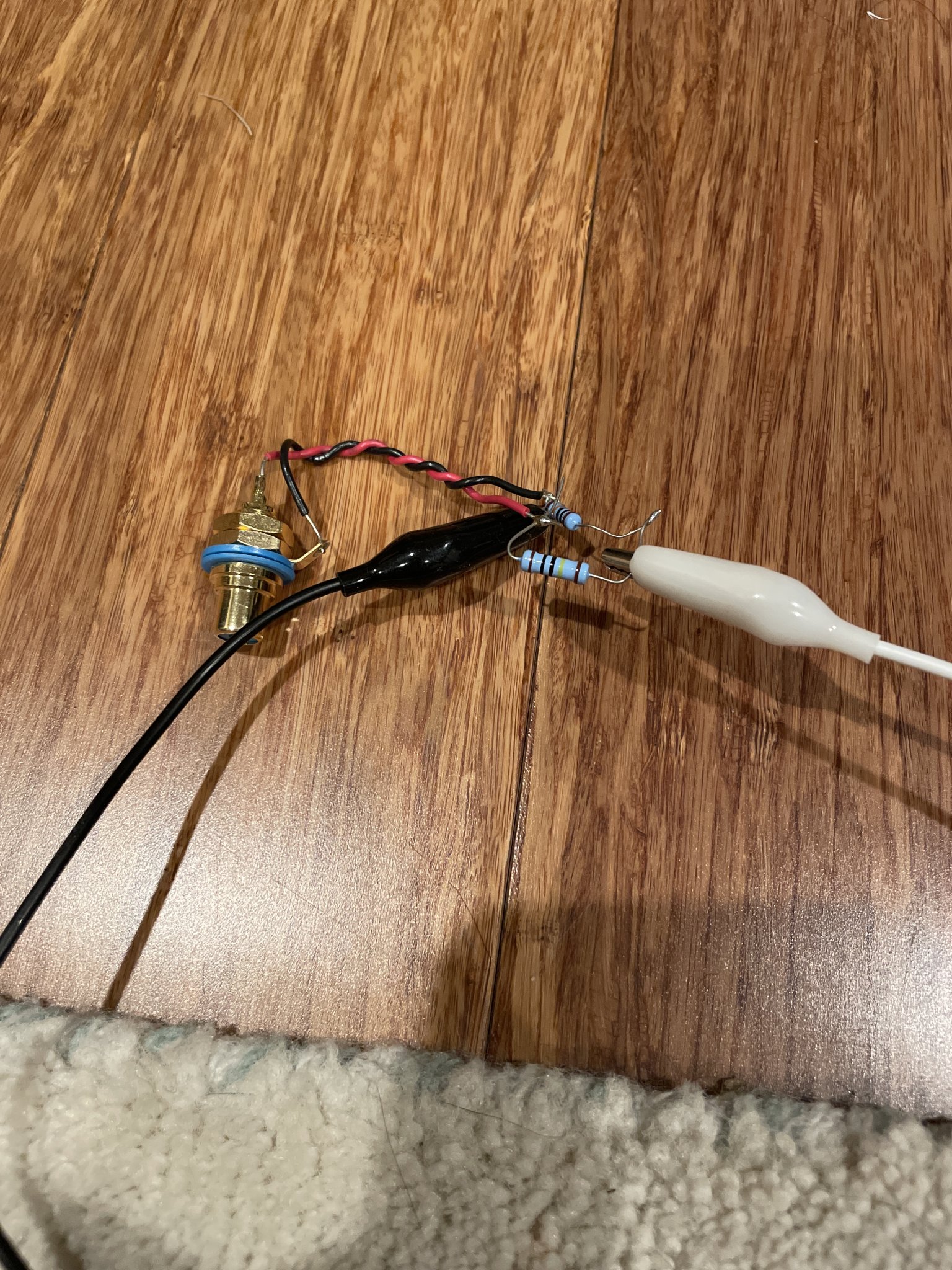

Very interesting. Thanks for sharing! Can you keep the distortion measurement running and move Vd upwards towards 40V? What happens to THD and max swing?

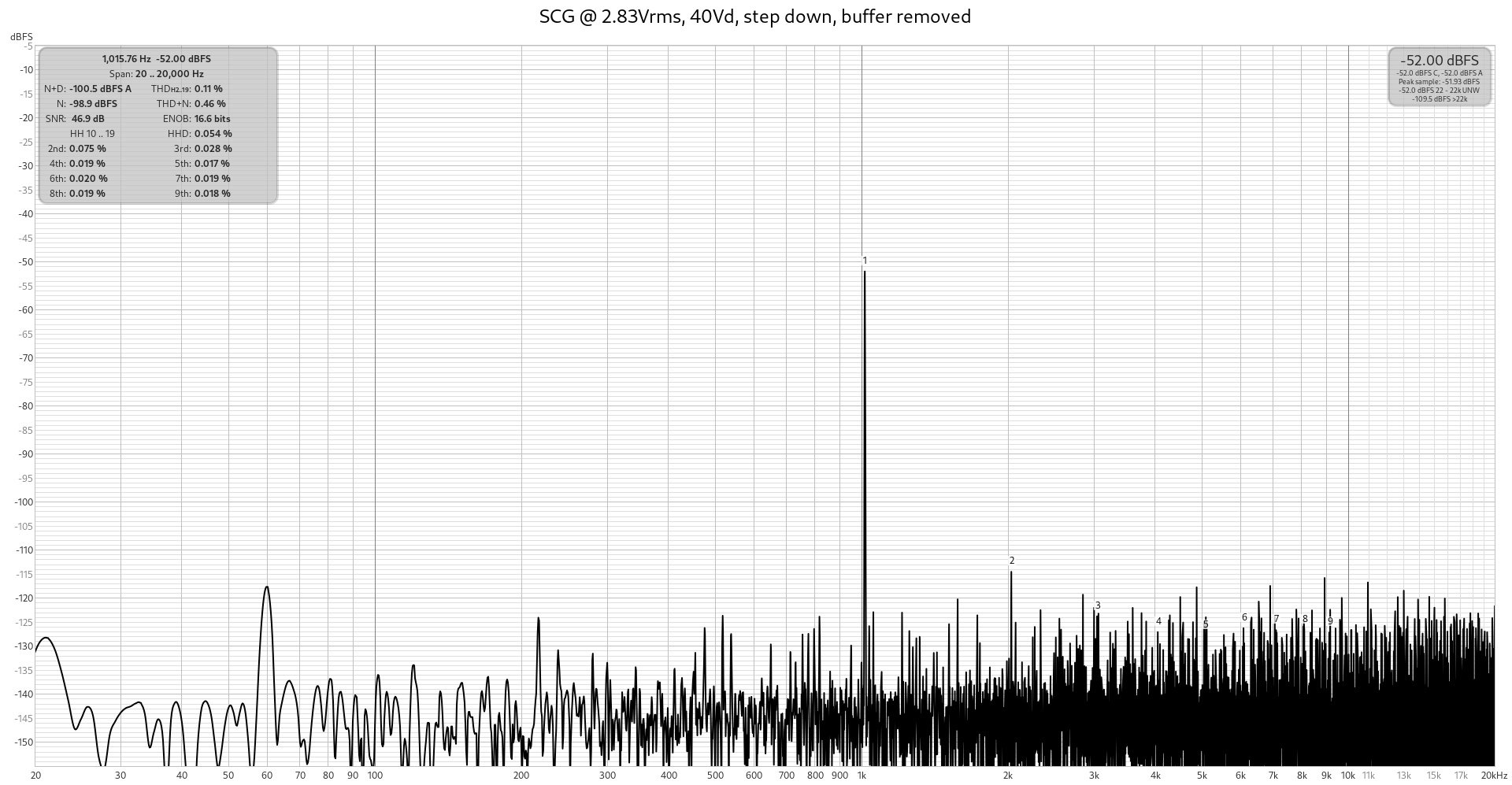

Oh wait, it might be the ADC is clipping. I use a 1:10 stepdown to measure above 10Vrms, coz my ADC clips above that. Even getting near 10Vrms it starts becoming gnarly. You can build an easy step down as follows: from output + connect a 1Meg resistor and a 100k resistor to ground. Other end of 1Meg connects to the ADC.
I then connect an RCA jack at the other end to feed the ADC and use clips to connect the input of this step down to the preamp output. So, in the image below, the white clip goes to preamp out, and black to preamp ground.
Also, the soundcard input should be 10k, so you can leave off the separate 10k resistor when measuring without the stepdown.
The max input on the Scarlet 2i2 is 22 dbu, which is 9.75 Vrms. So, it checks out
. The step down will do it.

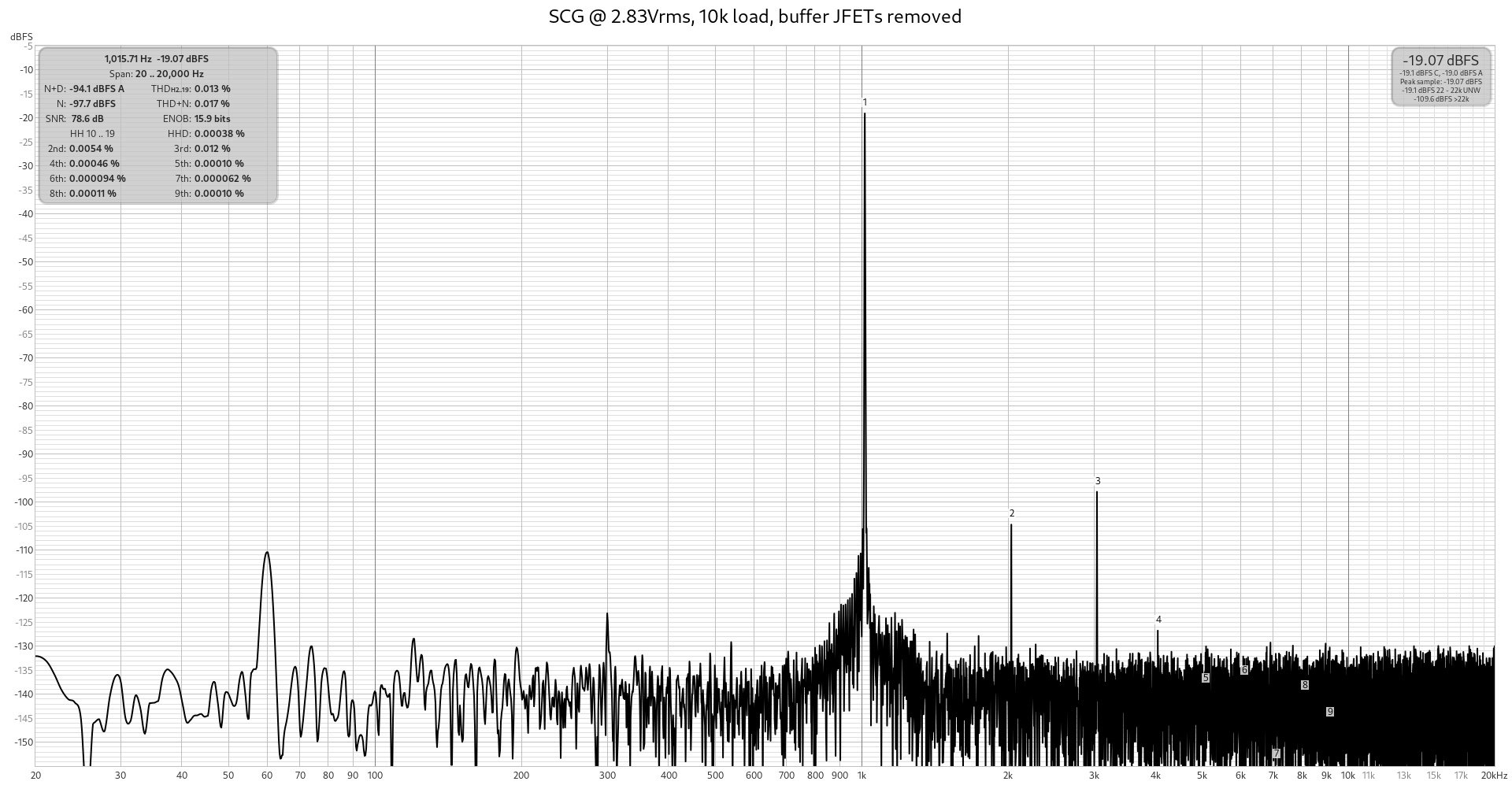

Buffer JFETs desoldered and removed from the board:

Hopefully it’s the ADC clipping it.
Hey @ra7 - you were right; I was clipping the Focusrite input. Good catch!
I think we're witnessing the limitations of the measuring equipment.

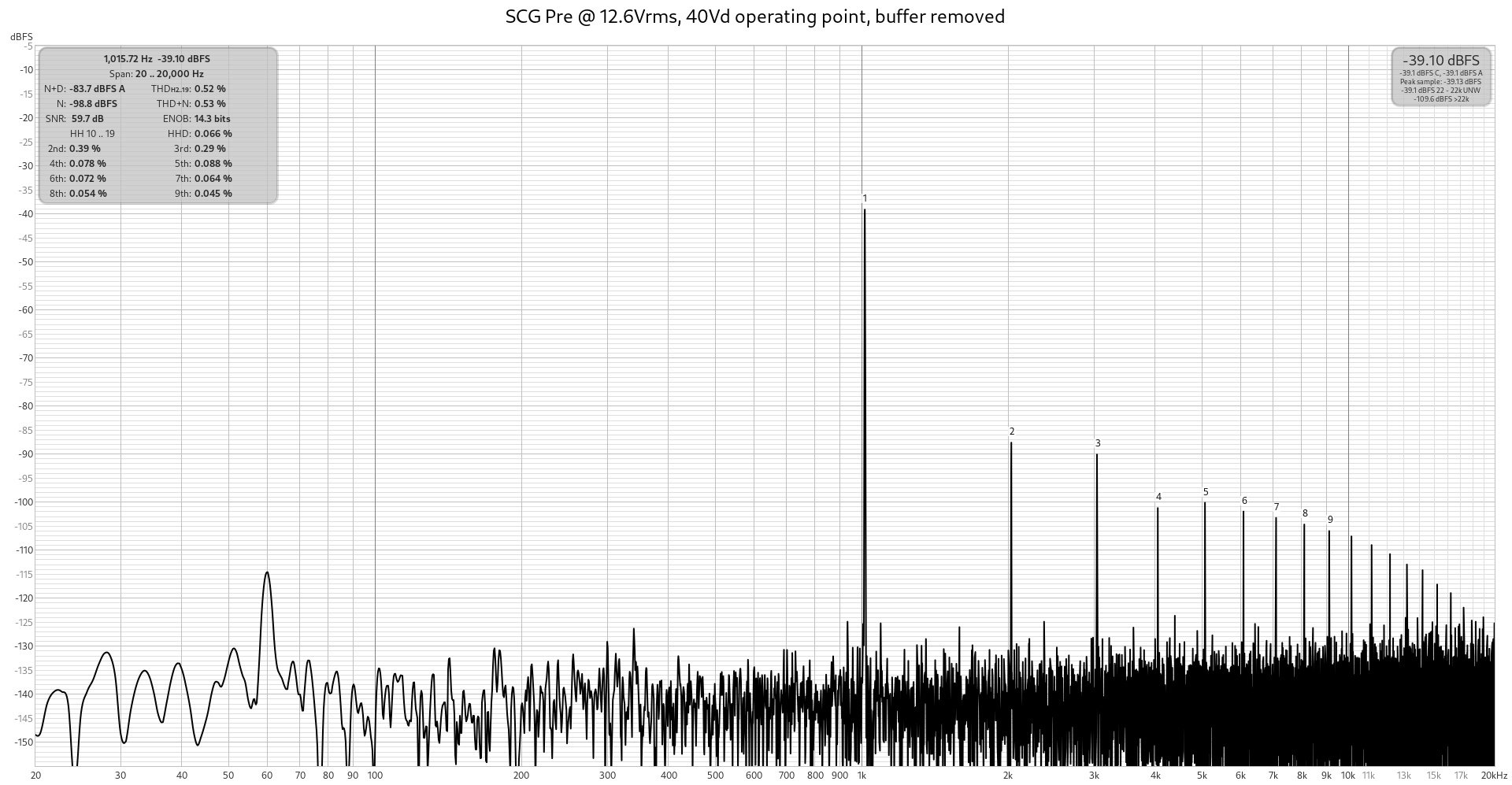

I made the change you suggested and adjusted the Vd from 35V->40V. I watched the distortion decrease in real time when I did this. I also was able to get a much higher output voltage before clipping (12.6Vrms) than before. I can see the top side of the waveform start to clip on the scope when I go higher than that. This is about 36Vpp, much closer to the expected 40Vpp.
Weirdly, though, the distortion measurements at 2.83Vrms increased and the distortion character changed. I can only assume this is the affect of the voltage divider or some other quirk of the measuring setup - because I noticed that increased number even before I adjusted the Vd to 40V (which decreased it from something like 0.15% to 0.11%).
Anyway it's late here on the East coast so I'm off to bed. I should have some more time this weekend to experiment.
I acknowledge my equipment's limitations - it cannot accurately measure THD below 0.01%.
