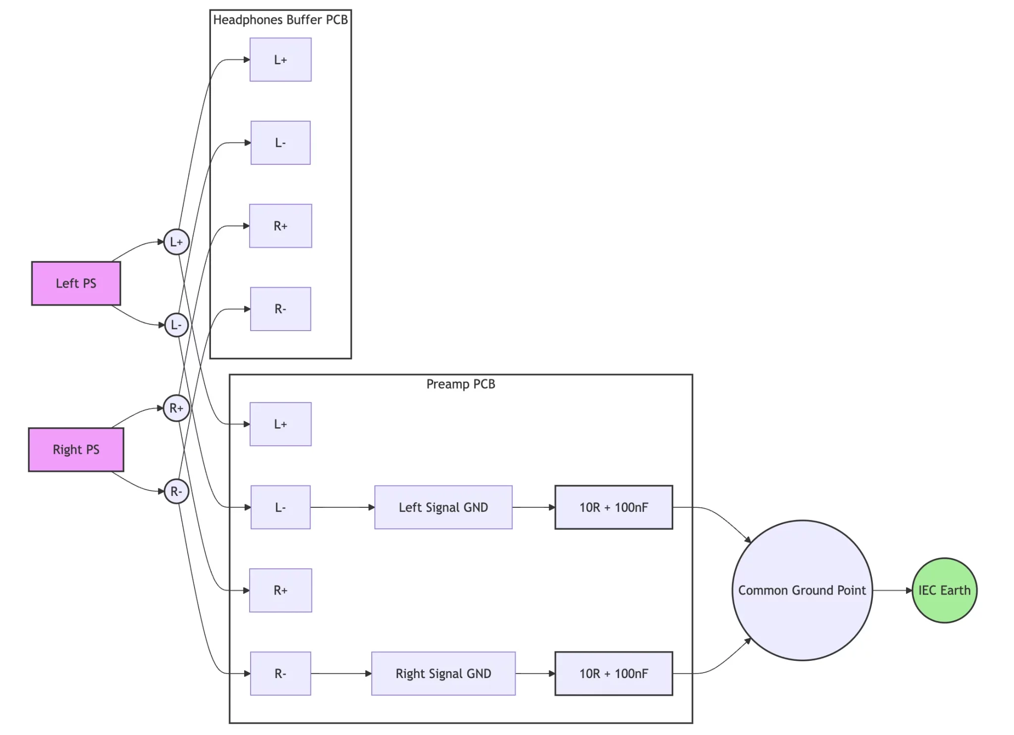

This story is kinda complex because I made it complex and because all the parts don't agree with each other.
The mind likes the idea of dual-mono designs. One PSU supplies one amp/preamp PCB.
Alas, most modern DACs connect the signal ground of L/R channels (and on to protective earth), so it's dual mono until you get to the DAC and then things open the door to nastiness.

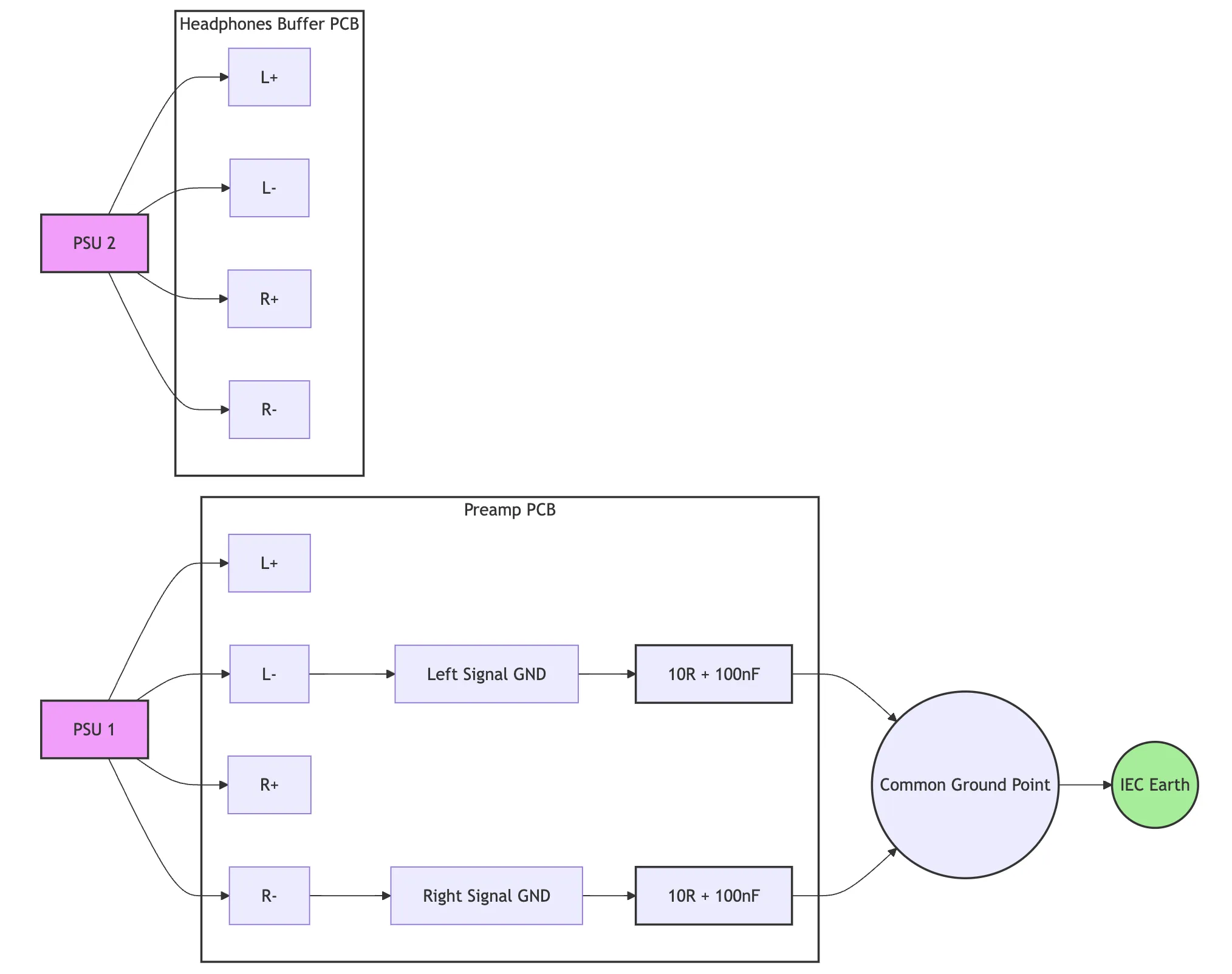

In the scenario I am currently solving for, I have four PCBs: 2 PSU PCBs, 1 preamp PCB and 1 headphones buffer PCB

This arrangement gives "silence":
In this arrangement, one PSU PCB supplies the left channel of the preamp/headphones buffer PCBs and one PSU PCB supplies the right channel of the preamp/headphones buffer PCBs.
This diagram doesn't show signal wiring because it is busy enough already.
This arrangement gives noise when the preamp PCB is connected to the DAC via RCA cables and a lot more noise when the preamp PCB is NOT connected to the DAC:
In this arrangement, the loads on PSU 1 and 2 are quite different. And the most direct common reference for both PSUs is via the DAC when the RCA cables are connected or via the ground-lifted Common Ground Point when the DAC is not connected.
You will note that in both arrangements, each secondary gets its own PSU with its own rectifier.

In the second arrangement above, I assumed the noise is due to the fact there isn't a low impedance path between the two PSU grounds, and/or the fact that PSUs are at significantly different ground potentials.
In the second arrangement, the preamp board receives 15V more (because it draws much less current and therefore incurs much less drop at the level of PSU 1). I have not verified if that increased voltage contributes to the noise.

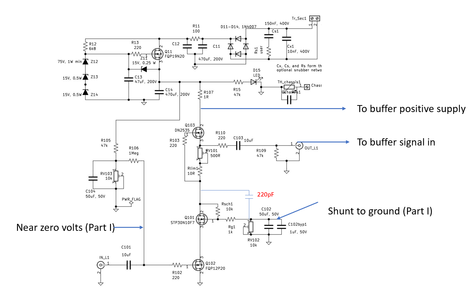

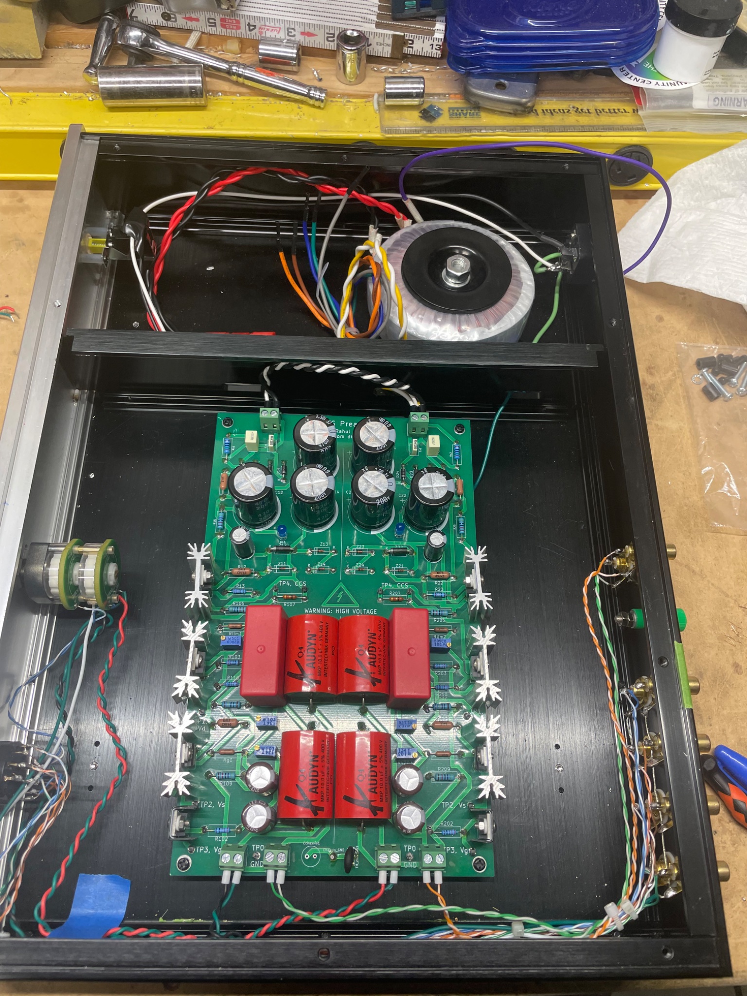

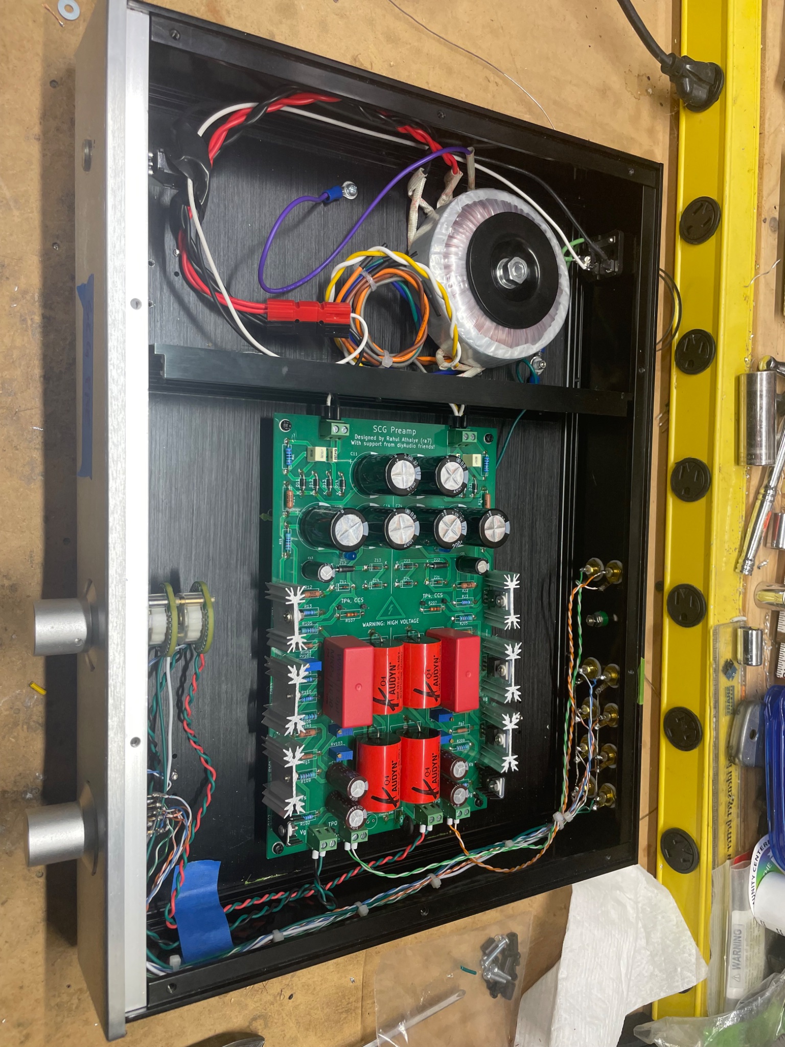

Need some help. I bought a pre-built SCG and donut from swap meet over a year ago and I finally got the opportunity to drop it into a chassis that had the inputs/output, selector, and pot installed. I'm using an Antek donut with 120VAC into the preamp PCB.
Board should be the original revision. There are jumper wires installed across the 1uF Wima bypass caps on the bottom. I don't see any notes on this bypass in the schematic.
Checkout procedure:
Test 1 - Regulator - 128V on both channels at R107/207 = OK
Test 2 - CCS Current. Ground Rlim with cliplead. Measure across R107/207 (1R) and adjust. 30mA = 30mV = OK
Test 3 - Set Q102 operating point. TP2 to GND = 11.8V (Target 20-30V) Adjustment of pot = no change. NOT OK
Test 4 - Set Q101 operating point. TP1 to GND = ~125V (Target 65V) = NOT OK
What's the jumper for? Should I pull the jumper? Should I pull semis and test them? Other thoughts / ideas?

@rhthatcher please refer to this post of modification - https://www.diyaudio.com/community/threads/schade-common-gate-scg-preamp.380487/post-7441704
@manniraj - perfect.
I pulled the Wimas and jumper, turned R103/203 to get 0v (1mV - close enough?)
Reinstalled jumper.
Tp2 is 4.2 and 4.25v. Target ~4V. Good
Tp1 is 84.1 and 85.8v. Target ~85V. Good.

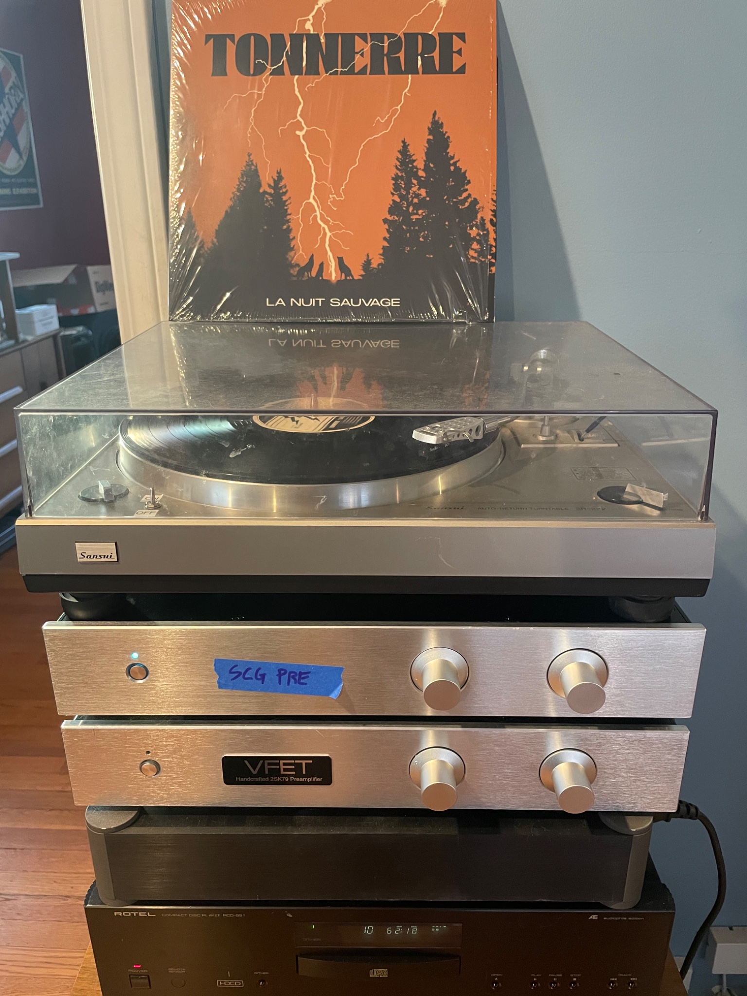

Cyan LED installed.
Time to give this a run with Pearl3, Aleph 30 monos, and Tannoys.
Jamming some French Canadian hard rock by Tonnerre. Sound is great!

Next question. My other preamp in this system is a buffer, so zero dB gain. This SCG is set up for 10x/20dB gain. My "gain chain" is now really hot with the added 20dB gain. I get 3-4 clicks from minimum on my stepped attenuator to get to normal listening levels. I'm tempted to back it down to 11 or 13dB gain to get some more usable clicks on the attenuator.
If I want to lower gain by changing Rg to 3k or 4k, do I have to go back and pull the jumper, adjust RV103/203, etc? Or is it as simple as changing out Rg?

Yes, increase Rg and then adjust RV103 to get back to the targets. That should do it.If I want to lower gain by changing Rg to 3k or 4k, do I have to go back and pull the jumper, adjust RV103/203, etc? Or is it as simple as changing out Rg?
Edit: Looking back at the instructions, it seems you don’t need to turn RV103, if you have adjusted it for zero V already. Reducing Rg will bring down the Vd (gain x 8), which should be fine.
