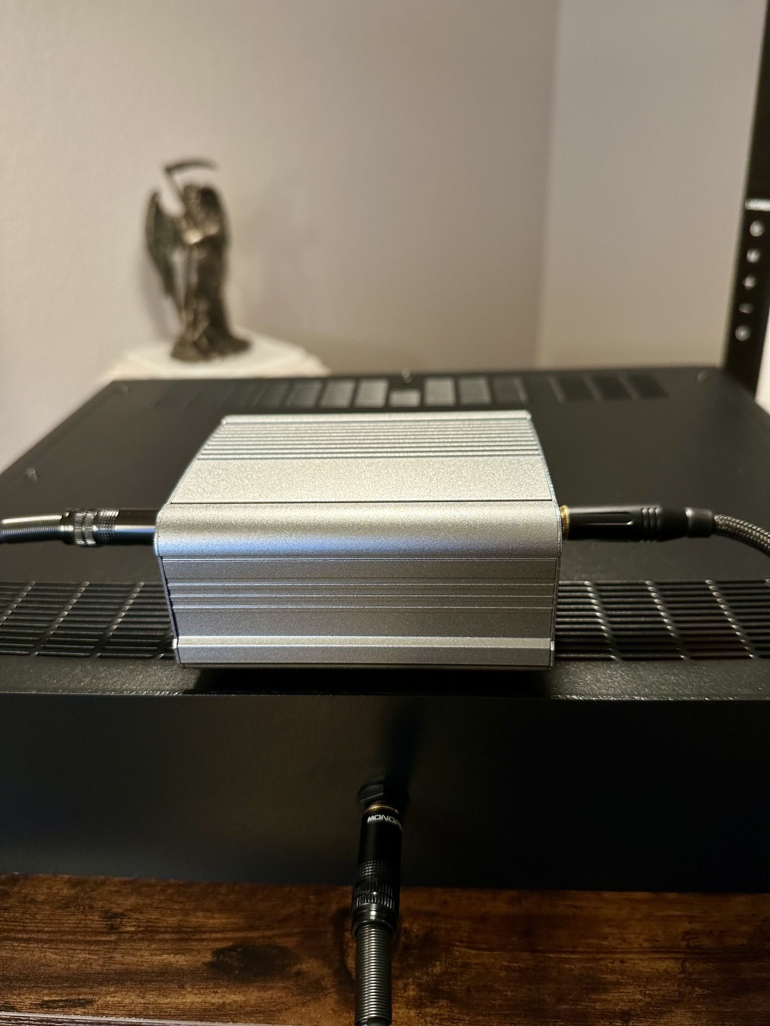

OK, if you are sensitive to the immense audiofoolery one can wander in, you may want to close your eyes and skip this post.
This box hosts 2 resistors and 2 6.35mm jacks. A bit of 20-AWG wire too.
The output of SCG with headphones buffer goes in on the left, headphones with ridiculously low input impedance go in on the right. It adds 33 ohm of impedance via 2W metal film resistors.
It's not a miracle cure, but that pair of 9-ohm headphones I did this for has ruler flat input impedance across the frequency range; so it works.
