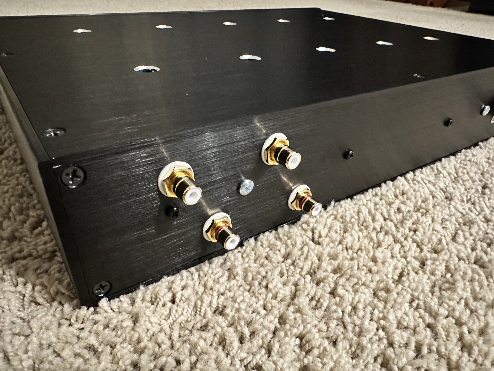

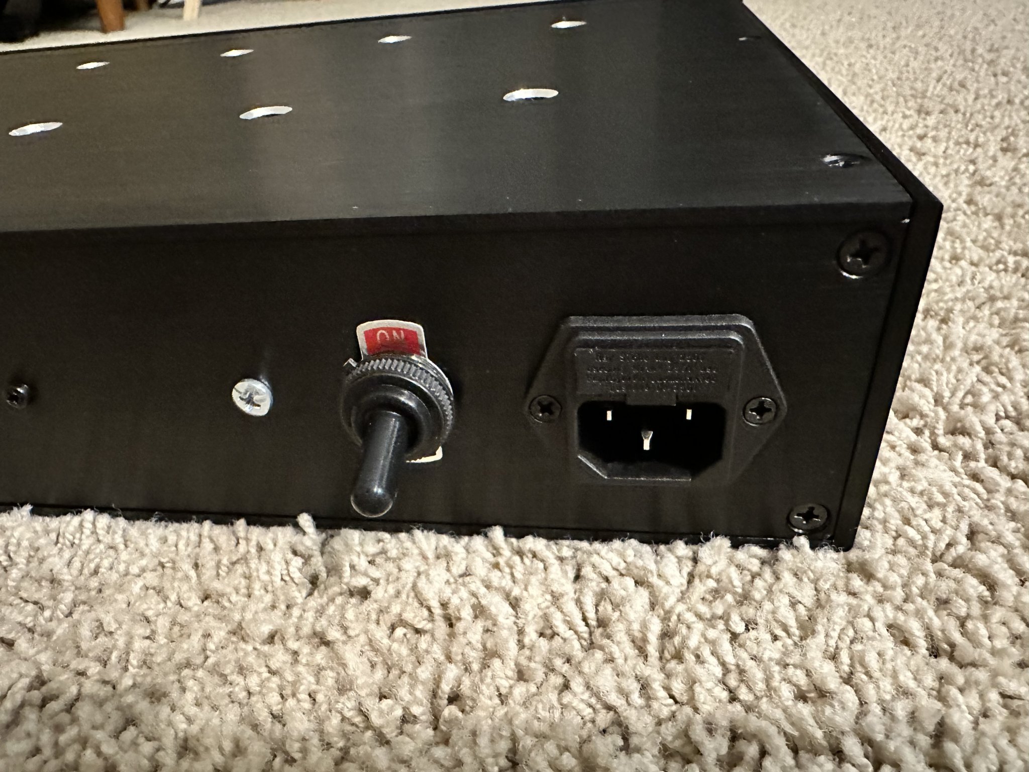

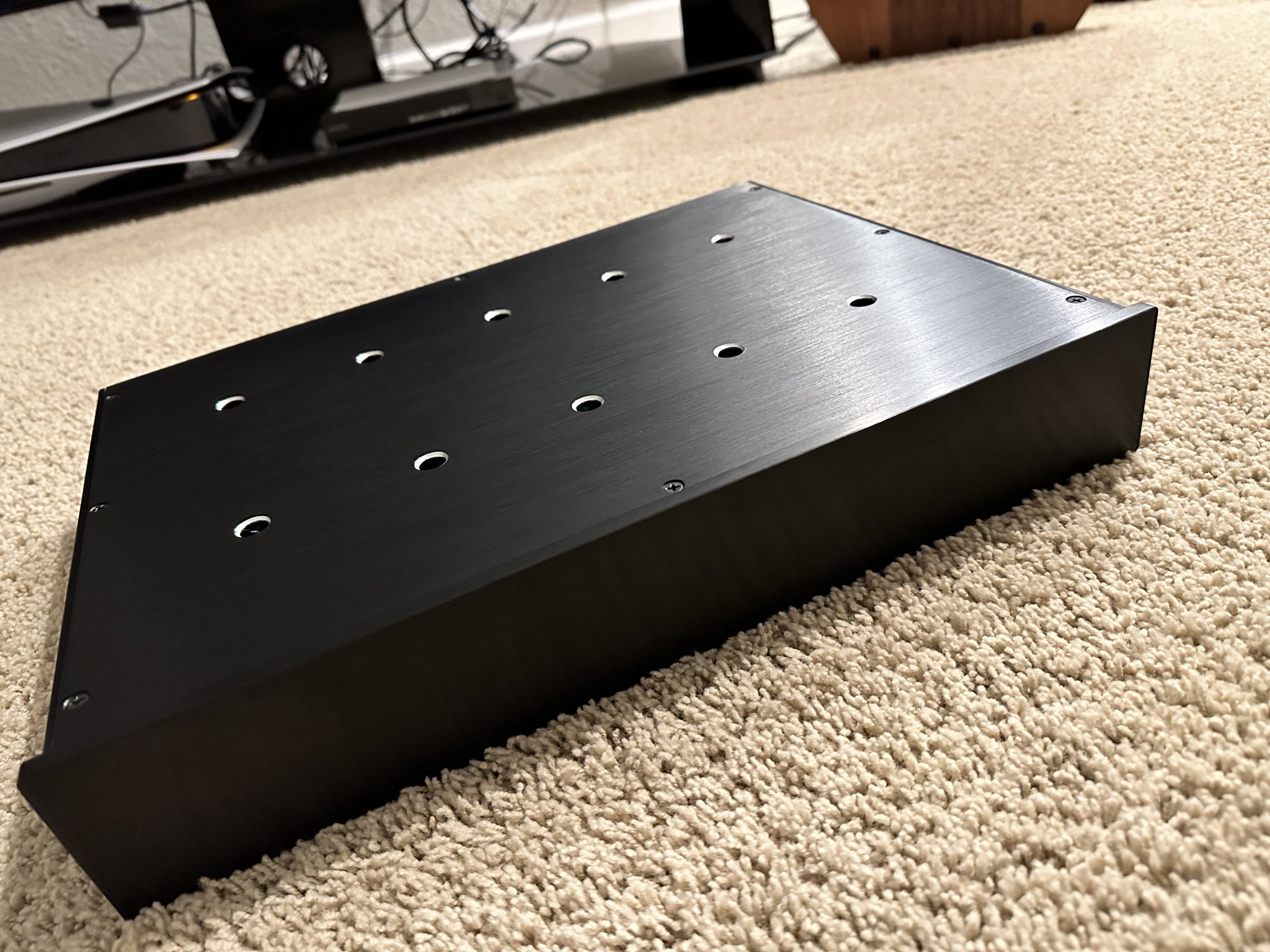

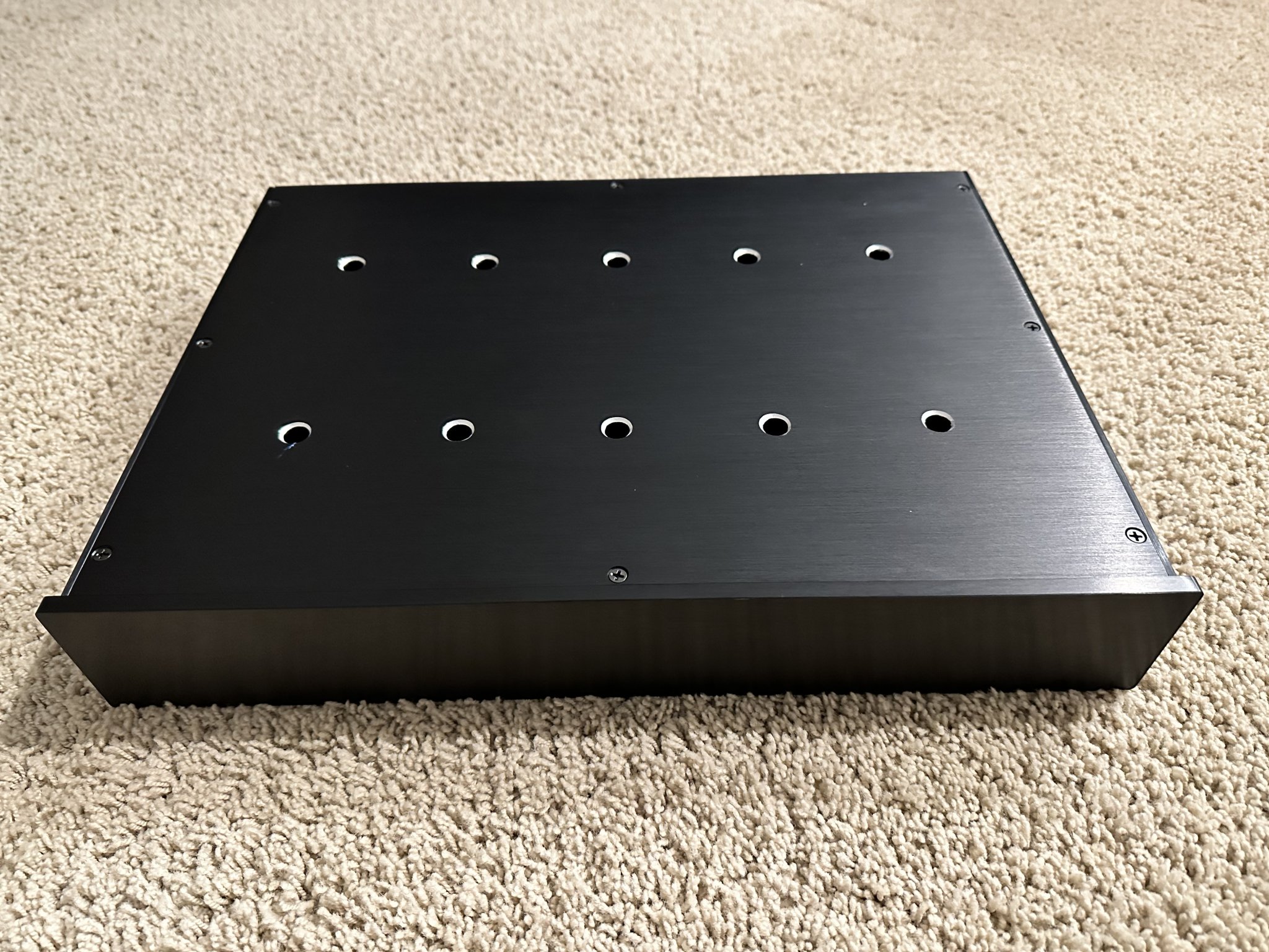

Superb! Is that a Landfall Systems chassis?
Nah, some cheap enclosure from China. But the IEC socket hole was already there, so it was great! 🙂
It's actually heftier than I expected.
