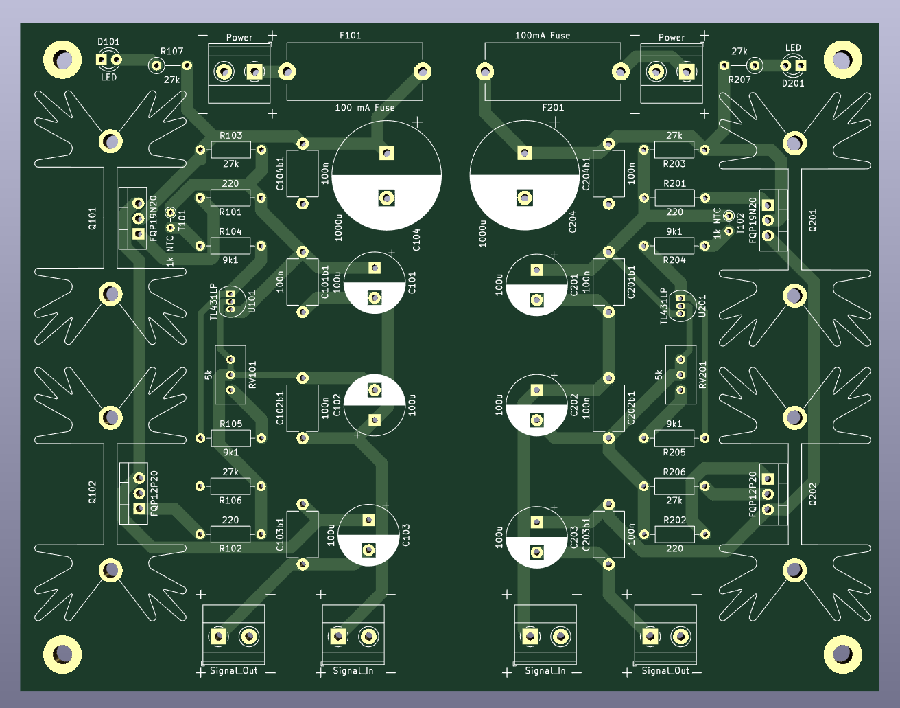

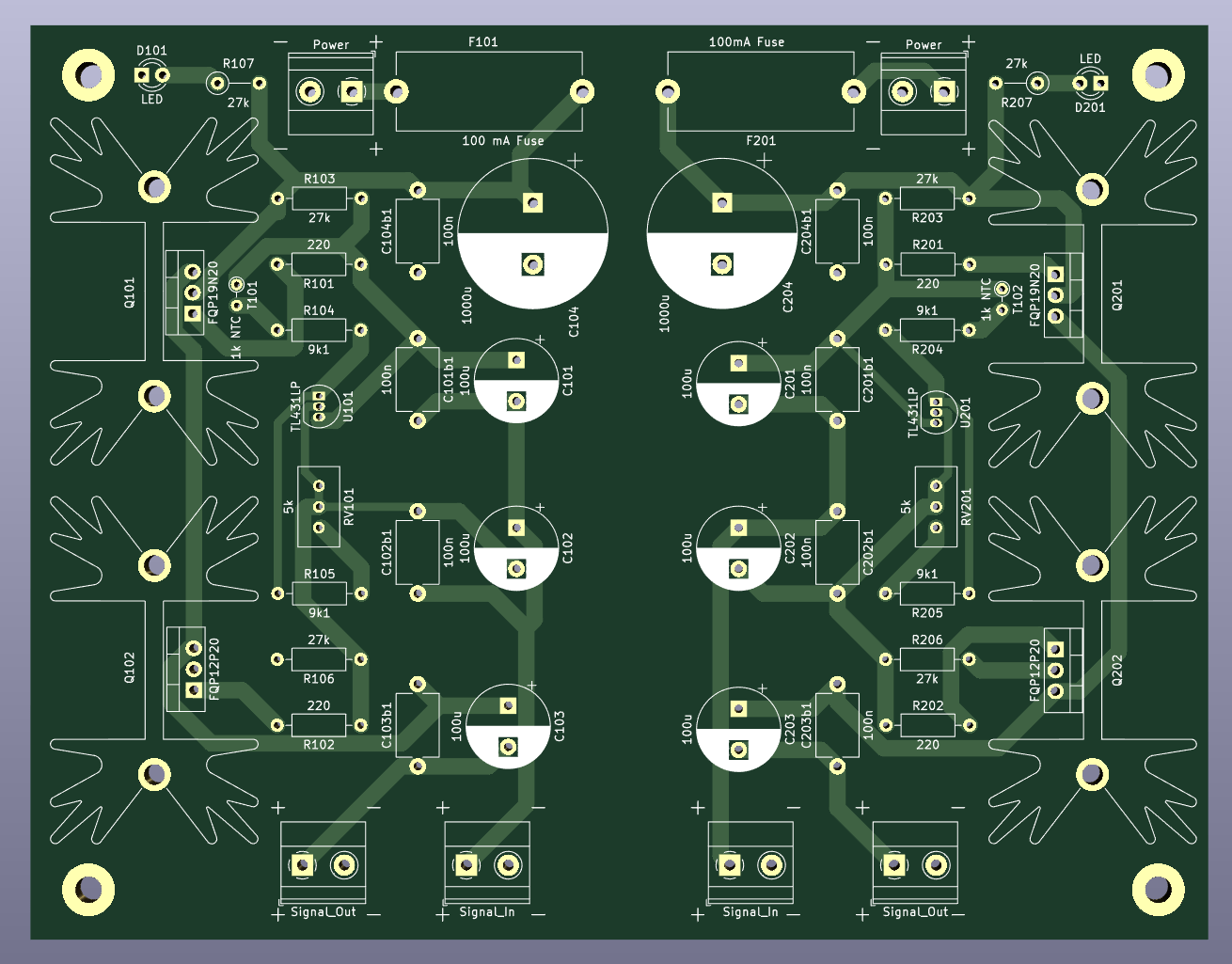

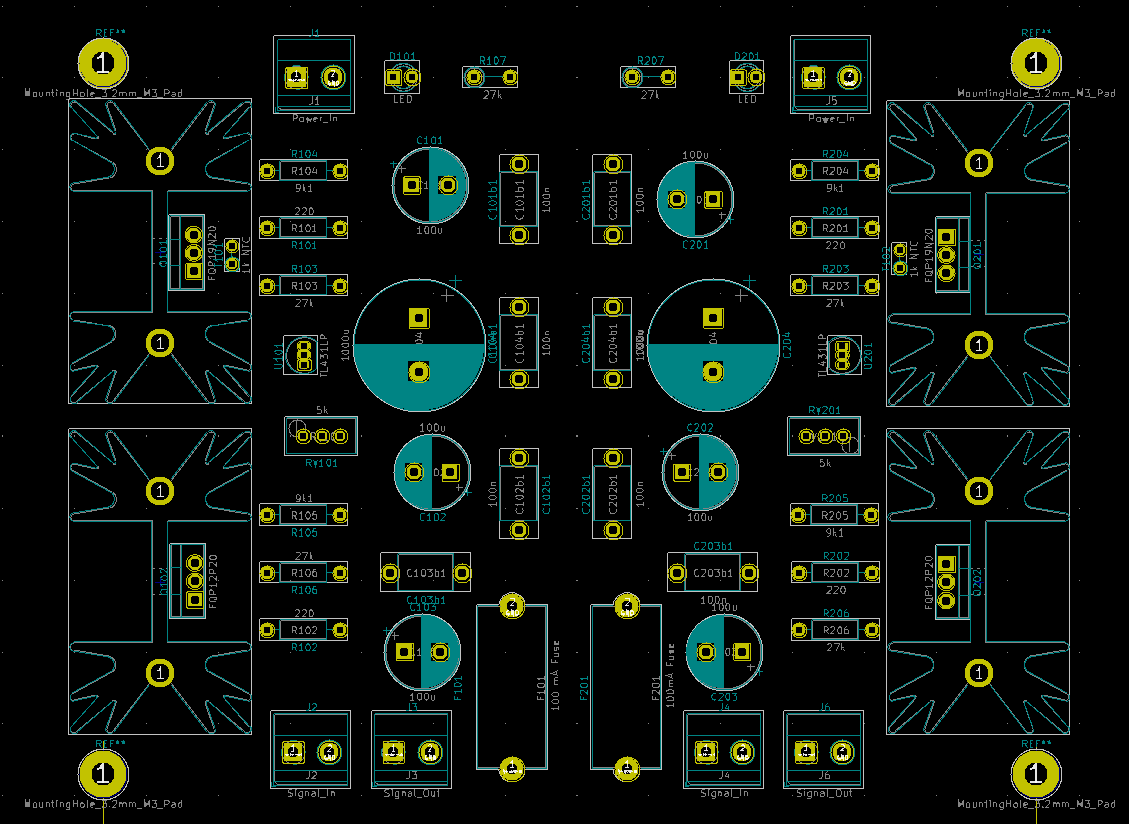

Here's where it is at right now. Schematic done, layout done. Just have to route traces. The PCB will fit the old one so that it could be stacked. However, the heatsinks will be quite tall and may not fit the chassis for height. I tried the layout various ways, but if it is going to be stacked, this seems like the only way it would work.
The plan is to score the PCB down the middle in the vertical direction, which allow it to be split into two parts and provide more flexibility for layout in the chassis.

Very nice layout, is this the SCG mkII and will replace the original SCG ?
I don’t see anything on your PCBs, who’s the designer, name of pcb, etc.

Hi Eric, this is a buffer after the SCG for driving headphones. Turns out it can drive speakers just as well. Also, it isolates the gain device from the outside world. This allows more flexibility with the SCG circuit and has resulted in big improvements. I am laying out a new SCG and plus driver PCB next.
Will add about the design, designer, etc. Thanks!

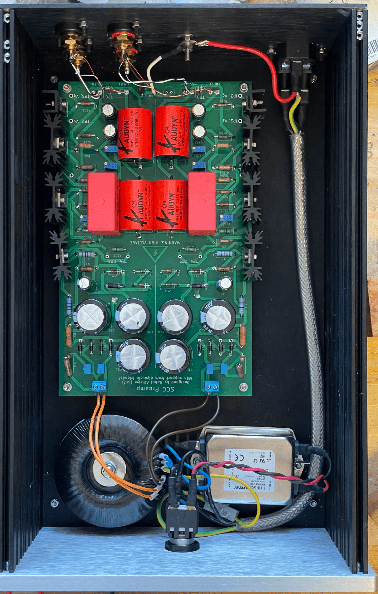

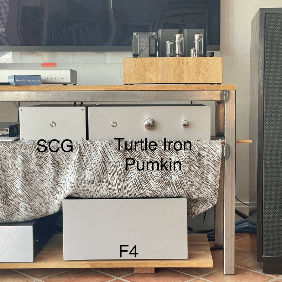

SCG is ready and I did some measurements. My PC oscilloscope can’t measure below 0,1% or -85dB, so that result (Rg 1k) without load is good. 20k square wave is awesome.Now SCG, with Rg 2k, is hooked up to F4 and to sensitive speakers playing very pleasing. Detailed and a bit lush is da ****. I like it a lot! As you can se SCG is wired as linestage with Turtle Iron Pumpkin handling volume. With 3u the SCG has the place for a buffer 😉
