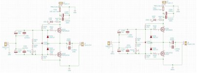

Hi can you post a schematics of your Version?Hi Mr. Ra7, here my Power Amp version of your SCG

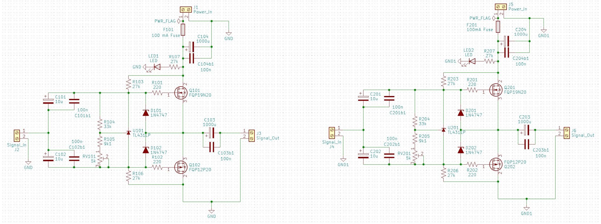

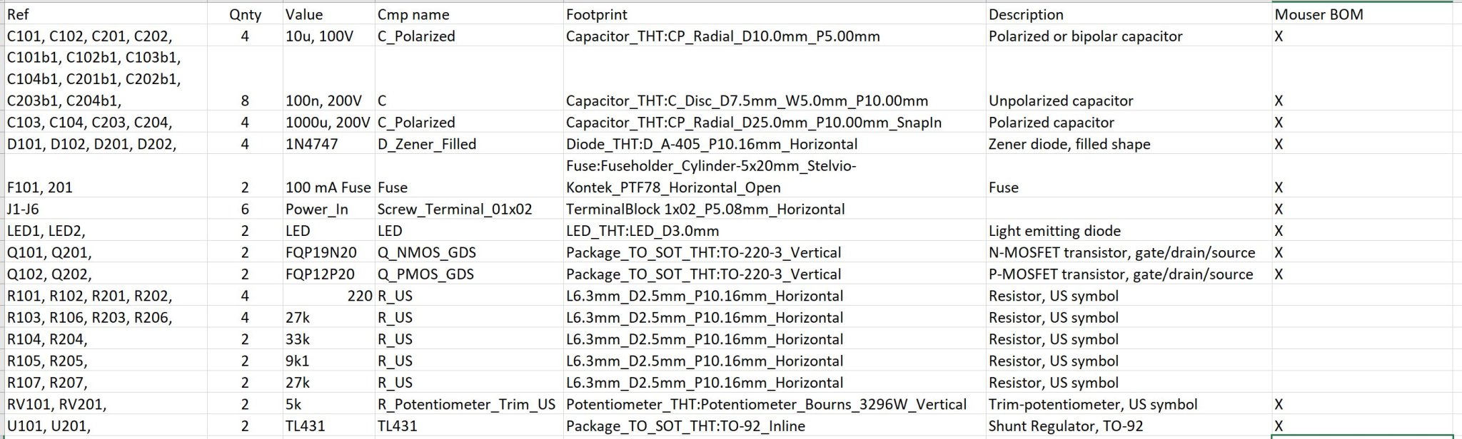

Here's the BOM and revised buffer schematic. Also, see here for a Mouser cart. It does NOT have resistors but has everything else.Is the BOM for the buffer board finalized? 🤑
https://www.mouser.com/ProjectManager/ProjectDetail.aspx?AccessID=e930f0fd0e
Please don't make changes to the Mouser BOM/project. Let me know if something looks amiss.
P-channel MOSFETs are a rarity in Mouser right now. I picked two (N and P) that appear to be a fair choice, but have not tried them because I have FQP19N20 and FQP12P20. Any good pair of complementary MOSFETs will work as long as the minimum Vds is greater than 60V or so. The buffer is a push-pull follower operated in Class A and so most complementary pairs will work just fine.

Hi marconi118, sent in pmHi can you post a schematics of your Version?
