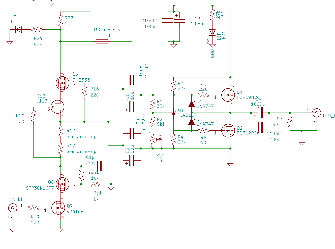

Sorry, Rahul, I wanted to verify the BOM and schematics for you, but life got in the way...tomorrow I should be able to get back to it.
@ra7
Checked the schematic vs. the BOM vs. the Mouser project...everything seems accounted for.
As you said, the Mouser project doesn't have the resistors, but these are no issue.
Other notes:
1. The footprint of the radial 10 uF caps is not a perfect match, but they will fit.
2. In the Mouser project, you put in FQPF9P25 instead of FQP12P20, but I think that's a valid substitute.
3. In the Mouser project, you put in TL431BCLPR instead of TL431LP, but again same family and valid substitute.
I put in my Mouser order.
And forgot to add the 100 mA fuses. Ehehe. Classic. Luckily I think I have some of those stashed somewhere.
Also, I kinda assumed the Qs won't need any heatsink, but I have plenty of those otherwise.
So, all good Rahul.
Now, you just need to send me the PCB itself. 😉

See schematic below. This is the gain stage plus buffer. I just discovered something new about the PS, so I am working on revising it. Also discovered C1p few days ago, which makes a big difference. The schematic shows the new CCS, absence of pot for setting CCS value, removal of bias adjustment at input and for the gain stage (Part I upgrade), new p-channel input FET, and zener protection of output devices. The gain device shown below is the same as the old one, but on the PCB there will be place for various pinouts and footprints so that a variety of BJTs, MOSFETs, and JFETs can work. After all, the genesis of this design is the ability to make triodes out of ordinary devices. It puts the gain FET in a most favorable position and I am always amazed at the different sounds coming out of various SS parts.
The circuit has an aesthetic rightness to it - just looks like it will sound good.
