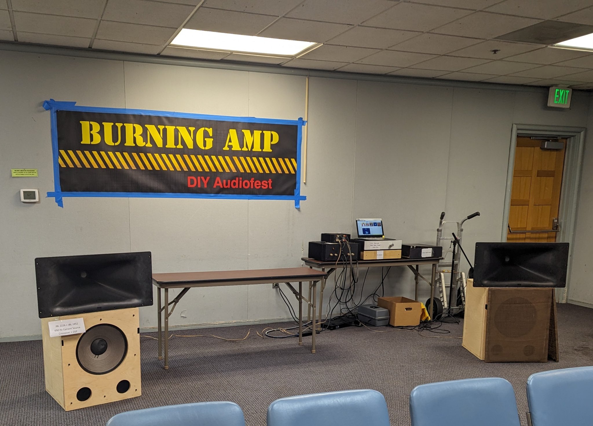

I was fortunate enough to be at Burning Amp this year and had the opportunity to hear ra7 demo the SCG in combination with a few amps, including the Total Domination VFET amp. I was already intrigued by the design and following this thread - but now I am even more interested in building one than I was before. I really enjoyed the sound.
Looking forward to the next iteration of this project.

Thank you! So glad that it sounded good in that space--was a little nervous how the response shaping would work. Also, the SCG definitely was behind the sound. It was the Miro TDA 1541 DAC into Nelson's FE 2022 (transparent plus gain) into the SCG driving an F4.
