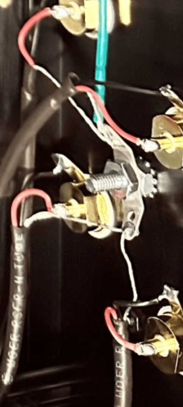

It is hard to see in this, but are the signal grounds connected to the chassis lug here or just the drains?
Just the drains.
The RCA grounds go to the board and from the board to earth ground, via the cap/thermistor pair and chassis ground.
It’s hard to fathom a loop, but the DAC is probably on the same circuit as the SCG, so who knows.

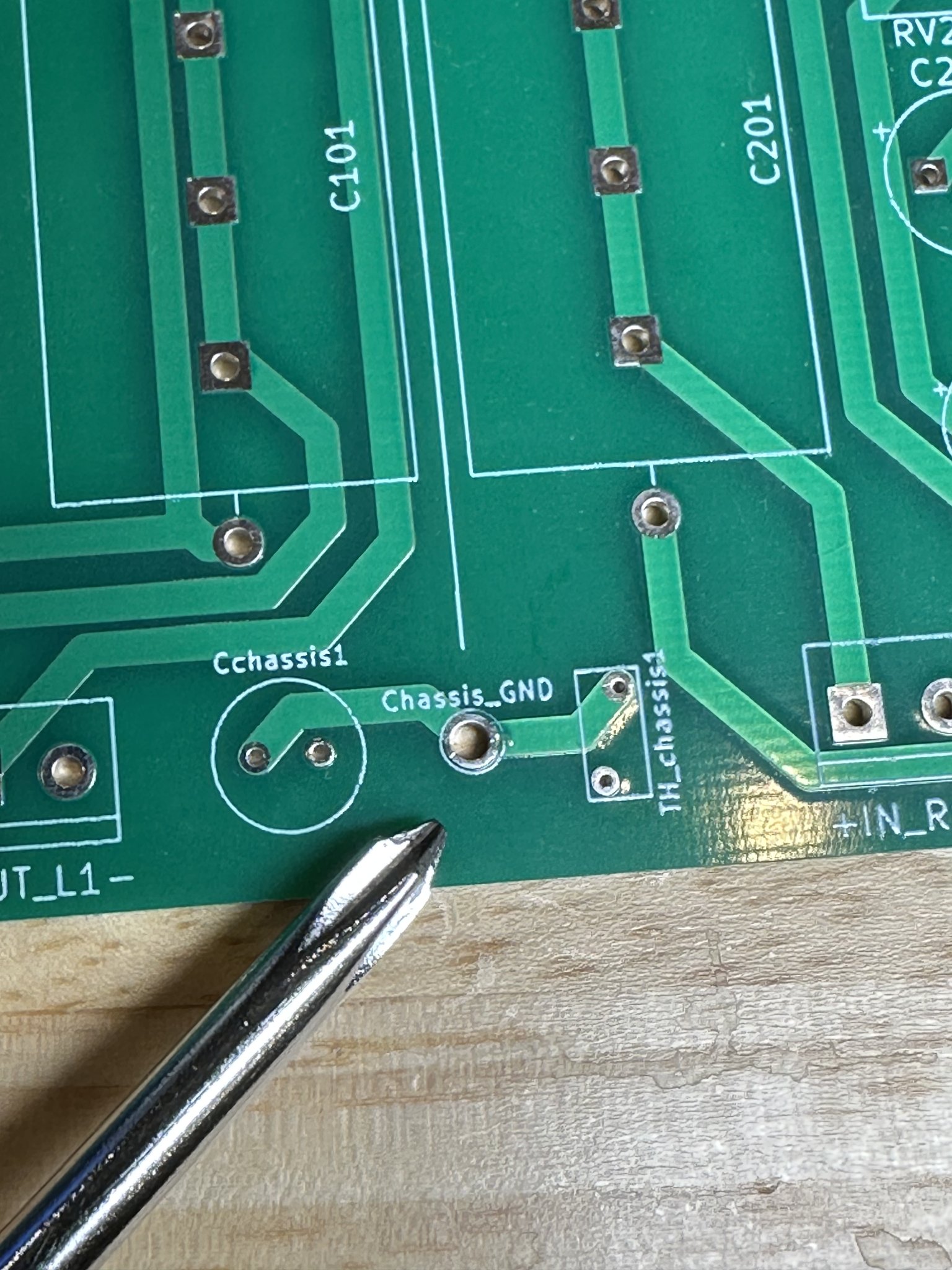

I noticed a couple of things. In post #1104 (Post #1104), clip leads were connected to the chassis ground point next to the thermistor on the pcb. If these were meter grounds for voltage measurements, then the meter measurements were not at signal ground, but through the thermistor.
I noticed the shield for the input cables appeared to be chassis grounded next to the input RCA jacks, and then another wire went from this chassis ground to another chassis ground near the IEC connector. It is best to have only one ground point on the chassis. However since this ground involved only the cable shield, it probably did not create any noise.
That is an excellent catch indeed. I departed from TP0!
I'll have to redo that.
Thank you so much for catching that one!
I agree on principle, but as you said, this additional ground point is only for the shields of the cables. And the drain wires are not connected on the other side. So, it cannot be the culprit.
The most likely culprit will be revealed in my next response to @Vunce

So, that was a fun little game.
I started by verifying that all RCA jacks were isolated from the chassis. They were.
Now, the set-up:
DAC -> attenuator -> SCG -> headphones (for these tests, it's easier and they are more sensitive, so it's also easier to decide if there is noise or not)
- I verified the thermistor has ~10R of resistance.
- I then measured resistance between the negative tabs of the RCA jacks and IEC ground...and resistance was 0.3R or so.
- OK, I thought. I removed all cables from the chassis...all RCA cables and the power cord. (power was not on, of course)
- Measured resistance between the negative tabs of the RCA jacks and IEC ground...and resistance was ~10R. Good.
- Reconnected all RCA cables.
- Reconnected the power cord.
- Measured resistance between the negative tabs of the RCA jacks and IEC ground...and resistance was ~0.3R. Ahah!
I'm sure you know where this is going...
SCG signal ground finds a path to earth ground through the DAC, so it doesn't care about going through the SCG PCB. And that could also introduce a loop.
So, I replace the grounded DAC with a battery-powered DAC, and checked for noise...there was none.
No matter how cautious I think I am, I am always humbled by these issues.
I do not really want to float the SCG board, but it seems to be the easiest way out.
Or perhaps you could see whether you can change the dac ground so that its signal ground is not directly connected to chassis ground.
