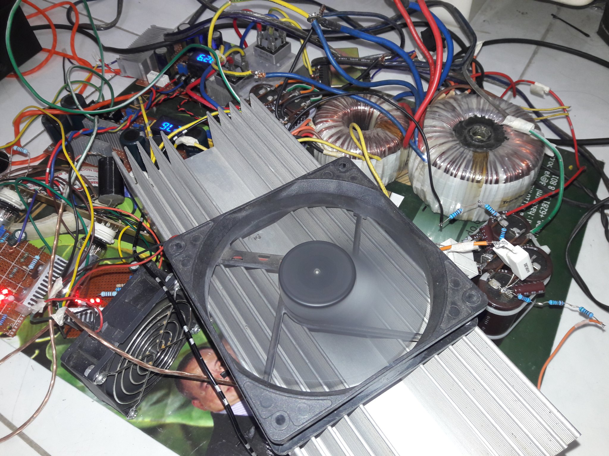

I'm also curious about the power amp version. I've seen Georges high voltage version with OPT but I've alsways though a low voltage version without OPT should be possible.

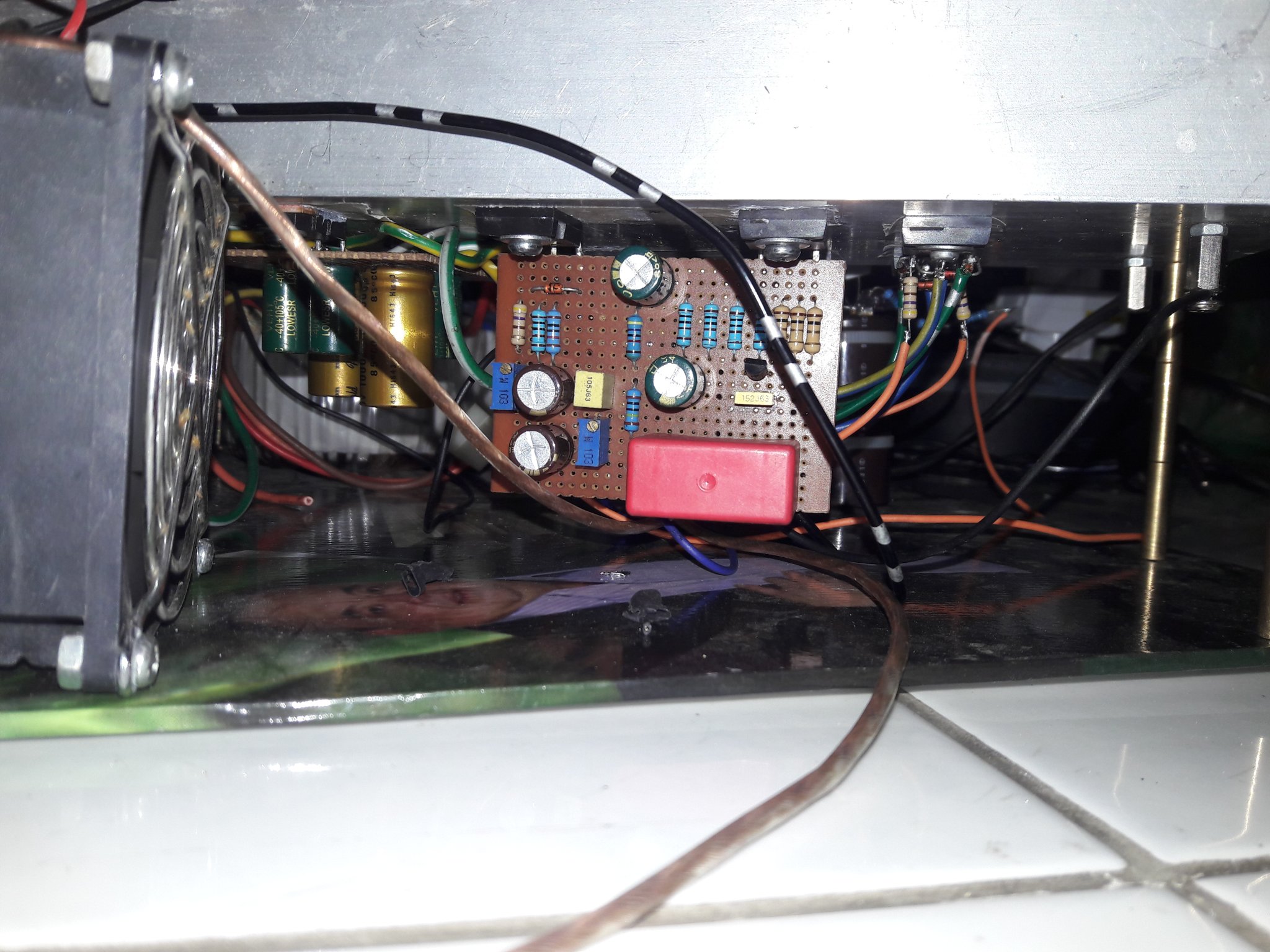

Hi Mr. Ra7, yes it's ccs loaded Aleph style, i use IRFP150N for ccs and gain mosfet, for P channel mosfet at first i use IRFP9140N, it's sounded great with very transparent treble, then i change to J162 and it's sound quality is improved in treble region. With J162 treble respons more extended and relax. Supply voltage after capacitance multiplier is 36.6volt, I bias around 2A, voltage at P channel mosfet source leg at 6volt, at gain mosfet drain leg at 21volt.
Nice! I would try to get the P-channel FET source leg at about 20V or so. But that would increase the dissipation quite a bit.

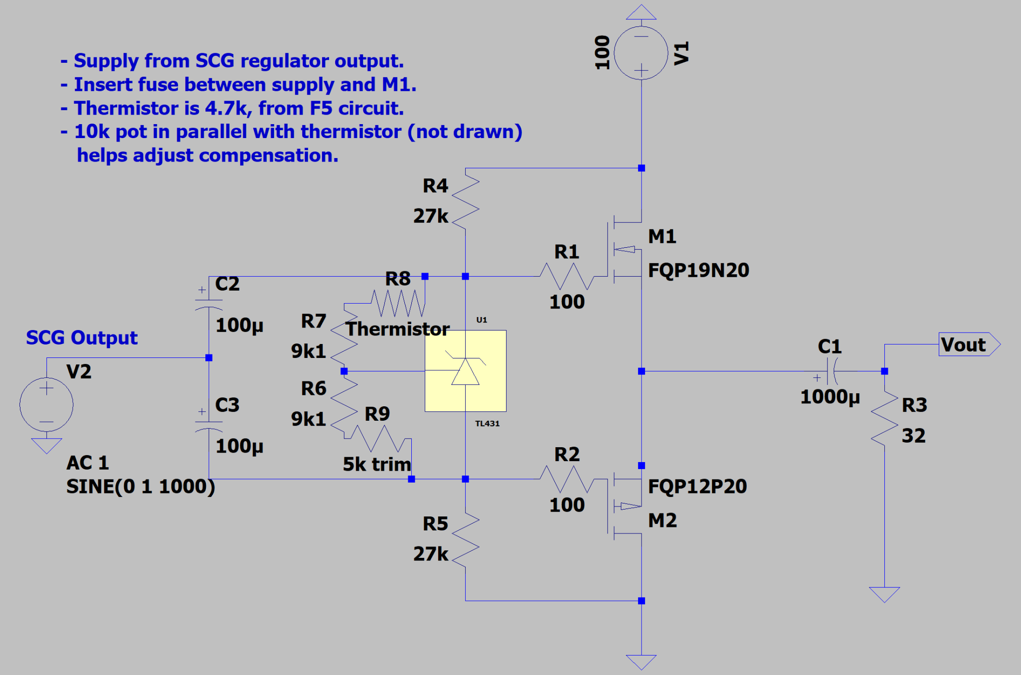

A few posts ago I posted the measurements of the SCG with an output buffer. Here's the push-pull buffer circuit. It is drawn with the same supply as the SCG, which is about 100V with the zener stack and regulator and tapped from R107/207, above the CCS FET.
I was shooting for a fully transparent buffer that will let the SCG do the talking and at the same time provide the drive needed for low impedance headphones. One could use a single-ended MOSFET source follower, easy enough, but I wanted to try this push-pull circuit without source degeneration. Jam provided inspiration at one of our visits and Papa has said many times that no degeneration is better. The XA25 review on Positive Feedback is an interesting read as well and the circuit looks very much like the BA-3 gain stage driving a PP follower.
https://positive-feedback.com/reviews/hardware-reviews/pass-labs-xa25-class-a-stereo-amplifier/
So, with all that as inspiration, I set about designing this buffer. Push-pull buffers are no big deal but doing it without degeneration means you need some sort of current limiting and temperature compensation. The circuit shows the bias control circuit, which is based on TL431 and is similar to the F4 (and BA output stages) except it has a thermistor (R8) to provide thermal compensation. R9 is a trimmer that is used to adjust the bias. No resistors on the FET source pins, which otherwise would've provided some level of bias control feedback. In this case, the thermistor provides feedback to the bias control and should be mounted in contact with one of the FETs. When the FETs heat up, it drives the bias down. This is not a novel circuit by any means and it still needs some form of current limiting (not shown).
The FETs should be mounted on a decent sized sink because each is dissipating about 45V x 25 mA = 1.1W, and we don't want it to drift too much with temperature. If shooting for 25 mA, I'd start it at 15 mA and let it drift for about 5-10 minutes while keeping an eye on it, then come back and fiddle with the trimmer. If it starts running away, shut it down, let it cool off, and start with the pot dialed back to a lower starting bias current.
The sound of the buffer is totally transparent. This circuit could easily be scaled up to a class A amplifier driving regular speakers. At 25 mA bias, there is more than enough drive for headphones. Based on my understanding, it will deliver twice the bias current in Class A, so 50 mA peaks, which translates to 80 mW into 32 ohms. The sensitivity of my Etys (EX4R) is 98 db/mW, which means there is plenty of power available. Output impedance is less than 10 ohms and likely much lower though I haven't really tried measuring it below that point. It drives my Etys with ease and provides thundering bass.
In my test bed, I have it running from a supply that limits the current. Without the ability to limit current, I would put a 100 mA fuse in the line between the supply and the circuit. With small heatsinks, I found the bias ran away. With bigger sinks and the thermistor in the TL431 loop, it stabilizes nicely. There is some sensitivity to where you position the thermistor. Right at the FET face is good for maximum feedback wrt temperature. You can put a 10k trimmer across the thermistor and match the compensation to the MOSFET's drift.
Well, there it is. If someone has the SCG and wants to try this buffer, go for it. Don't go without a 100 mA fuse on the supply to the FETs (between the regulator and this output stage). The great benefit of this buffer, apart from being able to drive headphones, is that we can scale down the current through main SCG circuit and use TO92 parts with lower input capacitance. More on this later.
It is very likely that this design will be refined further. A bipolar supply will get rid of a few caps and we definitely need some sort of current limiting. I have begun working on two PCBs: one is an add-on to the existing PCB and a second one that is a totally redesigned PCB with TO92 parts for the SCG circuit.
