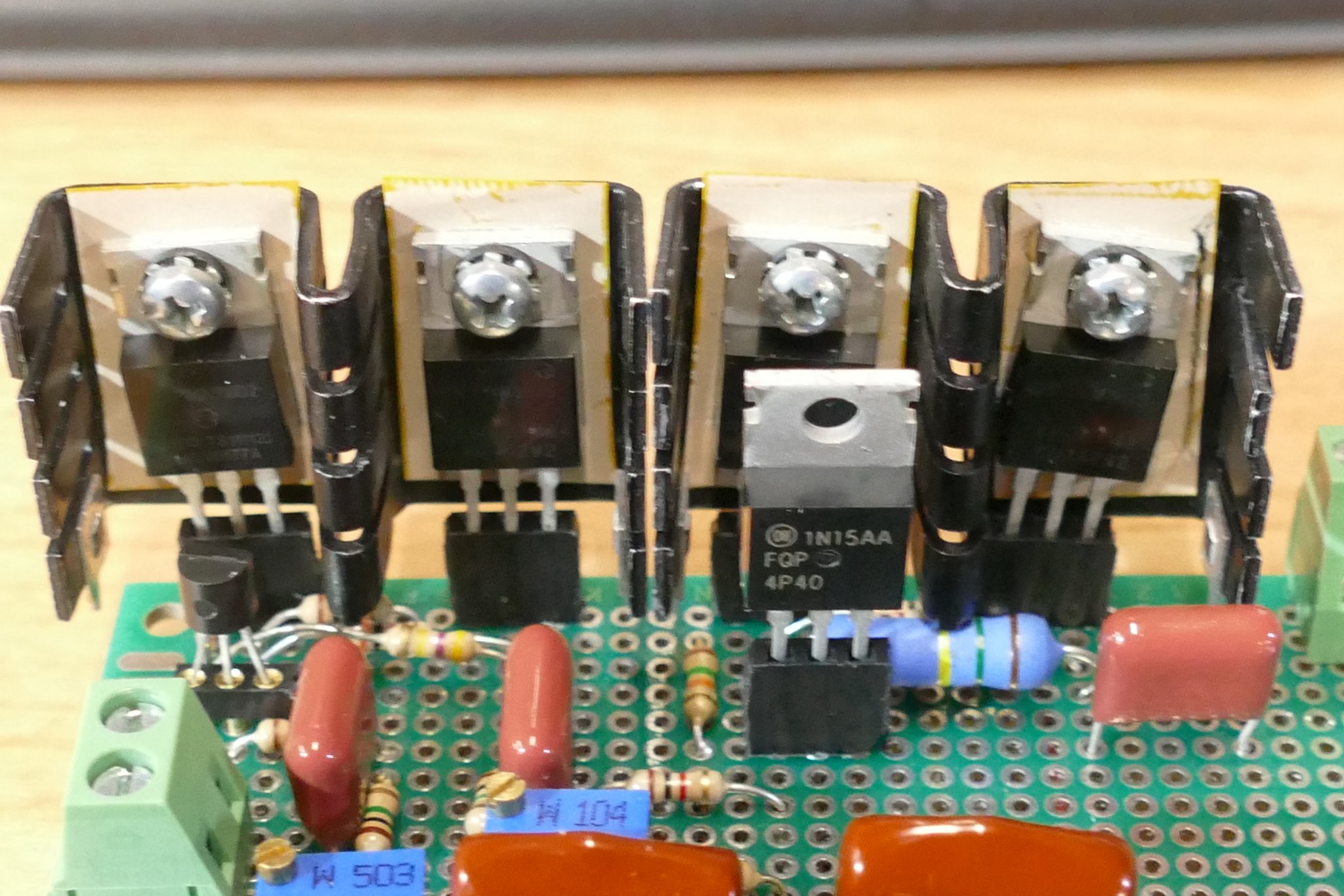

IRF9640pbf good substitute for FQP12P20?
I have used the IRF9640 in my test board, but I don't have any FQP12P20's to compare them to. I have been using the FQP9P25's in my builds both vacuum tube and solid state with good results. Maybe just my imagination but I think they sound better than the IRF9640's. The FQPF9P25 is the same part in an insulated case.
As for the 1N4007's you won't notice the difference between the two. If you are ordering parts anyway, look for some UF4007's. They tend to be a little less noisy in situations where cheap transformers without snubbers are used.

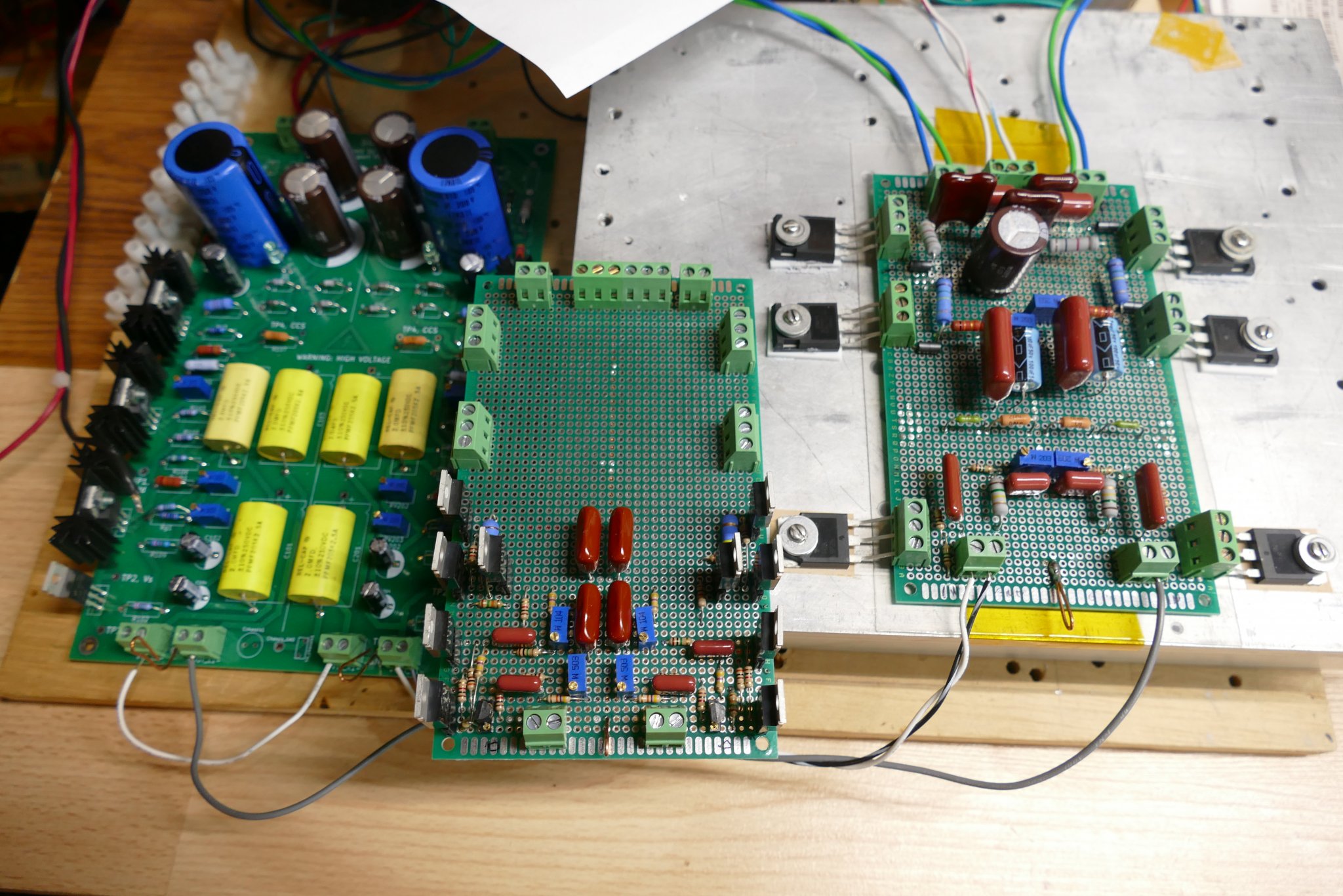

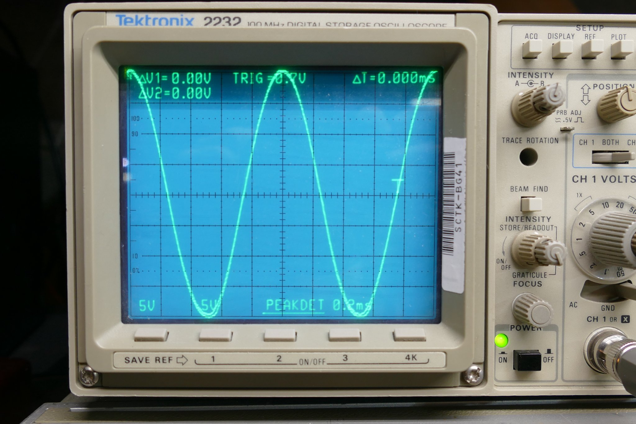

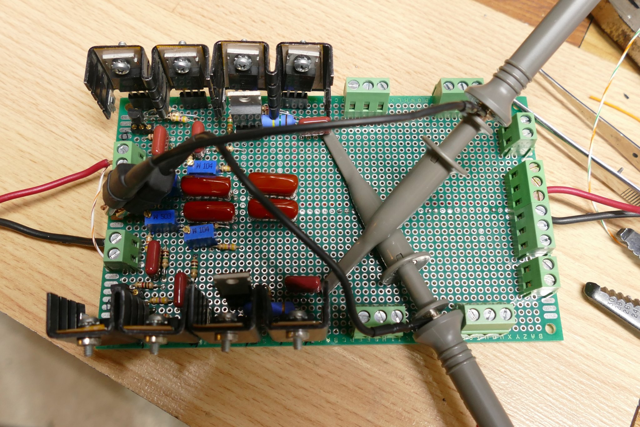

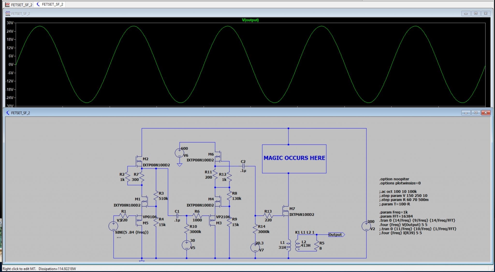

I'm working on a source follower output stage that will need about 600 volts peak to peak of drive voltage to put 50 watts of audio into my 600 ohm OPT's that were intended for vacuum tube use.
Back in post #63 I mentioned a magazine article that I wrote about some efficiency improvements I made in a vacuum tube cathode follower amp back in 2007. I have always wanted to revisit this design, but never got back to it. I thought that vacuum tubes would be my technology of choice, but now I find myself with a board full of mosfets. I have already tested the pair of two stage SCG drivers to 450 volts where they produce over 400 volts peak to peak. I'm about to populate the follower stage, but progress will halt soon for a Super Bowl party at a local marina.
Without some efficiency improvements the board will melt in a minute or so since there is about 115 watts of dissipation in the output FET. A stereo amp would need a few FETs and a really BIG heat sink.
Or is there better?
If you have them hand, use them. George has some good perspective above.
@aljordan yeah, those should work.

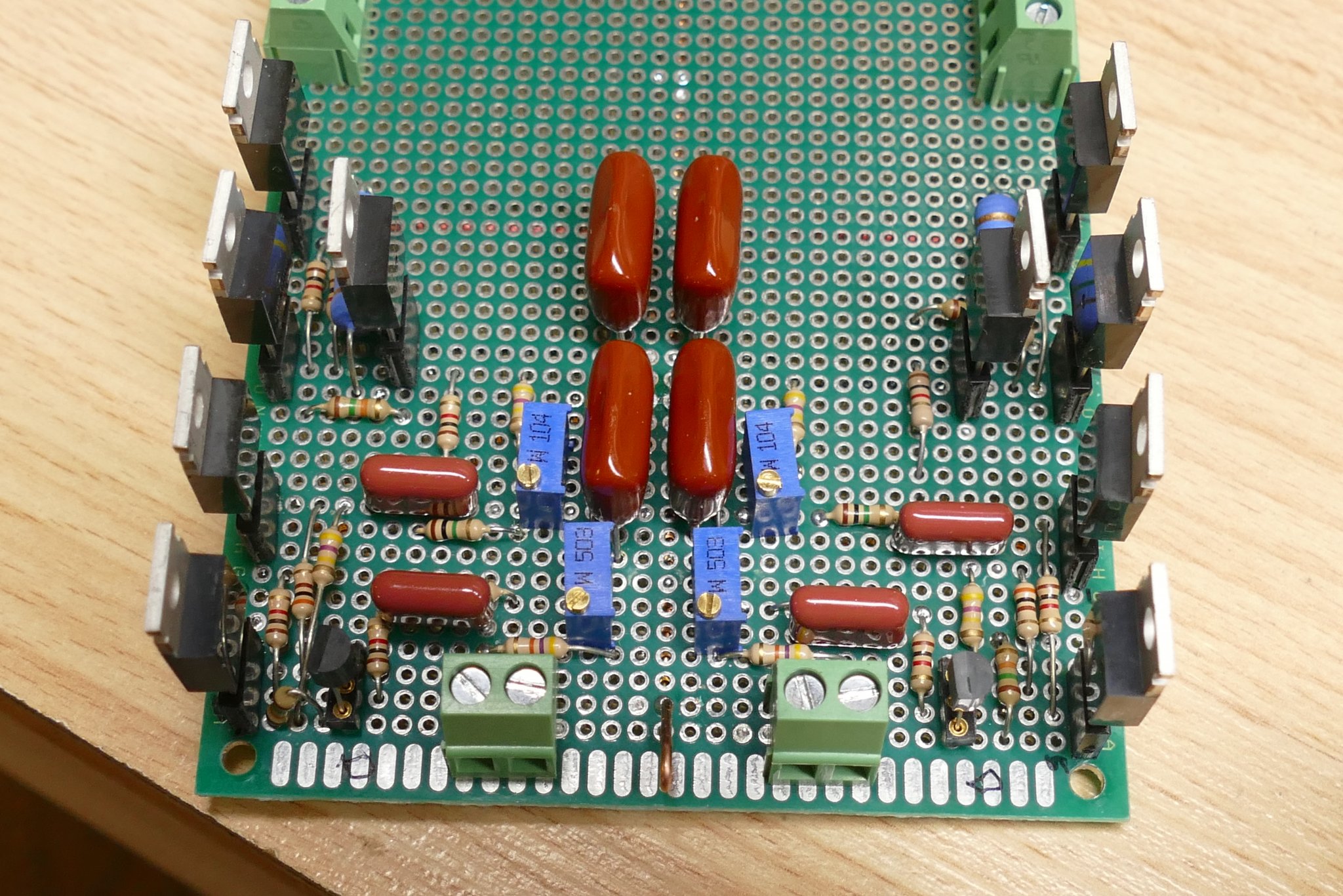

Look at it this way. Imagine a building out in the desert somewhere where the temperature is HOT. Inside the building is a machine that extrudes some kind of pliable material into whatever width you want. The material comes in a one foot wide width and the machine has a knob called "GAIN" that can squeeze out anything from a few inches to several feet in width. Set the gain on 10 and you get a 10 foot wide slab from the machine. Set the gain on 0.5 and you get a 6 inch wide slab. The internal make up in this machine controls the range of available gain. The gearset that controls the aperture of the extrusion horn is the set of feedback resistors on the gain fet. The size and make up of the machine's internal passages impose limits on the range of gains and the overall extrusion speed.
The slab travels down a conveyor belt to the door of the building where it exits onto a flatbed trailer. The door can be opened to any width within reason. As long as the door is open wide enough to pass the width of the exiting slab, there is no problem. The slab goes onto the flatbed trailer. If the door isn't wide enough, "clipping" will occur. Some of the extrusion will be "clipped off" on both sides. This door width is the power supply voltage. As long as it's high enough to support the gain and overall width of the slab, the system will work fine.
We could just leave the door wide open, running our machine at any gain and width we want, but remember we are in a desert and all that heat will come inside and fry our machine as it's made of silicon, so we want the door open just wide enough to avoid clipping without allowing too much heat.
The machine must be centered in the doorway or one side of our slab will hit the door frame before the other, limiting our slab width unnecessarilly. We need to keep our machine centered in the doorway, so we have a knob called "BIAS" or idle current, that can adjust the centering.
We test our machine / doorway setup with a constant width slab (sine wave) but remember that it makes a rather complex shape whose width is constantly changing. We need a little extra width in the door (headroom), and a possible offset in the machine bias to accommodate whatever slab profile (music) and flatbed trailer (speaker system) that comes our way.
We can see that the gain and headroom are intertwined but rely on totally different mechanism.
The original quest that led me down the common grid / common gate path was an attempt to get triode like curves from a pentode tube or mosfet. The original work on this idea goes all the way back to the late 30's in a paper published by Schade. He proposed adding feedback from the plate of the tube to the grid to get triode like curves from the new 6L6 pentode tube. Most of his proposals attempted to put the feedback and the drive signal into the same element (the grid) of the tube resulting in imperfections due to the varying impedances involved when the two signals met.
Ham radio operators in the 50's found that grounding the grid of the amplifier tube and feeding the signal into the cathode worked well and provided a method to "cheat" the "maximum DC input power to the final RF amplifying device" rule imposed by the FCC at the time. My work with UNSET simply combined those two approaches.
The first follower stage is a method of getting the signal into the cathode / source with minimal distortion. A transformer will work as well. This allows the gain stage to work as a common gate amp for the audio signal, and a common source amp for the feedback signal. This combination produces near ideal triode curves which is what imparts the "Single Ended Triode" like sound. You may find that changing the topology imparts a significant change in the design's "sound" signature.
I have gone pretty far in the "increasing the gain" direction without negatively affecting the sound. It may be possible to go just as far in the "lower the gain" direction too, but I have not been there.
You can get these connectors that are popular with the Arduino community. They will fit right into the SCG board and allow plugging in ant TO-220 fet available. I have seen them in three pin sizes, but I just get the long strips from Amazon and cut them up with wire cutters.
The three pin socket for the TO-92 device is just a piece cut from an 8 pin DIP IC socket. Use a machined pin socket. I have seen strips of these on Amazon as well but didn't have any at the time I decided to "shrink the SCG board."

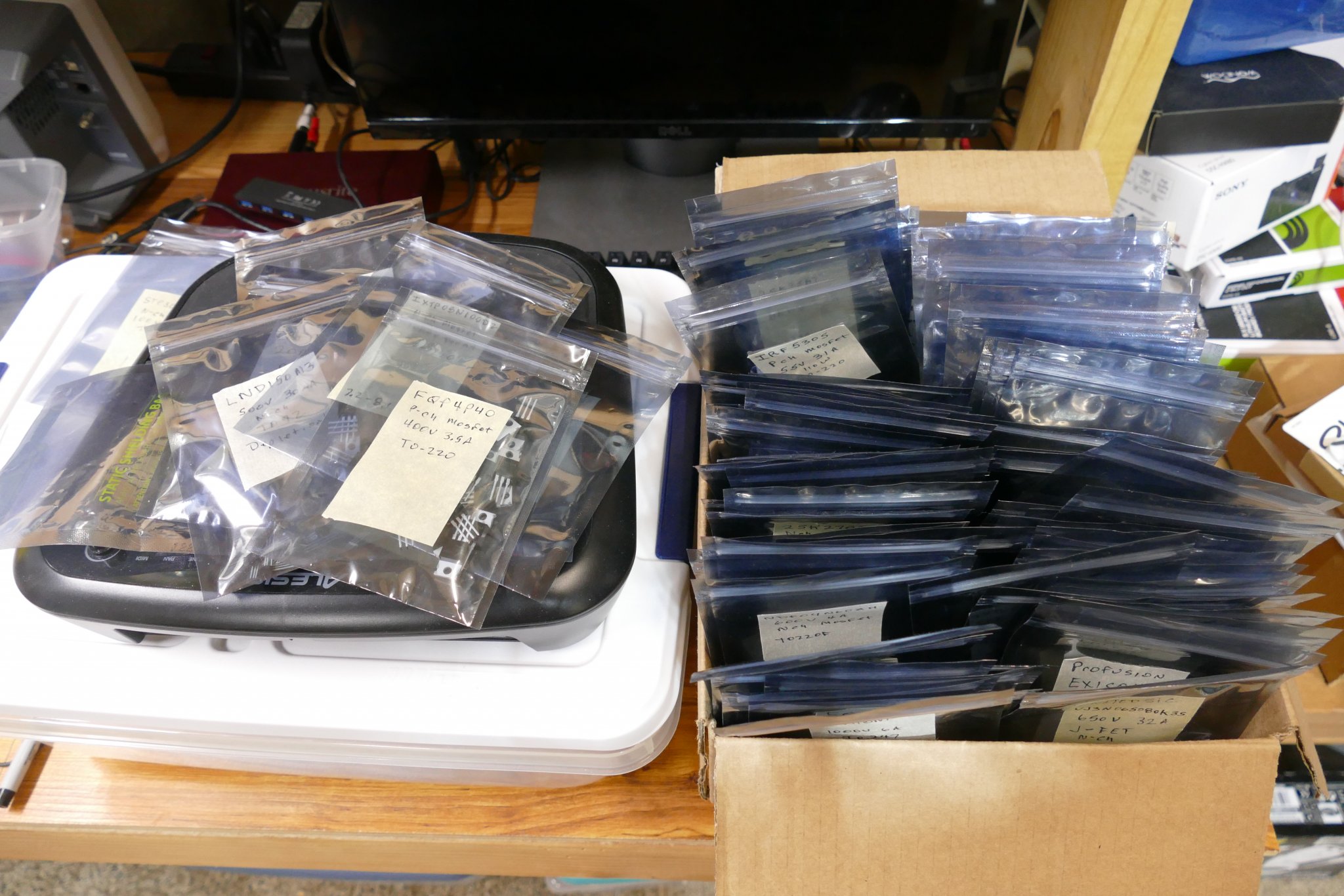

I have a fair collection of mosfets to try, and another smaller collection of J-fets and BJT's. Some are 30 to 40 years old.
