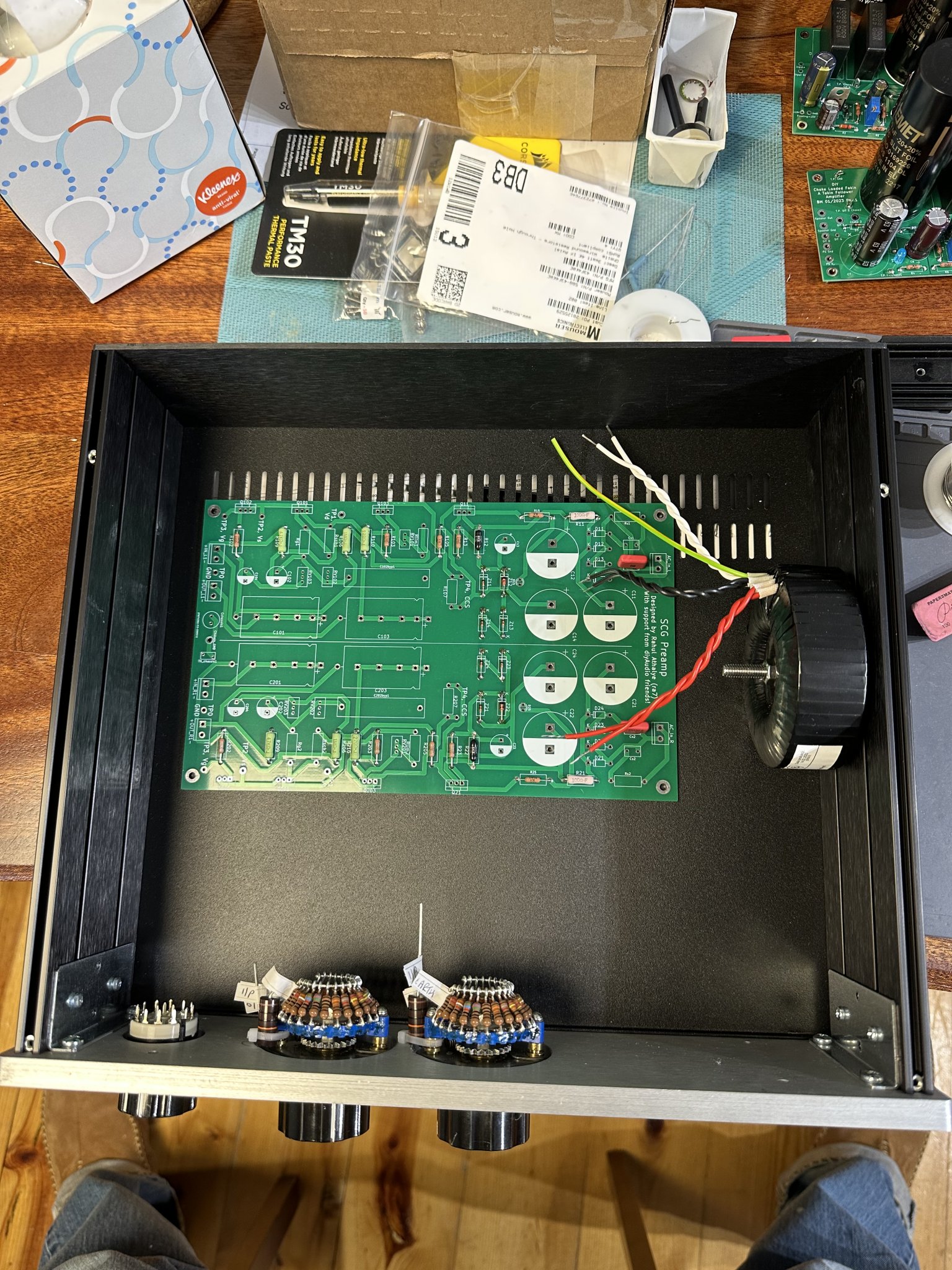

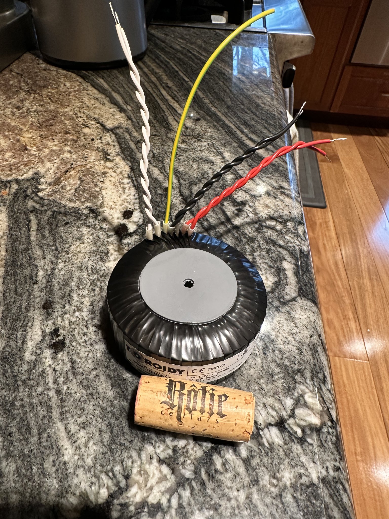

Compact Toroidy
Reactions: ra7 and Vunce
Yes, I have some but they are almost gone again.
In other news, I have been working on some circuits that will drive headphones. Actually, the current circuit also drives my Etys just fine but I am curious to hear what could be achieved with a powerful follower.
