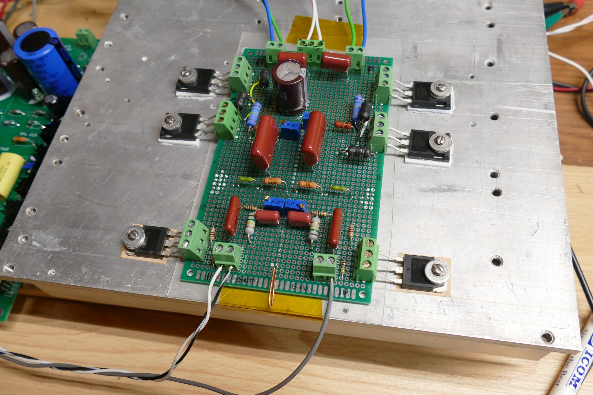

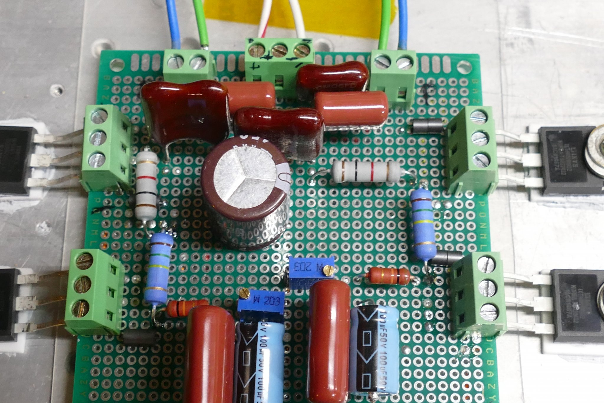

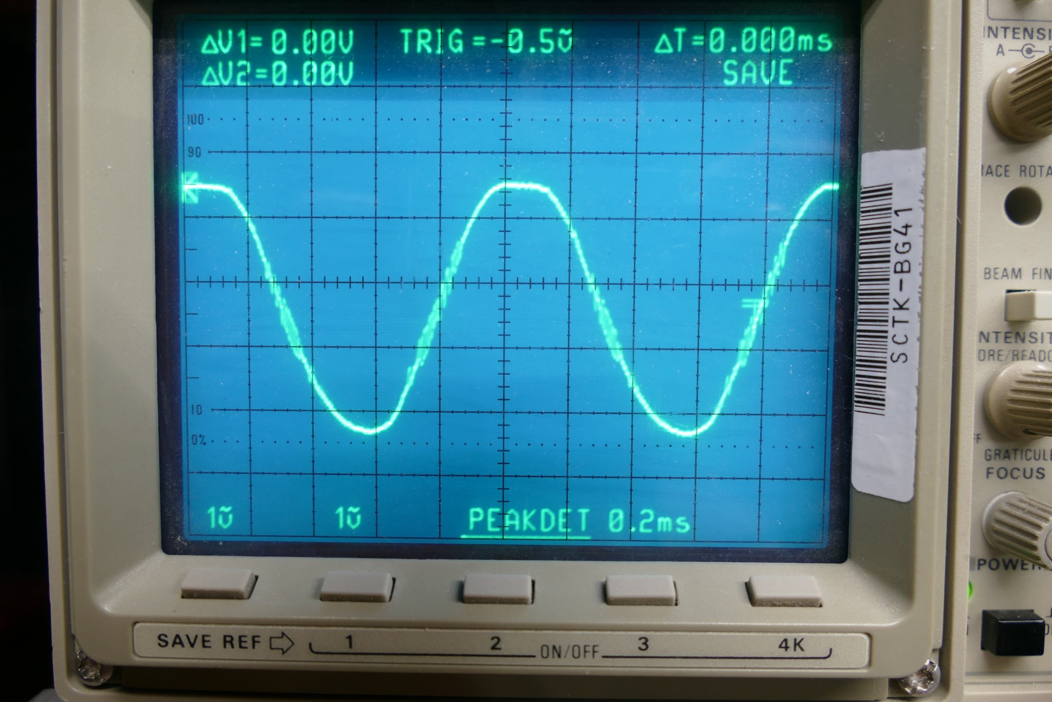

Yesterday I tried to put some SiC J-fets in the high powered board in the output device position. I could not get then to work without changing some component values, and I didn't have much time, so I abandoned the idea, at least for now.
Last night and this morning's more ambitious idea was to fix the heat issue by ripping apart my breadboard and adapting it to use two parallel mosfets per channel. When I fired it up this morning I was met with high powered oscillations at about 1 MHz. There was so much RF in the air that my cheapie DVM read random numbers on the 600 volt scale with its probes lying on the bench and my old vacuum tube Knight Kit power supply that feeds the SCG board would start putting out random voltages in the 100 to 300 volt range depending on where my hands were in the air above the board.
Much of this was cured by putting jumpers across the source resistors. I had run out of the Dale 1 ohm 2 watt 1% resistors that I usually use, so I used some half ohm unknown resistors that are probably wirewound.
With those resistors bypassed there was still some oscillation present, but it was tame enough to see 40 watts per channel at the onset of clipping on 300 volts and mosfet temps around 65C after 20 minutes or so at idle with the upside down (too hot) heat sink.
I think the next step is to clean up the breadboard routing or build a new one.

I know there is a thread on oscillations, but how do you know they are happening? Watching it on the scope? This is a general question. How do you watch for oscillations?
I love the breadboarding technique. On that particular breadboard, the points aren’t connected in a pattern, right? So, how do you connect them? Beneath the pcb? I have done it that way.

The insulators are solid alumina which is quite brittle. Thin stuff will shatter.
Oscillations are obvious sometimes, and obscure and hard to find in other times. This was probably one of the most blatant, obvious cases I have seen in a while. The scope wired directly across the speaker leads went bonkers with anything from 10 volt P-P sawtooth waves at about 1 MHz, to random "confetti" filling most of the screen. Waving my hands above the board without touching it made the idle current change. An unconnected DVM near the amp read -400 volts which changed whenever you moved near the board.
Sometimes things are not so obvious especially with higher frequency oscillations that will not make it through the OPT.
As it stands now after bypassing the source resistors and messing with the grounds and wire dress I have it down to a minimum, but it's still visible on the scope in the zero crossing areas of the sine wave as the amp is pushed into clipping. Worst case is usually the transition from one output device to the other in a class AB push pull amp.
In the past I sometimes found "invisible" oscillations with a portable AM radio or analog TV set tuned to a weak station. If either misbehaved as you ran your hands over the tubes and other non conductive surfaces, it's a sure bet that something is oscillating somewhere. I have built tube amps that wiped out a dozen or more channels on every TV in the house back in the OTA analog TV days. Modern digital TVs are far more immune to such interference and don't make good detectors. I have an RF spectrum analyzer for sure fire testing, but I didn't need it today.

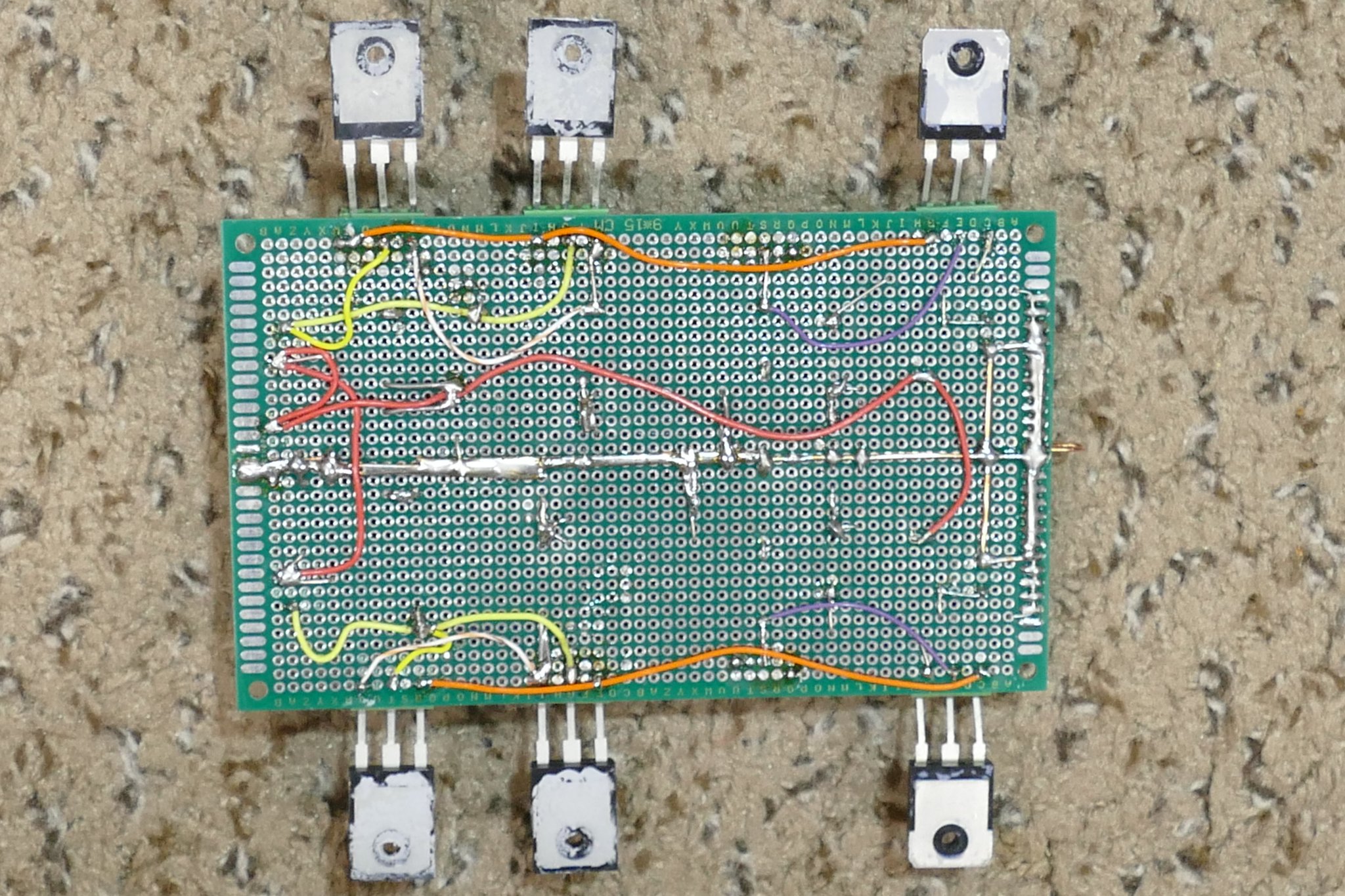

Connections on the breadboard are made with component leads or thin hookup wire. I'll flip it over and take a picture the next time it's off the heat sink.
There are lots of pictures of this kind of prototyping including some of mine and some that are far better than mine in this thread:

I stated that I would post a picture of the back side of the proto board, so here it is, photographed during yesterday's modification session. The oscillation still persists, though it's now tame enough that I can play music through it, and crank it to the 40 WPC level without blowing any parts. The second picture shows a burst of oscillation that pops up on a bass guitar solo that is putting about 40 volts peak to peak across my speakers. Today's experiments will involve the gate stopper resistors and some "magic (ferrite) beads." Unlike Bybee purifiers and Shakti stones, these actually do something.

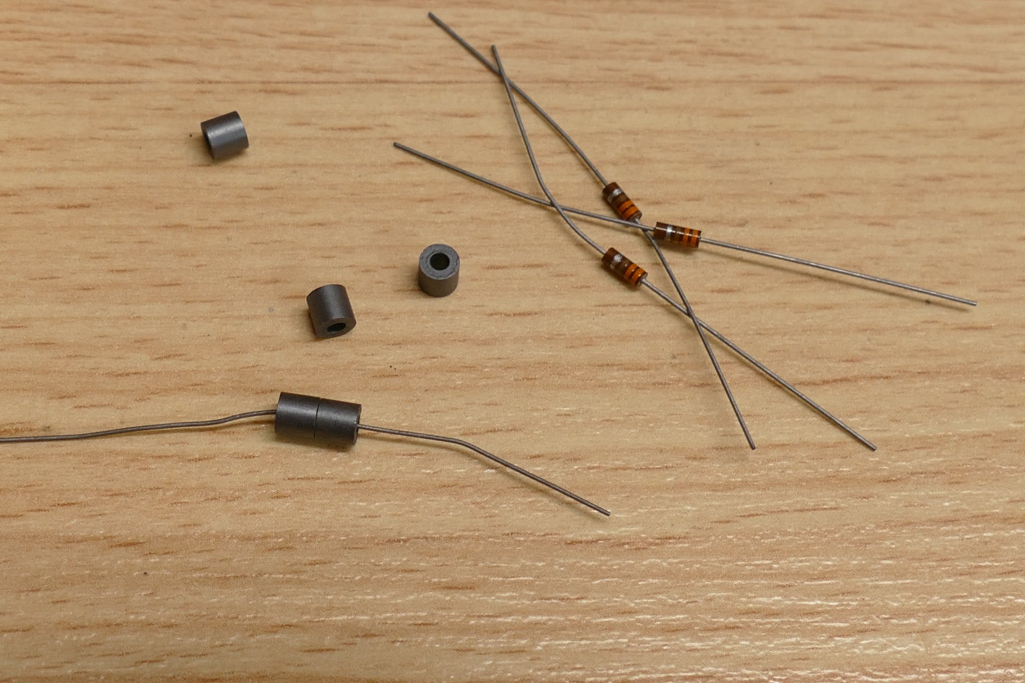

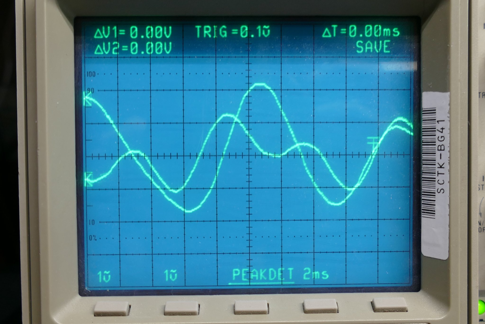

My oscillating amp had one 220 ohm stopper resistor shared between two mosfets, not exactly ideal. After a general layout clean up including snubbers on the OPT primary and better B+ bypassing, the full on radio transmitter stuff was gone, but the random bursts were still present. I have dealt with these before when using mosfets to directly drive vacuum tubes, so I busted out the "magic beads."
In mild cases I generally put a bead on each lead of the stopper resistor. I bad cases a bead goes on the non common leads of the mosfets as well. larger beads go on the plate leads of the output tubes. In this space constrained build my first attack was to stuff a 330 ohm 1/8 watt carbon composition resistor inside two beads. A DIY Bybee? I put one of these right at the "socket" pin for the gate of each output mosfet.
In this case that cured all of the oscillation. The picture shows the same piece of music cranked to the edge of clipping, but I couldn't capture the exact same musical moment just by pushing the "store" button on my 30 year old TEK scope. I saw no ugliness in 4 plays of this song at different volume levels. All levels had random bursts yesterday.
The board has been removed and replaced 4 times since I properly applied thermal goop so I didn't run it at full power for long. I'll redo the goop and take some measurements later today, or tomorrow.

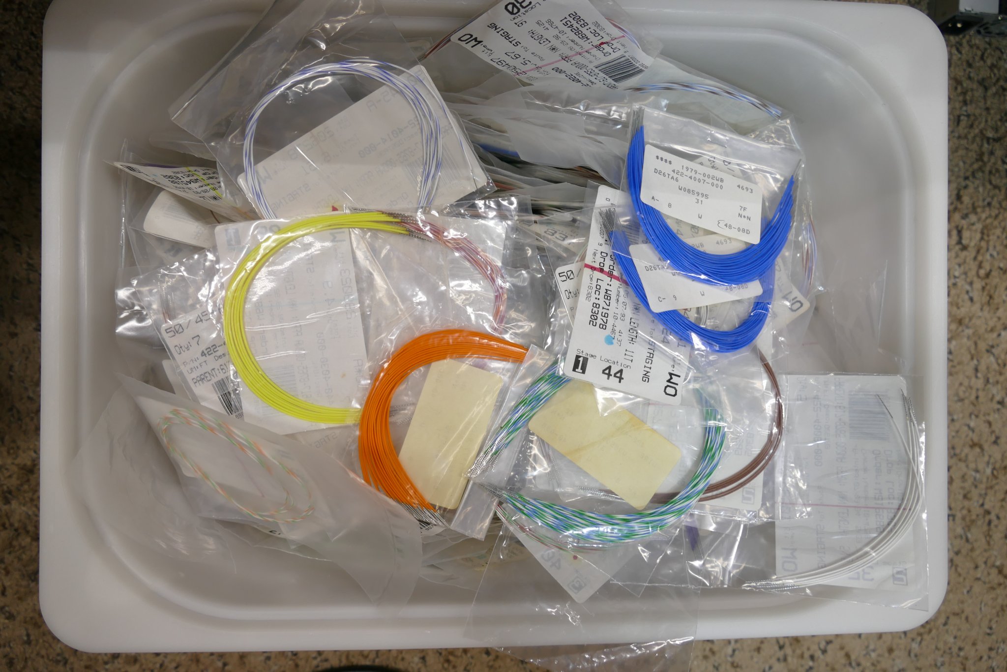

I got a huge bin full of "Teflon covered silver plated stranded copper wire" for like $10 because it stuck to a magnet. All is pre cut and stripped in individual military packaging with FSNs (Federal Stock Numbers) which do state Teflon silver and copper. That is the colored hookup wire I used to wire up my breadboard, and virtually everything that I have built for the past 25 years or so. Quite a few of my resistors are also magnetic.
