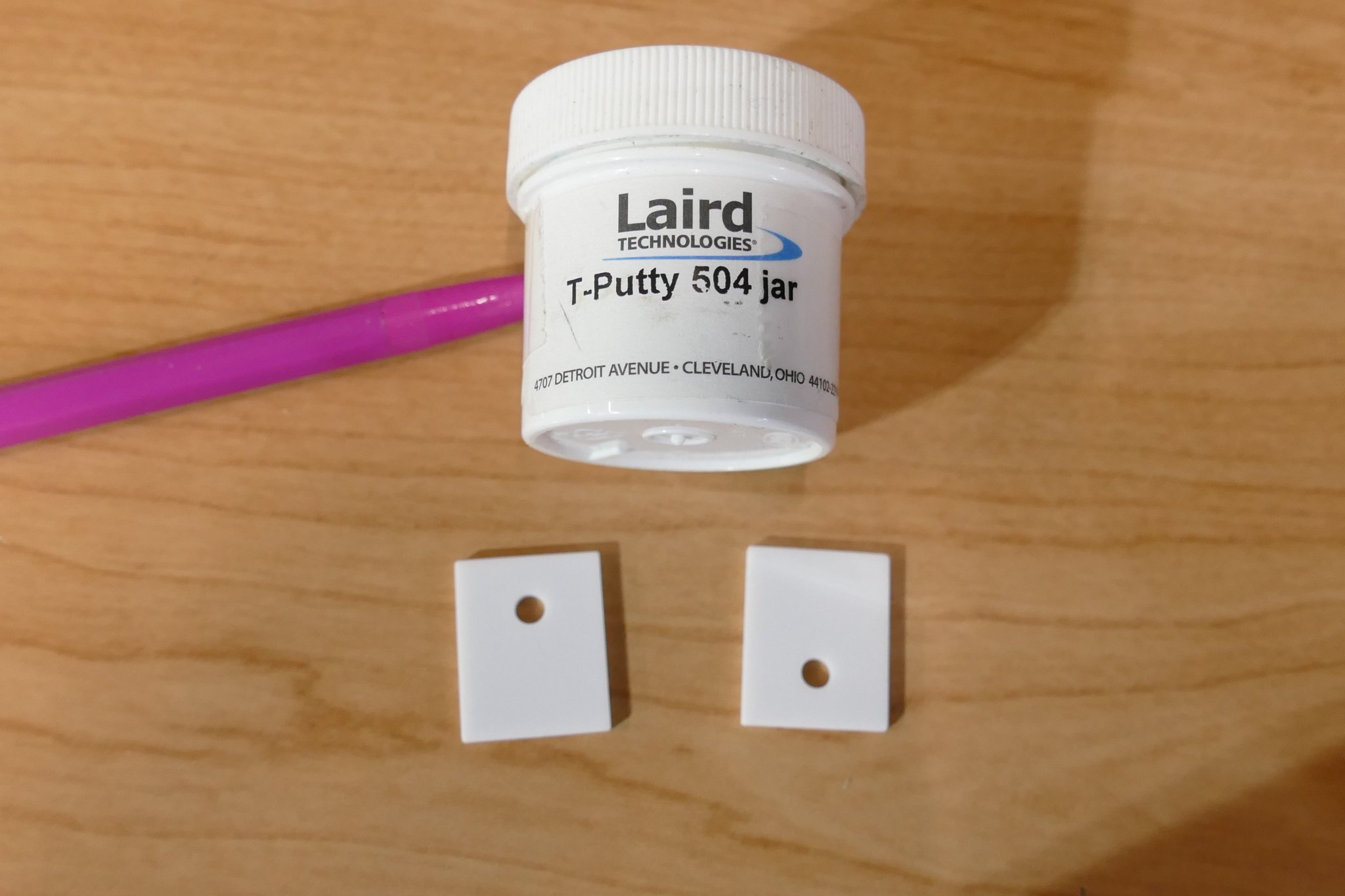

Ceramic insulators and goop👍

I am into the Keratherm thingies without the goop. Much easier to manage.

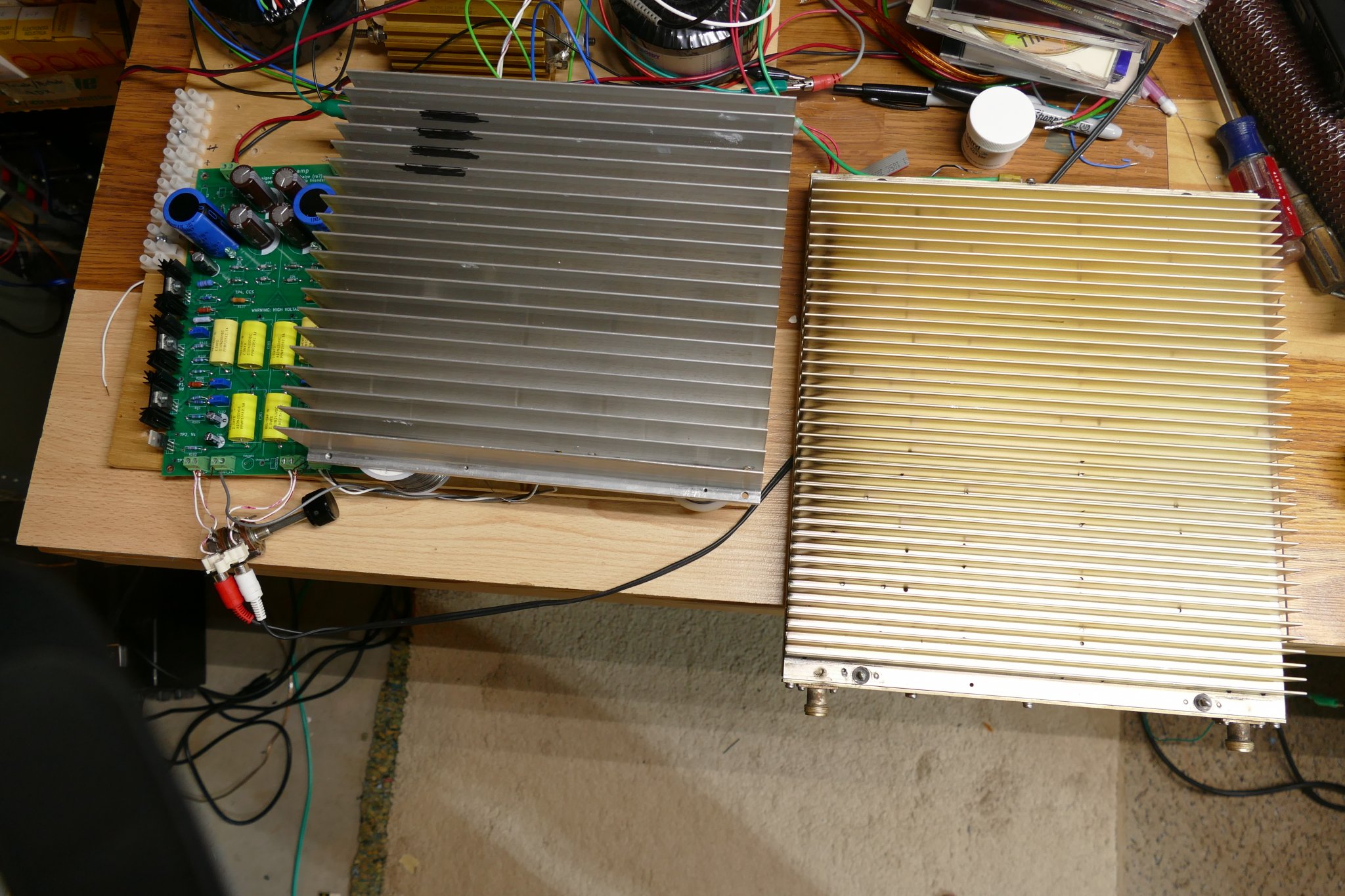

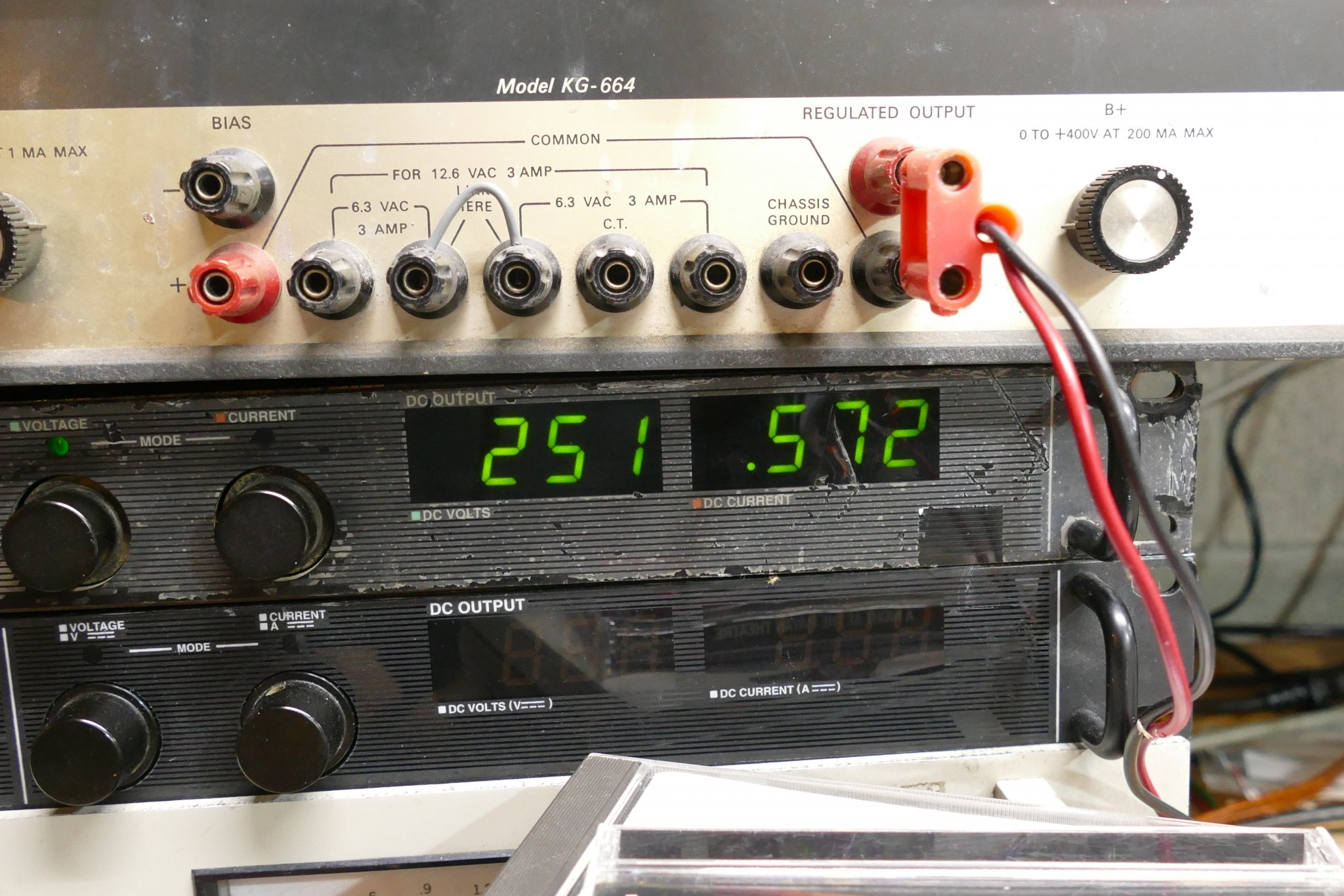

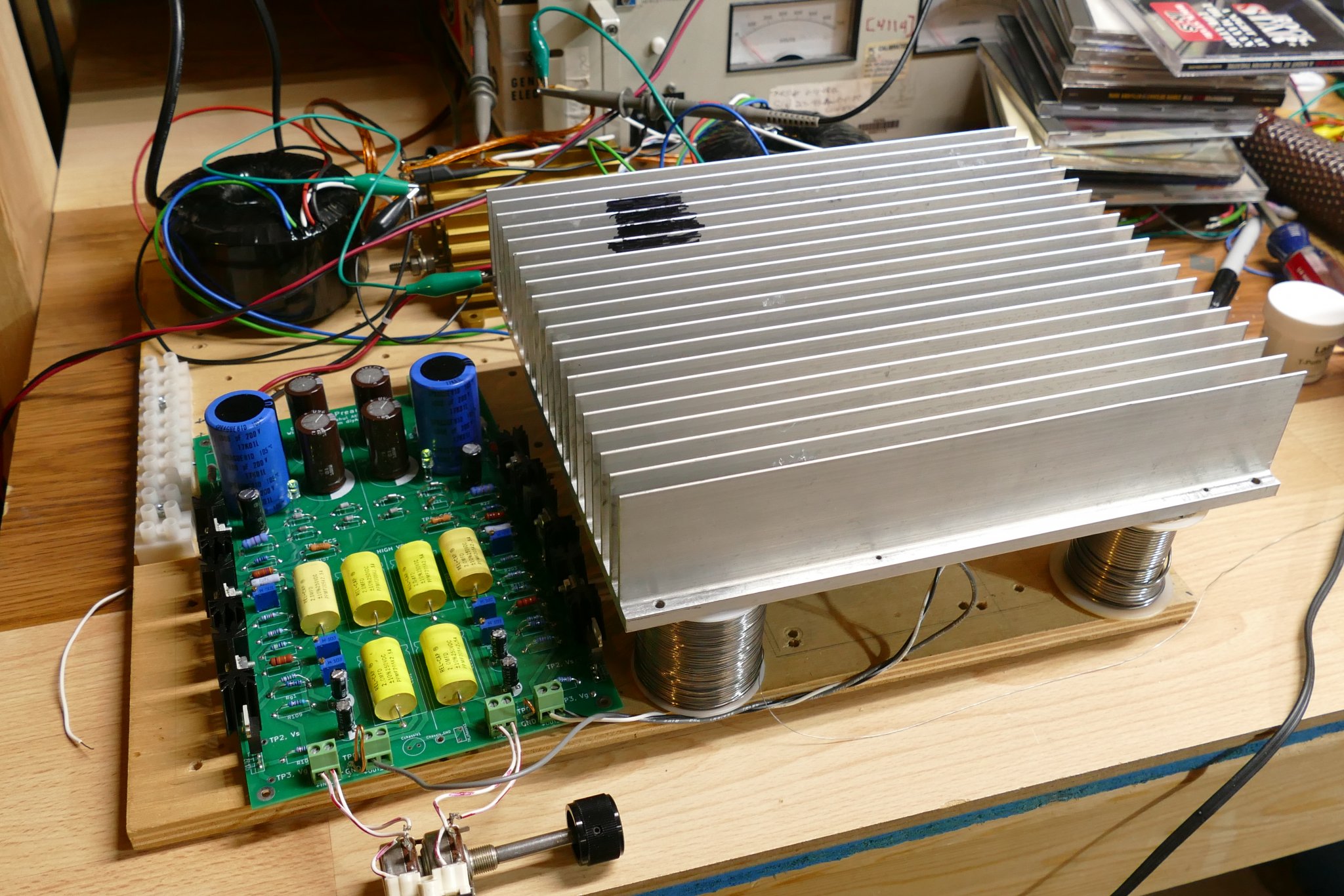

For tonight's experiment I flipped the heat sink right side up and carefully placed it on three lead filled dampers to support it. I set the power supply to 250 volts where the current started out at 530 mA and leveled off at 575 mA after everything got hot. That's 143.75 watts going into the board. Maybe 3 or 4 watts are burned in the resistors, so 140 watts gets sent to the heat sink. I blackened a few fins on the sink with a Sharpie so that the IR thermometer might read the temp. After 3 CD's had finished at a very low volume for max dissipation. I believe that the heat sink was around 55C. I could keep my hand on it for about 10 seconds. The output mosfets were around 80C though.
I have some other heat sinks stored in another building which I will try to get to tomorrow. I have two of these, but that would be a BIG amp.

Last night's test was to find out how much power I could stuff into that heat sink before it got over 55C. I kept clicking the funnygun all over the heat sink and assumed that the highest number was closest to the correct temperature. I may try some of those Cole-Parmer Digi-Sense stick on strips to get a better handle on the actual temp rise. We used them at Motorola for basic heat sink testing. We tested our power amps inside a temperature chamber to simulate "cop radio in the trunk of a black cop car with the officers jacket thrown over the radio" kind of conditions.

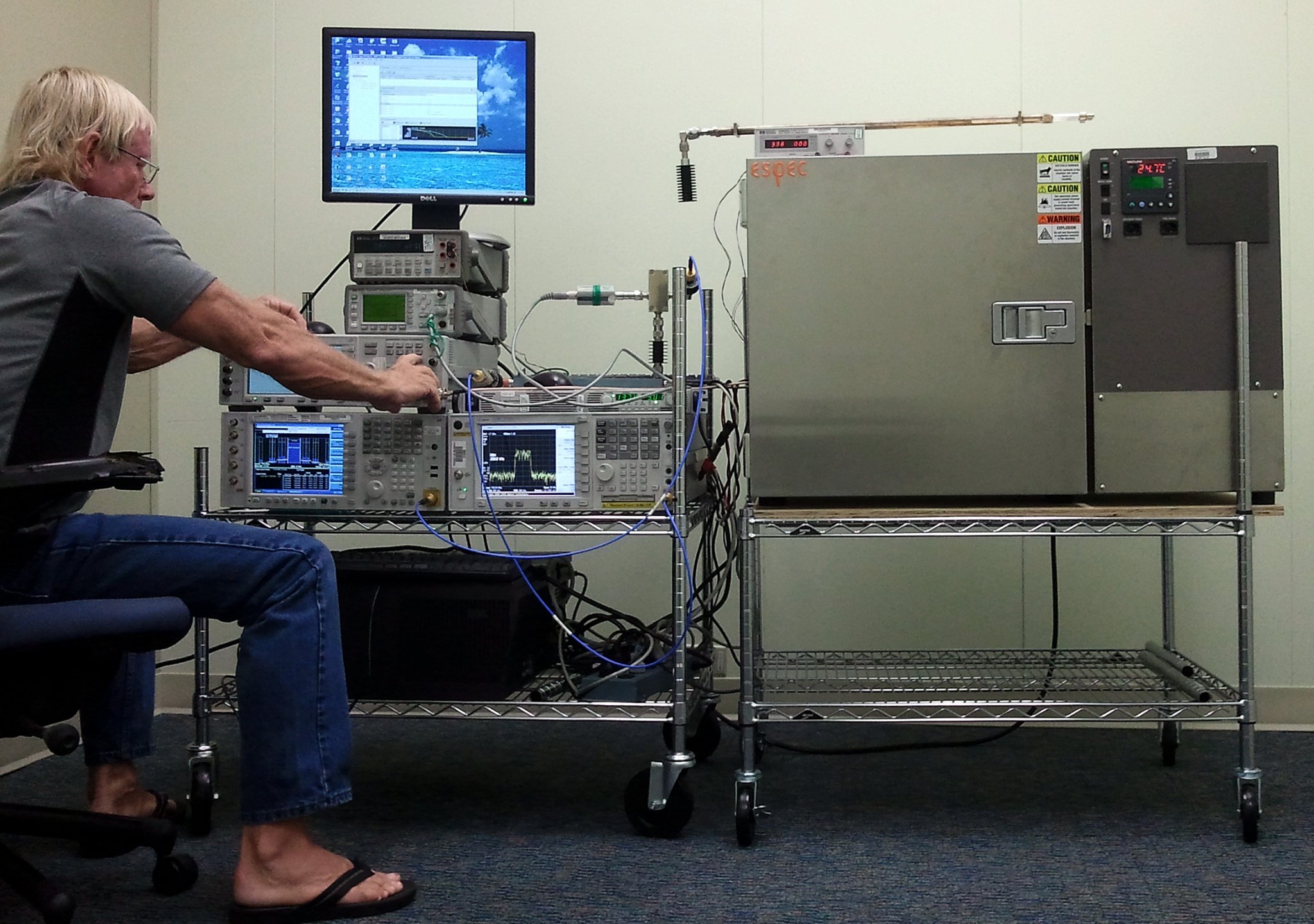

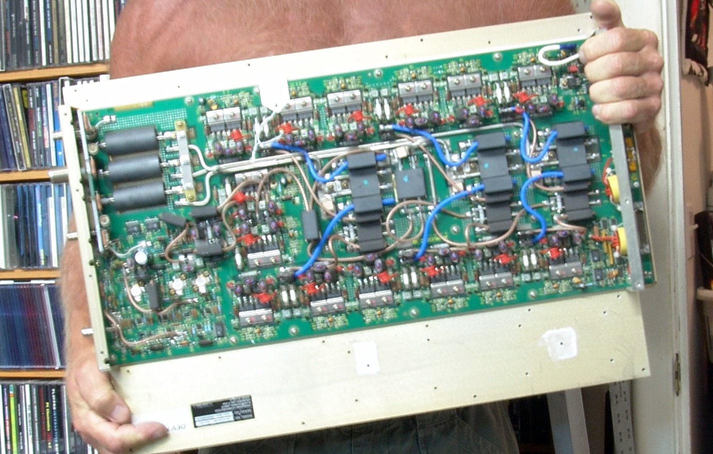

Here is one of my test radios. It puts out over 100 watts of peak LTE power at 770 MHz. The second picture shows me working hard at testing it.

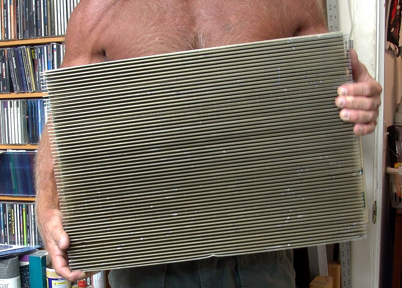

If a big heat sink is good, maybe a bigger heat sink is better........too bad I sold the really big one!

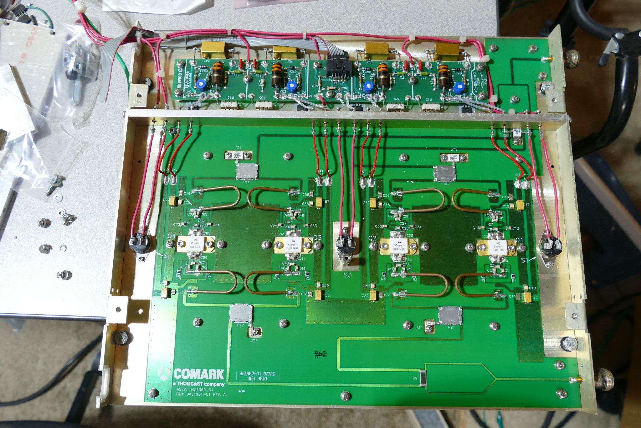

The gold anodized "bigger" heat sink is from a driver amp in a TV station. I got two at a hamfest several years ago for $10 each. I'm about to open it up to see how reusable it is.
The "really big one" was from a 2.5 KW (pulsed) RF amp out of an MRI machine. I stripped off and kept the RF stuff including some big mosfets, then sold the heat sink for more than I paid for the whole amp.
Yeah, I had no idea that I could be building a big class A solid state amp when I sold it.
It is big, and heavy but the fins are so close together that the free air flow into the spaces is likely zilch. I'm sure that the MRI machine used forced air cooling.
The TV station amp looks like an easy part-out, but I'll probably need to drill and tap some holes. I will find out later tonight.

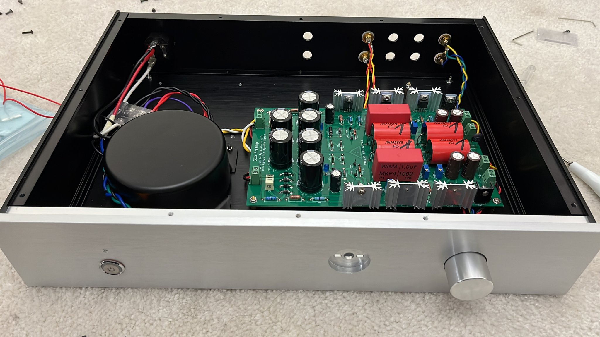

This preamp deserves much better chassis, so off goes BA2018 and comes in the SCG
- Schade Common Gate (SCG) Preamp
