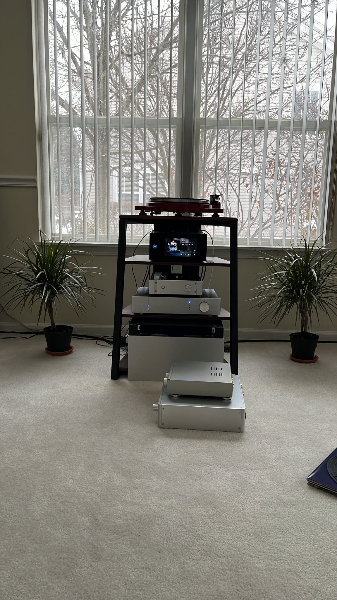

It’s playing on my main setup and just sounding awesome 👏

It sounds great and I would say forward sounding compared to the HPA and Elekit. Base is just too good never heard it so tight and clean on my klipsch horns 👏Sound impressions? Did you hook to your sissySit?

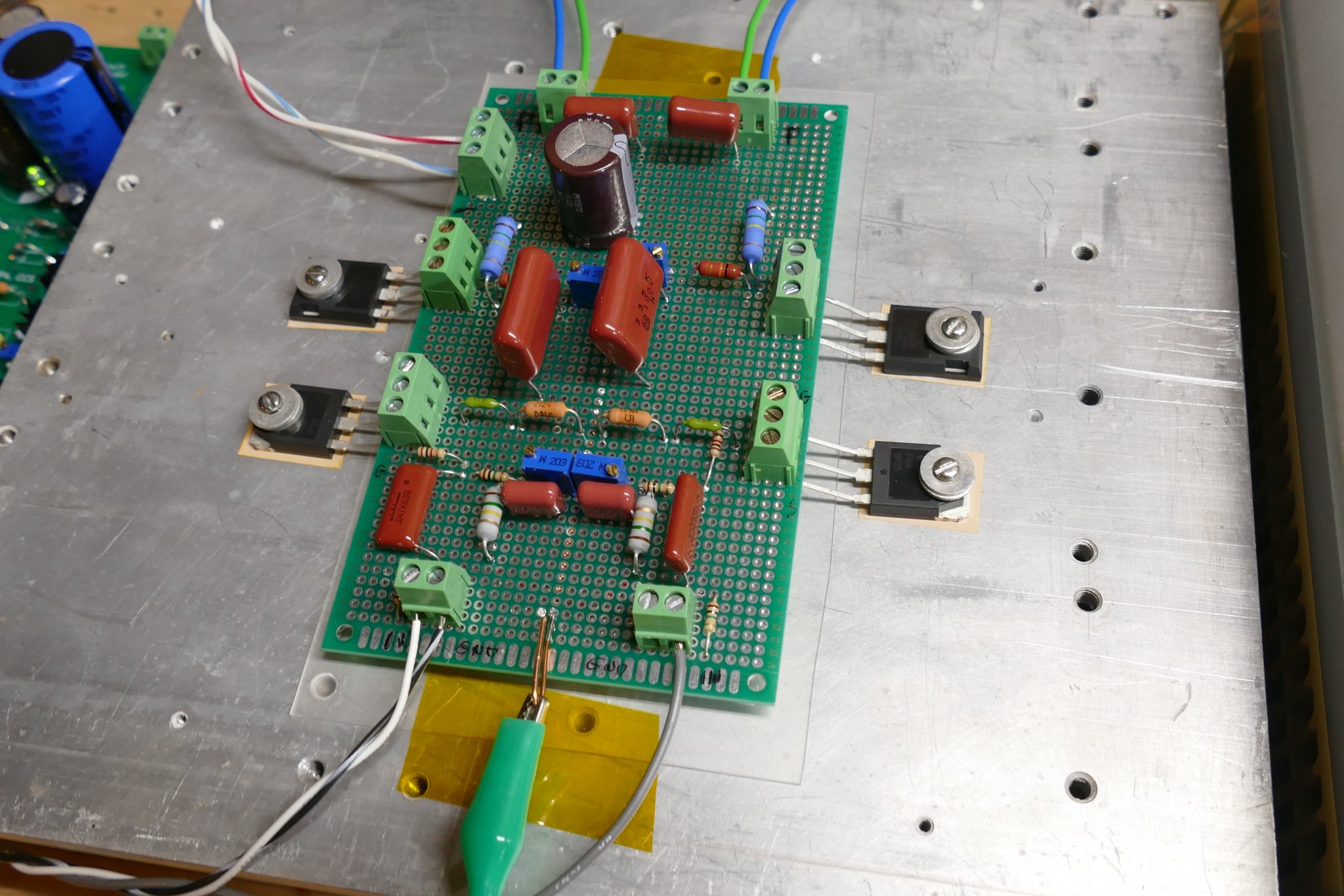

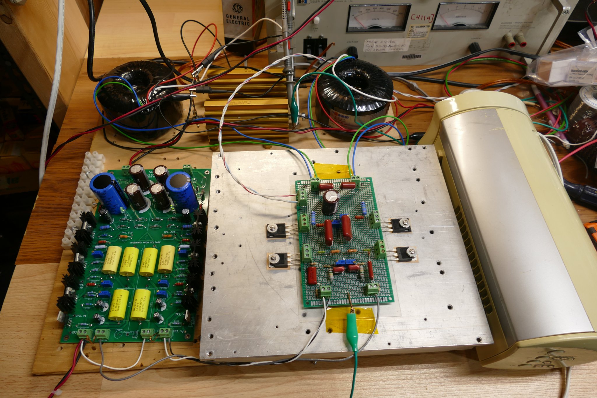

Today the breadboarded high powered SCG amp met the big heat sink shown in post #644 and got connected up to the output of the SCG board I made earlier in the thread. The big heat sink was also fed a stream of air from a portable fan. I cranked up the board on a big Sorensen power supply capable of sourcing a kilowatt and experimented with the higher powered end of the thermoelectric spectrum.
The last time I made a class A power amp I was a kid using those big TO-36 germanium transistors pulled from the back of late 50's / early 60's car radios. My "power supply" was a Lionel train transformer, some alternator diodes, and some big caps. Those transistors just started sounding good right before they blew up.

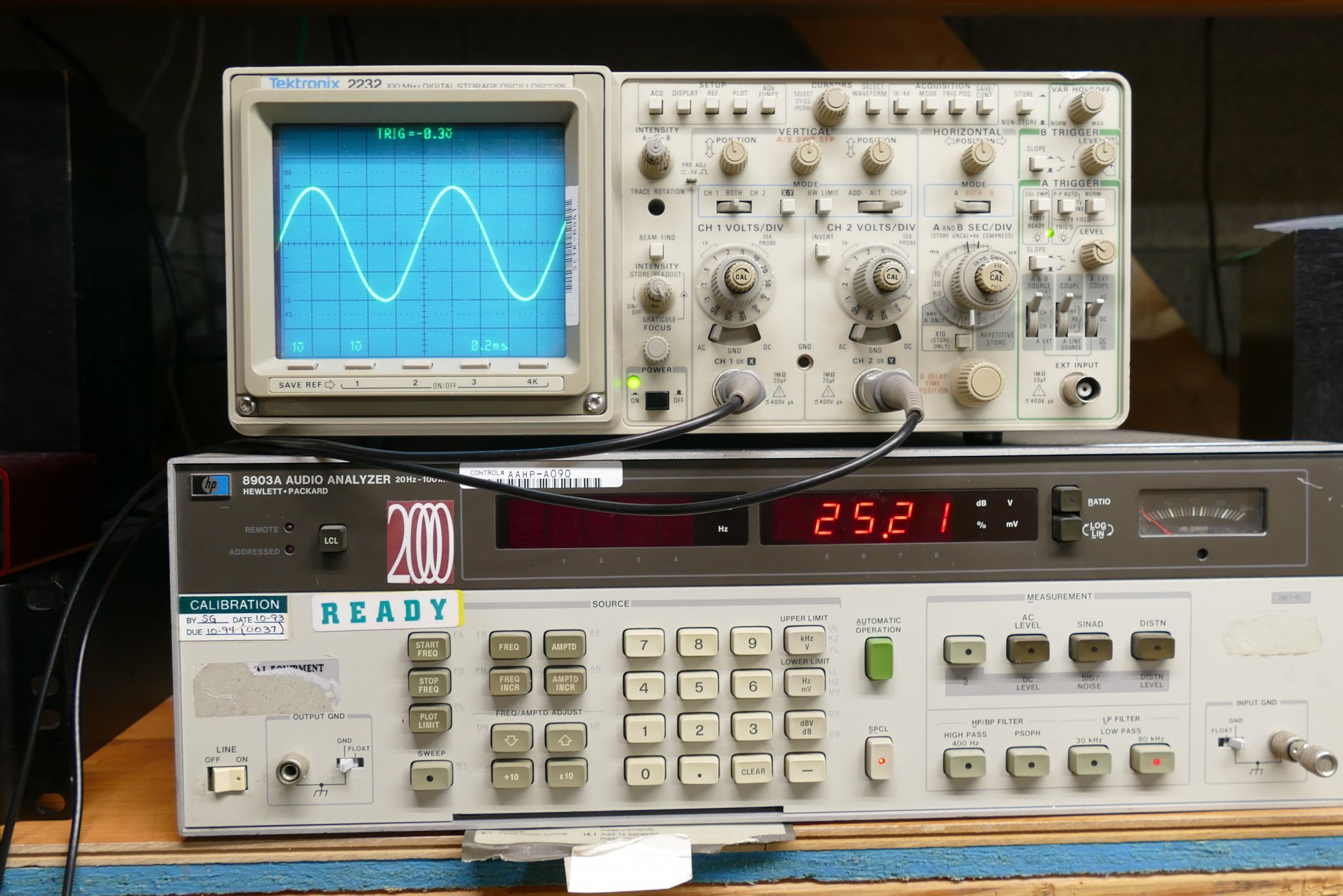

The first picture shows the setup. The beige thing on the right side of the heat sink is a portable fan on its lowest setting that blows air across the heat sink. The third picture shows a pair of overlapping sine waves on the scope from two equally matched preamps and power amps. The analyzer reads a bit over 25 watts in one channel. THD was about 1.75. The power supply for the power amp reads 306 volts at 732 mA. I am pumping 224 watts into this board and extracting 50 watts from it. At this level the output fets show about 70 degrees C on my $24 Amazon quality IR thermometer. Shutting off the drive however, makes the board eat all 224 watts pushing the mosfet temp over 90 C. With the fan running on low the heat sink is slightly warm and there is a noticeable thermal gradient from one side to the other with the coolest side touching the fan.
Measured performance is outstanding:
Power Left Ch THD Right Ch THD
100 mW 0.176% 0.166%
500 mW 0.172% 0.153%
1W 0.214% 0.181%
2W 0.268% 0.224%
5W 0.414% 0.337%
10W 0.554% 0.477%
20W 1.12% 1.00%
25W 1.77% 1.62%
30W 2.99% 3.35%
Things got hot, but nothing blew up. I'm not sure just how far I can push it though. How hot do you guys push your class A mosfet amps?

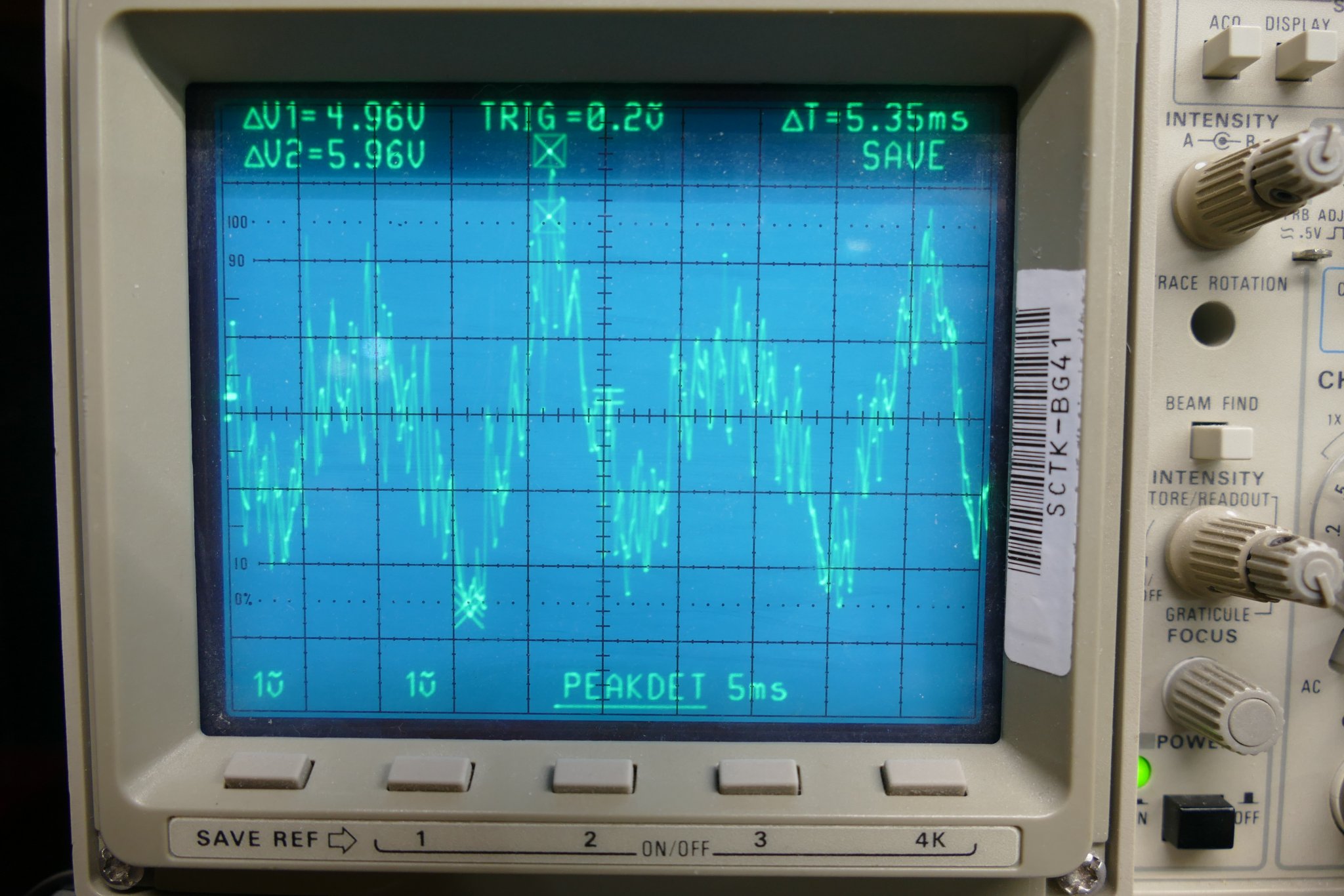

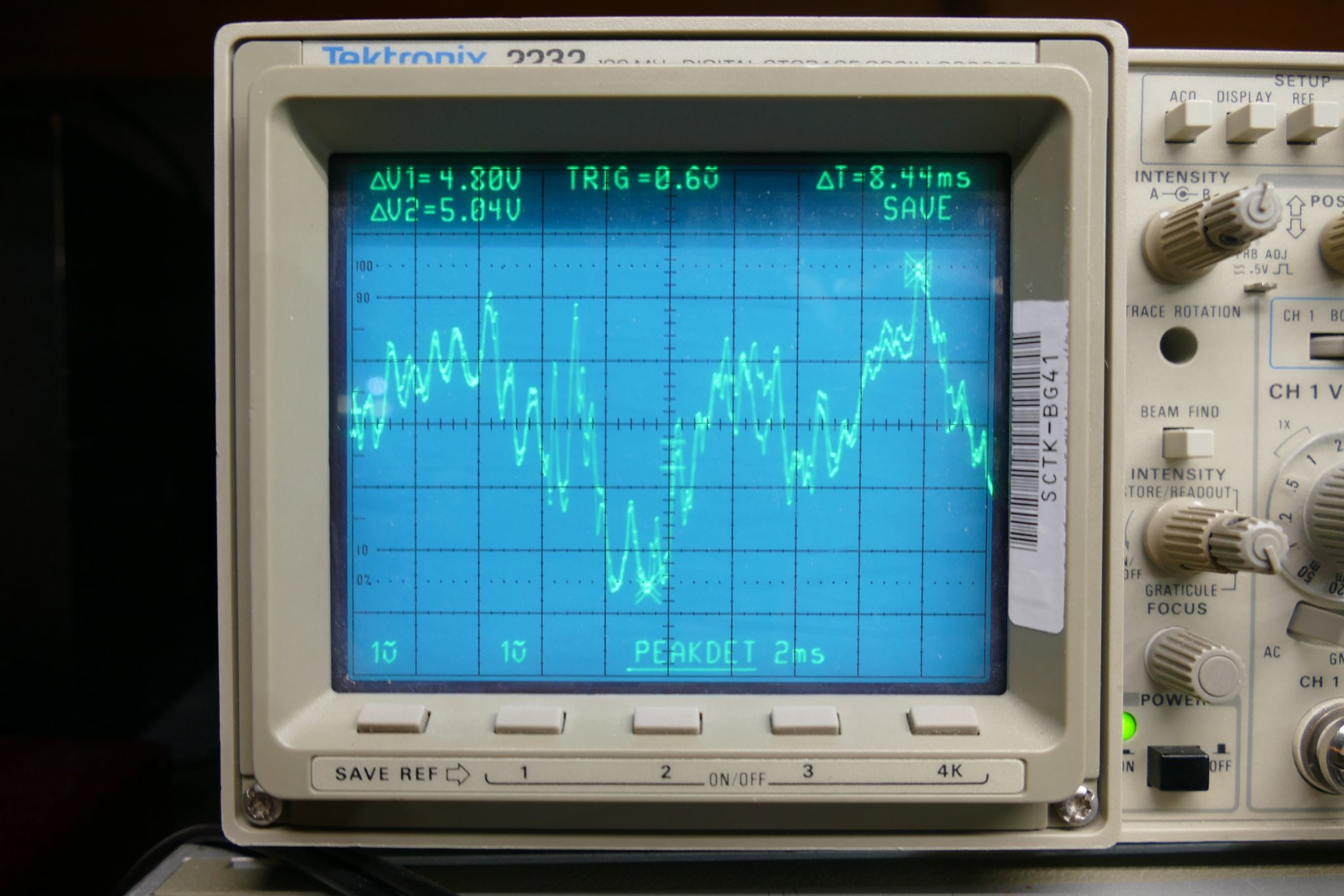

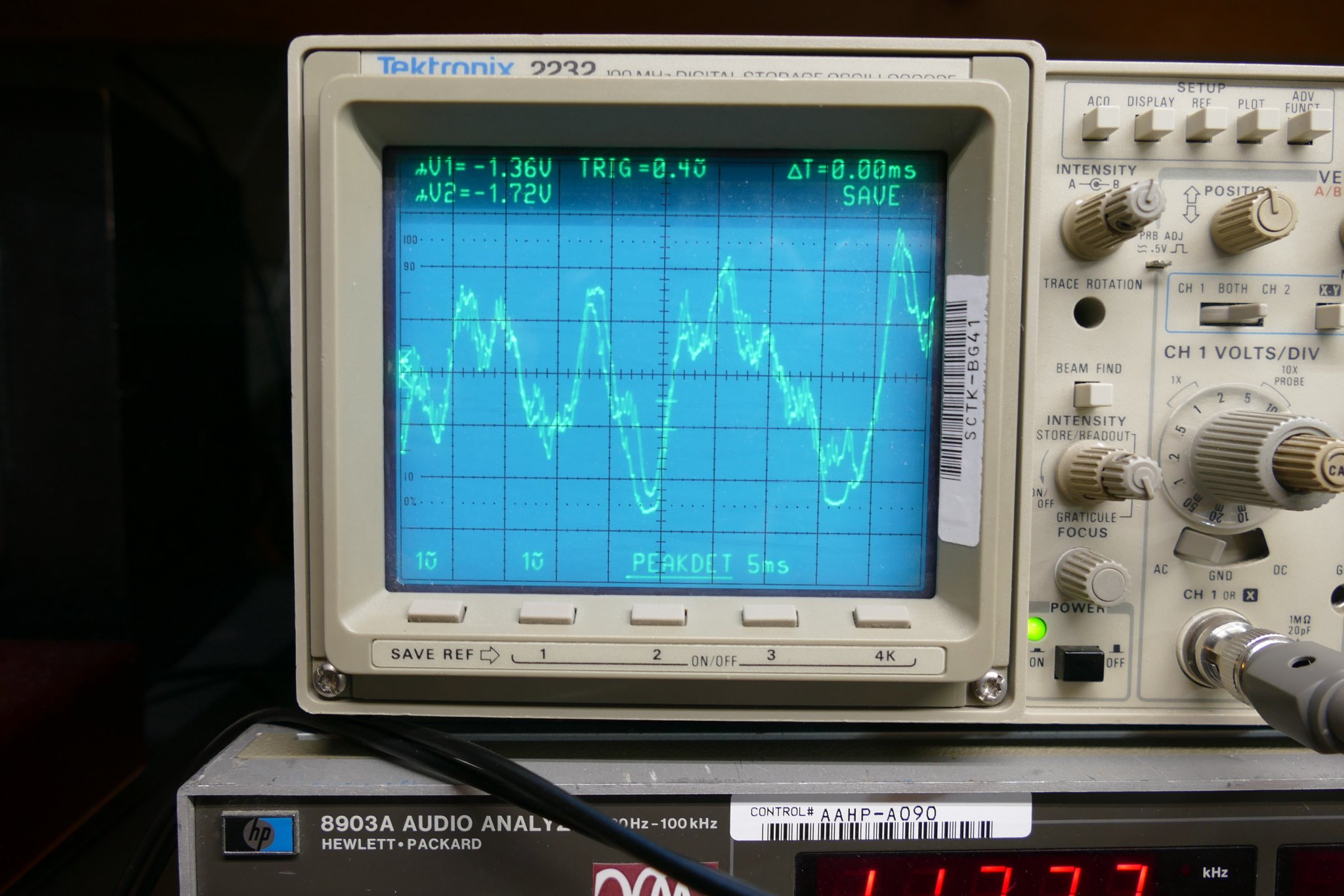

So, watching red and green numbers blink and scope traces jump is no fun, so it's time to hook up the CD player and speakers and crank it up. I played lots of different music through this thing at volume levels from mild to well into visible clipping. As with many SE vacuum tube amps you can often see some clipping on the scope before it becomes audible. Some of this is due to the magnetic storage effects in the output transformer, and some is due to the soft saturation characteristics of a vacuum tube. The same characteristic can be seen on the scope in this amp. When the top part of the trace clips, it clips hard. As the drain of the fet hits 2X the B+ voltage there is no more stored energy in the OPT and abrupt clipping occurs. As the drain of the fet is pulled toward its source the drain to source feedback resistor reduces the drive softening the landing. This can be seen in some of the scope shots here.
The first trace shows a peak to peak excursion of 50.4 volts into my "8 ohm" speakers. This is 39.8 watts, how is this possible when measured clipping occurs at just over 30 watts? Remember that this is music with multiple frequencies occurring at the same time. The large upward ramp in voltage between the two markers is at a frequency where the speakers are probably about 20 ohms.
Note the rounded bottom of the clipped notes in the second picture. These are not noticeable on casual listening. If you know that they are there, you will hear it.
Here is nearly 60 volts peak to peak across my speakers. yes, it was LOUD, and clean.
With music playing the average power being produced was probably 1 watt or less. The output fets seemed to stabilize at around 90C. I shut the fan off to see what would happen and the heat sink got too hot to touch in less than a minute, so I turned it back on.

Great! Which amp are you using with it, SissySIT?It sounds great and I would say forward sounding compared to the HPA and Elekit. Base is just too good never heard it so tight and clean on my klipsch horns 👏

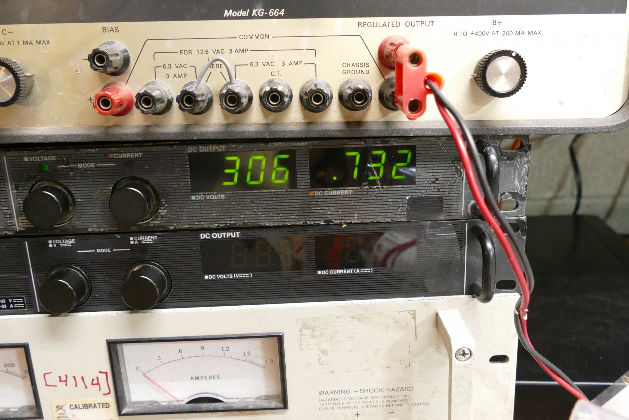

70C on the case is okay, I believe. @Zen Mod @Vunce and others may have some thoughts on it too.The power supply for the power amp reads 306 volts at 732 mA. I am pumping 224 watts into this board and extracting 50 watts from it. At this level the output fets show about 70 degrees C on my $24 Amazon quality IR thermometer. Shutting off the drive however, makes the board eat all 224 watts pushing the mosfet temp over 90 C. With the fan running on low the heat sink is slightly warm and there is a noticeable thermal gradient from one side to the other with the coolest side touching the fan.
That looks pretty much like a single-ended class A amp with a 2nd harmonic dominant profile. How does it sound?Measured performance is outstanding:

Interesting stuff. Is symmetrical clipping a worthy goal or is it not so important? I guess it would depend on the speakers too and how loud you like to play and whether the amp will be pushed to clipping.The first trace shows a peak to peak excursion of 50.4 volts into my "8 ohm" speakers. This is 39.8 watts, how is this possible when measured clipping occurs at just over 30 watts? Remember that this is music with multiple frequencies occurring at the same time. The large upward ramp in voltage between the two markers is at a frequency where the speakers are probably about 20 ohms.

I see the case temp hit 90C at idle and I'm dissipating over 90 watts at idle when I run the power supply at 300 volts. That gets me about 30 watts of audio at the onset of clipping. These mosfets are rated for 300 watts on a perfect heat sink made of unobtanium with an insulator make from polished unicorn skin. The data sheet quotes 180 watts of SOA at a case temp of 75C. The curves show that I can do 600 mA with 300 volts across the device at 75C, but I'm not sure exactly how to derate it to 90C. I thought about this, and how to optimize it for symmetrical clipping, but then the reality of it all slapped me in the face. Supposed I do get things to run at 90C or beyond. How am I going to deal with 225 watts of dissipation at idle. I would need a pair of those water cooling rigs from a gaming computer. I'll back things down to about 20 watts output tomorrow and reevaluate how it works.

Yes SissySIT R3 is my main amp now a days.Great! Which amp are you using with it, SissySIT?
