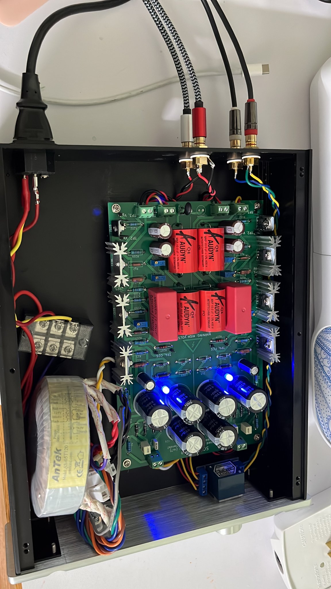

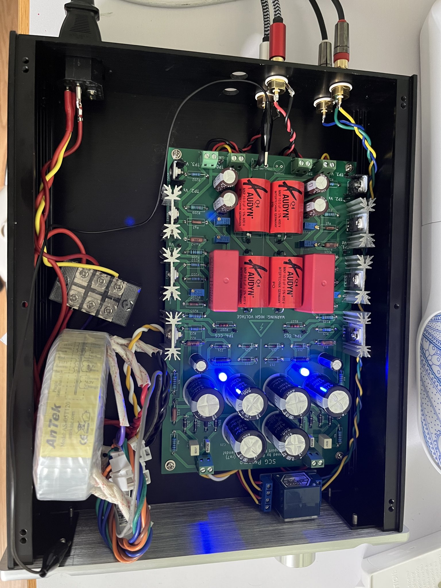

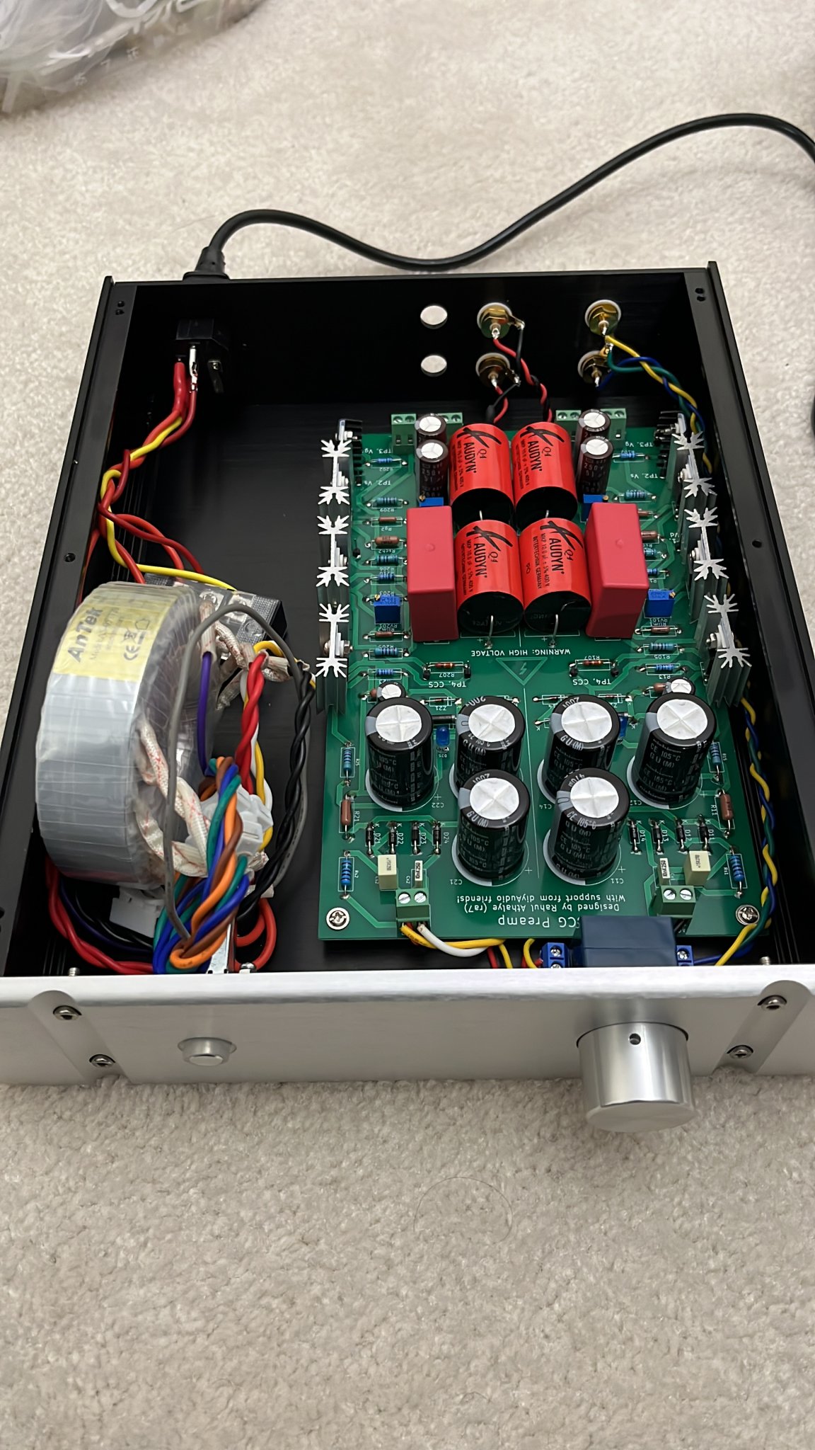

Listening to the preamp now 👌
Wiring isn’t very good as I get some hiss sound could be because of the volume pot wiring crossing the AC wiring and the trafo being so close.
Looking great! Such a clean build.
In my build with a pot, I found that connecting the preamp ground to chassis cured the residual noise. Is the chassis grounded to earth? Don’t see it in the pics but it might be. Be sure to do that.
Vunce, I don’t get any noise coz I do have a Papa amp with 12db gain, though I haven’t tried it in a while. I have also run two SCGs in series and again, no noise.
Thanks Vunce, I am testing this right now with my MacBook as input via headphone out and listening using on my headphones. So no power amp yet 🙂Congrats Manniraj!
If your power amp has >20dB gain in addition to SCG's gain you will get a bit of hiss heard from the speakers.
But now eager to connect to my SissySIT R3 which is my main power amp and listen to my Forte's.
Good eye Ra!
Manniraj, connect the chassis GND on pcb (next to NTC) to the common point earth GND attaches to chassis.
I do get some audible hiss with my ear close to the speaker when "regular" amplifiers are in the chain. When 'Follower' amps are in the chain no hiss heard.
Also, speakers are 92dB efficient.
Thanks @ra7, this is my spare chassis a bit small to hold both the Antek trafo and the pcb. I passed all the signal wiring underneath the board from the pot to the input of the preamp. Yes I have not yet connected the preamp ground via the thermistor on board to the chassis yet. Will do that over the weekend and as you said hopefully it should eliminate the hiss which I am hearing and increasing with the volume pot.
@Vunce As you said this is definitely a very very special preamp just so clean and deep soundstage even on my crap headphones. I cannot wait so tomorrow first thing it goes into my main system and head to head with HPA and my new Elekit tube preamp 🙂
Awesome Manniraj!
Weekend is near for playtime, looking forward to hearing about your SCG/Sissy/Forte marriage 🙂
