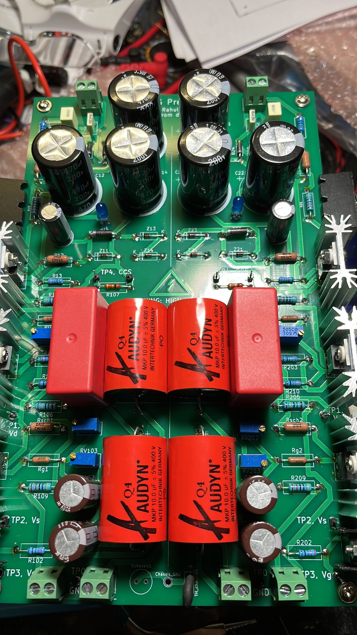

I am close to having four working channels - always something missing which slows the project down.
I am using 5k/10K in the Schade network.
I would assume this would consume less current than the standard 1k/10K version and the setting as specified in your instructions is what I should use?
My second power transformer is due today so I hope to have it working by this weekend.

Those resistors also control the gain. 10k/1k gives 10X the gain (1V in, 10V out), 10k/5k will give 2X the gain. But it will work. George is using it with more gain by reducing the 1k resistor. He wanted to drive his power amp to full output with just CD output in to the preamp.
Even my build is now stuck because of my blunder in getting the TO92 version of DN2535 transistor. So now ordered it from Mouser as its the site where stock is available. I used the gain resistors per the BOM as going to use with Soekris DAC to my SissySIT R3 power amp.
I am using 5k/10K in the Schade network. I would assume this would consume less current than the standard 1k/10K version and the setting as specified in your instructions is what I should use?
The ratio of the two resistors do control the overall voltage gain. The series combination of the two resistors determines the current "wasted" in the feedback network.Those resistors also control the gain. 10k/1k gives 10X the gain (1V in, 10V out), 10k/5k will give 2X the gain. But it will work. George is using it with more gain by reducing the 1k resistor. He wanted to drive his power amp to full output with just CD output in to the preamp.
The very first Schade common grid amp used a large vacuum tube for the gain device with a plate voltage of up to 650 volts, so I used a 33K/300K set of resistors to reduce power dissipation. Here the grid capacitances are very low and have a very weak and lossy (low "Q") dependence on applied device voltages, so high valued resistors are acceptable.
Some of the mosfets used in the SCG builds have considerable gate capacitances which vary quite a bit with the applied audio signal. This can lead to variable phase shifts in the applied feedback with respect to the signal frequency which may cause a perceptible distortion effect that is hard to measure. The 10K/1K pair is probably a good choice as we can afford to waste a few milliamps if needed. 10K/5K is OK if a voltage gain of about two is enough. I needed a gain of 20 to drive a single stage vacuum tube to 20 watts, and something similar for the fat mosfet output stage.

The 10k/1k pairing plus the pot produces about 3 mA in the network. Just about enough IMO based purely on listening. The 100k/10k sounded not as good.

Done with all the remaining transistors and ready to power up the preamp. Going through the build guide of Rahul.
- Schade Common Gate (SCG) Preamp
