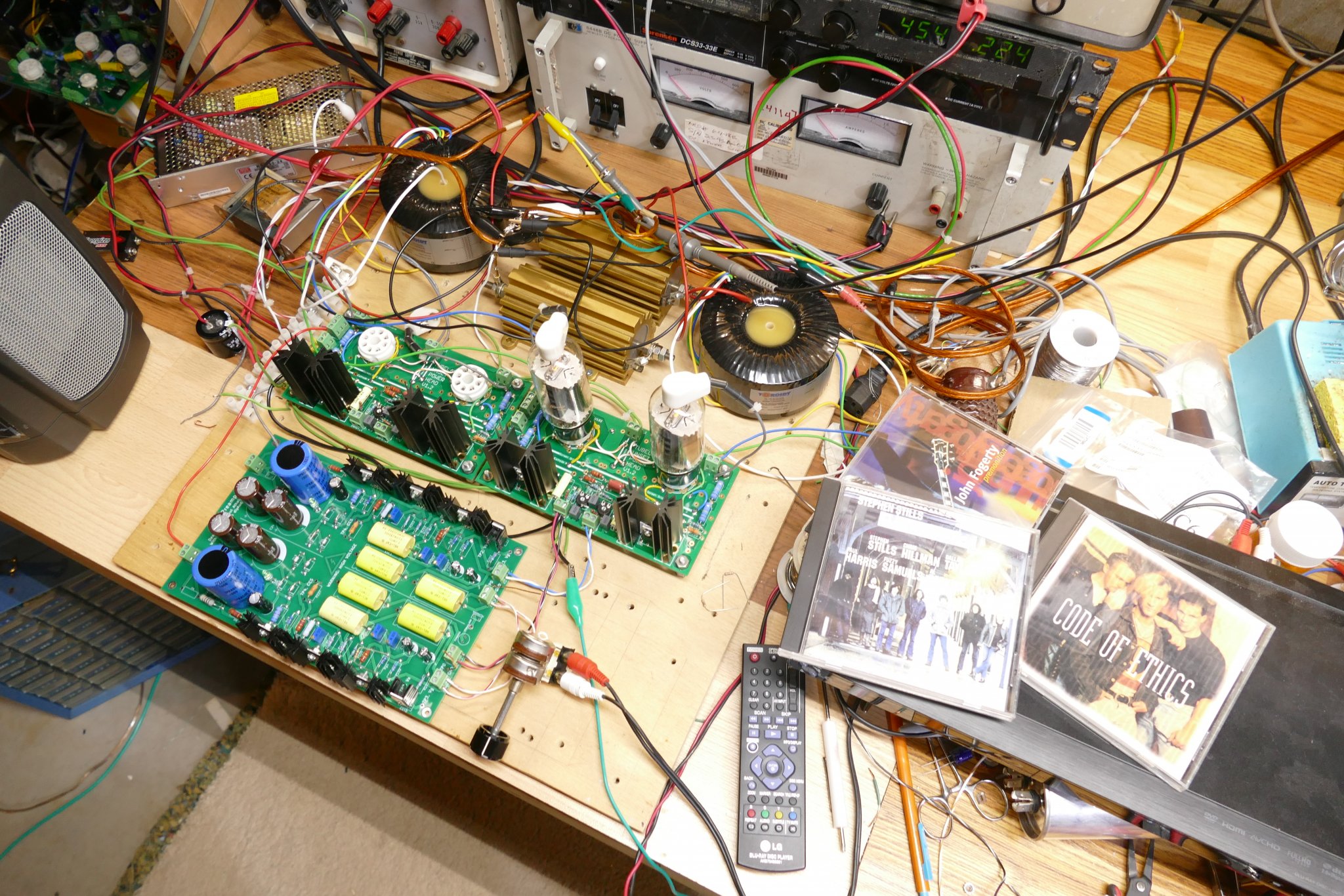

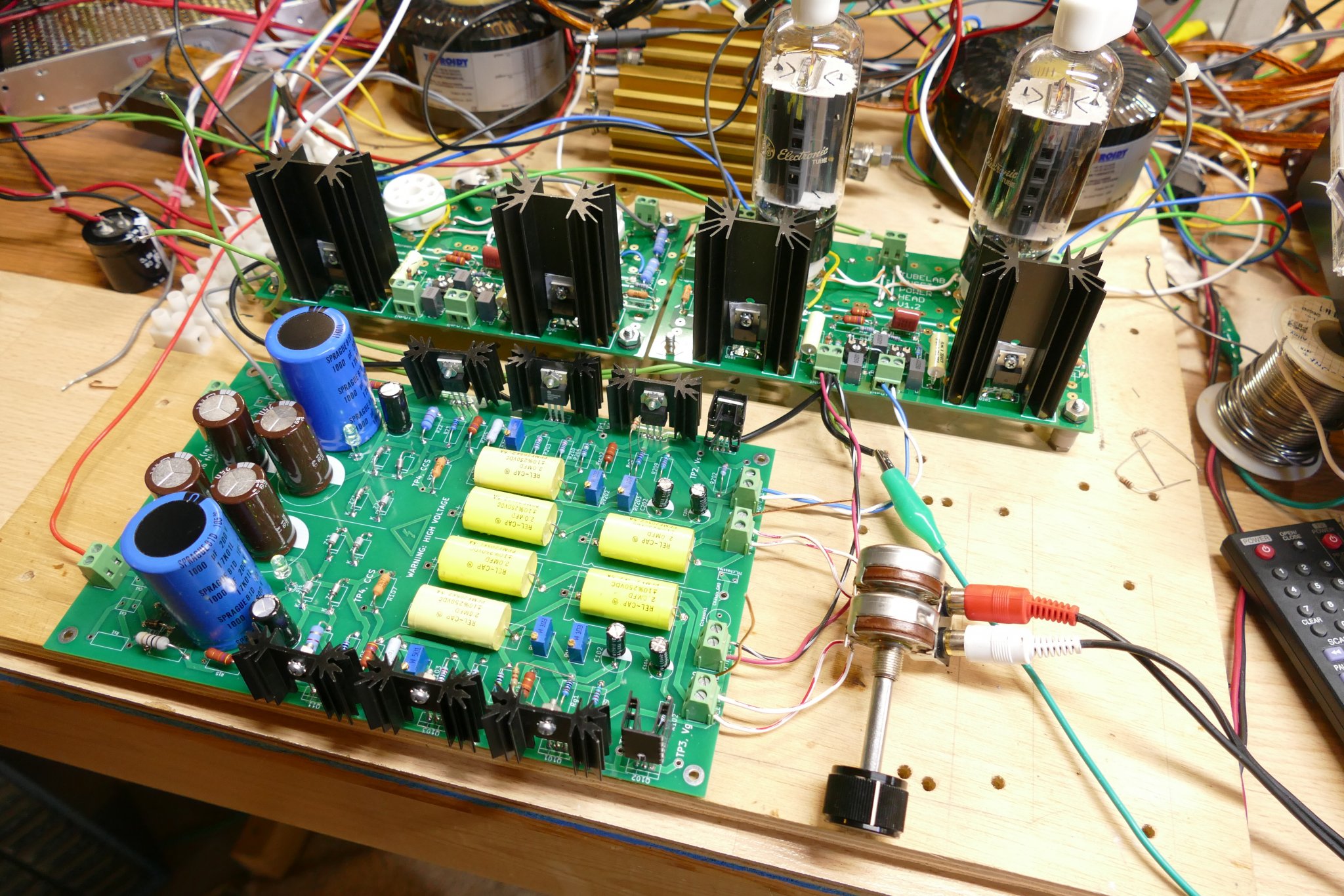

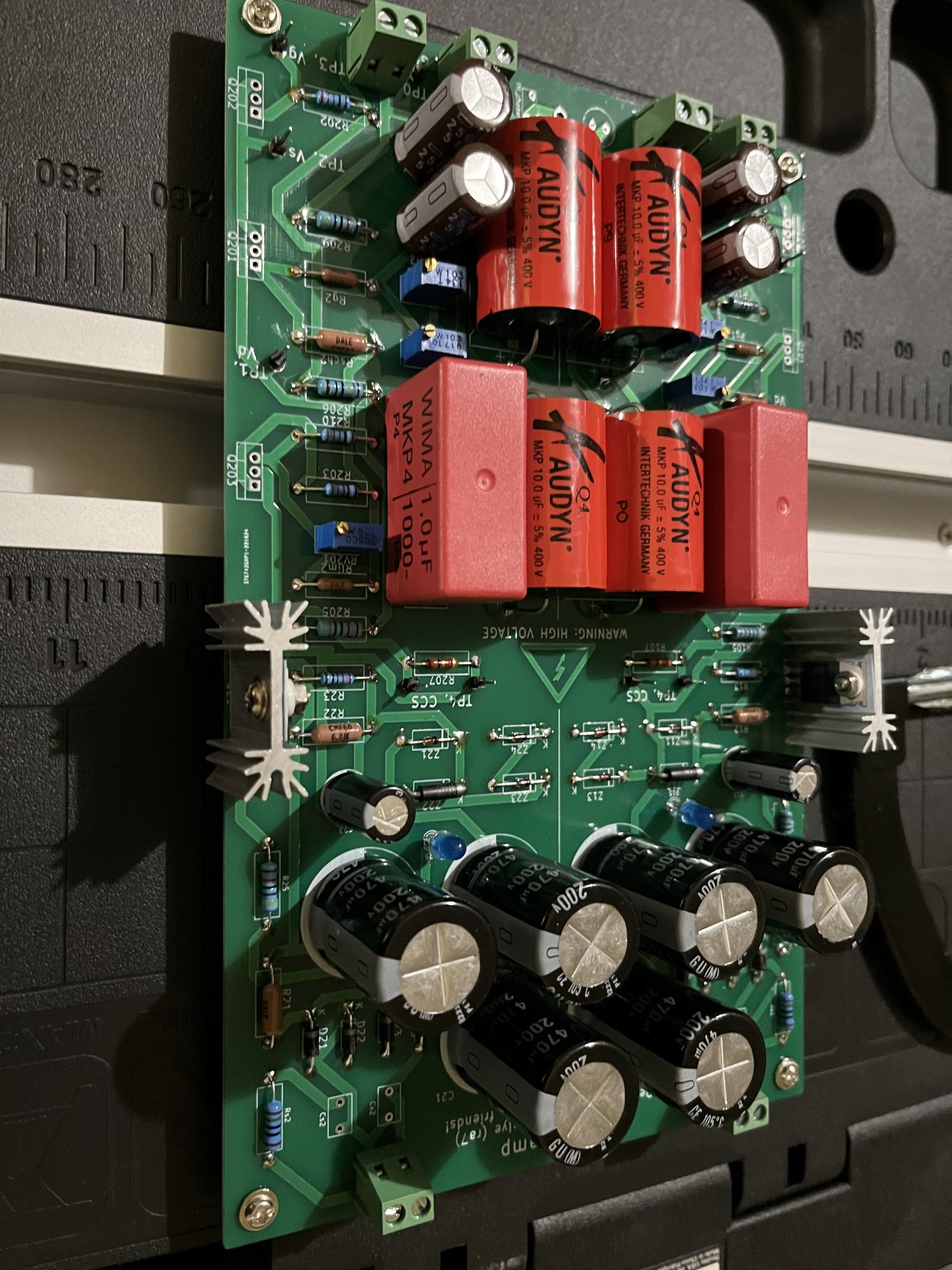

I put this together with parts that I had in my stash. The only part I purchased for this board was the gain mosfet which I got back when it was mentioned that they were getting hard to find. I didn't go by the parts list, I just looked at the schematic and picked the best fit from what I had. Nothing except for most of the small resistors is the correct part. I fired up the power supply from a bench supply and tested it before installing any other parts to avoid fried stuff if the supply is way off. One channel has 118 volts and the other has 121, and it remains constant with a raw supply voltage from 130 to 180 volts.
This is as nice as it will ever look, because once I start messing with it ugliness happens.
Looking great, George! Good to know that the regs are working.I put this together with parts that I had in my stash. The only part I purchased for this board was the gain mosfet which I got back when it was mentioned that they were getting hard to find. I didn't go by the parts list, I just looked at the schematic and picked the best fit from what I had. Nothing except for most of the small resistors is the correct part. I fired up the power supply from a bench supply and tested it before installing any other parts to avoid fried stuff if the supply is way off. One channel has 118 volts and the other has 121, and it remains constant with a raw supply voltage from 130 to 180 volts.
Please let me know if you have any suggestions on the PCB, layout, etc. I've already learned so much from you!

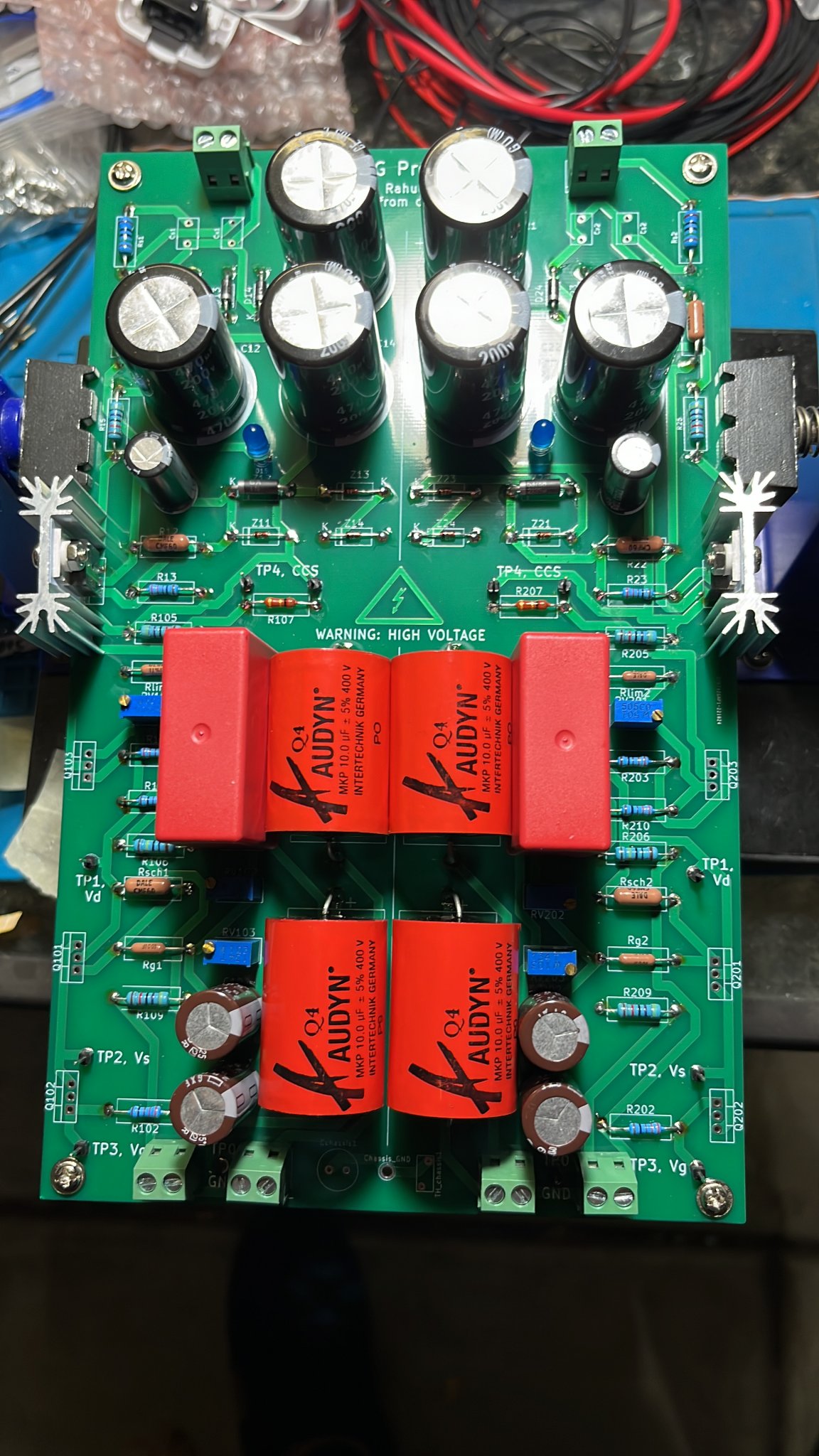

Looking good!Almost done waiting for the remaining mosfets arrival.
I powered the board up this morning to find my first dead part. I did all the current and voltage adjustments on the left channel, and all went well. The current adjustment on the right channel went well but the voltage at TP1 wouldn't stay set, it just wandered. A little poking around with a voltmeter revealed that Z22 couldn't remember what its breakdown voltage was. Eventually it decided to become completely open. I have a good collection of zener diodes that came from a lot of surplus parts from 1974, so finding one bad diode out of 8 isn't a big surprise. Another from the same bag worked fine. I have two 53 volt, and one 18 volt in each string, and one of the 53's died.

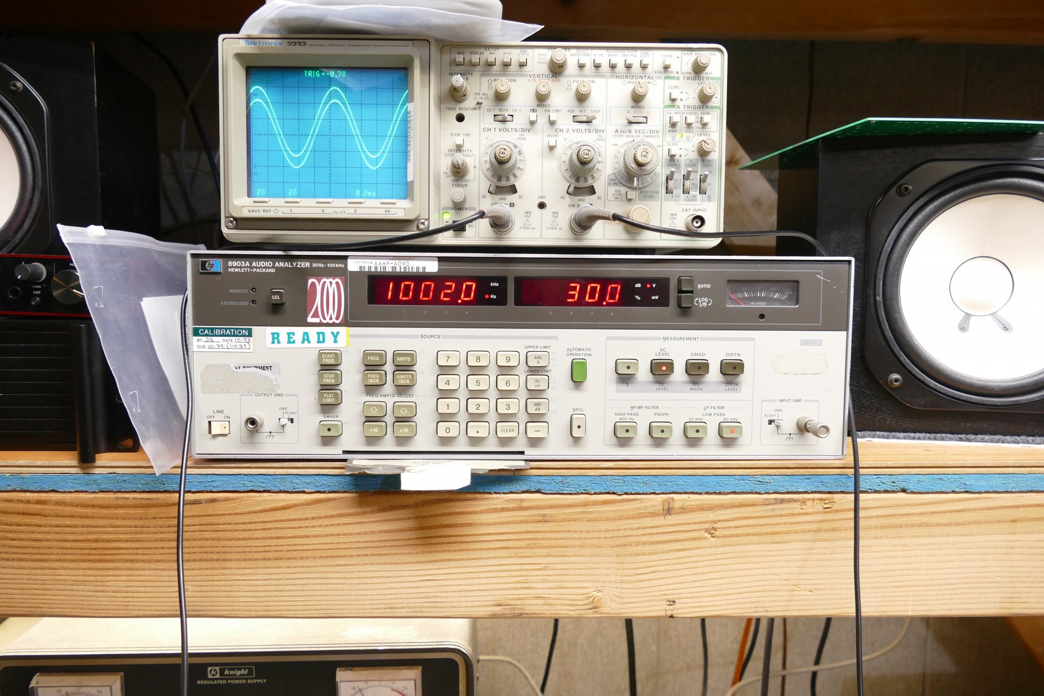

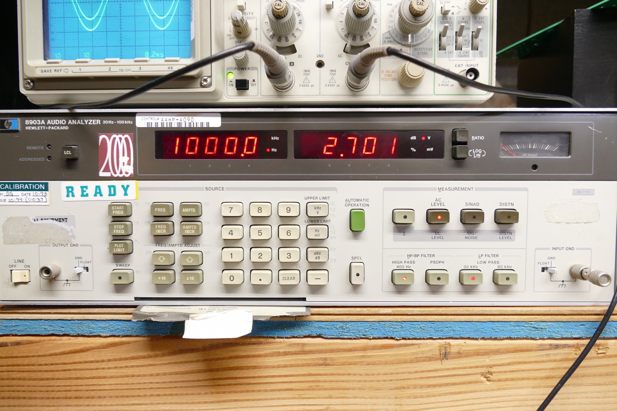

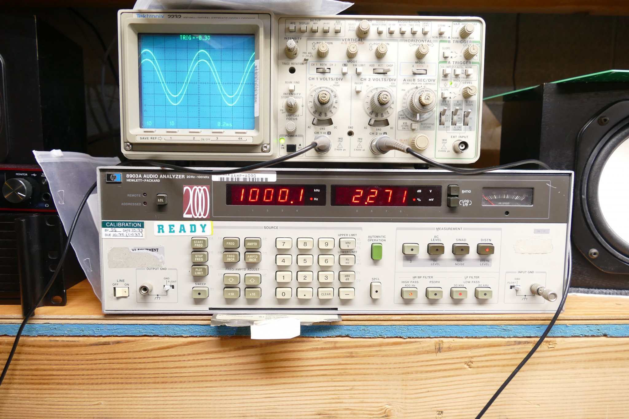

I applied a signal and cranked up the drive to find clipping. It's just over 30 V RMS. THD is .23% at 30 V RMS. Both channels are identical. The frequency response at 30 V RMS can not be measured with my equipment, since the -3dB points are below 20 Hz and above 100 KHz which is the range of the old HP8903A. The response is down 0.25 dB at 20 Hz and at 33.1KHz. THD at 30 volts and 20 Hz remains .23% but rises to almost 2% when trying to drive 30 V at 20 KHz into the scope and audio analyzer plus a mess of random wiring.
I plan to use this board to drive something BIGGER, but full power at 20 KHz is not a concern for several reasons. I did not use the correct part for the P channel fet so this may be part of the problem. It could also be a crappy cap. Those yellow REL-Caps are at least 30 years old too.

Thank you so much for testing. Looks about right. I could never drive it to clipping given the soundcard’s max output but at some point, I recall doing 25 Vrms without clipping, which is plenty for the SS amps we deal with here.I applied a signal and cranked up the drive to find clipping. It's just over 30 V RMS. THD is .23% at 30 V RMS. Both channels are identical. The frequency response at 30 V RMS can not be measured with my equipment, since the -3dB points are below 20 Hz and above 100 KHz which is the range of the old HP8903A. The response is down 0.25 dB at 20 Hz and at 33.1KHz. THD at 30 volts and 20 Hz remains .23% but rises to almost 2% when trying to drive 30 V at 20 KHz into the scope and audio analyzer plus a mess of random wiring.

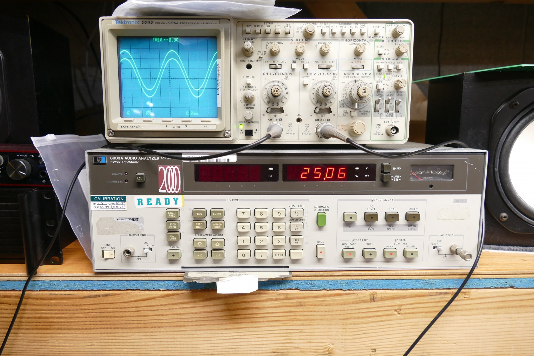

Anyone who knows me can guess what my next experiment would be. There was a picture in post #732 that showed a pair of UNSET vacuum tube output boards that had been squeezed for over 500 watts in push pull. These boards can be configured for SE where they will make up to 30 watts per tube, given a suitable driver board. Well, we now have a new driver board, so the two must meet.
The result is a SE stereo hybrid amp that makes 25 WPC. THD is 2.3% at 25 watts and 0.35% at 1 watt. It however needs 2.7 volts RMS of drive to get to 25 watts. Now the "messy stuff" begins.
I got to stick some speakers on this thing.......
There is still the box full of big fets to play with. I think I'll go back to my breadboard for those experiments and save the second SCG board for a possible two stage driver setup, or maybe even a headphone amp.

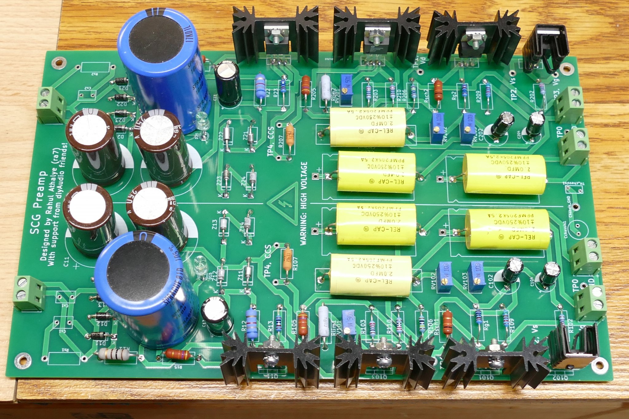

Good question! I need to look at KiCAD because the footprint was from KiCAD--think I picked one that was too small. Will get back to you tomorrow. On the PCB, I saw it was too small and so I just connected a 10R, 0.25W resistor, which should work just as well as a thermistor.

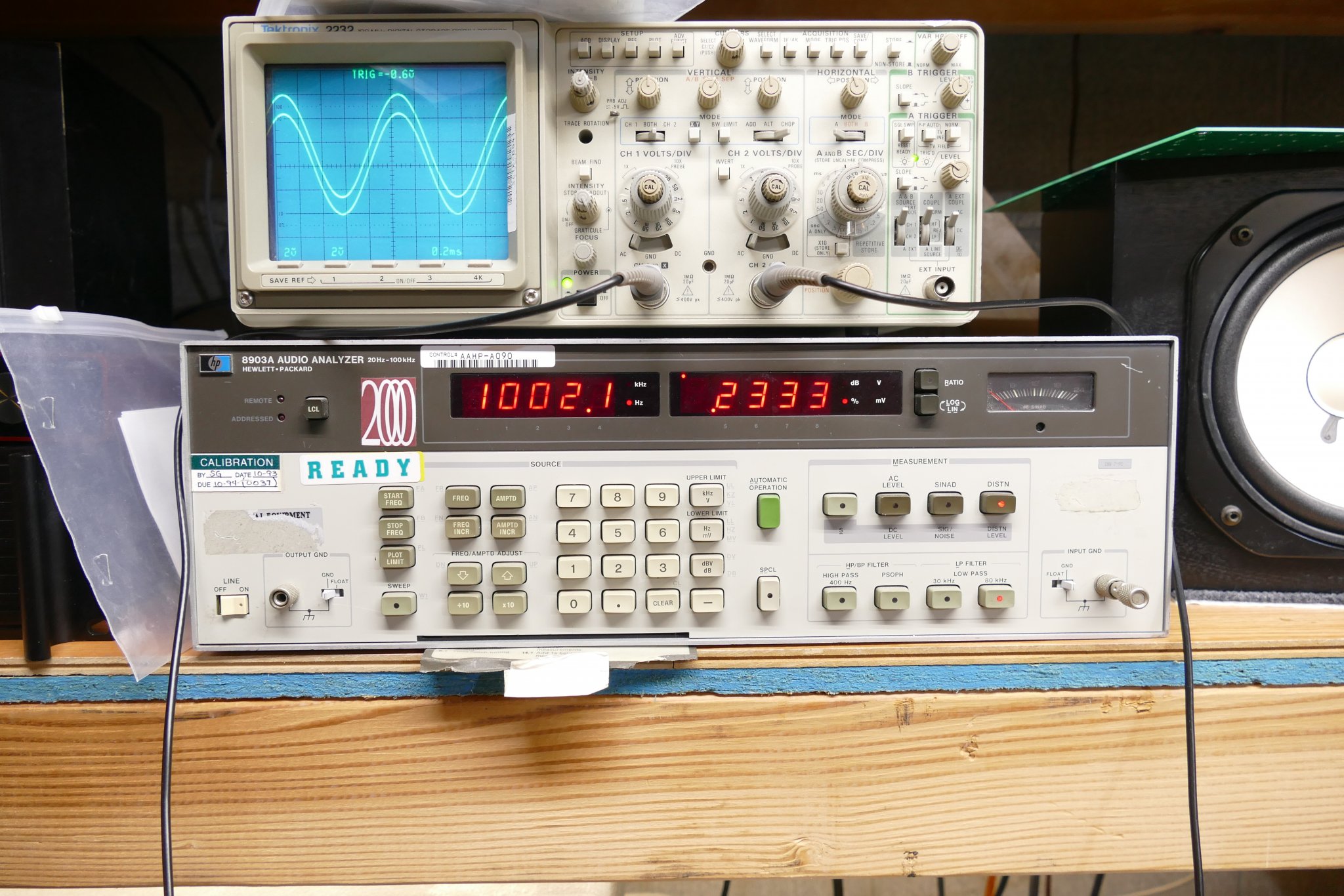

Last night I simply soldered a second 1K ohm resistor across both Rg's making Rg 500 ohms. The THD from the SCG board went from 0.22% to 0.4% and the gain went from around 10 to 19.8. It now takes 1.34 V rms to get 25 watts out of the board where the total THD is still just over 1%. I have not connected it up to the speakers yet. I may do some more experiments first. I have been using the same bench power supply that feeds the screen grids of the output tubes to run the SCG board. I have it set at 150 volts. This gives me some room to increase the B+ on the SCG board, but too much can put the 100 volt gain FET at risk. I may try to squeeze a little more gain out of it too.
The FETSET with an OPT will happen. I will probably use my old breadboard for that purpose since I would only need the bottom two FETS and a few parts. It also has screw terminals for solderless FET swapping, since blown parts are inevitable.
I tinkered with the SCG / UNSET board pair until one channel started giving me the silent treatment. I had blown one of the input P-fets. I am using Fairchild FQP3P20's because I have a bunch of them, and they work fine in some small vacuum tube UNSET boards that I built. I replaced the dead part and all was well.
I now have a 750 ohm resistor in parallel with the 1K resistor for Rg. This gives me a gain of just over 20 and allows me to drive the vacuum tube UNSET board to 20 watts from a 1V rms signal. I need about 1.2 volts to hit 25 watts. Testing with a CD player reveals that I can hit clipping on about half of the CD's that I tested.

I made some measurements that look outstanding for a SE tube amp. The anomalies previously seen at high frequencies were not present and the 3dB point for the entire amp was 17 Hz to 61 KHz measured at 20 watts! I simply turned the frequency knob on the audio generator until the power dropped to 10 watts. The THD remained below 1.5% until I dropped below 35 Hz where saturation in the OPT became visible on the scope. Here is THD VS power output for the entire amp.
0.1 W 0.348%
0.5 W 0.427%
1.0 W 0.537%
2.0 W 0.585%
5.0 W 0.651%
10 W 0.757%
20 W 1.18%
25 W 2.07%

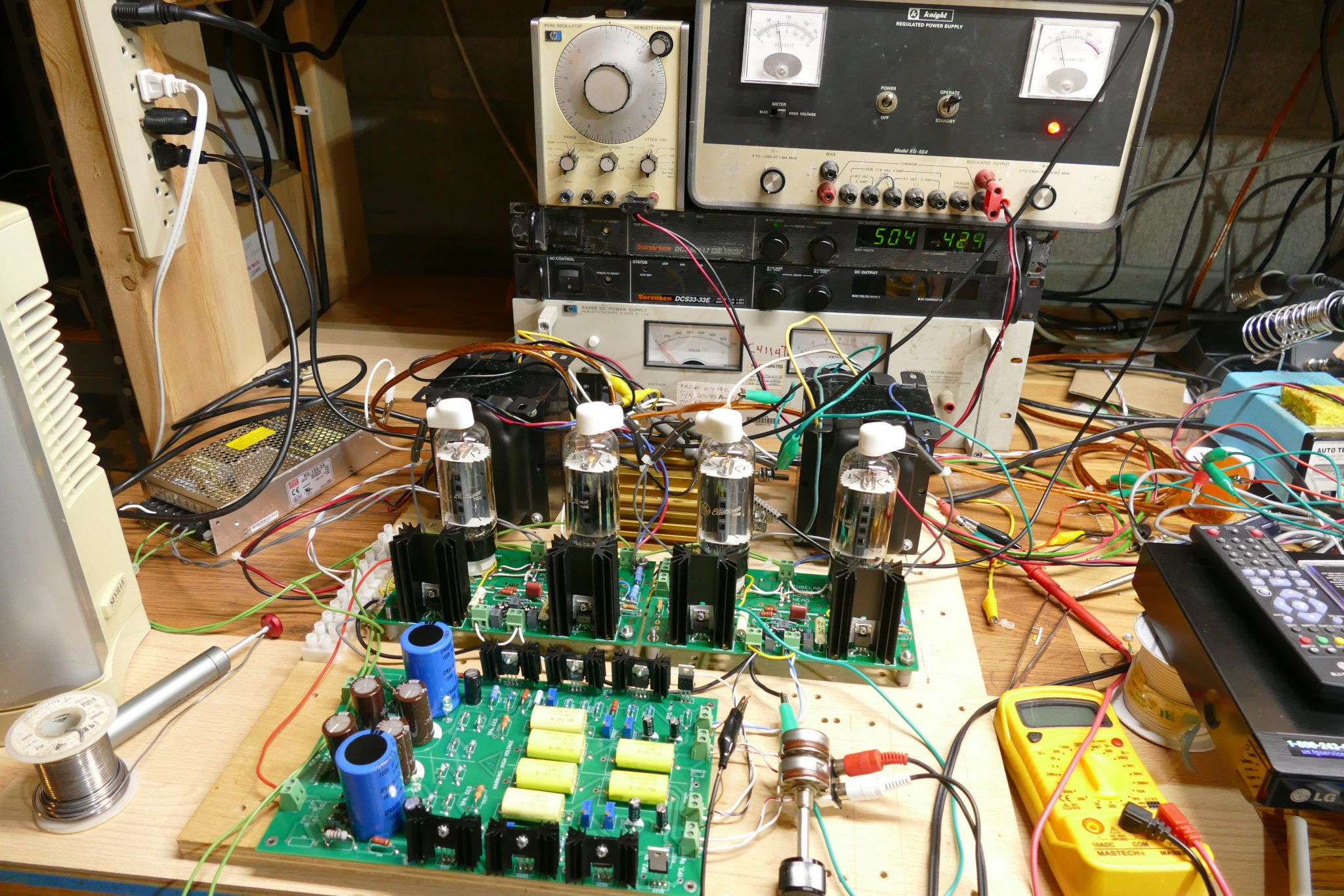

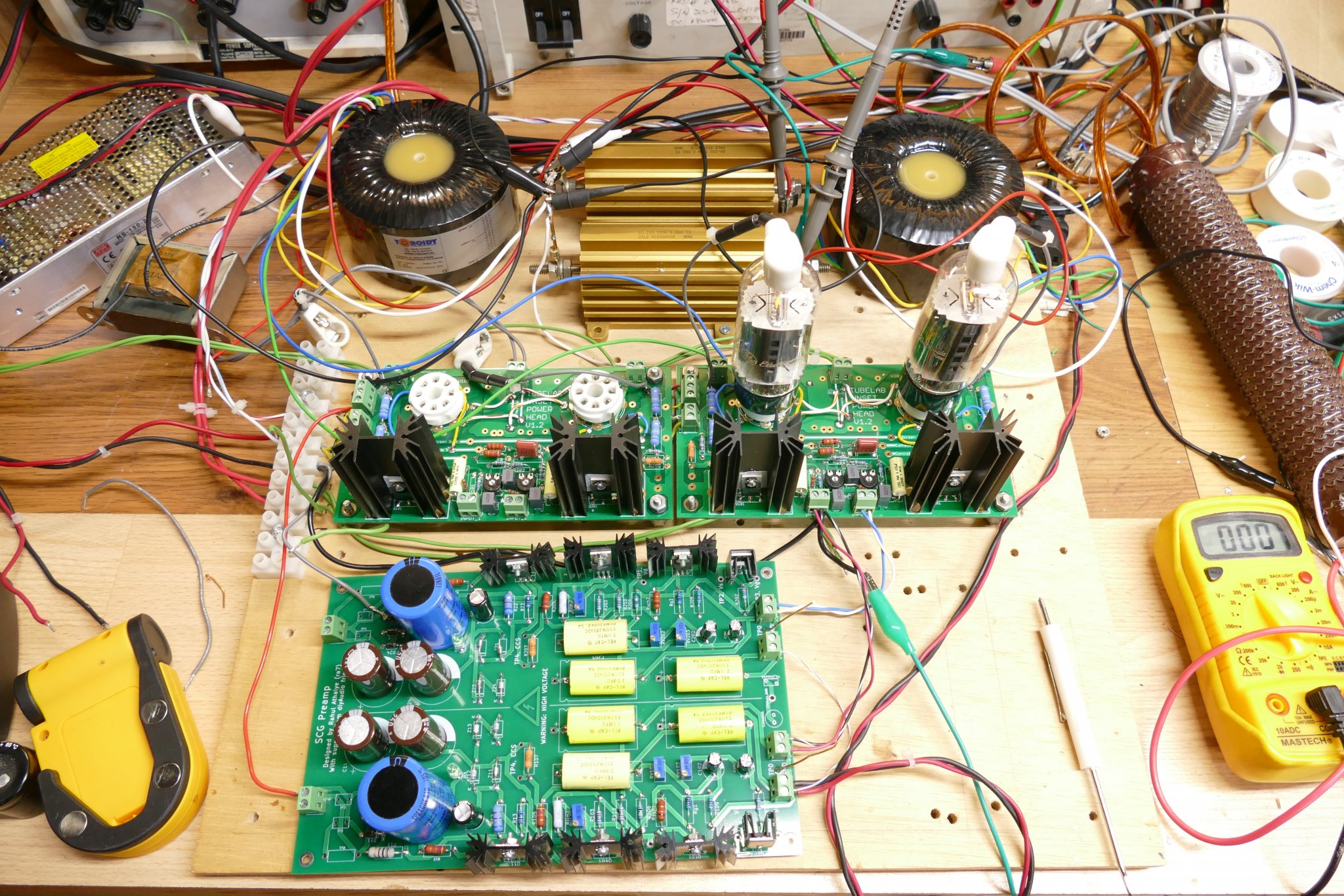

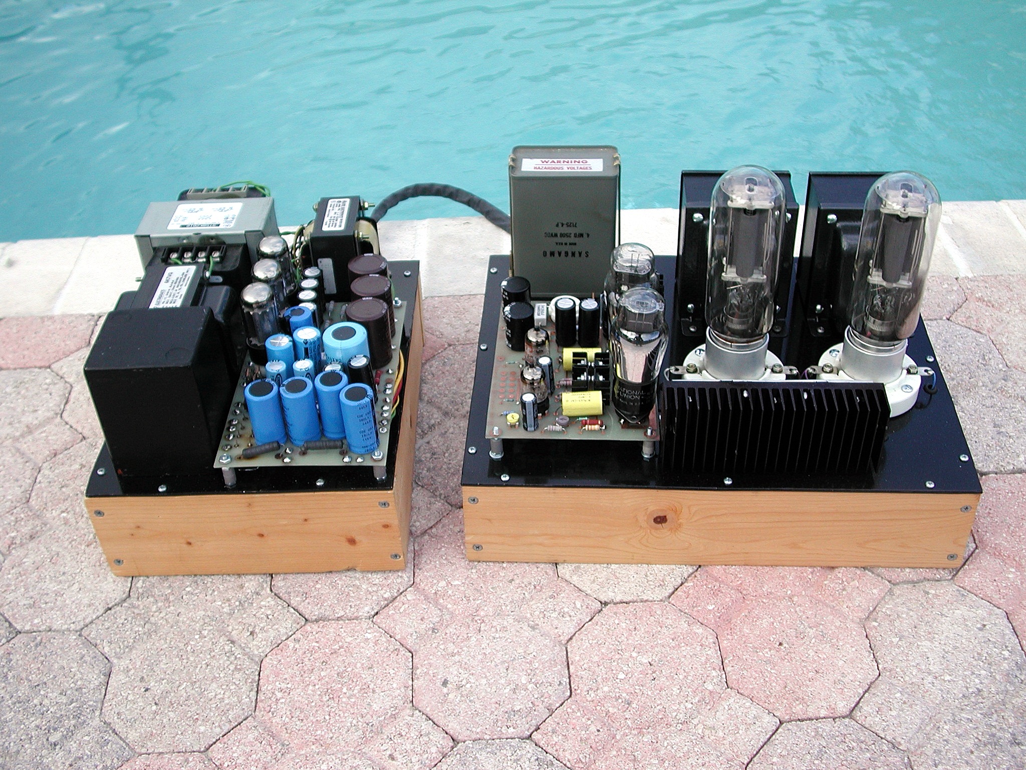

Yesterday I got the bright idea that if one big fat output tube per channel is good, two should be better, right?

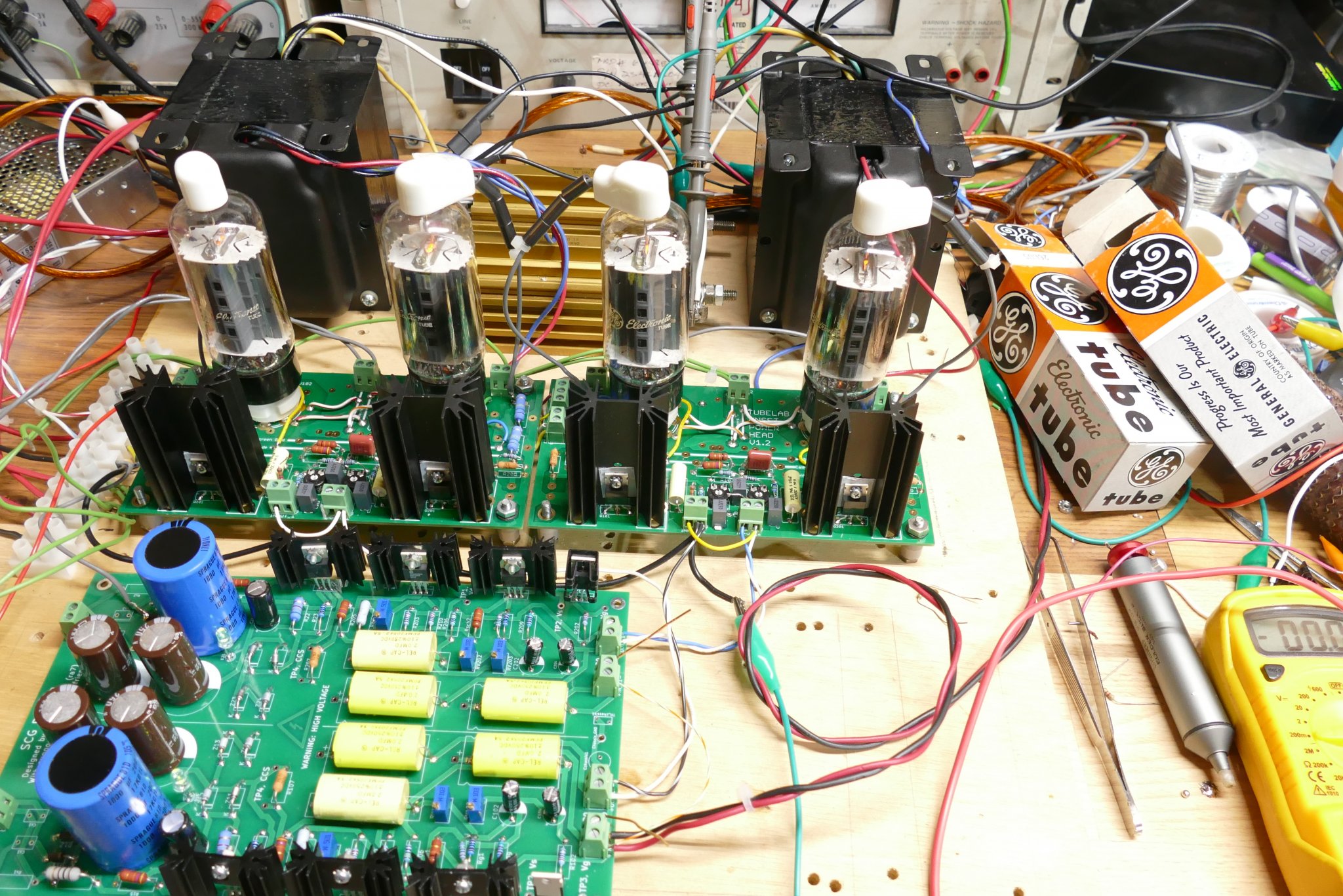

I have seen, tested and heard the SCG board driving an UNSET board with one large TV sweep tube per channel. It makes 20 to 25 watts per channel, sounds great and posted some good test data for a vacuum tube based amp. The test data shown was done with the tubes being run rather hard. This is OK in a Class AB push pull amp where the average power is rather low and the idle dissipation is well below the output device's spec limit. This however is a Class A Single Ended design where worst case dissipation is seen at idle and low power output, where it will spend most of its lifetime. Conventional wisdom on tube amps is to run the tubes at 70 to 80% of spec in a class A design. These tubes are rather conservatively rated at 33 to 40 watts and there is no visible glow from the guts at over 50 watts in a well constructed tube. Not all tubes are "well constructed" and testing must be performed to find good ones if they will be pushed hard.
My breadboard however looked rather sad and disconnected with two empty sockets and several dangling wires, so I decided to fix that.
This picture shows two tubes in each board with the two tube / mosfet pairs wired in parallel. Each board is driven from one channel on the SCG board. Despite the "Nominal Power - 60W" sticker on the Toroidy OPT's, they will not do 30 watts across the audio range and saturation was seen at 20 watts below about 35 Hz. I decided to use a pair of Hammond 1628SEA's that I have owned since 2006. They are large, inefficient, and have never been used in an amplifier as long as I have owned them since I have always found something else that worked better in listening and measurement testing. The huge core requires more energy to flip all those magnetic domains back and forth, so they give up at least 10% of the applied audio power compared to the large Edcors, and probably close to 20% compared to the efficient Toroidy's that these are replacing. The Hammonds are 5K ohm and I need a lower impedance, so I am deliberately mis-wiring them to get 2500 ohms, which will waste more audio power.
The Hammonds have more stray capacitance and leakage inductance than most OPT's primarily because they are BIG. More wire, and more metal makes more inductance and capacitance. They have been consistently marginal in HF frequency response with an upper 3dB point in the 18 to 25 KHz range in a typical SE tube amp design like my SSE. The vacuum tube based UNSET changed that with frequency response from about 20 Hz to mid 30 KHz due to the low driving impedance it presents to the transformer. This reduces the "Q" of the resonant notch formed by the stray capacitance and leakage inductance. Listening tests with an UNSET board driving these transformers were very positive.
Running Two UNSET circuits in parallel further reduces the driving impedance to the OPT and allows for a more conservative operating point. I fired the breadboard amp up and set each tube for 35 watts of dissipation. The amp began to clip around 30 watts and hit 5.5% THD at 35 watts. I believe that this would be a 40 watt amp with a more efficient OPT. The 3 dB frequency response at 20 watts of audio output was 16 Hz to 45 KHz, a number previously unseen with these transformers. THD vs Power at 1 KHz is below. Both channels were nearly identical. It took 1.05 Vrms to drive the amp to 20 watts of output.

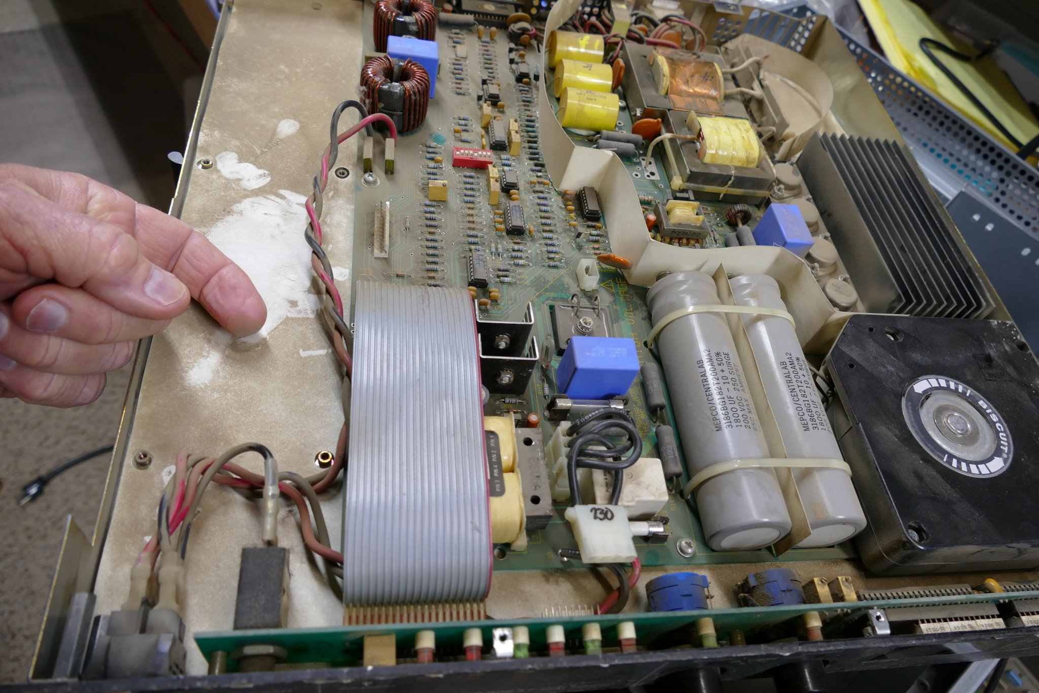

I suspected the Sorensen switcher since it was also a rescue from scrap and the second picture shows what it looked like when I got it. I decided to disconnect it and swap it with the big HP6448B. Unfortunately, I accidentally swapped two banana plugs and fed 450 volts at up to 1.7 amps into the SCG board and the vacuum tube screen grids. When I hit the power switch the fire gods danced and the smoke monster descended on all 3 boards. I had a small fan running to keep things cool so I could not see what smoked, I watched the current meter as I hit the on switch and immediately killed power when I saw it pass 1 Amp. I don't see any obvious blown stuff, but I haven't looked very carefully. I'm still looking for the reason the breaker pops.
This morning the breaker was still popping whenever I turned on the switching power supply and any other piece of test equipment, but it also popped when I turned on the scope and audio analyzer with the power supply off. I decided to move the stack of equipment but found nothing and the problem vanished. Things that "fix themselves" often unfix themselves at the most inopportune moment. I'm going to take that supply apart for a better look. While the bench is a mess, I need to look inside my Fluke 407D. It was yet another metal scrap salvage that I got on Ebay for $25 plus $45 shipping over 20 years ago. It worked when I got it and other than some loose pots, has worked fine until a couple months ago. It was built around 1970 and still contains all of its original parts. It probably needs a total rebuild.

I ripped my workbench apart in an attempt to find the cause of the GCFI trips but failed to find the cause. I cleaned up the ratsnest of wiring behind the equipment and took the Fluke 407D apart to see if there was an obvious clue to its fault but found nothing obvious. I think I'll replace all of the tubes and try it again as they are all 50 years old, and I have seriously abused this thing.
I put back the power supplies and began to troubleshoot the dead amp expecting the worst. I powered up the SCG board by itself and found it to be drawing almost 200 mA instead of 60. One channel however, worked just fine and the other was dead. Voltage readings revealed a fried input fet, so I replaced it. This brought the other channel back, but the current was still high, but not as bad as before. I soon realized that one of the big blue electrolytics was getting warm and there were signs that it had vented. Oddly the characteristic stink of a vented electrolytic did not occur, or I would have looked for that first. The 100 ohm resistor that feeds that cap was a bit darker than its brother in the other channel.
I hooked everything else back up and the amp works. After about 15 minutes of testing the blue cap was quite warm but the current kept creeping downward so I connected up the CD player and the speakers. I have never heard sound like that come from these big transformers, and even with 87 dB speakers it goes quite loud. Percussion is very dynamic, and everything sounds quite real. Everything has its drawbacks, and to some this amp's worst characteristic is the 300 watts or heat it puts into the room at idle. Almost 30 years ago I built a 30 WPC SE tube amp using 211 or 845 transmitting triodes on 1050 volts. It sounded quite nice but didn't have anything close to the dynamics that this amp has. It also put over 500 watts into the room. That didn't work in my 100 square foot room in Florida, so the amp never got much play time, and it still sits on a shelf in the corner unused. It's currently 33 degrees outside, a few extra watts of heat in the basement is a good thing.
