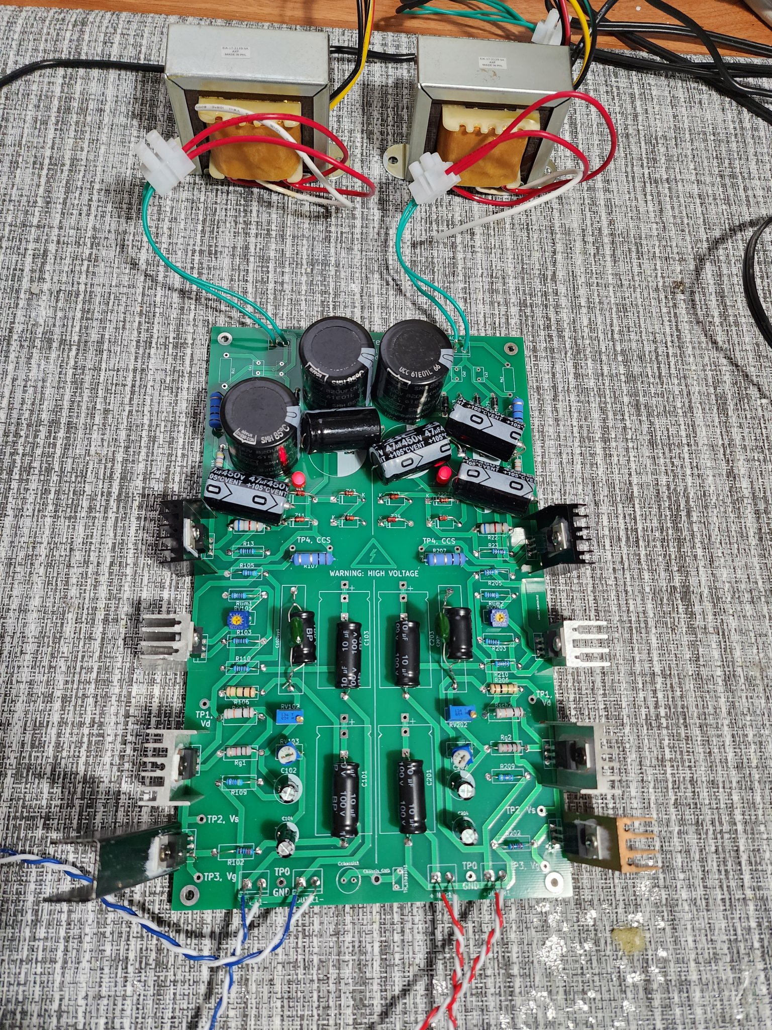

I am building second SCG pre and about to order these power transformers. They worked great for me first time. If anyone is interested.
https://www.tubesandmore.com/search/node/P-TN-68X
It's actually intended to be used as a dual primary 115 or 230 volts to a single 115 volt secondary. I have used them "backwards" for years and they do work fine. Both Mouser and Digikey have them in stock and they are about $1 cheaper than AES.That's a great find. Dual secondaries.
I used them extensively in my tube pre investigation. Remember srpp kit with 6n1, 6n11, 6n2, 6dj8, 6n6? I tested apr. 6 versions and finished four into final boxes. Measured and listened to all, selected best sounding for main system.
This little trafo was used in all of those tube pre, since I used it as 125 to 230 ac. That's what kit required. And just like George says.
In case of SCG, i use it 115 to 115 just as isolation. One per channel. They are cheap.

Second SCG is born. All went well, biased as expected. I used whatever small heatsinks i found. Since they are individual, i used no mica pads to insulate.
One has to refrain from the temptation to touch the heatsinks to check for temperature. Unless one wants tingling feeling 🙂
My previous solution with one big heatsink was more labor intensive, with lots of mica pads and wires, but lot more safe.

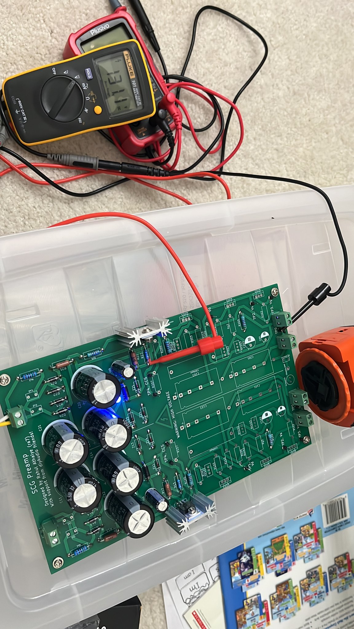

I am in the process of finishing up my board. Any recommendations for the value of the volume pot for this preamp if I am pairing it with positive vfet amp or my SissySIT amps?
That’s a good sign. Measure at R207, should be a few volts lower indicating the reg is working.
