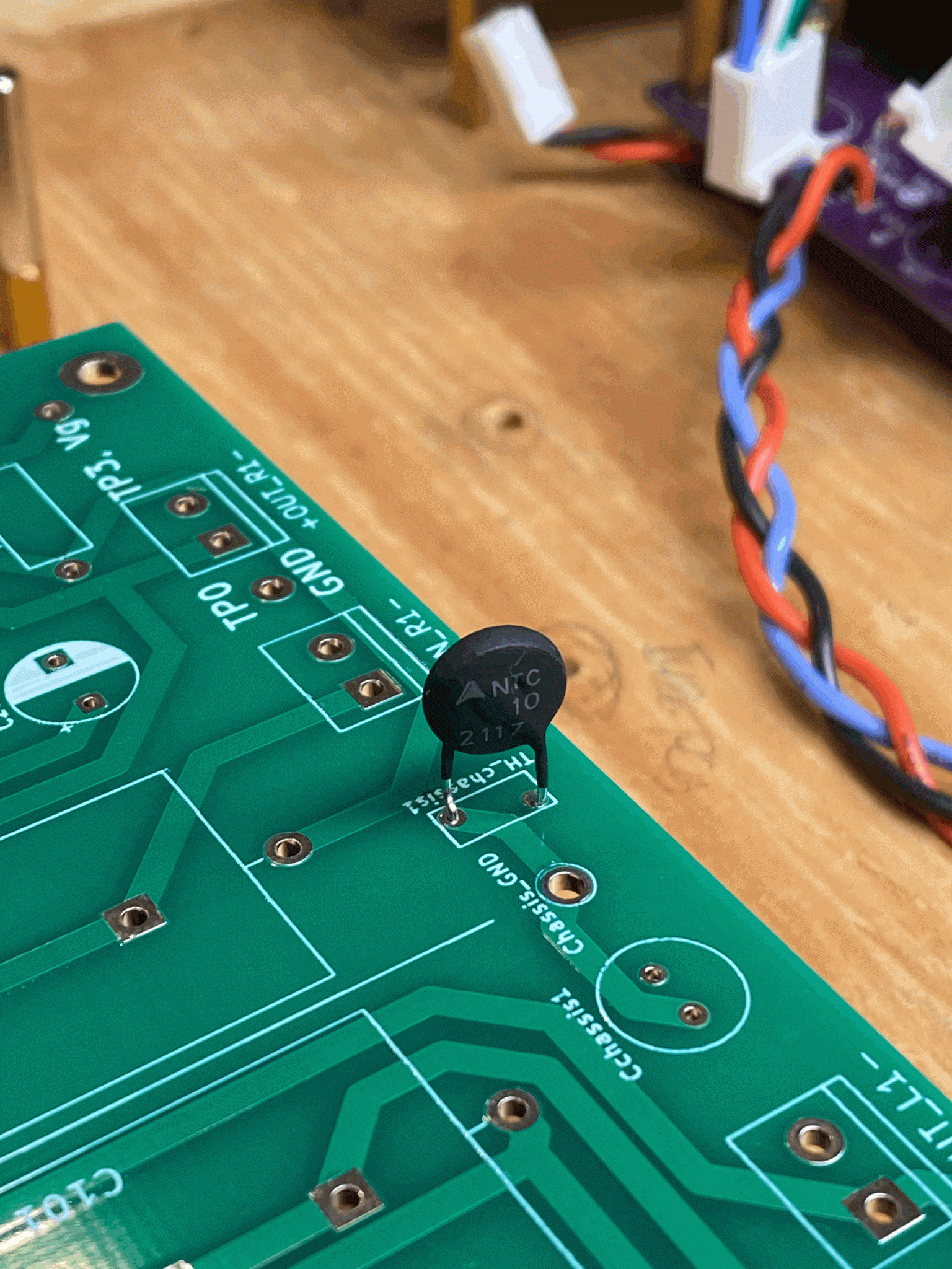

With regard to the thermistor, here's some options. The lead dia should be 0.6mm or less. I thought I chose an NTC thermistor footprint that was too small, but there are options. Really only a question of the lead fitting into the hole.

Manniraj, use this NTC:
B57235S0100M000

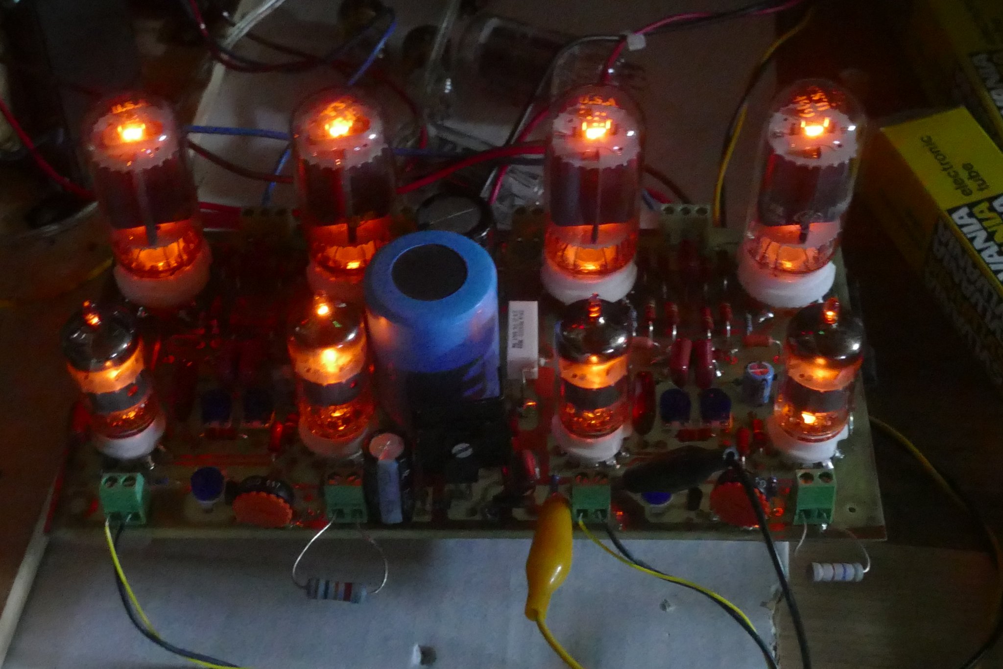

This picture shows two tubes in each board with the two tube / mosfet pairs wired in parallel. Each board is driven from one channel on the SCG board. Despite the "Nominal Power - 60W" sticker on the Toroidy OPT's, they will not do 30 watts across the audio range and saturation was seen at 20 watts below about 35 Hz. I decided to use a pair of Hammond 1628SEA's that I have owned since 2006. They are large, inefficient, and have never been used in an amplifier as long as I have owned them since I have always found something else that worked better in listening and measurement testing. The huge core requires more energy to flip all those magnetic domains back and forth, so they give up at least 10% of the applied audio power compared to the large Edcors, and probably close to 20% compared to the efficient Toroidy's that these are replacing. The Hammonds are 5K ohm and I need a lower impedance, so I am deliberately mis-wiring them to get 2500 ohms, which will waste more audio power.
The Hammonds have more stray capacitance and leakage inductance than most OPT's primarily because they are BIG. More wire, and more metal makes more inductance and capacitance. They have been consistently marginal in HF frequency response with an upper 3dB point in the 18 to 25 KHz range in a typical SE tube amp design like my SSE. The vacuum tube based UNSET changed that with frequency response from about 20 Hz to mid 30 KHz due to the low driving impedance it presents to the transformer. This reduces the "Q" of the resonant notch formed by the stray capacitance and leakage inductance. Listening tests with an UNSET board driving these transformers were very positive.
Running Two UNSET circuits in parallel further reduces the driving impedance to the OPT and allows for a more conservative operating point. I fired the breadboard amp up and set each tube for 35 watts of dissipation. The amp began to clip around 30 watts and hit 5.5% THD at 35 watts. I believe that this would be a 40 watt amp with a more efficient OPT. The 3 dB frequency response at 20 watts of audio output was 16 Hz to 45 KHz, a number previously unseen with these transformers. THD vs Power at 1 KHz is below. Both channels were nearly identical. It took 1.05 Vrms to drive the amp to 20 watts of output.

Perfecto!Manniraj, use this NTC:
B57235S0100M000

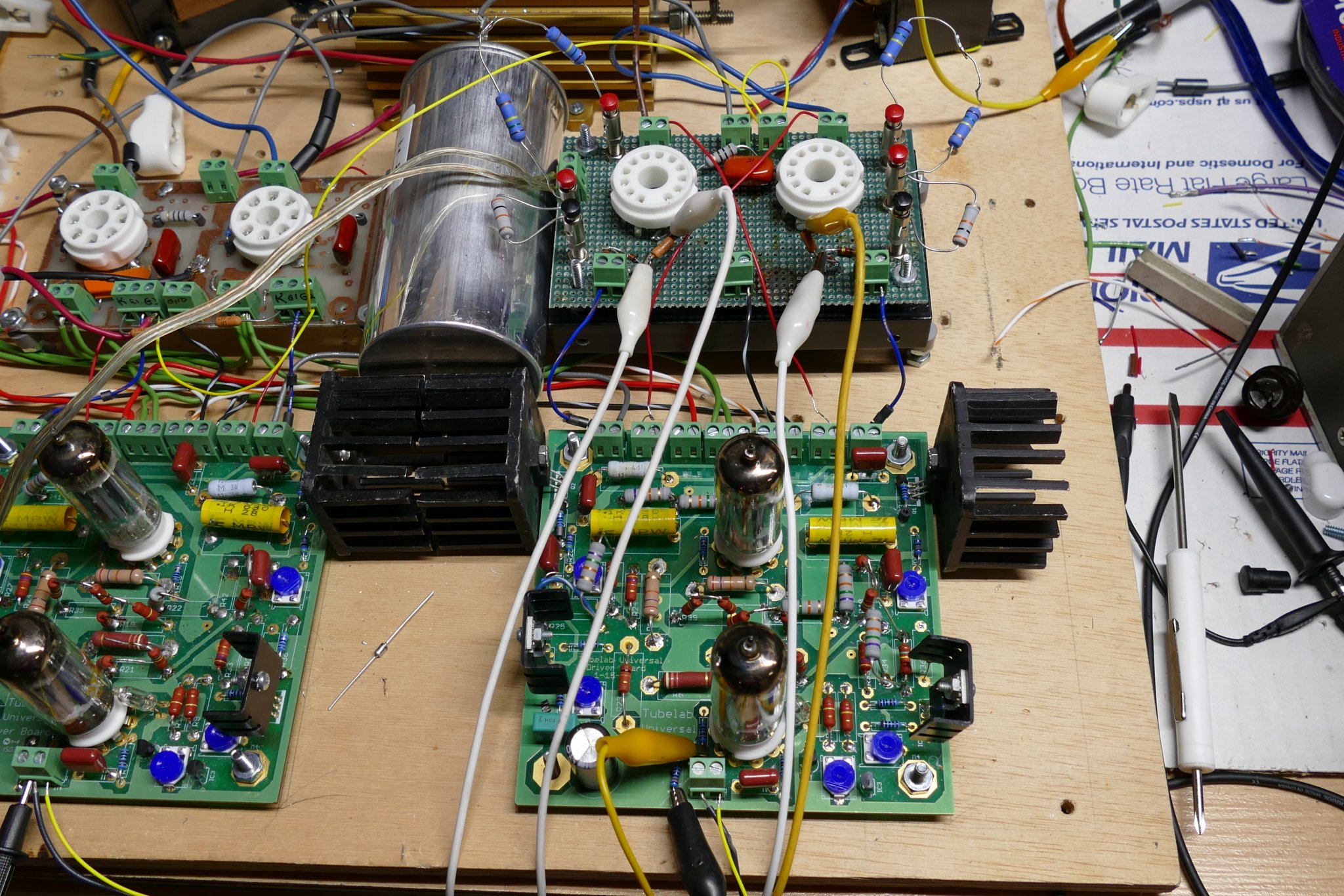

The 211 / 845 amp has its power supply on the smaller of the two chassis. It uses a vacuum tube based linear power supply which was included in the heat generation numbers. It also uses a 45 based TSE board for the driver that consumes about 11 watts for its heaters, and a power supply with 3 5AR4 rectifiers for about 15 watts more of heater power.
The output stage in the 211 / 845 amp could run either tube. It contained a mosfet driving the grid for class A2 operation. I ran old tubes at 70 mA and about 1070 volts for a power input of about 75 watts per channel. This produced about 25 WPC of audio. I got several new Chinese tubes back when they were about $30 each, so I didn't mind bending the spec a bit going over 100 mA which dropped the plate voltage to about 1050 for about 105 watts of input which yielded 30 WPC of output. Going to 120 mA actually reduced the power output because the B+ voltage sagged further. It did however improved the bass due to the higher damping factor.
Last night's listening session had 105 mA flowing through each tube / mosfet combo on 504 volts of B+ for an identical 105 watts of input. I could however get about 34 watts at 5% THD which was the measurement criteria I used to use when the 211 / 845 amp was built and tested. The Hammond OPT used in the SCG / UNSET tests is less efficient than the transformer in the 211 / 845 amp. Increasing the current further in the output tubes did very little if anything for the sound quality but did gain a couple more watts in output power. At this point the driver and output sections are both hitting the clipping wall. I may swap in a higher voltage zener in the SCG board and test again, but I won't be home today, so maybe tomorrow.

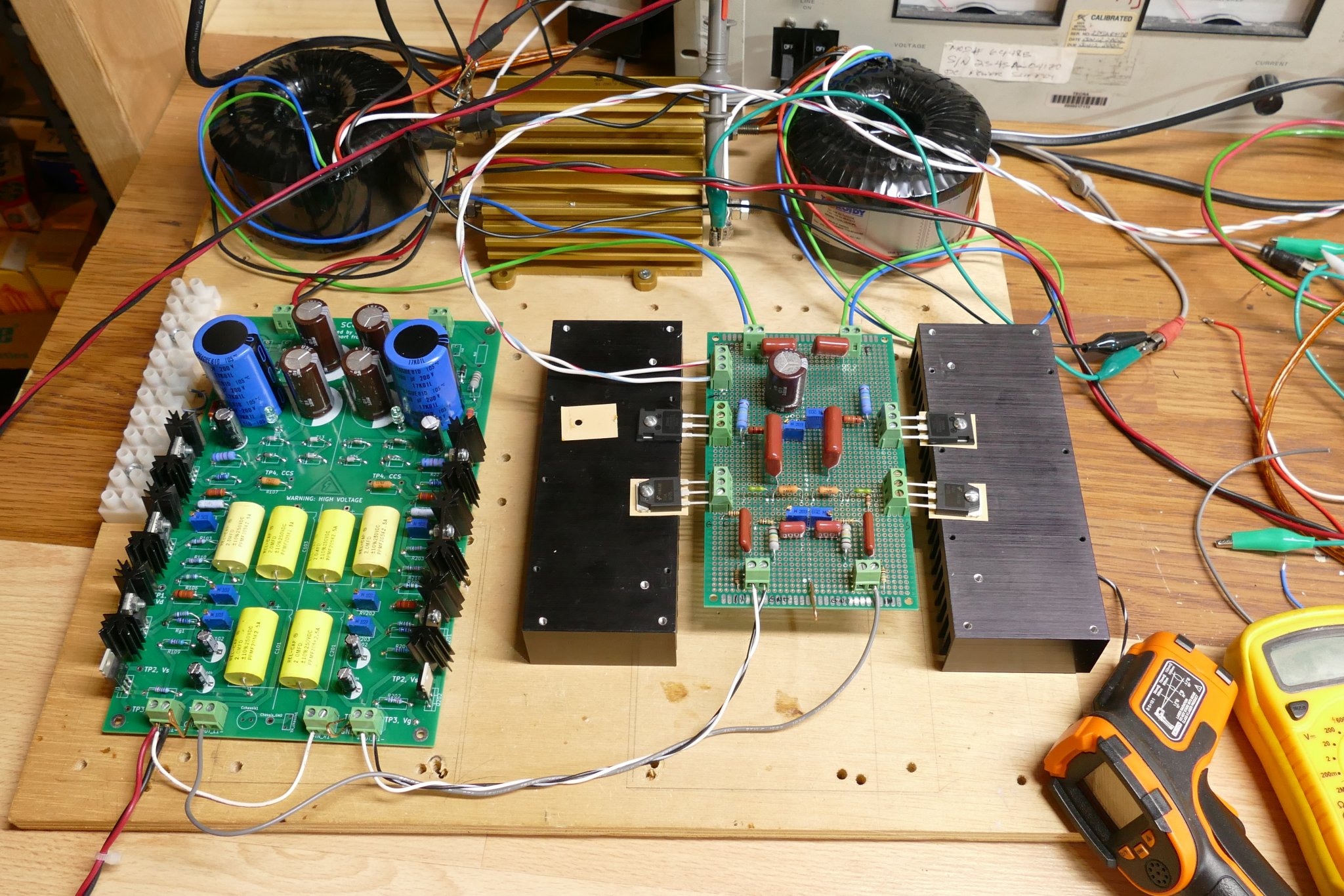

The initial experiments that led to the common grid or common gate topology found in the SCG and UNSET started in 2017 as an idea for a way to make low buck vacuum tube guitar amps. There were a few successes, but far more failures including a pair of exploding vacuum tubes.
The first successful test board is seen in the first picture. The setup is my typical breadboarded 2 channel tube amp with the output board on the right replaced with a perfboard experiment. The mosfets are mounted on a black heatsink underneath the perfboard. The "Schade" resistors are in the spring clips on either side since they were constantly being changed. White and yellow clip leads put meters across 1 ohm resistors in series with the P-fet drain.
The first successful amp with this topology is seen in the second picture. All the tubes used here were on the $1 list, so 70 WPC flowed from $8 worth of tubes.

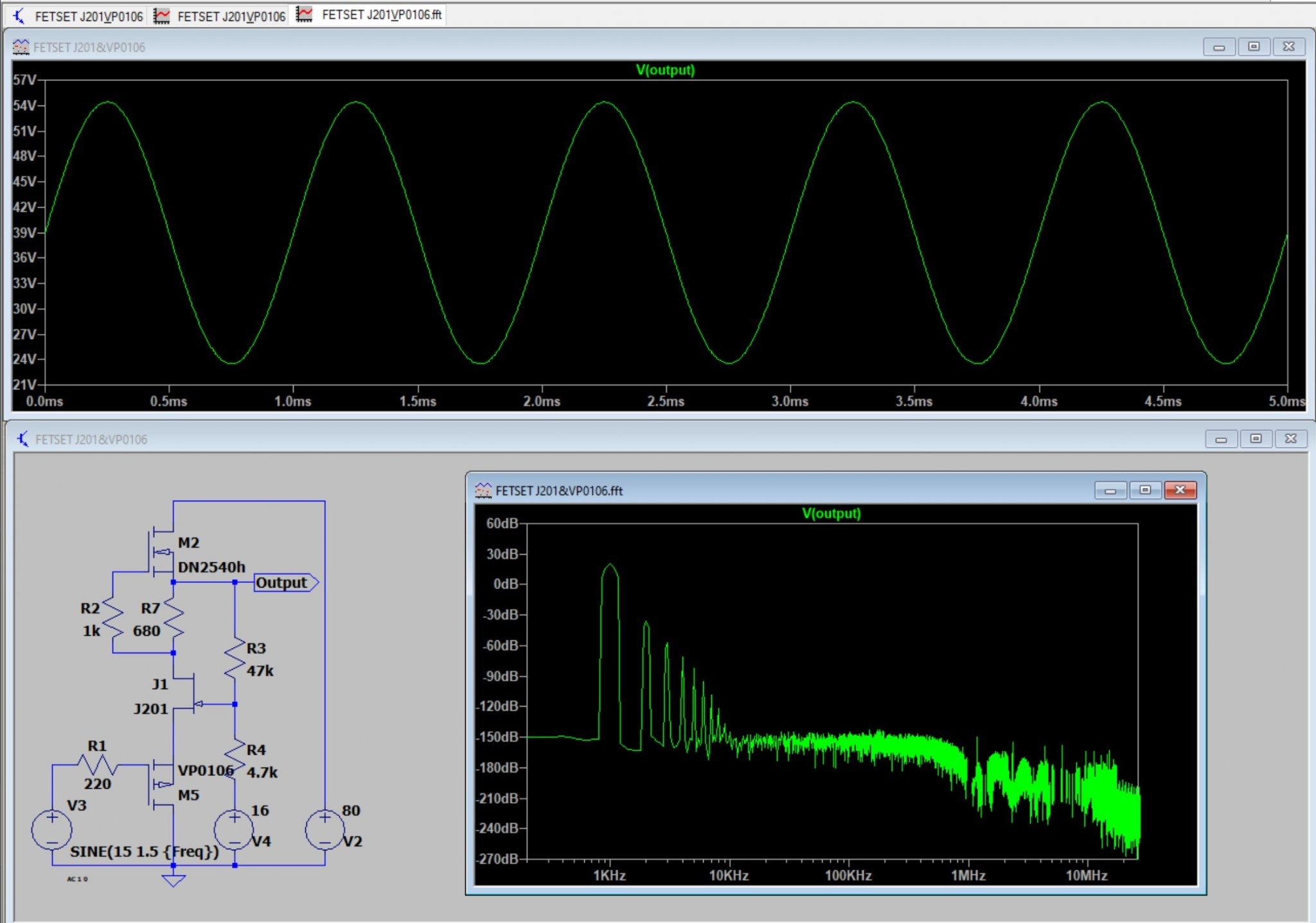

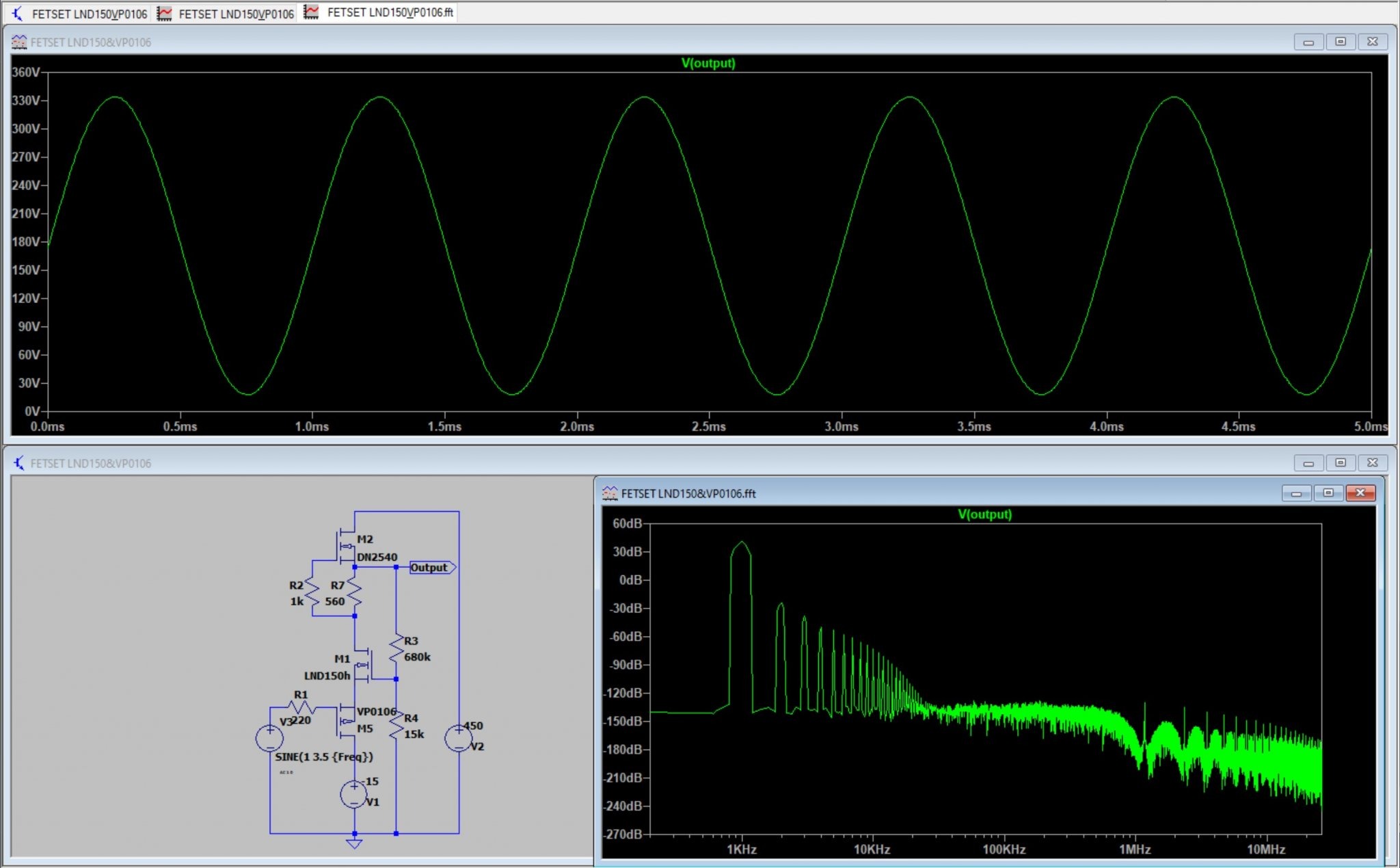

In one of these I had mentioned that I had stuck a pair of LND150 mosfets into the 12AX7 (vacuum tube twin triode) socket in a guitar amp with no other changes and it worked very well. This experiment and discussions led to some simulation and a redesign of the 4 tube guitar amp I build for that challenge. It now contains 4 tubes and two LND150's, and remains the only guitar amp I use regularly.
The sim in the first picture may look somewhat familiar. It was intended for driver applications and can produce 300 volts peak to peak with about 0.5% THD in real world bench testing.
I also tested a similar design with a j-fet for the gain device. It also had decent performance but could only be run at low voltages due to the j-fets breakdown voltage rating.

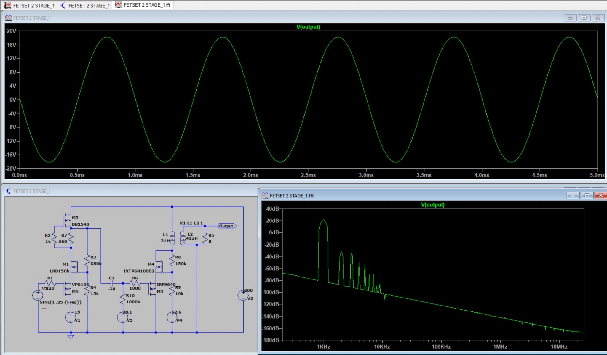

I simulated several two stage circuits in an attempt to get from line level to speaker level, assuming a single ended output stage with an output transformer like those seen in a typical tube amp. There were all tube sims, sims with a tube and a fet, and a couple of all fet sims. I went in the all tube direction first and created the UNSET design. The story is here if anyone is interested:

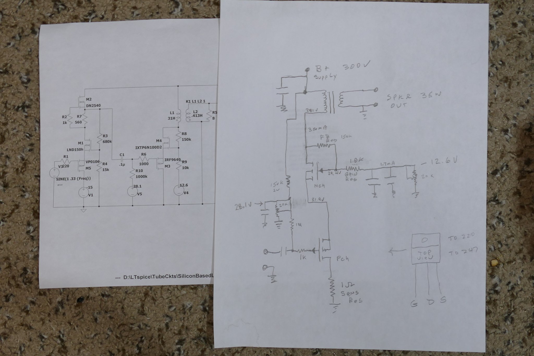

I distilled the important info from the sim and created a schematic for an output stage that could be built with physical parts the old fashioned way, with pencil and paper and several boxes full pf parts. It soon became obvious that my old test board wouldn't work, so I created a new one. 6th and 7th pictures.

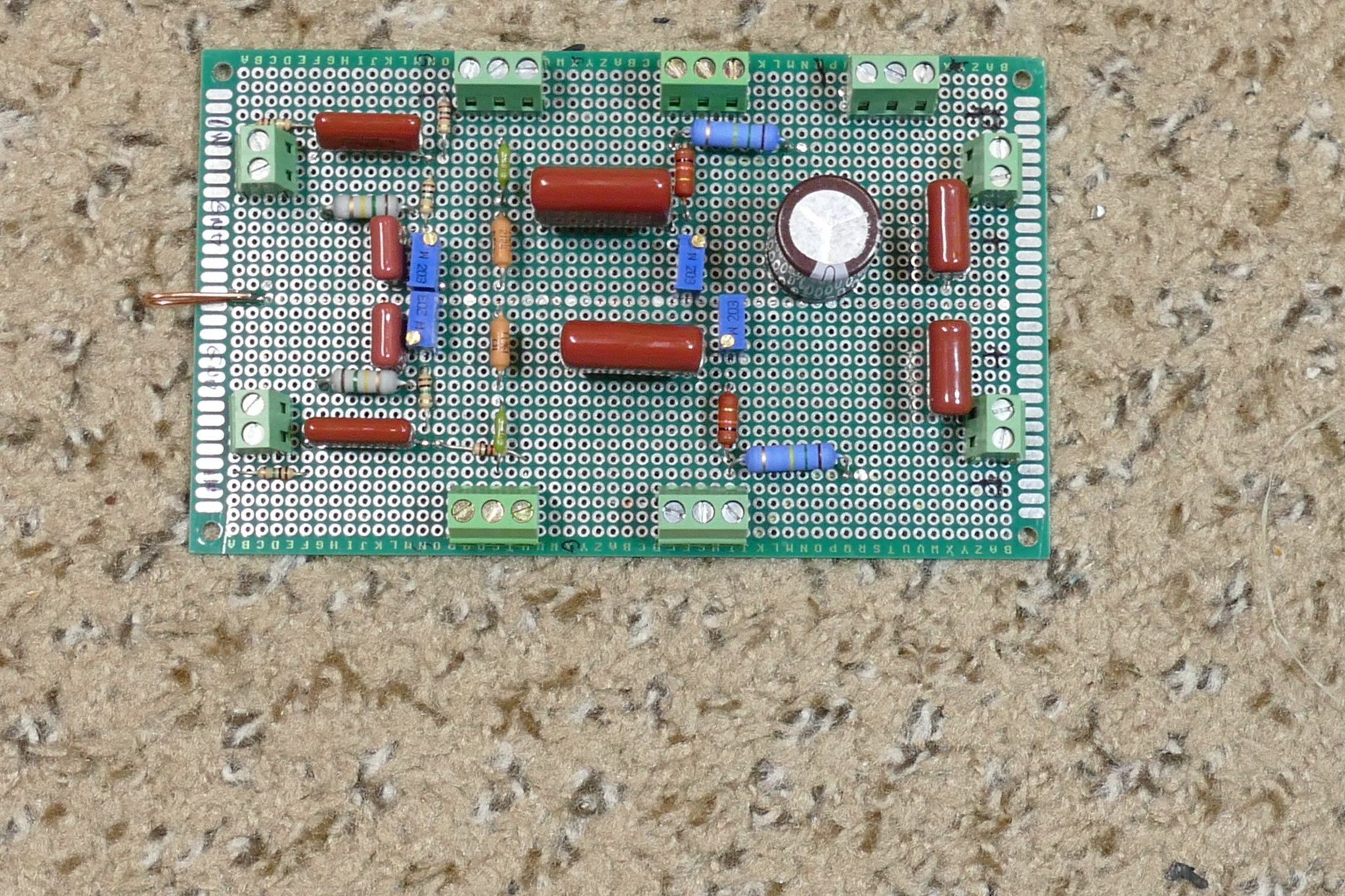

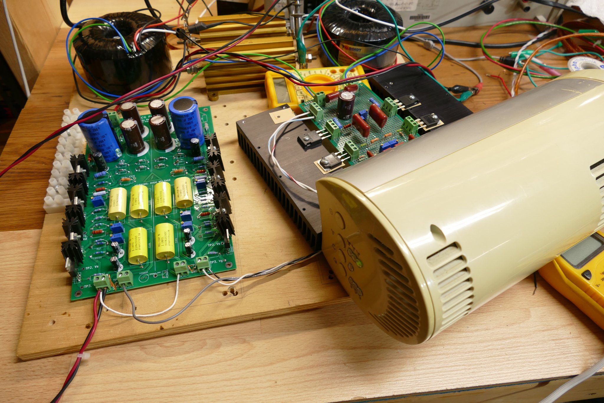

The test board worked perfectly, but mosfet heat killed the fun before I could find the limits. The sim revealed that I should be able to get 35 WPC with under 1% THD on 300 volts of B+ with 350 mA of idle current into my 600 ohm OPT's. This is 105 watts of dissipation per channel, with about 85 watts of that in the gain device.
In order to extend the test levels, I resorted to "cold air induction." The meter at the end of the board blocks the air exit forcing it out through the heat sinks. This gave me a few very short test periods where I did see over 20 watts at under 2% THD on each channel. During a 30 second or so test the mosfets hit 80C while the heat sinks barely got over 30C. I haven't built anything with TO-247 devices in ages, so my 20+ year old thermal pads that were pulled from another heat sink are probably useless.
This design sees up to 2X the B+ voltage on the drain of the gain fet. The heat sink needs to be grounded to avoid a shocking experience, so I ordered a bunch of different kinds of thermal "solutions" from Mouser yesterday.
Those heat sinks are not big enough to dissipate 200 watts, so I'll need to drill and tap proper holes in the big one seen in post #644. I have two of them if one isn't enough. My drill press is in the garage, so that operation will be delayed until the sideways blowing rain / snow slows down a bit, maybe Sunday. Another possibility is the use of some of the CPU coolers that I have accumulated in 40 years of PC building.

Heat is a problem with this single-ended topology. The trafo or choke as a load helps with improving efficiency. But 300V and 350 mA is a lot. Also, it must a huge transformer.
The LND150 sim is amazing. Gain of 40X? Superb linearity. Maybe it can be a preamp in its own right with a buffer on the output. I tried the LND150 in the current preamp. When driving the gates of SITs, I found you needed at least 8 mA of drive. The LND150 wasn’t cutting it. But maybe with a buffer.
Love the hand drawn schematic. I recently read in one of Nelson’s early Zen articles that a lower impedance feedback network provides more current for charging the gate capacitance of the MOSFET. I see high impedances in that last schematic. Have you tried with lower impedance? I did notice a difference between 100k/10k and 10k/1k preferring the latter. The bigger mosfets want even more current, I presume.

What is that giant can in the third from last picture?

When I dug up the old sim that I used in my last post both stages used the same VP0106 - LND150 - DN2540 lineup. This made 300 volts peak to peak with low THD, but couldn't drive anything. I simply played the "pick a new mosfet" roulette wheel until I got something that worked, then built it.
I plan to mess around with the feedback resistors once I have the amp thermally stable. It's far easier to parallel resistors across existing parts that are too high in value that it is to change them, so when I'm building a proto, I always start too high on resistor values, and too low on capacitors. I made the mosfets easily swappable here too since I have lots of them to try for power output and voltage output test conditions. I also used 450 volt or higher capacitors so I can test this thing up to 450 volts.
The large metal can is a 100 uF 370 VAC (good for over 500 VDC) motor RUN cap in parallel with my 50 year old Fluke 407D power supply. Motor RUN caps like found in an air conditioner are low ESR polypropylene capacitors which can provide a quick pulse of current to feed musical transients like drum hits. Builders of my amplifiers have been using these in parallel with the on board electrolytic for years. Most users including myself find increased dynamics especially on percussive music. Note that motor RUN cape are designed to run directly in series with the AC line and a big motor. They are designed to handle AMPS of current continuously forever with low loss. A motor START cap is usually a cheap electrolytic which must NOT be used in a tube amp, as it is designed for short term duty and could leak, vent, or even explode if left across a power source continuously.
