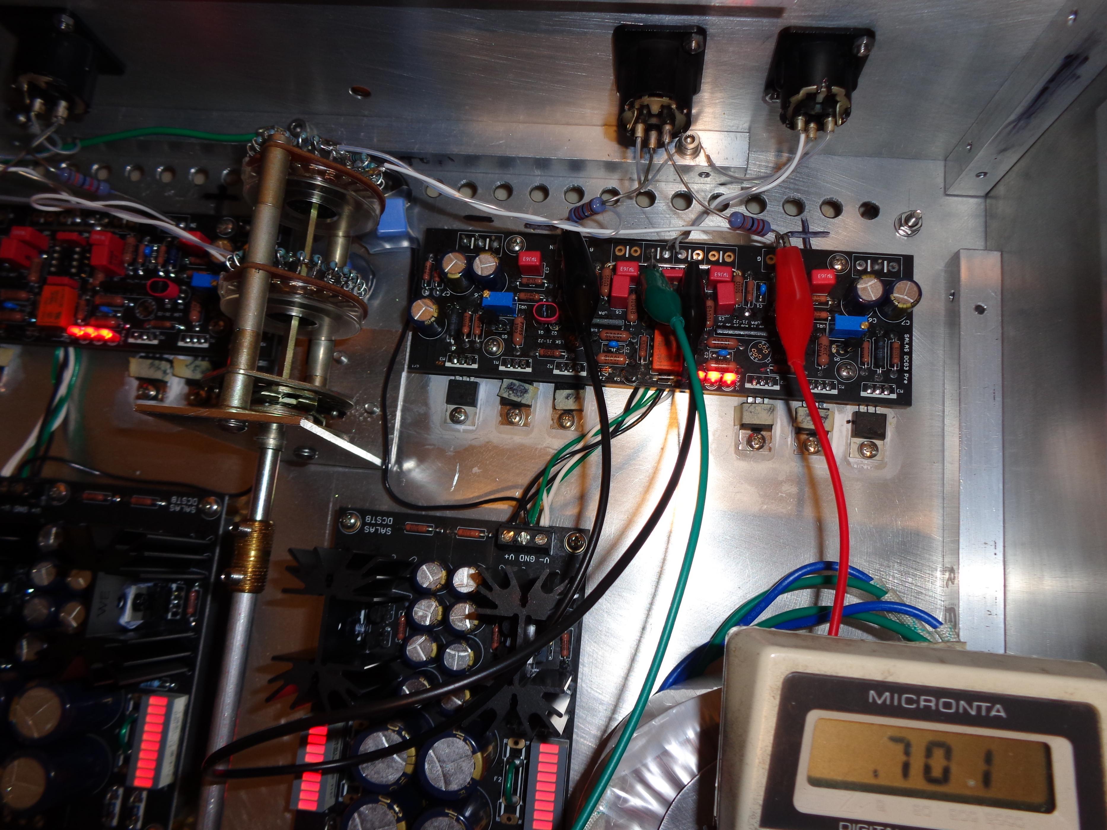

As you recall I had mentioned about hum when SLB's are connected and about the weird hum when I touched the circuit of the left channel. Not finding any issues with the build I decided to swap transformers from one side to another. This eliminated the hum that I heard when the circuit was touched. Perhaps one of the transformers has more leakage than the other and re positioning it solved that issue? Very quiet except for very slight hiss from the speakers.
I was still bothered by why there was a hum/buzz when SLB's were connected so finally I shorted the lifted end of the R7's back to PCB G and that resulted in no hum/buzz with SLB's connected. Maybe you can explain why.
Listening with R7's ends grounded or lifted I could hear no difference in sound. So I decided to ground them and connect the CL60's. I also paralleled a cap with each CL60 as you had earlier suggested. At the speaker it sounds just as quiet as the earlier setup.
SE to balanced conversion works even without R7's lifted. I have tested it by making leads that connect directly to XLR pin 2 and 3 and they work fine. As per Kosta's request I tested by connecting G to In- and feeding the SE signal reference there and that works fine too.

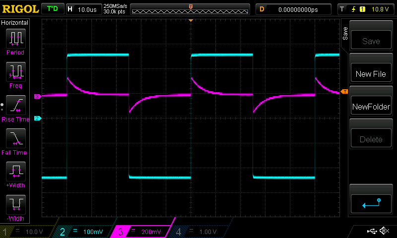

Now I discovered another strange behaviour while scoping the inputs versus outputs... When feeding a square wave into Right channel I see a distorted square on the output of the Left chanel.
Where does this crosstalk come from ?

Usually from rails interaction or ground wiring interaction. Or interaction in the measurement loop.
Nicely shaped main squarewave BTW.
Yes, now the lines in the scope are free of dust. Been ploting response and never did find anything like this.
It is flat to 2megahz and reduces gain from 3X to 2.7X at 3megahz

If you experience issues with the transformers check for correct phase at the secondaries. 18V AC accross each secondary, 36V AC accross both.
That's weird, indeed! It doesn't work in my setup with R7 grounded. I' ll check it again to be sure but I think the shunt volume control plays a role here.
Here's the money shot.
The atten is in the max position which makes it an open between the IN+ and In- and is completely out of the equation just like you have it.
Red wire(signal) to In+, black wire joining In- and Pcb G and green wire(signal reference) also to G. Notice the short 1/4 in wire soldered between the R7 link and G that I have put in to which green wire is attached. Meter is reading between the two Line outs.
nash
It seems correct yet strange. I' ll check mine ASAP.
BTW, I see you are running two wires from DCSTB GND to DCG3. This may be the reason for hum.

Good observation. I had removed one thinking that there was a ground loop formed but it made absolutely no difference. As noted all is quiet now.
