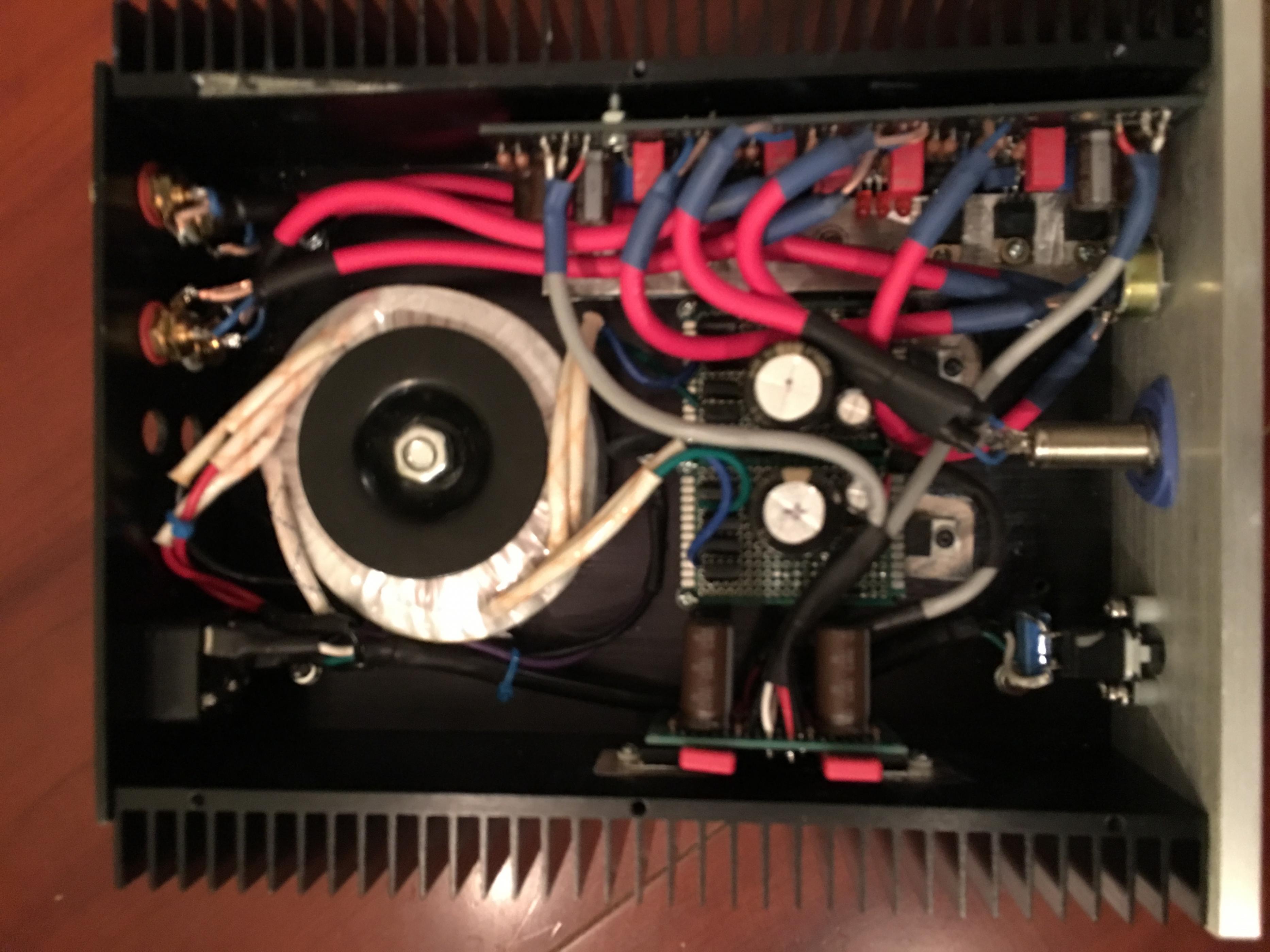

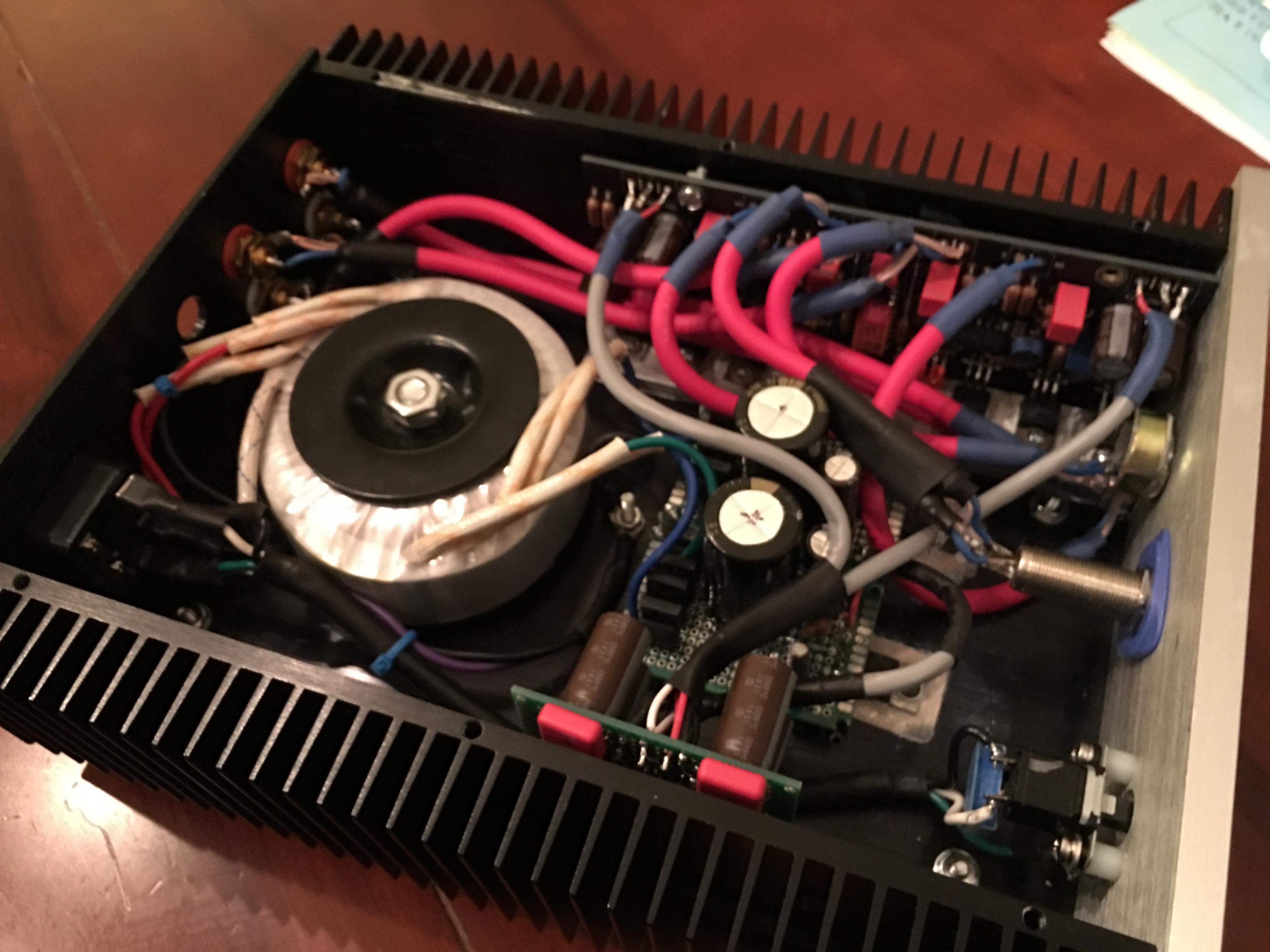

And on a side note, I also like the warm glow of the LEDs. My case is still without a top - will have to plan for incorporating an acrylic window on the top so that parts of the power supply unit are still visible.
Hmmm... nice!
Btw, I am using the DCG3 on a daily basis as a line preamp and enjoying - thank you for sharing this with the DIY Community!

Congratulations for your build. Post pictures when finished with acrylic top.
Thank you. Definitely will post pictures when top and front panel are done.

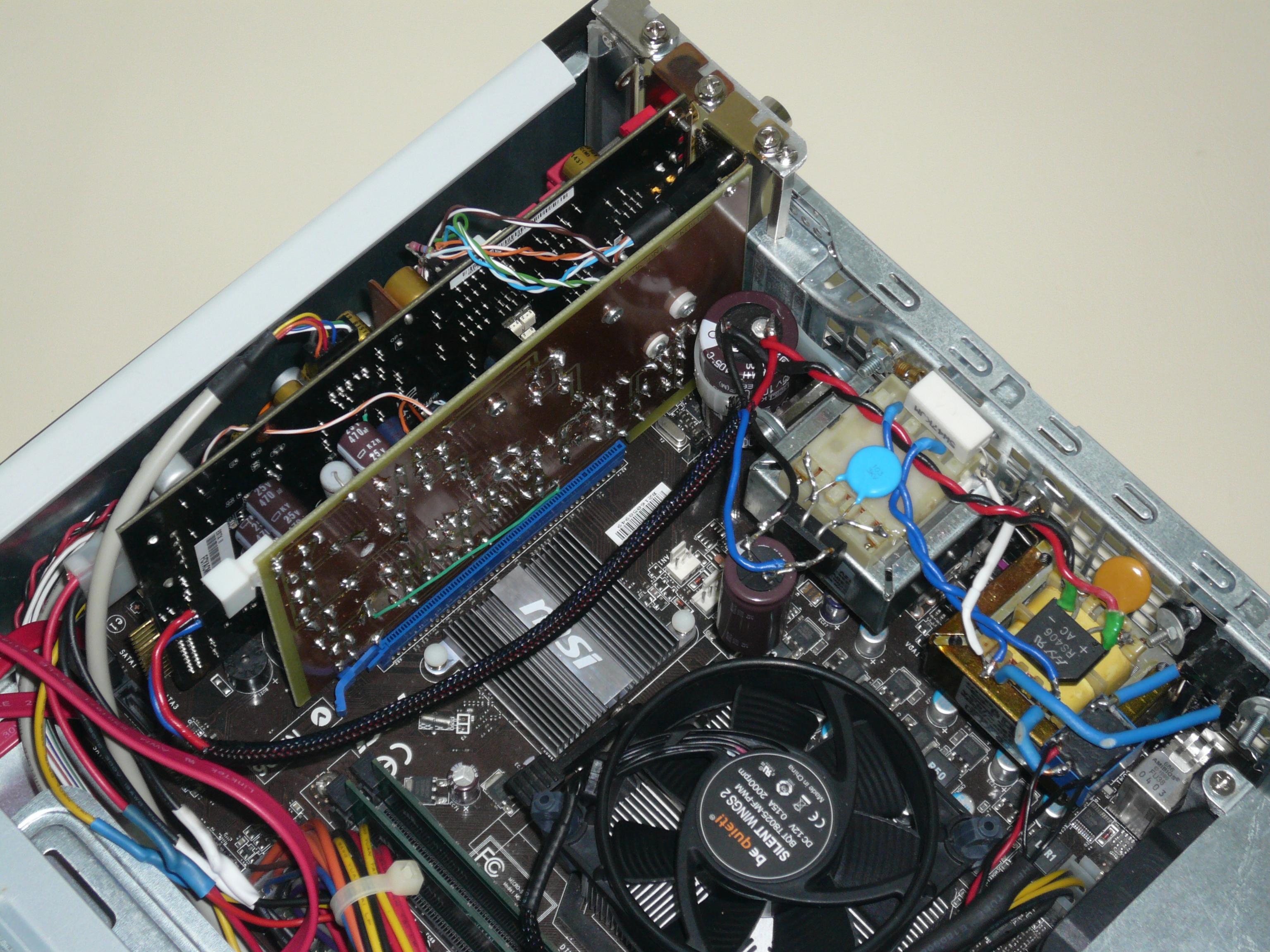

Pic of my "DAC". A modified Asus essense STXII.
I checked with R7s lifted. Yes, it does SE/bal conversion. The interesting thing is that it does it with and without - in to GND! Also there is buzz noise not affected by ground lifters. It doesn't change to better or worse even if I touch the wire that connects the R7s. Go figure!
