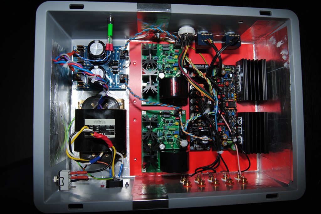

Colorful and nicely reordered. PCBs for everything now I see.
1.2Rs of narrower loops etched layout replaced the perfboard ones? What type of comp cap (C2) you ended up with? SMica?

after changing the shunts with new ones prepared for 17v and also changing the compensation cap in the dcg3 feedback, it sounds spectacularly well with my new mosfet power amps.

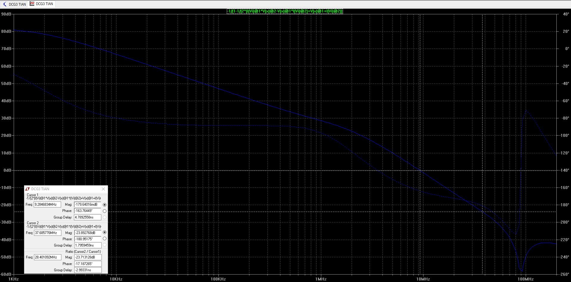

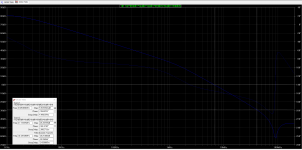

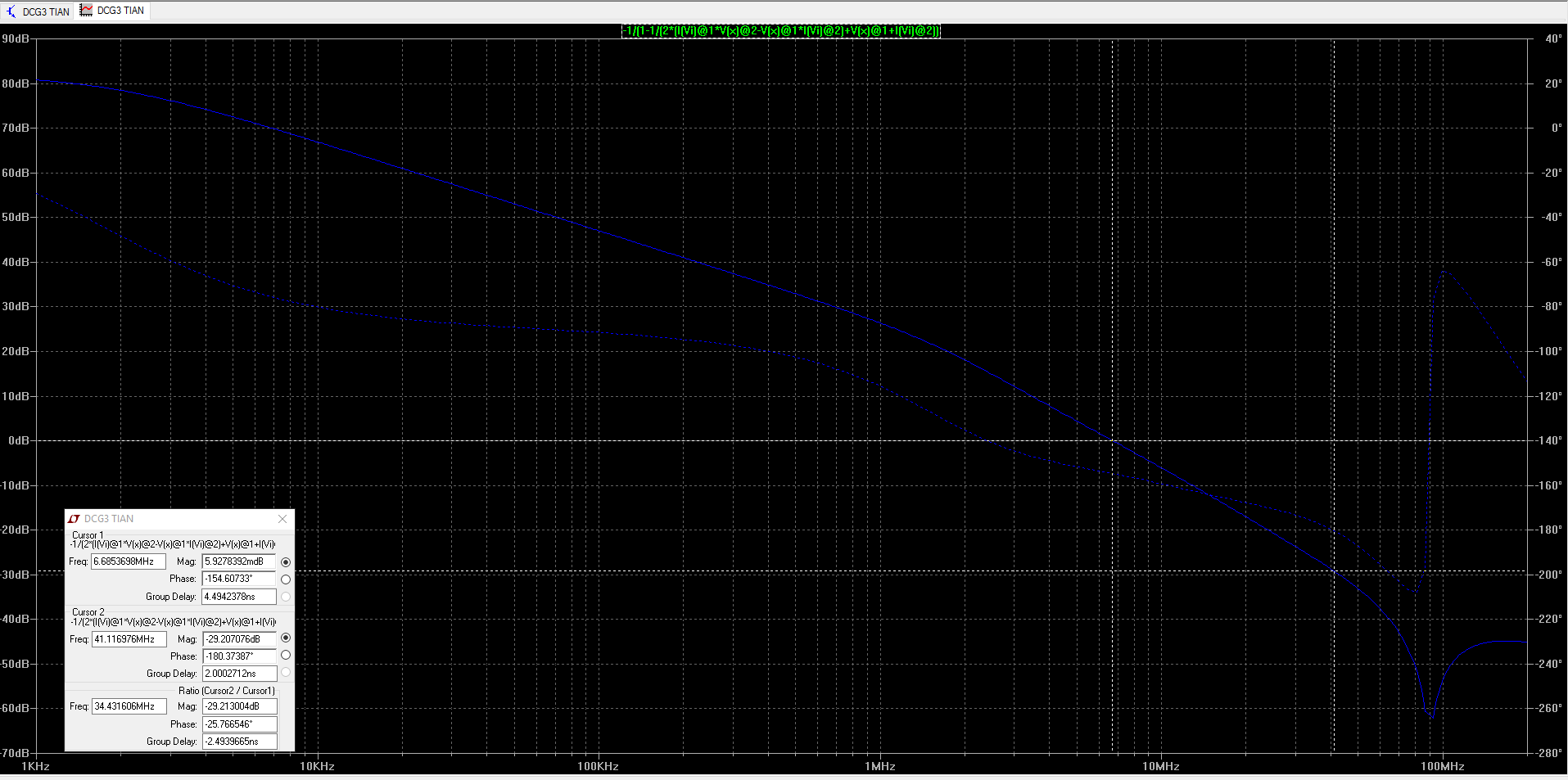

Throwing away much phase margin with 163pF C2 though. Try AD823 DIP8 (European stockist) AD823ANZ ANALOG DEVICES - Operational amplifier | TME - Electronic components
Its different set of graphs than my simulations. Both for numbers and shapes. I get 66.5 deg of margin with 33pF and 27.4 deg with 163pF. Also more open loop max gain. It was not the Tian method you use and if we also have different models our deviations can add up.
But... Before theory, in practice, I compensated the circuit sans input pot on the bench and then listened to it also. I remember that significantly higher value additions took it nearer to instability indeed.
Nonetheless practical matters like pots, wiring, type of PSUs, range of loads I want unconditional stability (included many tested headphones), can play a significant role for compensation choice.
I just don't recommend hit or miss value substitutions to people that don't have lab equipment. If it works stably for you that you can fully test it for some purpose, then its fine.

You are correct, I am not having good results with this TIAN probe.

your phase margins are exceptionally low.
For basic operation one expects a phase margin of ~45degrees, but that will give lots of overshoot on fast signals.
One normally needs at least 60degrees of phase margin to get minimal overshoot and usually amplifiers perform better with around 80degrees of phase margin.
I do not know is your simulation is correct, but you can check by testing your amplifier.
Put in a lowish level of 1kHz square wave with the input filter crippled.
Check the output for a clean square.
Add some capacitor load and repeat. Try 1nF, 3n3F, 10nF, 33nF, 100nF
Do any increase the overshoot?
Do any start ringing?
Do any cause oscillation?
