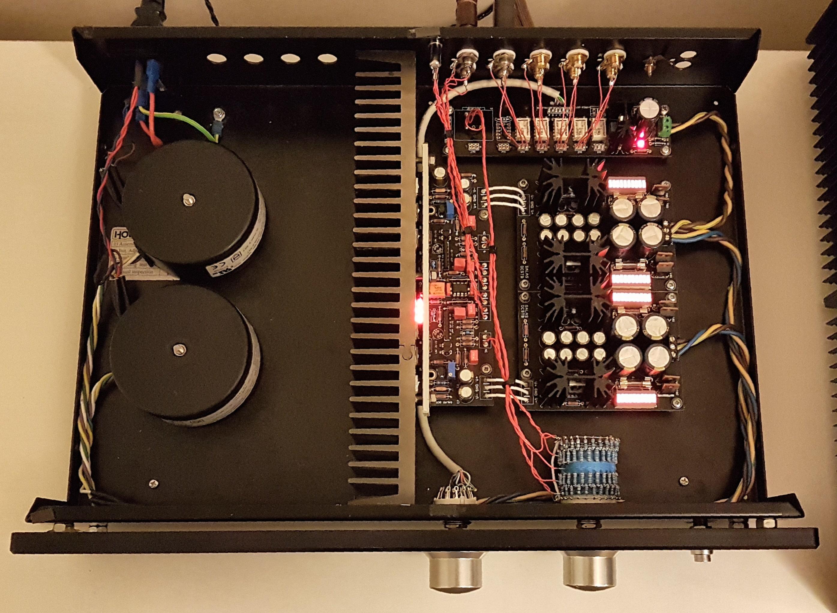

Looks very nice and tidy your build. Did you manage as hum & buzz free in the main system for multi-input line duty as it was quiet on headphones when you first tested it?
Yes. It is dead silent. No hum, buzz or whatever both with headphones and main speakers. My speakers are approx 96dB sensitive. If I put my ear deep inside the tweeter horn I can barely hear something. 5cm away - nothing. Its practicly inaudible.

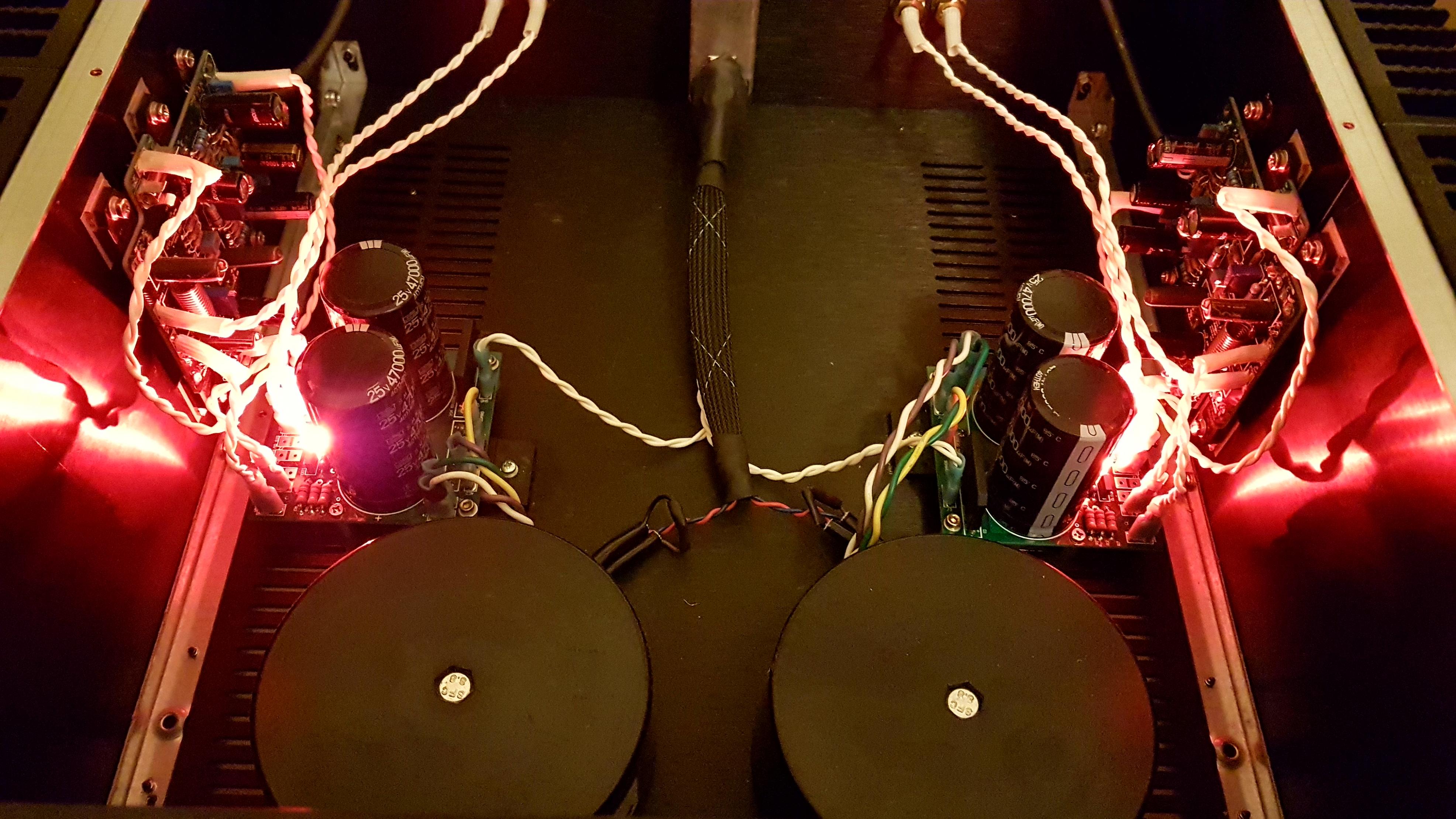

Poweramp is "Ovation-sx" 15W class A from Bonzai.

Good amp. Bonsai knows his stuff. And a good source. Must be a sweet total system. Congrats and enjoy.
BTW is that red twisted pair wiring single strand OFC or something, and are the speakers DIY also?

The wires are some ofc copper/silver ptfe insulated stuff.

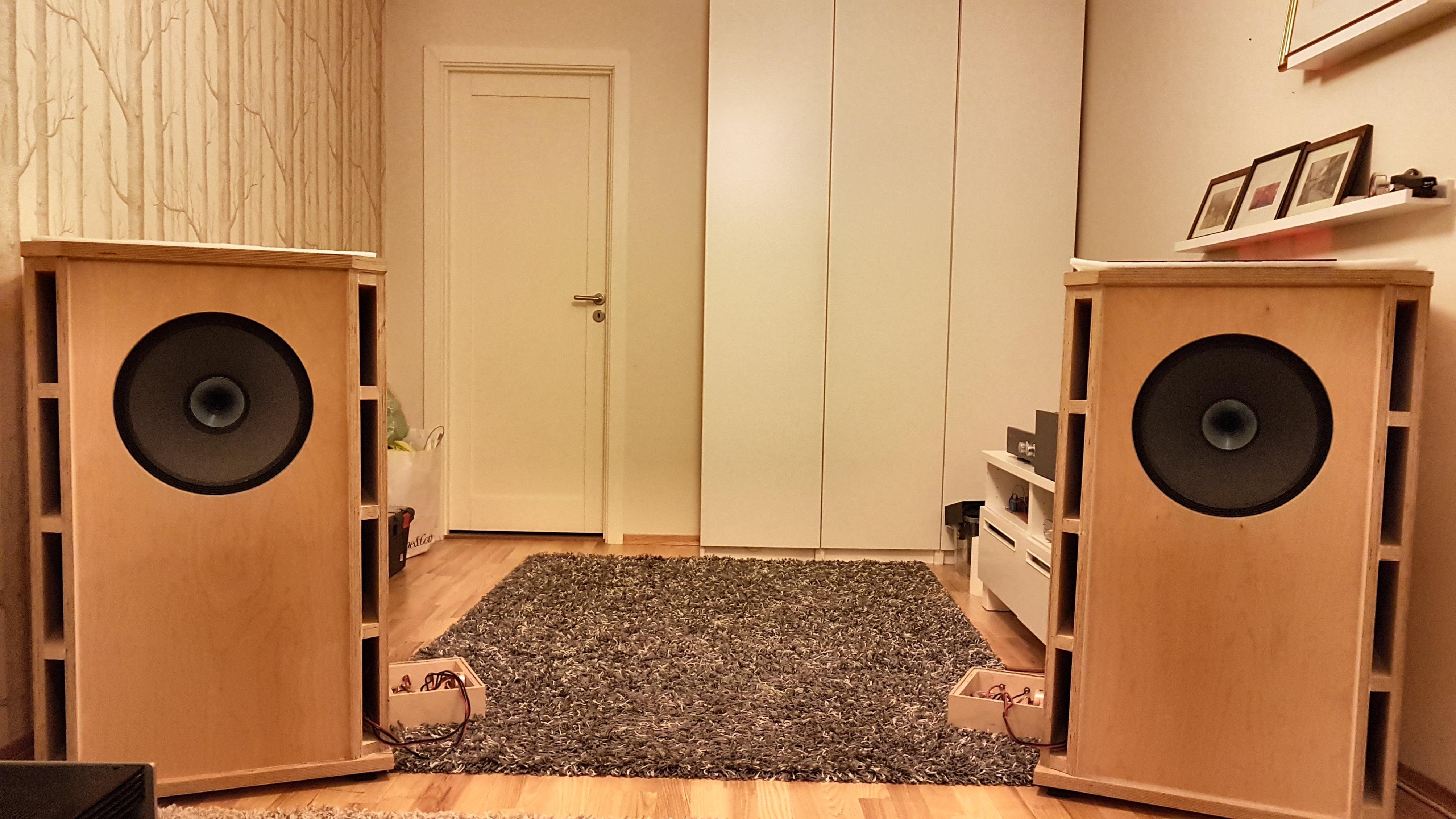

I think you have seen the speakers before 🙂 - have a small room in the basement..
Two of a kind on planet earth ;-) diy of course
One inside pic of the poweramp also.
