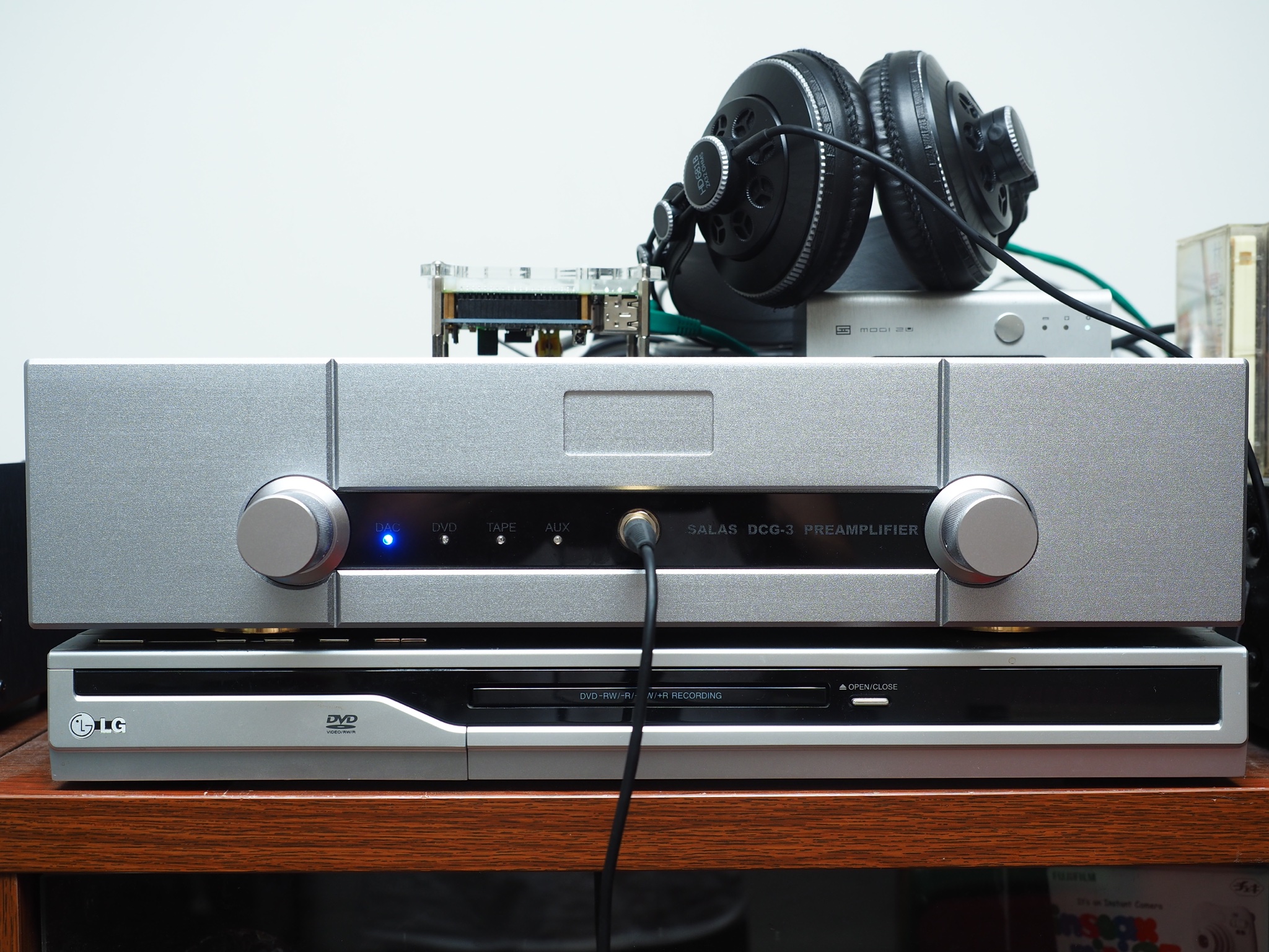

Add a laser engraved acrylic panel and input indicator in front of the chassis..Congratulations. First one here with a Muses chip-pot I believe. Let us know more about your system and how it blended in after you run it enough to grasp the qualities.

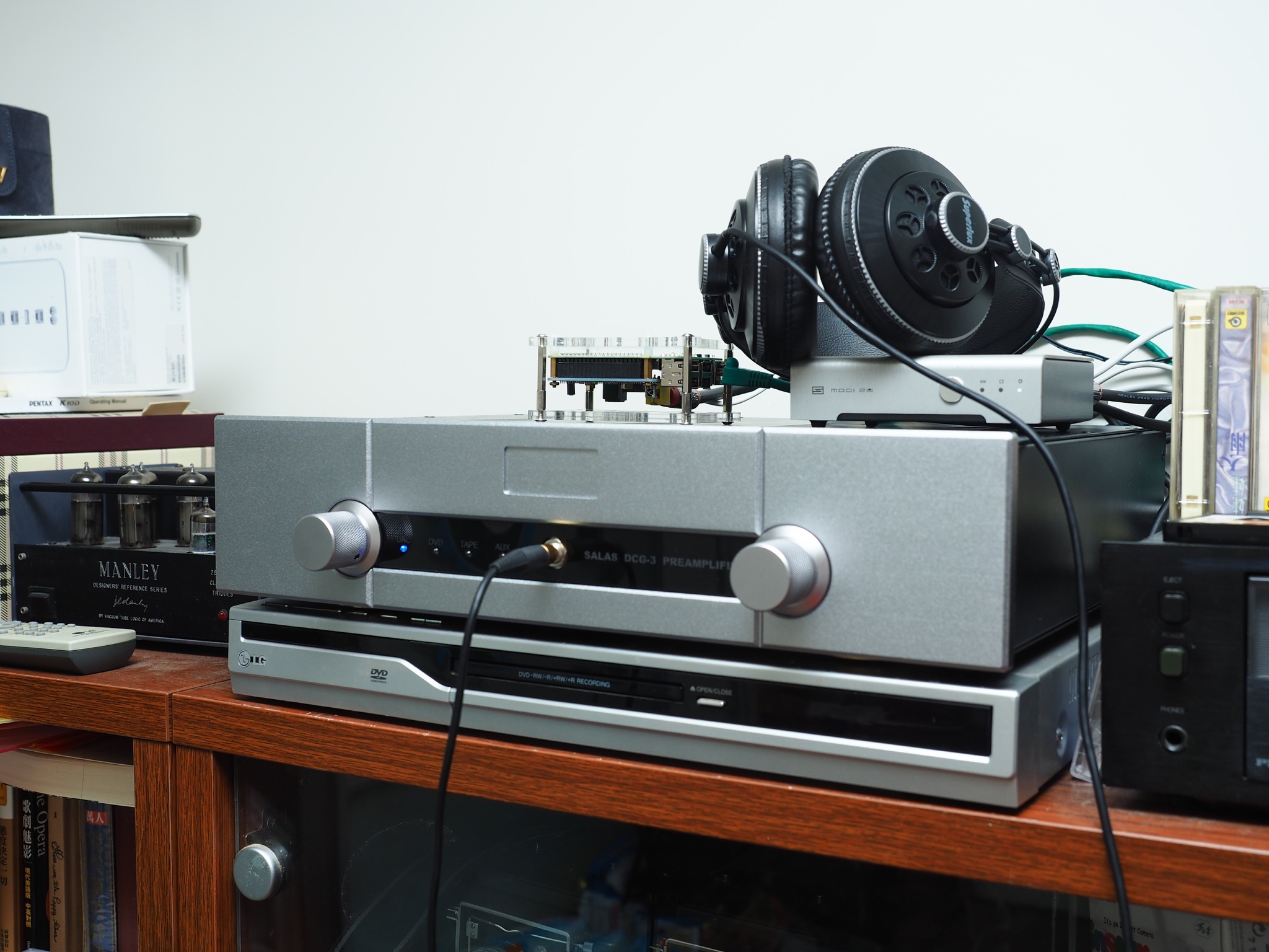

I use musese72320 chip-pot kit from Japan. As Salas mentioned, the pot circuit has it's problem. There are input caps and op-amps.
The input use the muse bp 22uf caps comes with kit. For the op-amp, I use the much cheaper muses8920 instead of the pricey moses01.
Here are my current equipment:
Spurce: Respbarry PI 3 + Schiit Modi 2 uber DAC.
Power Amp: VTL TT-25 Limited Edition tube power amp.
Speaker: Diaton PM-610MB 8ohm version.
Headphone: Superlux HD681D
First thing I noticed is the detail. In some good live concert records, I can feel the atmosphere.As matter of the fact, I can definitely hear more information from all of my records.
The treble and bass are extended and fast in my system. Sound stage is good. I have to say that I love the sound of DCG-3. Thanks Salas and Tea fro the efforts so I can build one.

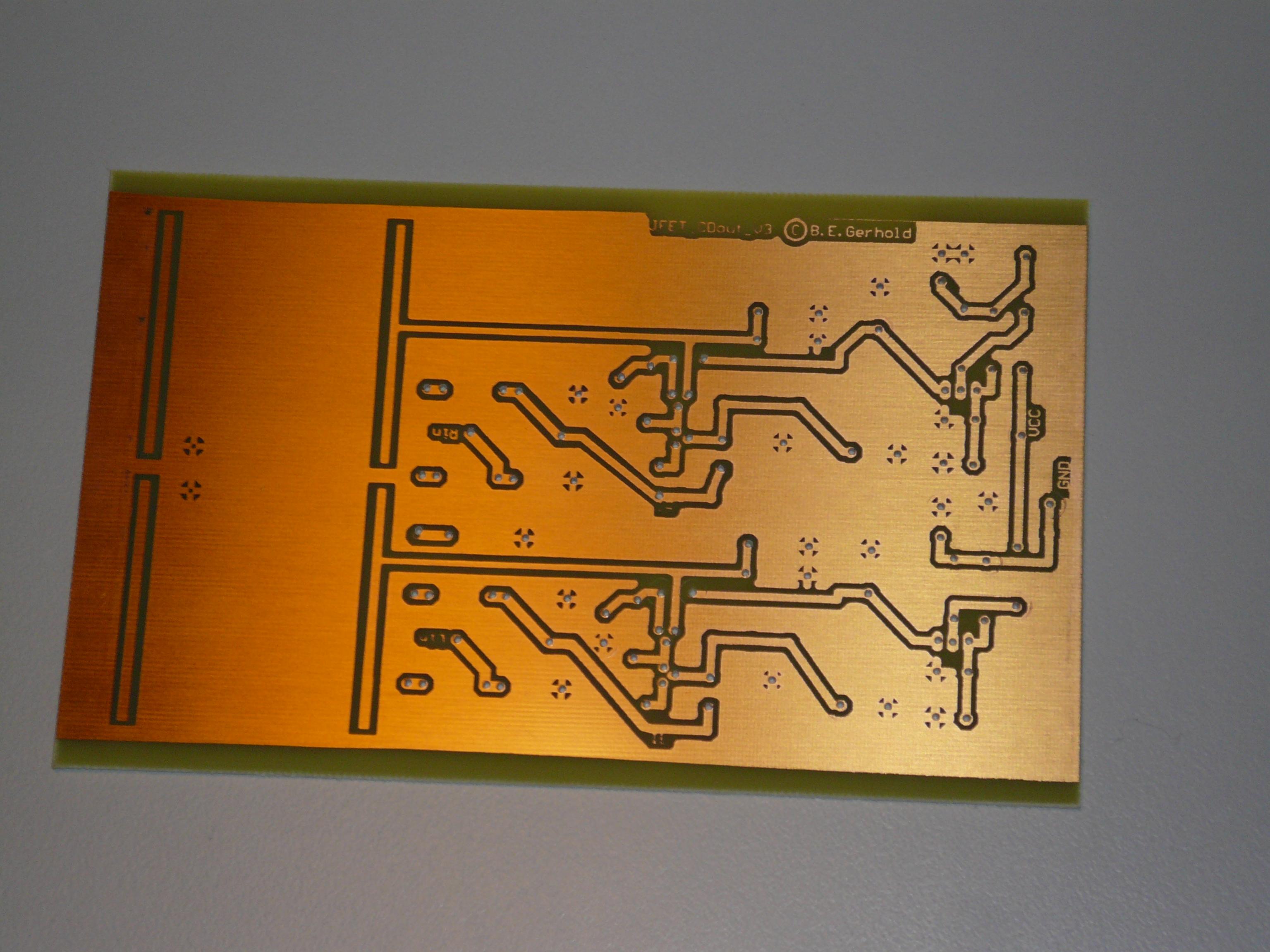

Thanks Salas! I just thought to play with an old sketch that seemed to be suitable to etch it on a PCB. It gives a very nice faint glow when DCG3 comes to life!
This is amazingly good work MagicBus...
How is you're procedure, when transfering some etch resistant foil or like to the bare pcb? -And how do you make it black afterwards 😕 🙂

I use UV sensitive boards. I print the layout on transparent paper, just placing it on the PCB and expose it on a lamp - many youtube videos about that. After a little experimantation results can be amazing! The UV chemical can be left as copper protection mask while it allows soldering.
